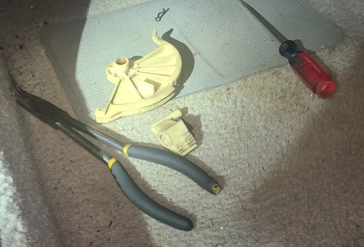

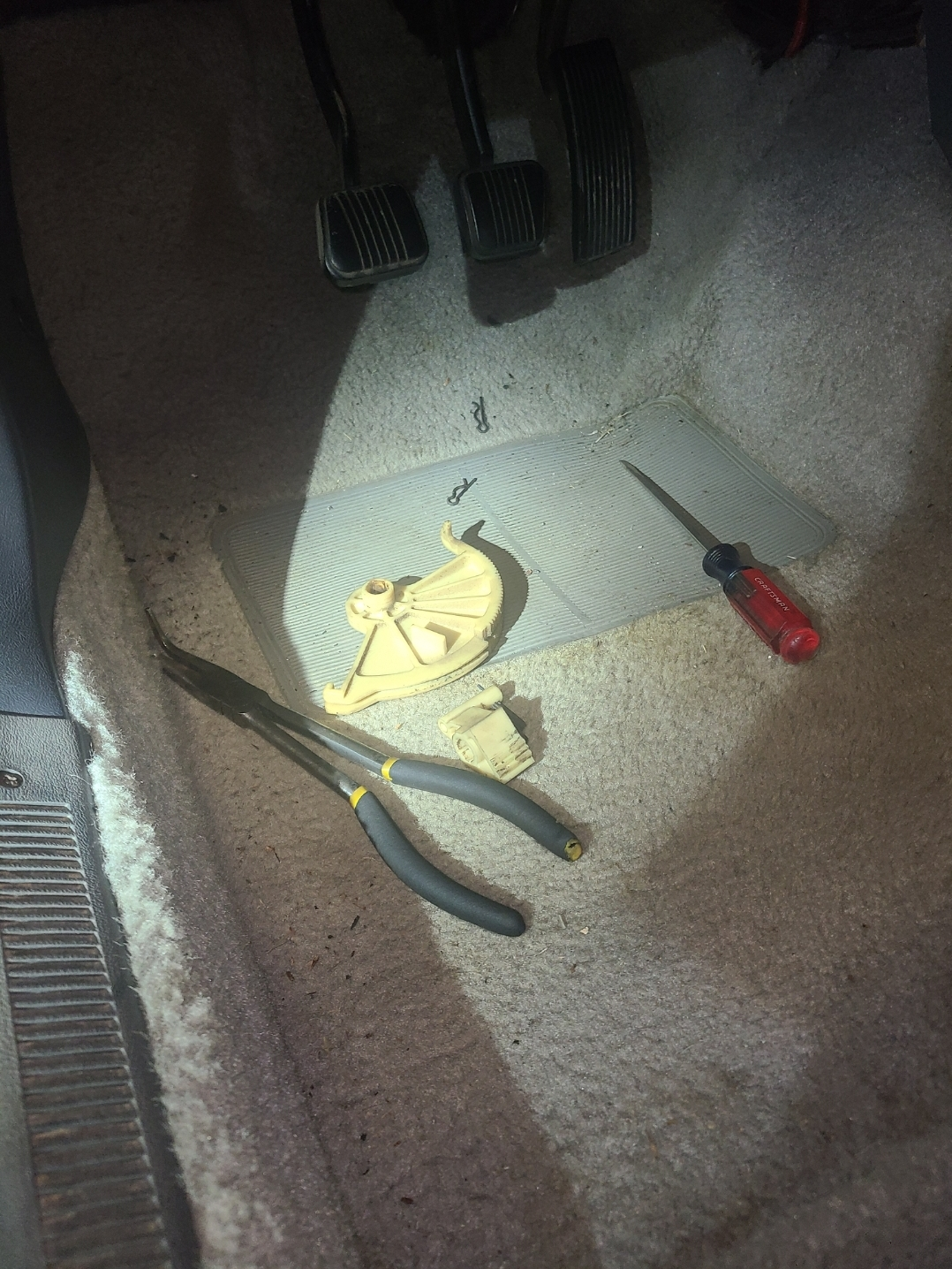

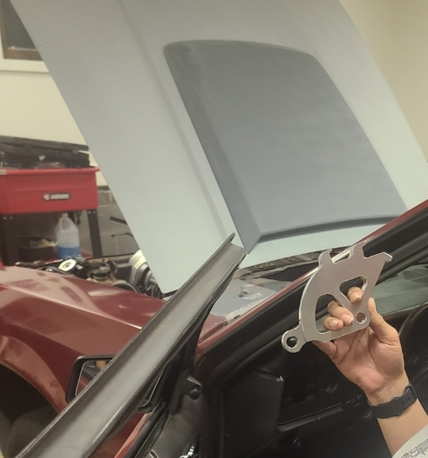

Well I finally ordered it and changed out the clutch quadrant. Feels easier to drive already:rock: Taking her out tomorrow to figure it out:spot:
All courtesy of our son taking pics
Well... We now know which of you is the patient one:
I dunno about the rest of you but mine came out in pieces as I ripped it from the car. :D
Your quadrant looks good but the prawl is FUBAR. [Anything] would be an improvement at this point. :)

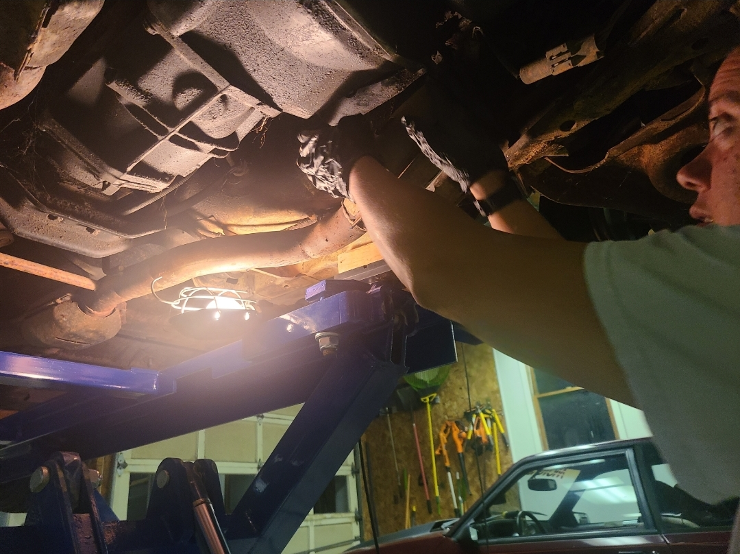

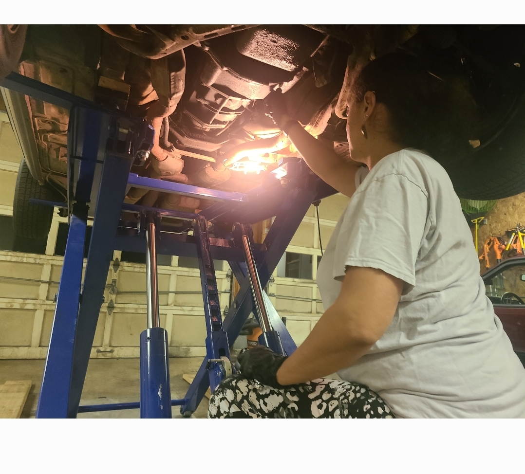

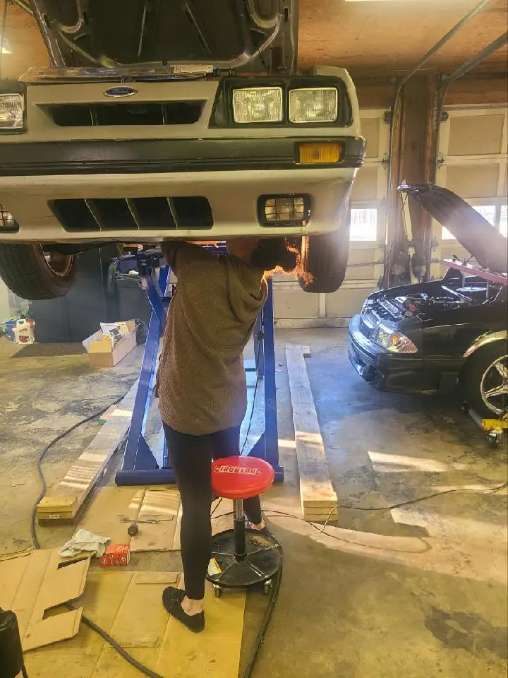

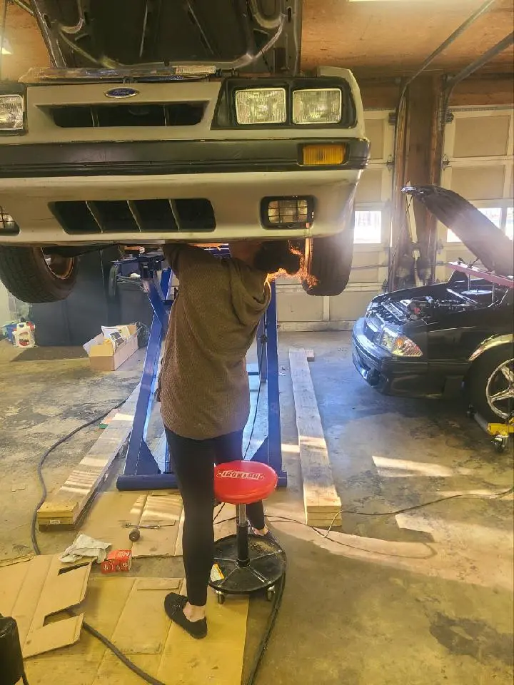

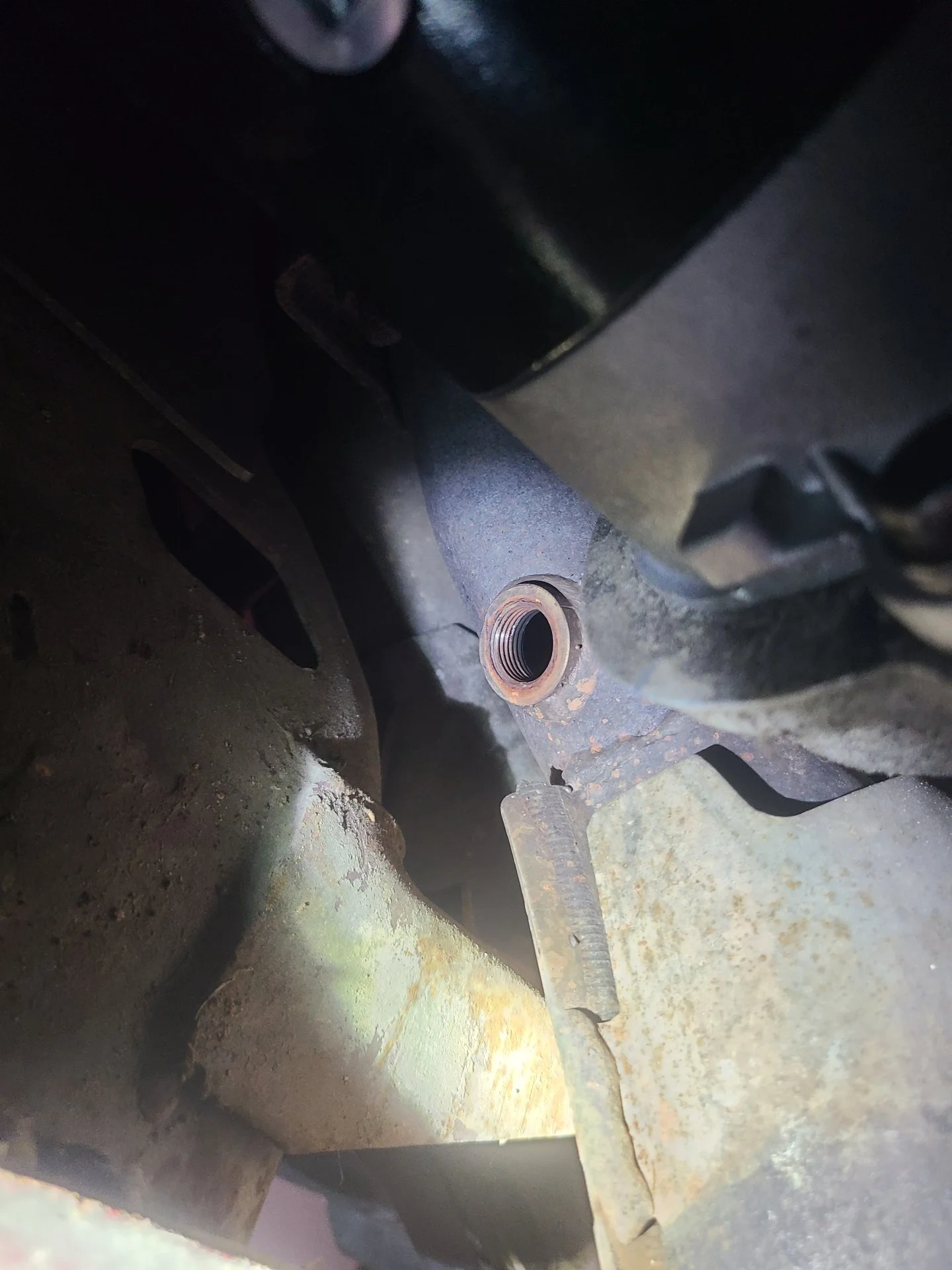

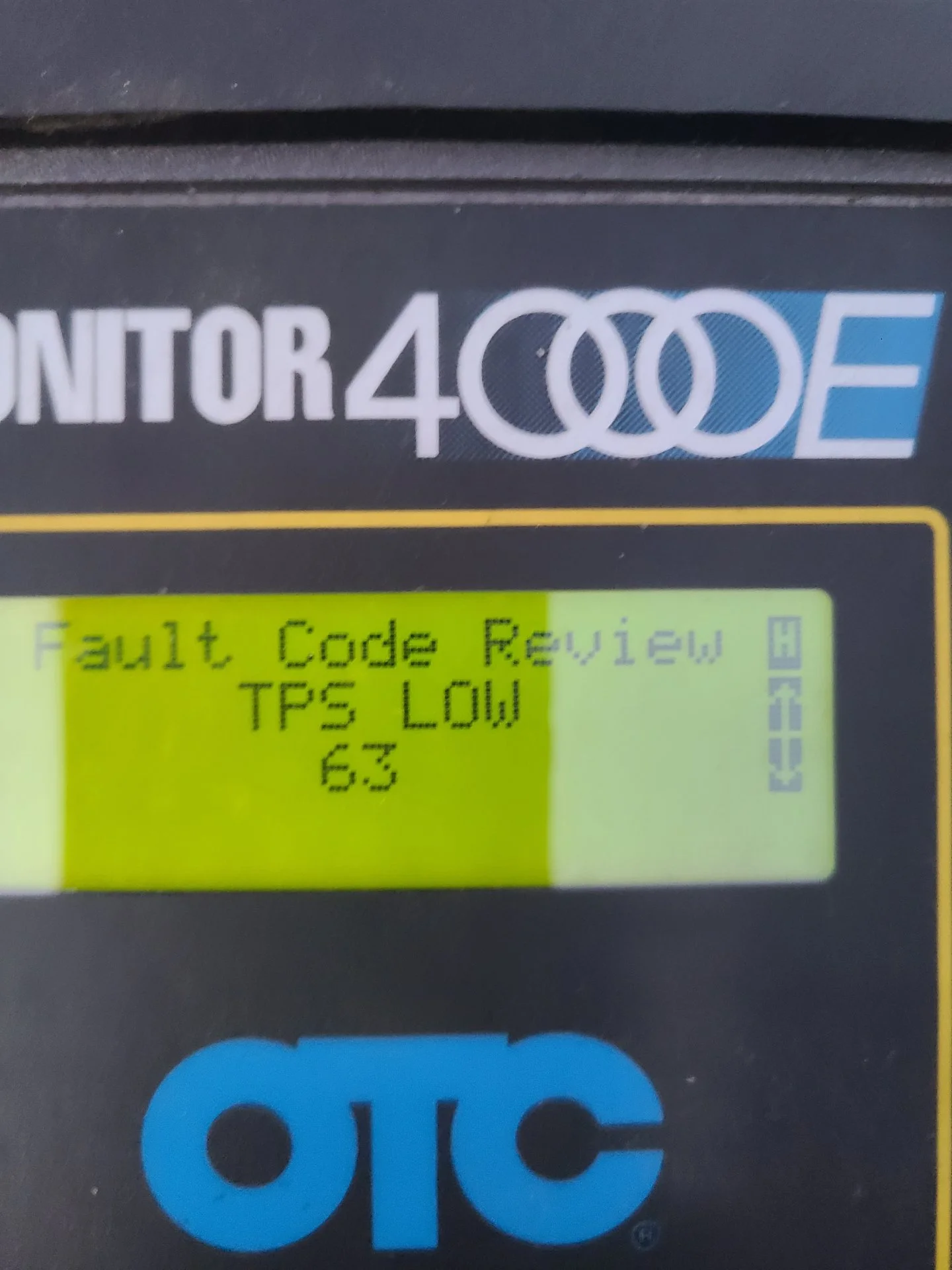

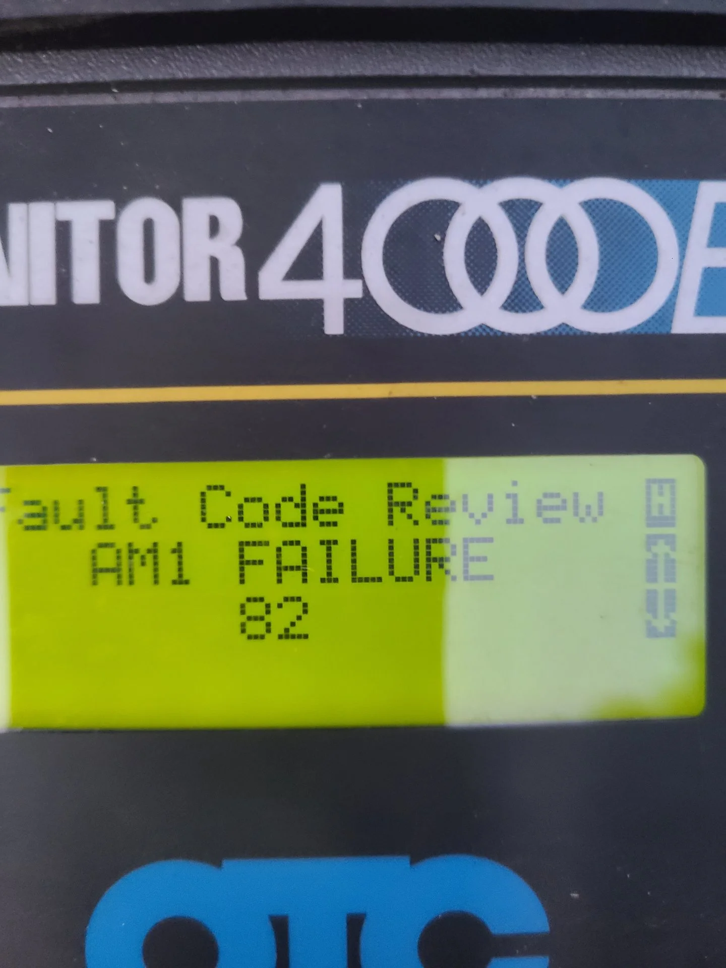

Pulled codes on Scarlet a few days ago. Had a dash issue and a hot restart problem. She's about to get some stuff done on her girl soon.

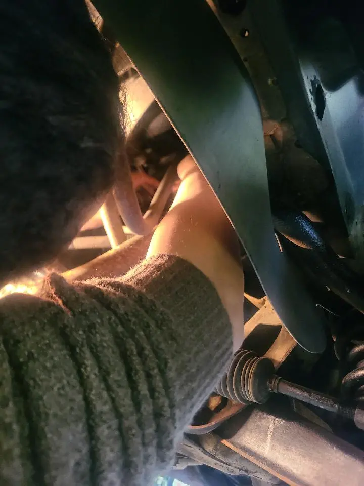

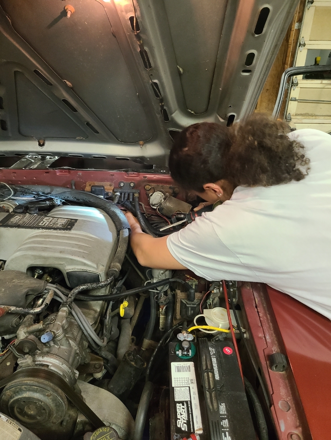

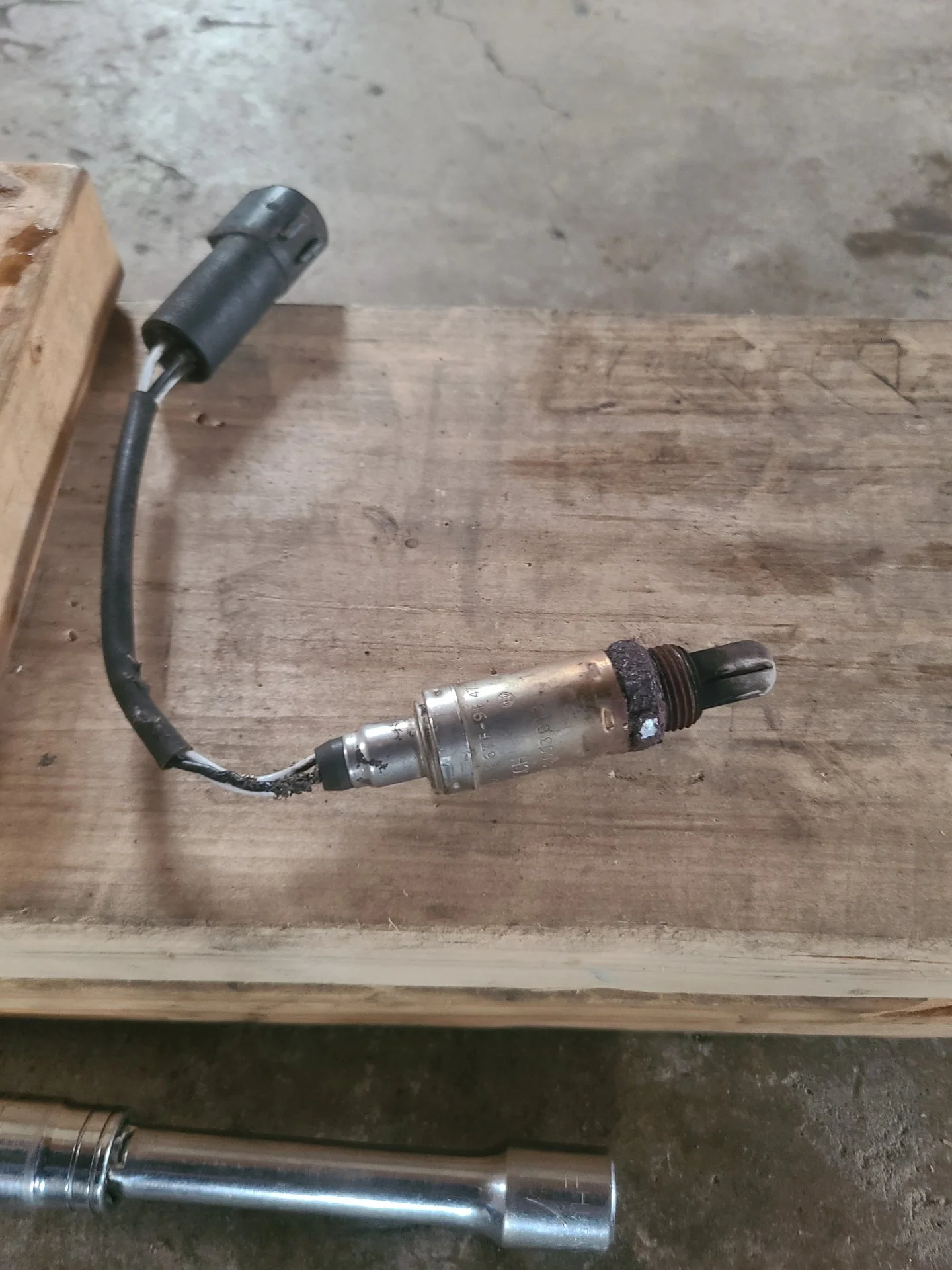

The o2 sensor wire on the passenger side is melted. It's also so rusty the wreck shoulders are completely gone. I've been tasked with that removal. She'll be doing the cluster voltage regulator, fuel level sender, and checking the TPS.
Yall should've seen her eyes cross when we were going through schematics in the EVTM.
Finally got to it...
She replaced the O2 sensor and adjusted the TPS sensor. Got a 11 ( pass ) for KOEO test.
KOER test showed 94 and 44. Guess she'll be pulling the thermactor pipes and cleaning them out when she does the leaky valve cover gaskets.
