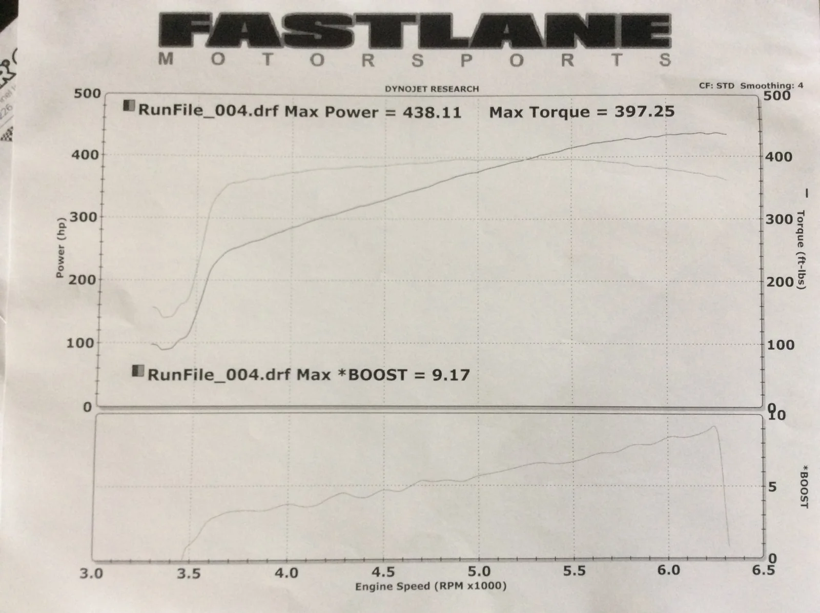

Overall there is no “bad choice”. Centris and twin screw blowers both make good power (my dyno is attached as a comparison). The 2v engine does well with boost and all the blower kits on American muscle or a Kenne Bell will easily put you in your target range. Comes down to user preference and budget.
Awesome numbers!
