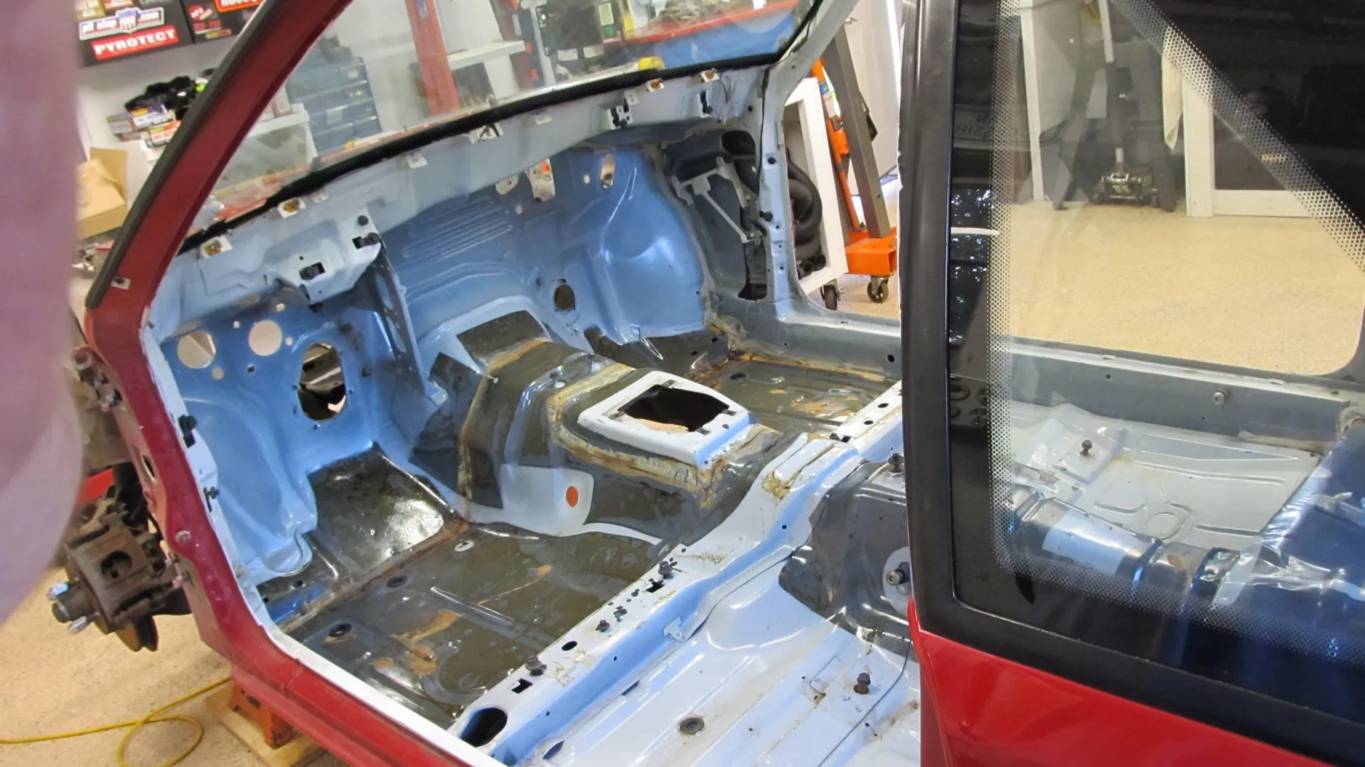

I made my own version of those SF connectors. Only I made mine to attach to the bottoms of the standard sub frames like all normal connectors do, then ran the outriggers to a 1" square bar welded to the floor along the rocker pinch weld. I'm confident that they are far stronger than any single bar connector, regardless of whether or not it was through the floor.So I have the vehicle torn down to the point I felt comfortable with removing the inner fender skirts and getting the floor pan prepped to start cutting it for the through the floor sub frames.

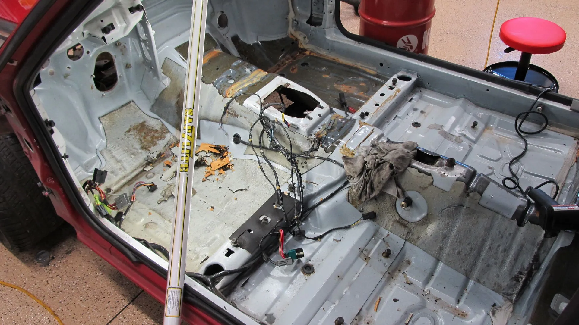

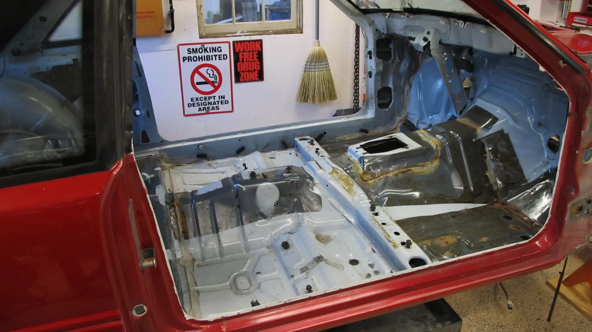

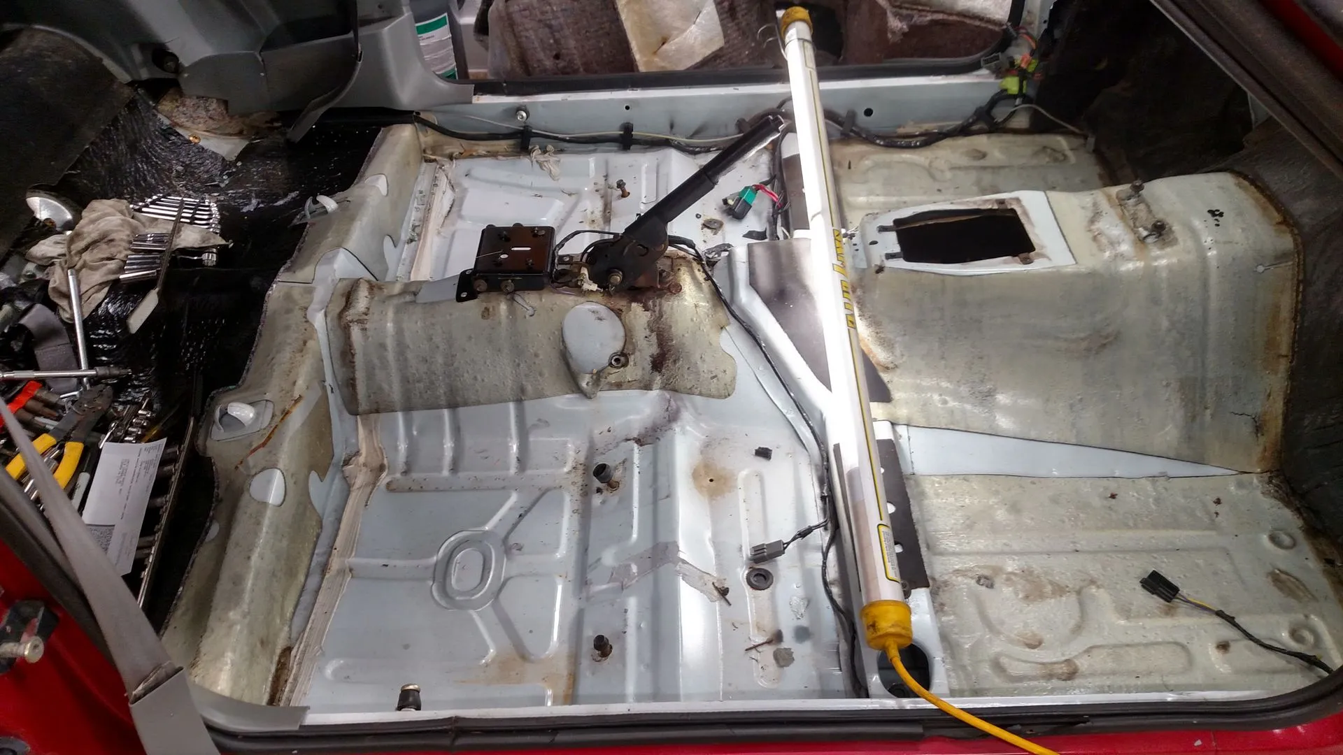

Starting the removal of the sound deadening material. I know the dry ice technique is the quickest, but a heat gun and a scraper seemed to work really well on this old sound deadening. I'm also scraping out a majority of all the seam sealer since I plan on stitch welding some areas of the chassis.
Sound deadening all removed (except for the hatch area which I will get later)

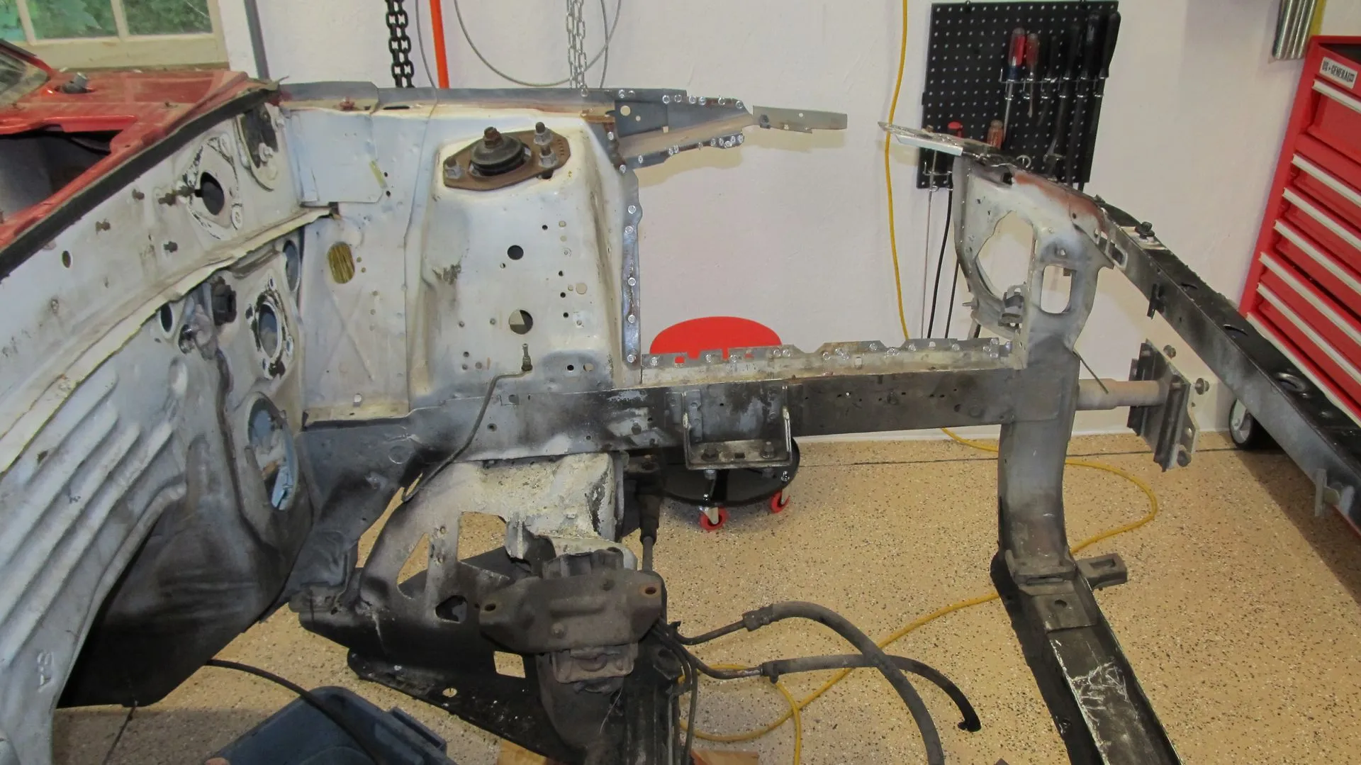

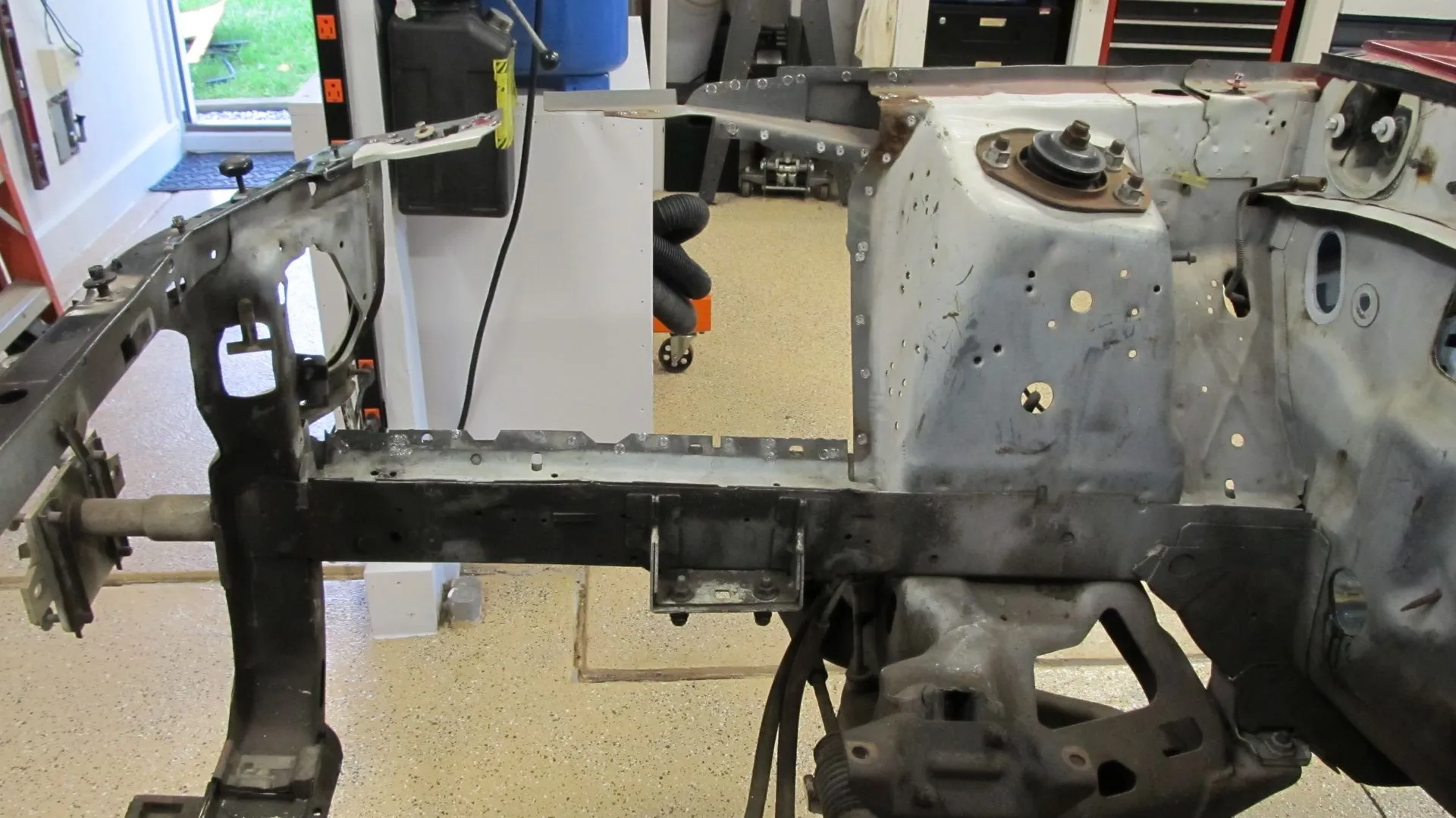

Inner fender skirts all removed. I used almost 4 harbor freight spot weld cutters to do this.
I ordered the LMR smooth inner fenders and all the Scott Rod's panels for the engine bay (shock tower panels, frame rail panels, upper firewall panel, and behind the shock tower panels), so hopefully they will be in within the next couple weeks so I can start welding them in. I still have plenty of prep work to do in the engine bay before that, so I'm not to concerned if they don't show up right away. I'm going to be stitch welding the main structural areas of the engine bay/shock towers while I'm in here, which will also take some time.

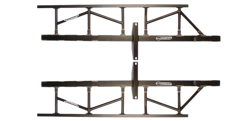

I also need to get to the steel supply shop to pick up all the steel for the through the floor sub frames. Looking at 2"x3" .083 rectangular for the main rail and triangle bracing above the floor, some 1"x1" .083 for various underbody bracing, some 1/8" steel plate for gussets/plates, and some 1" round stock for the triangle bracing from the main rail to the rocker panel. I'm planning on going a little above and beyond what most people do by replicating the picture of the sub frame connectors below into the design. Since this car is going to be seeing some road racing, I want as much lateral support in the chassis as possible. I could do a lot of this strengthening with a cage, but I'm trying to keep my cage design to a minimum since this will also be a street car.
