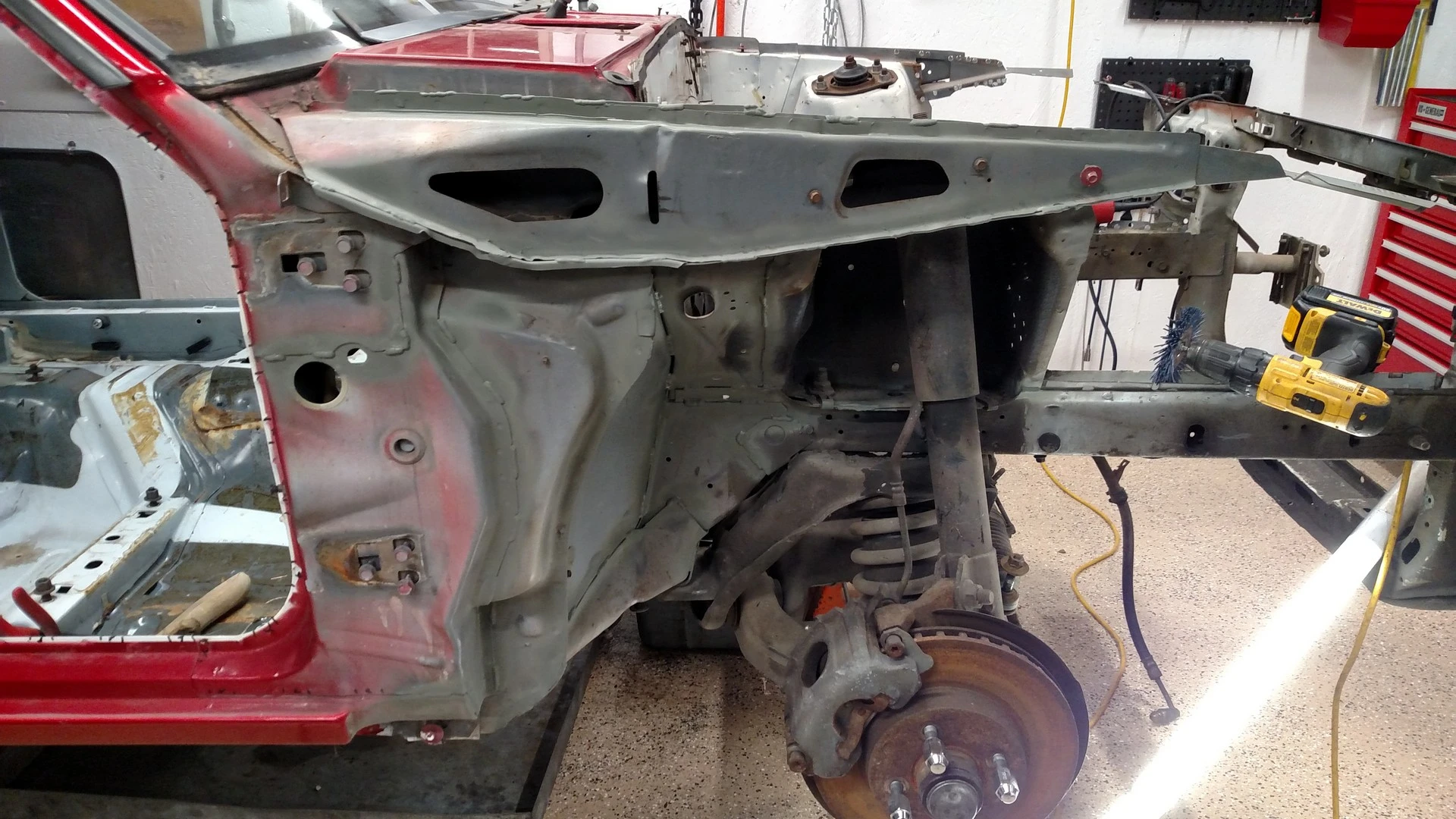

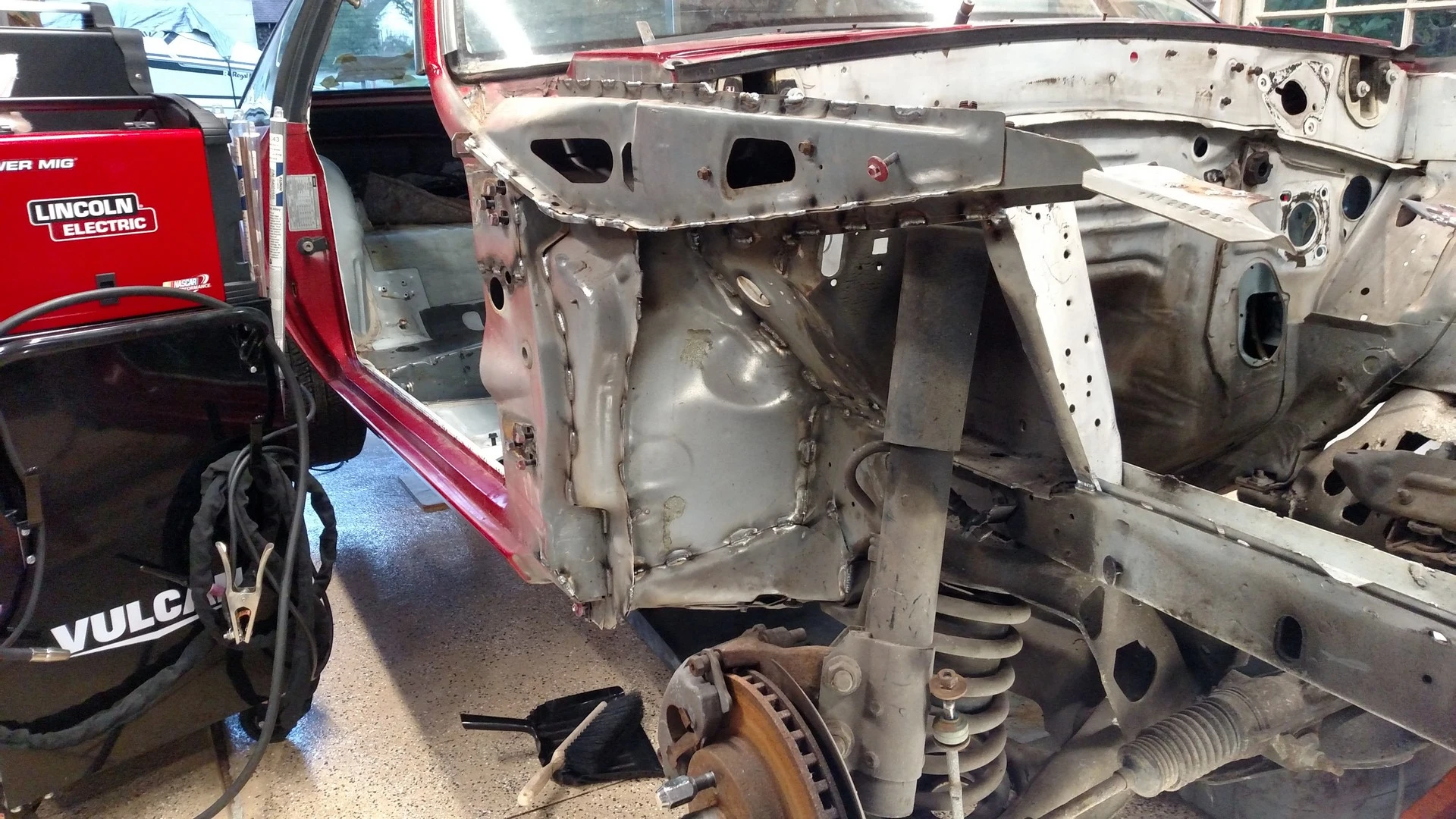

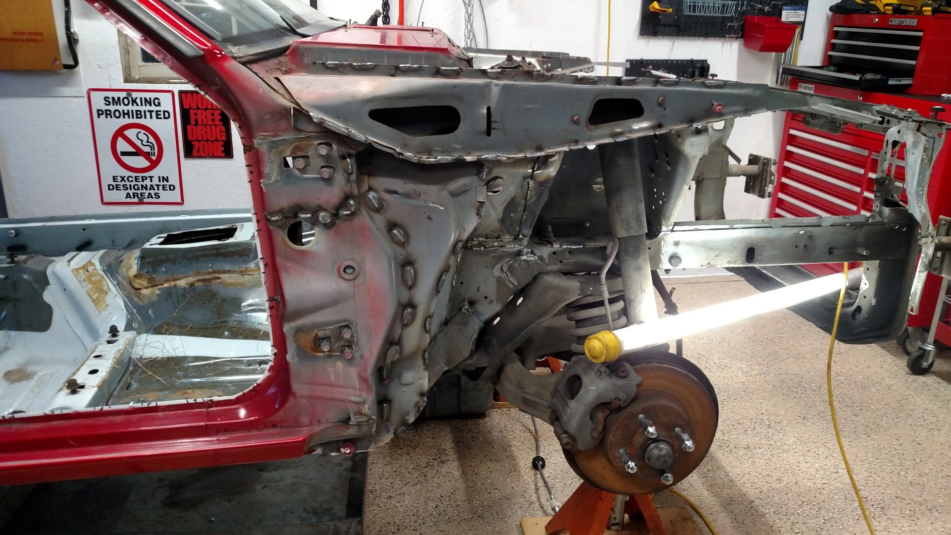

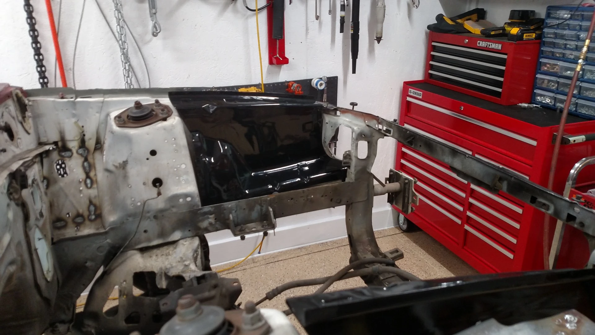

It's been over a month since my last post because work has been crazy busy, but I figure I better give some updates. I've been stitch welding the front half of the chassis most of November but decided to switch gears last week and start working on the subframes. Stich welding gets boring after, oh, an hour, so this will give me a little of a break from that before I get back at it. Lets just say my beer intake has increase with this stitch welding since I have to keep it interesting somehow... Plus, I want to get the main rails of the subframe done so I can get the weight off the suspension. This way I can completely remove the rear and front k-member to keep stich welding some critical areas. I have a lot of pics to post.
Started stitch welding the passenger side first:
Just quick coated the welds after they were finished and cleaned to keep any rust from starting:
I ground down the welds around the pinch weld of the door so the door seal will fit like stock:
That's all the stitch welding pics I'll post for right now. I have both the passenger side and drivers side done, it's pretty much the same process. Grind and clean like hell, close any gaps between the sheet metal with a hammer, weld, get pissed off because no matter what you do there is always still dirt in the weld and they turn out :poo:ty, repeat.

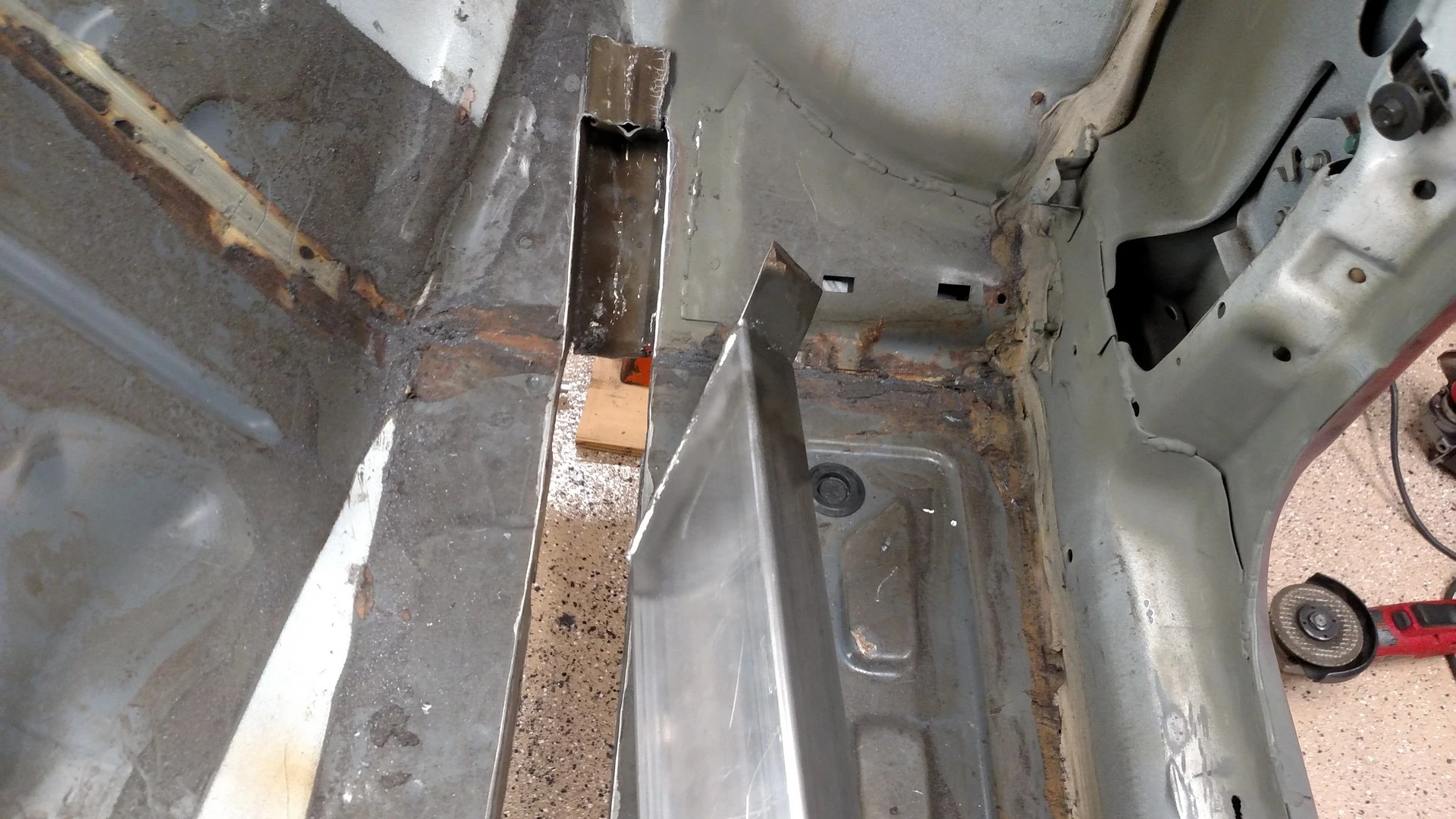

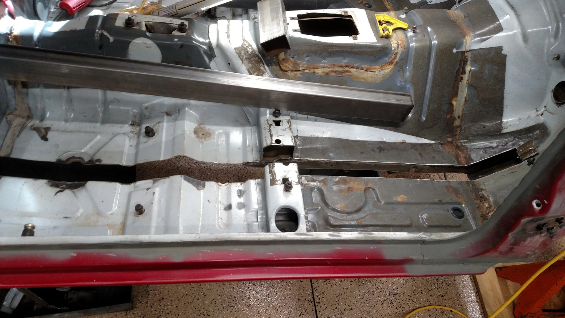

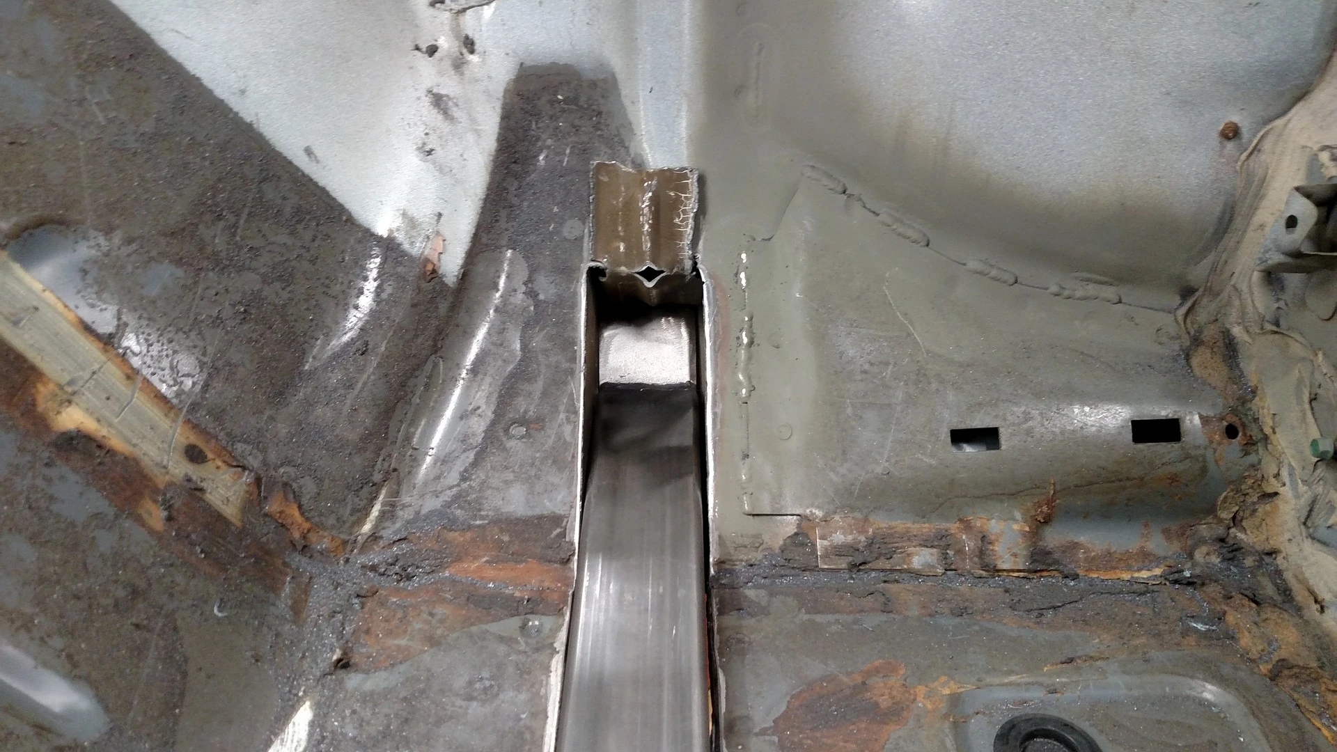

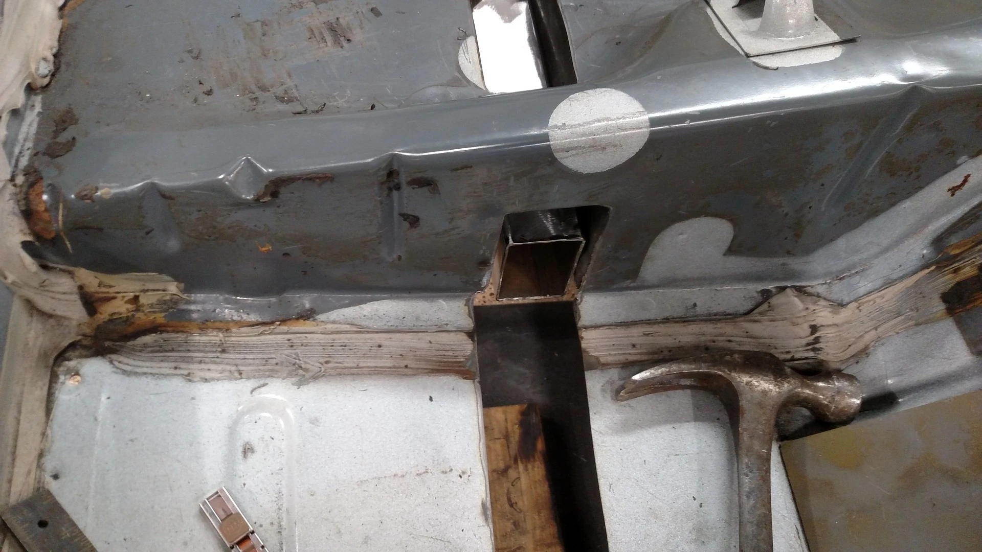

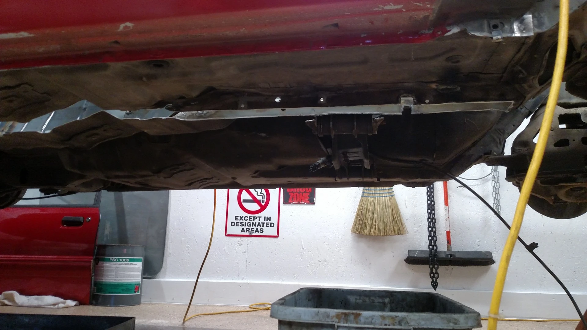

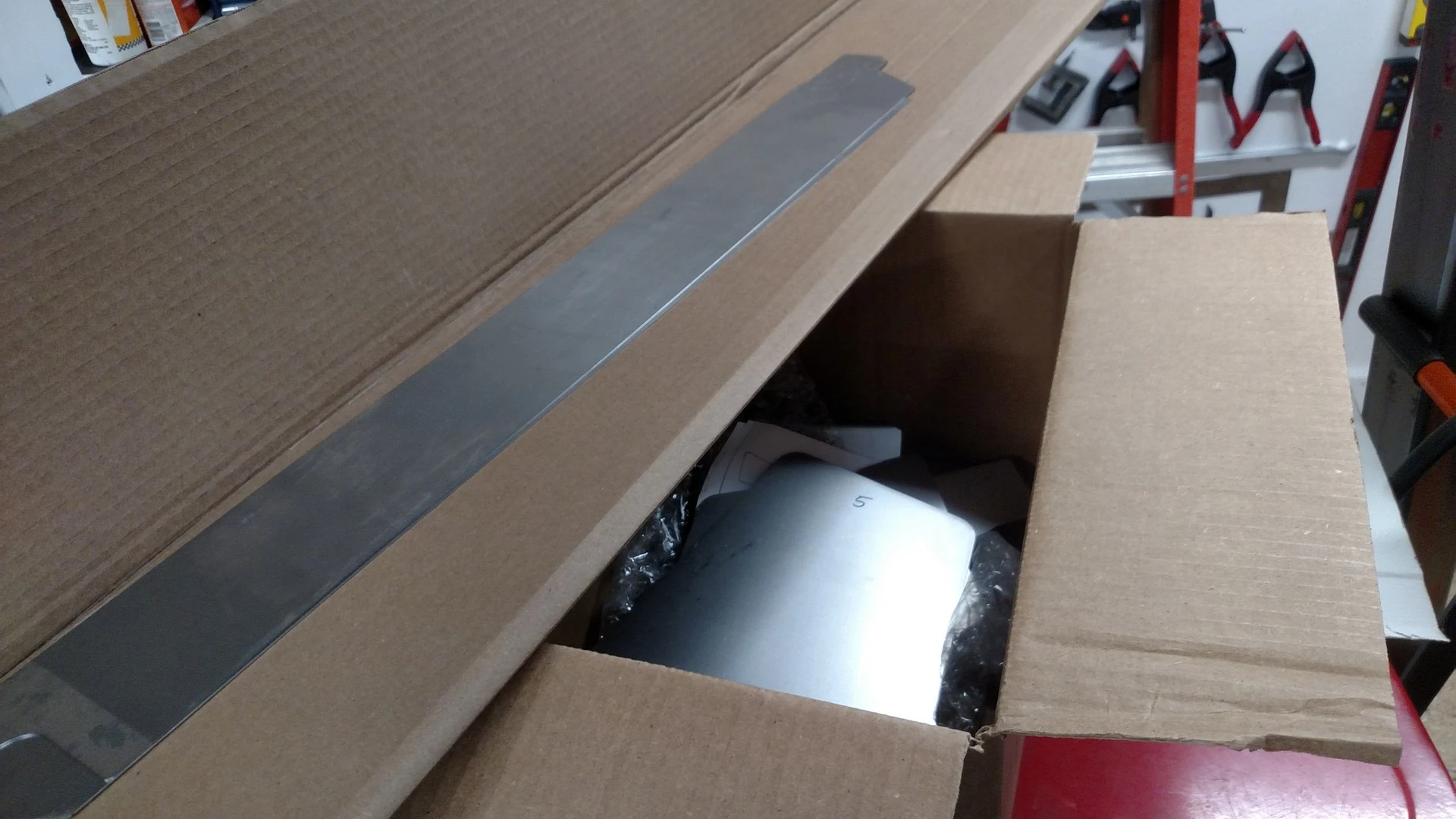

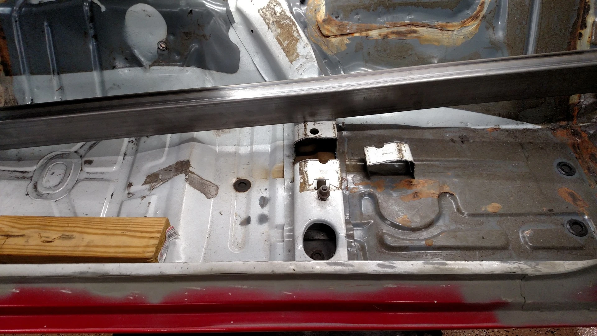

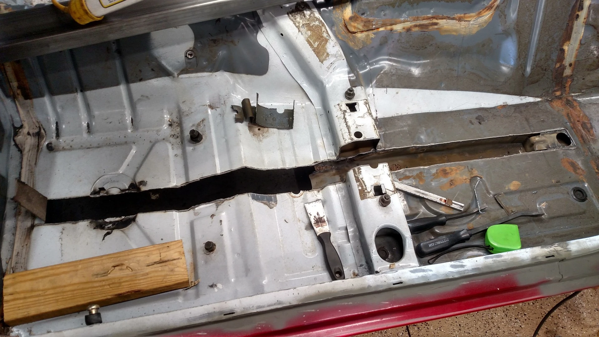

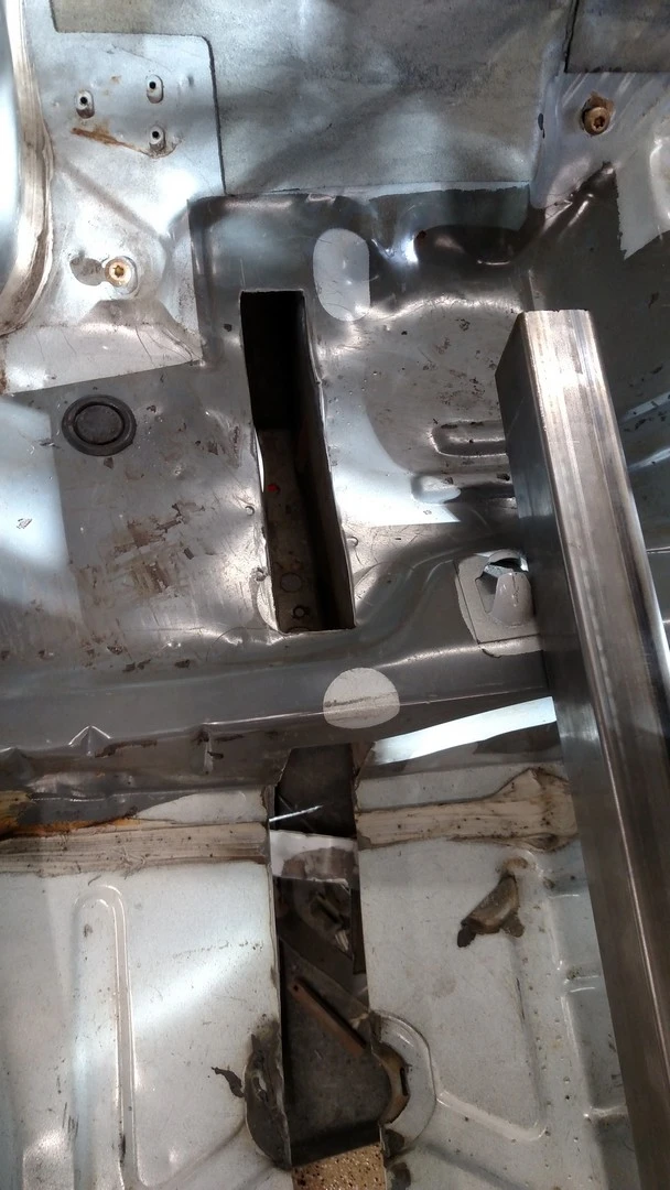

Started the passenger side subframe connector. Just getting started with cutting the floor and getting my bearings as to where I want the rail to go. This rail is .083 2x3 rectangular steel tube.
I want the main rail to get as deep into the front subframe and rear subframe as possible.

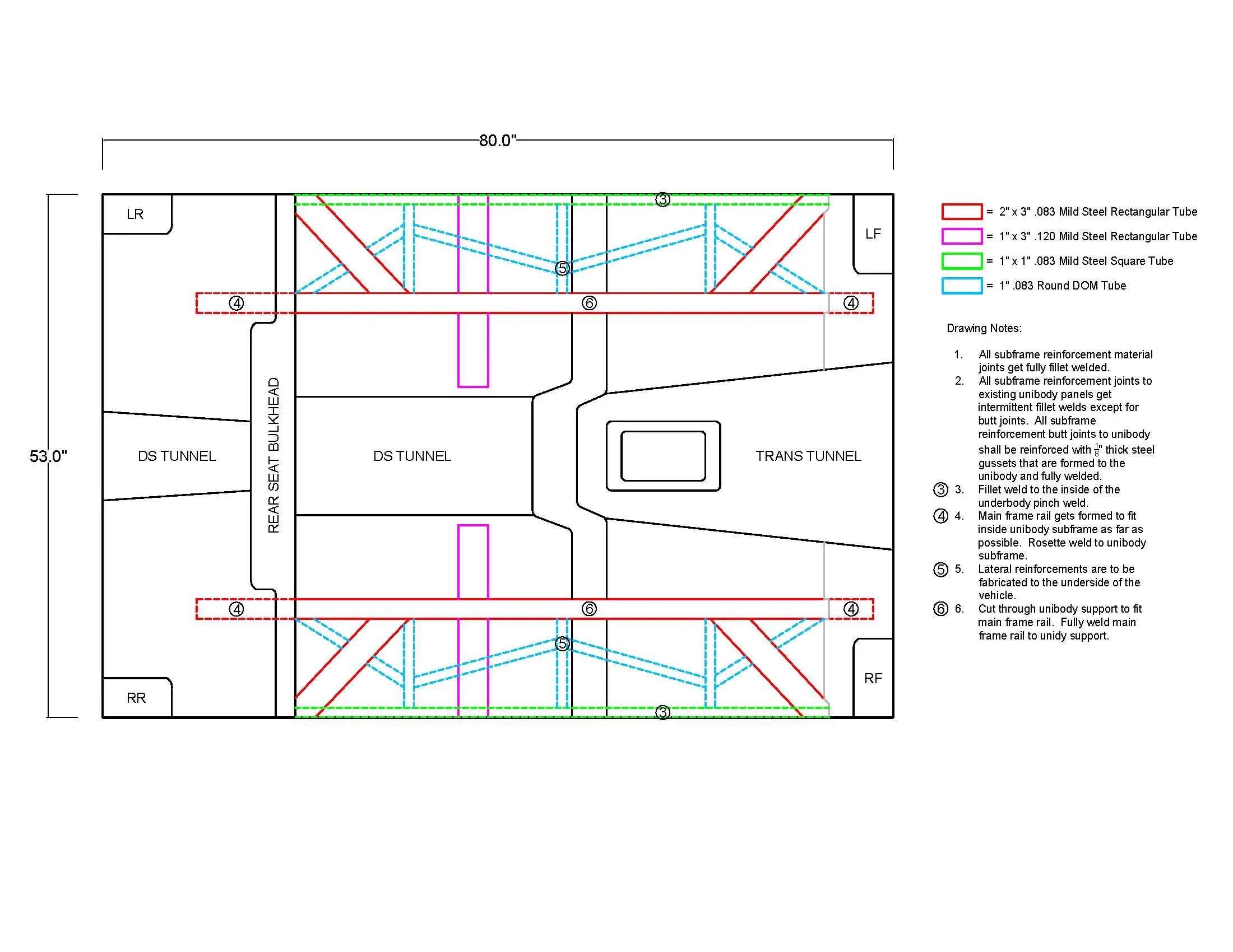

So at some point during the month I decided to CAD the subframe connector setup I am looking to do. This is just a rough CAD drawing to generally show what I am going to do and what pieces will be needed. I plan on updating this as I go with the actual dimensions of how I cut and welded everything , just to keep track of what I did. I'm anal like this.

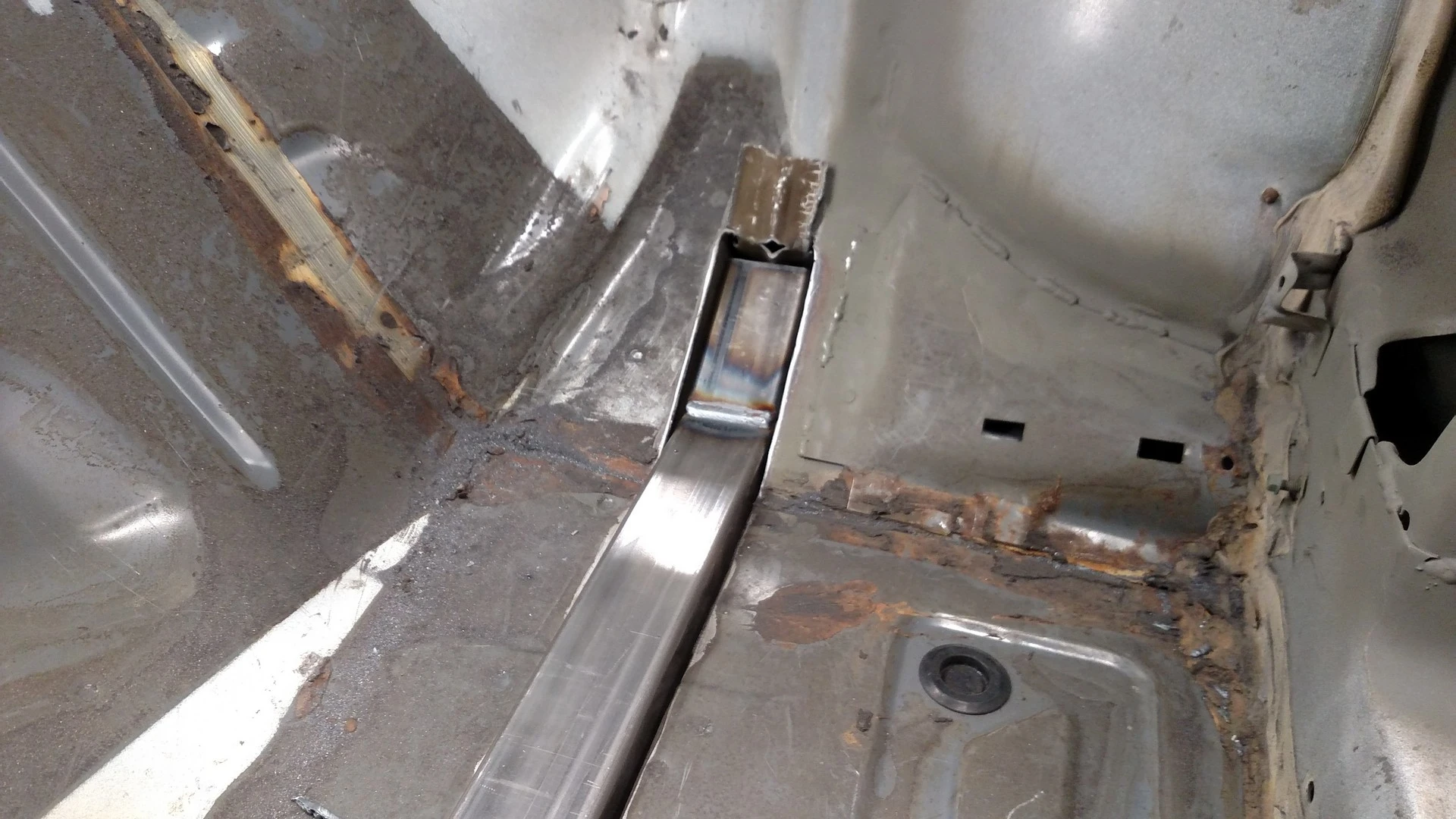

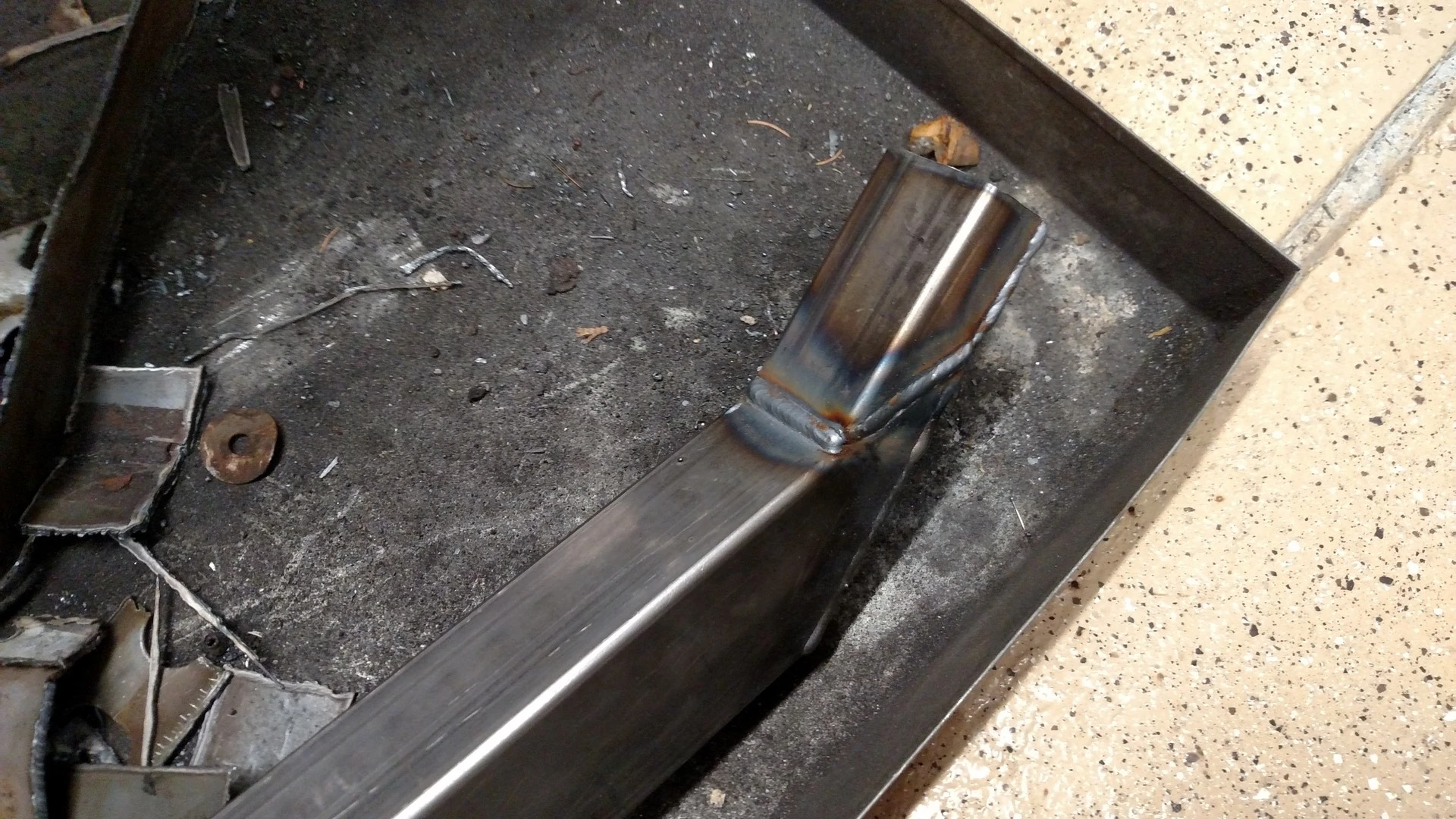

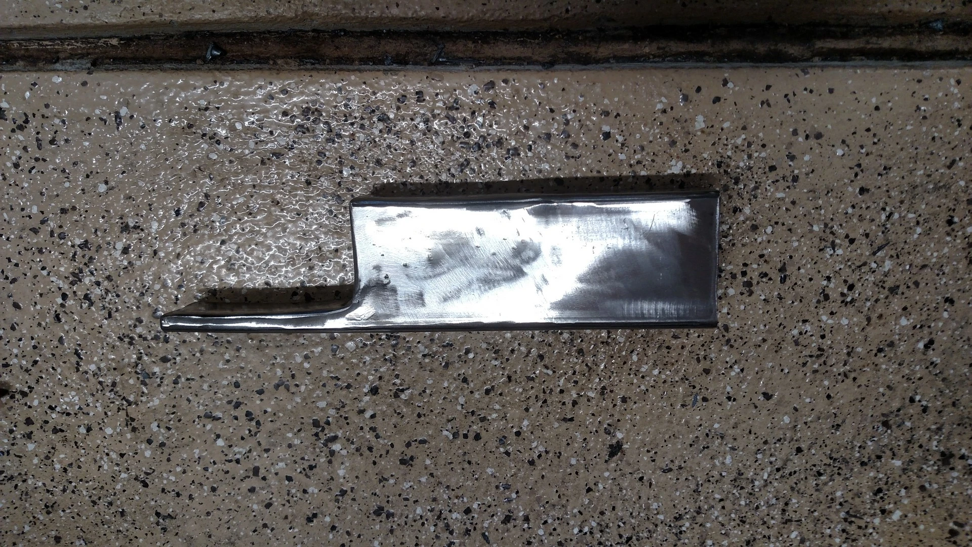

Here is the front of the main rail that I profiled and boxed in to fit up into the front subframe.
I slipped with the plasma cutter a little and kind of boogered up the rail here. No biggie, after I hammer that piece hard against the new subframe and weld it, you'll never know.

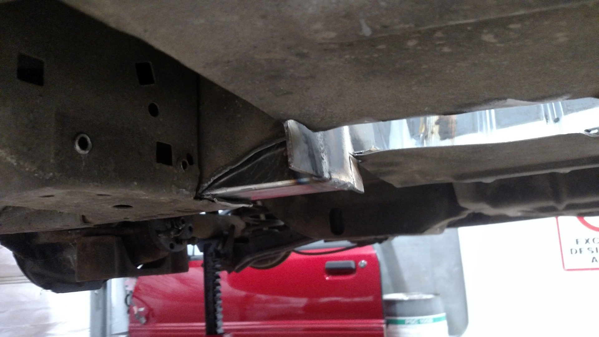

Finishing up the front of the subframe. Added some support here so the tab I had to bend up and out of the way can be bent back and welding in.

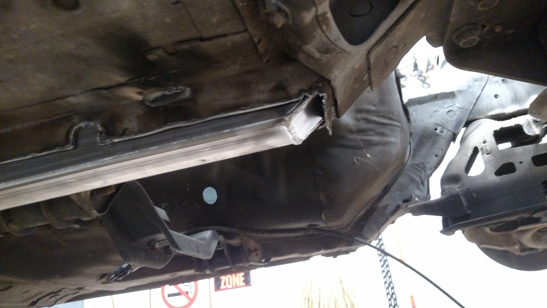

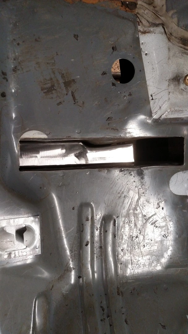

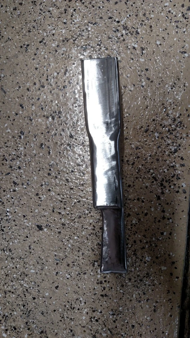

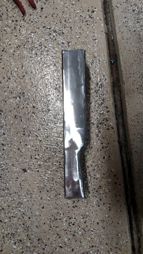

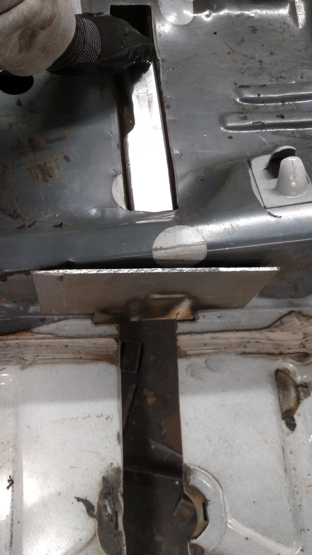

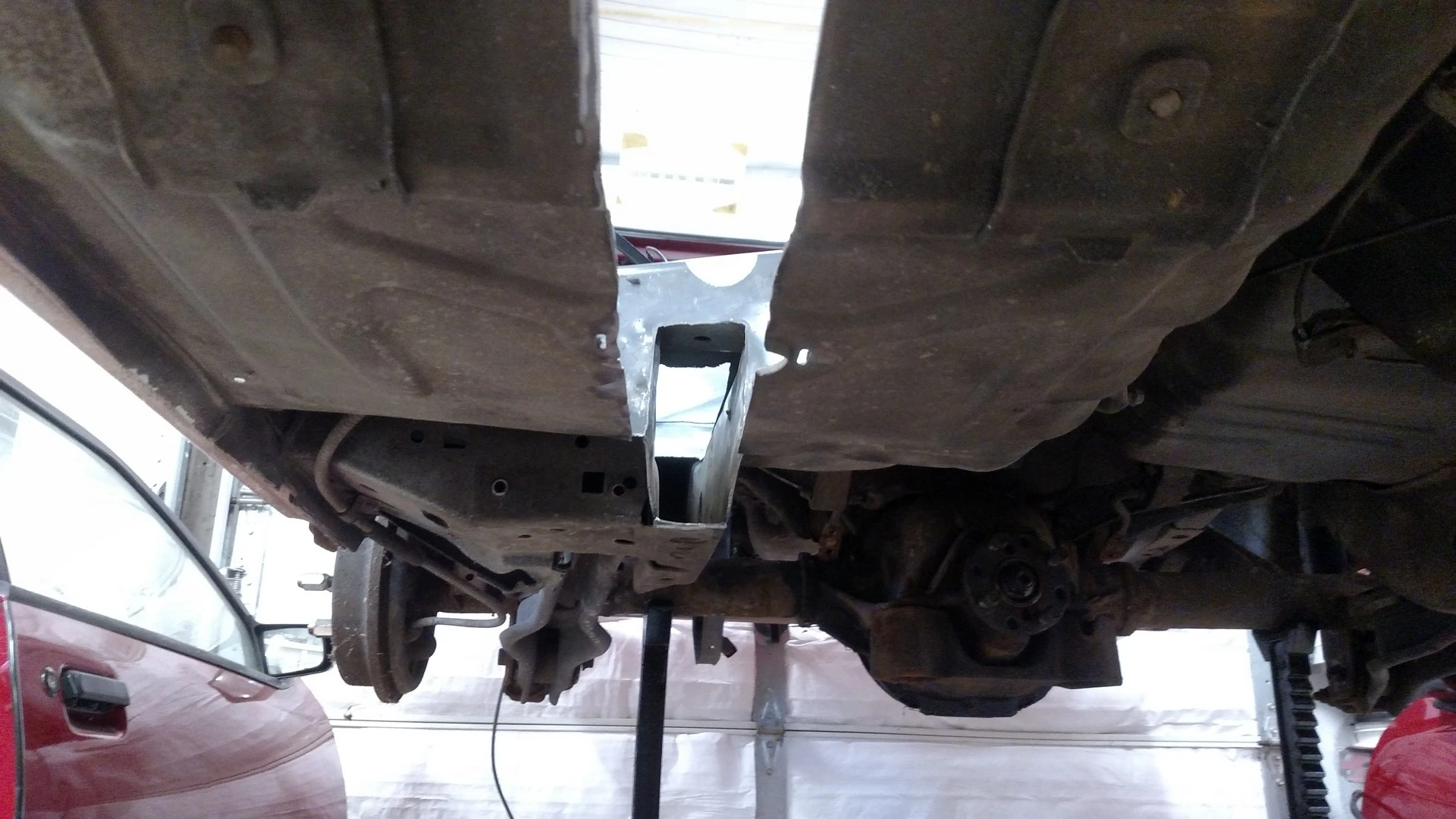

So I had wanted to make the subframe connector out of one solid 2x3 piece but quickly discovered that was not possible with what I wanted to do. So I decided to make the main subframe rail out of two pieces and join them together with a 10 gauge plate at the rear seat bulkhead area. I had planned on plating the subframe to the rear seat bulkhead anyhow, so this ended up working out great. I had to cut, weld, hammer, and bend the rear subframe rail to fit since the rear subframe opening is not perfectly straight, tapers in at the bottom, and I had to keep access to the rear lower control arm bolt. I want the rear subframe rail to go in as far as possible because I plan on tying the torque box reinforcement into it.
Here's how it fits in the rear subframe.

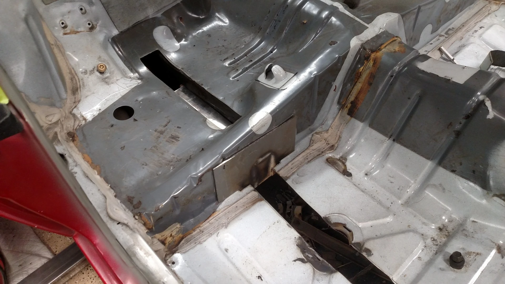

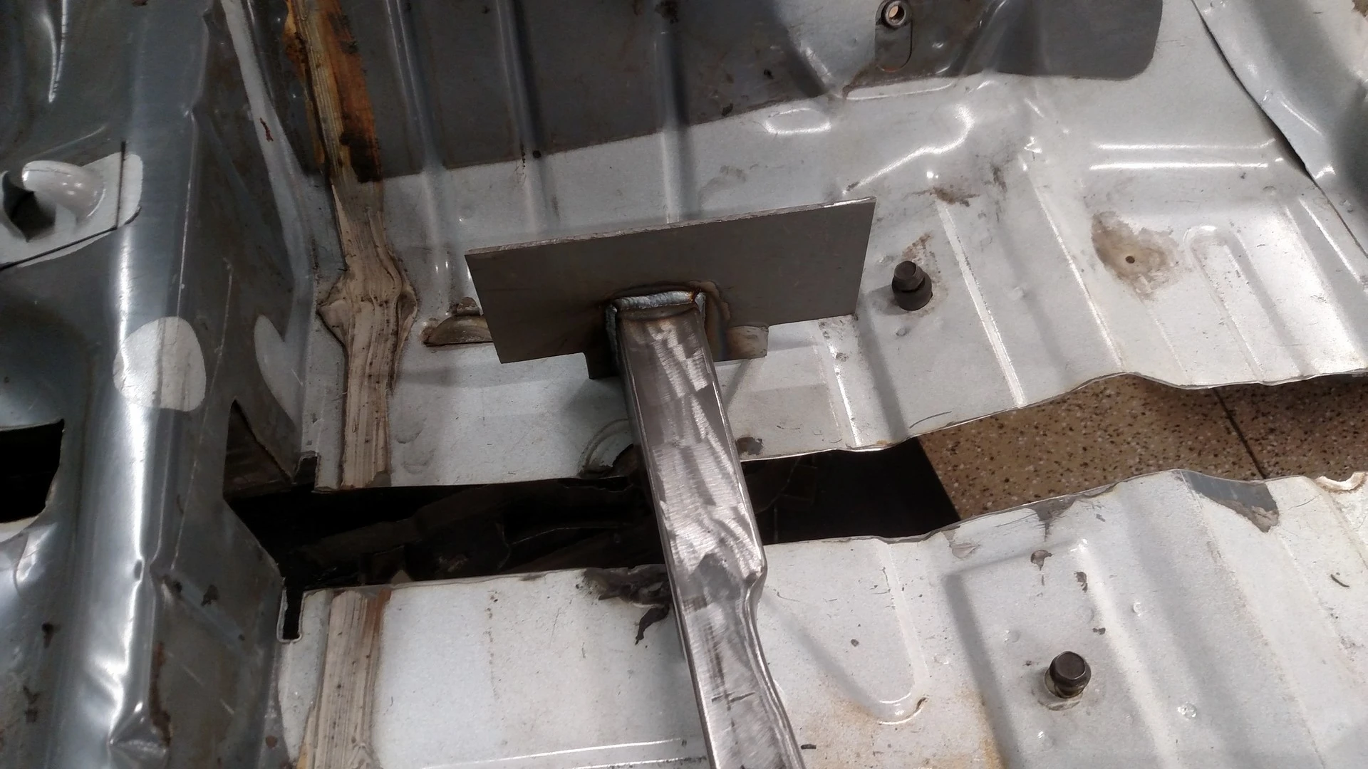

Here is the plate I am talking about. In this pic I already have it welded to the rear subframe rail. I will weld this to the rear seat bulkhead once everything is fitting 100% and everything is ready to weld. I was able to keep it proportioned where I can remove the rear subframe rail and the plate together as an assembly. Then I will just fit the main rail to the plate and weld away.
