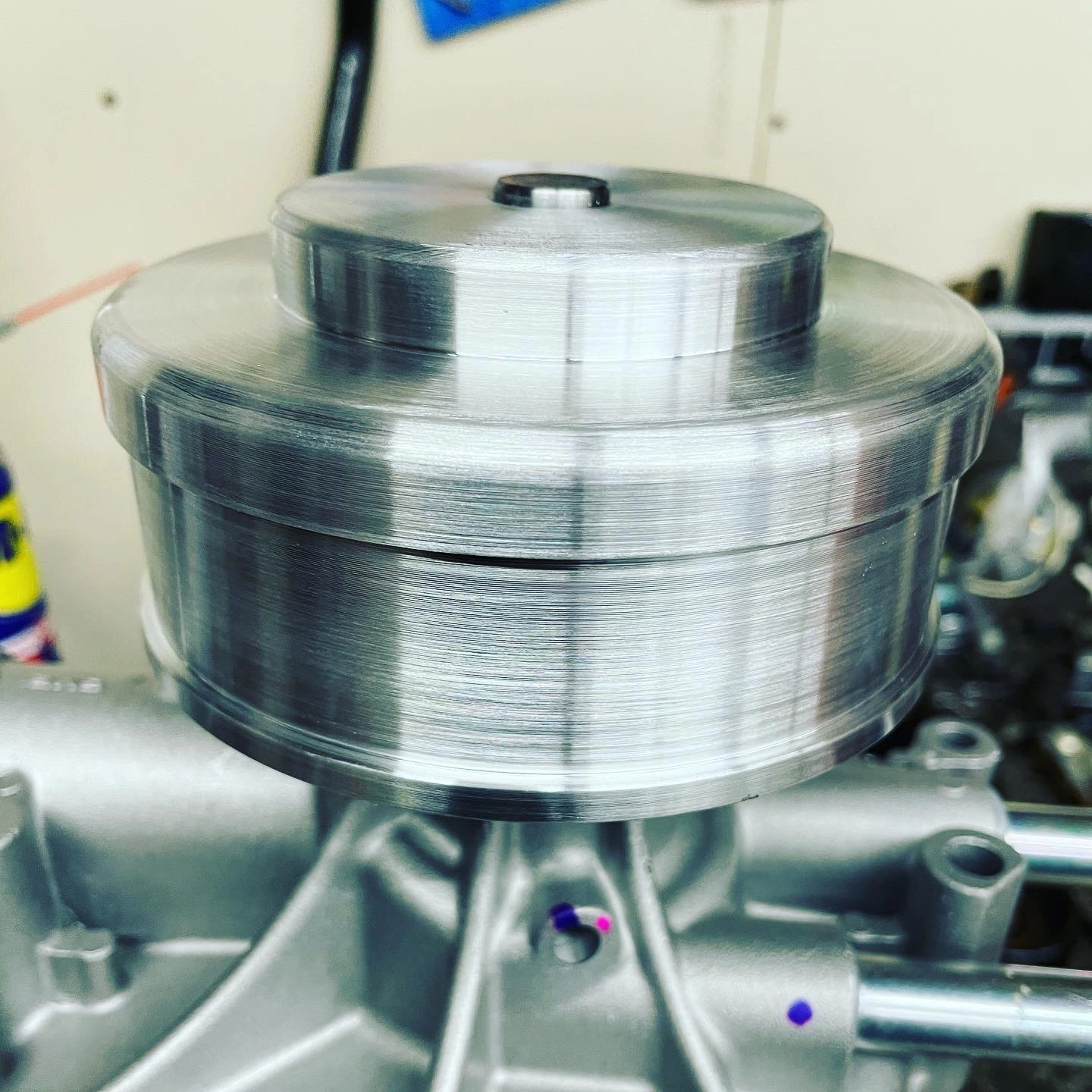

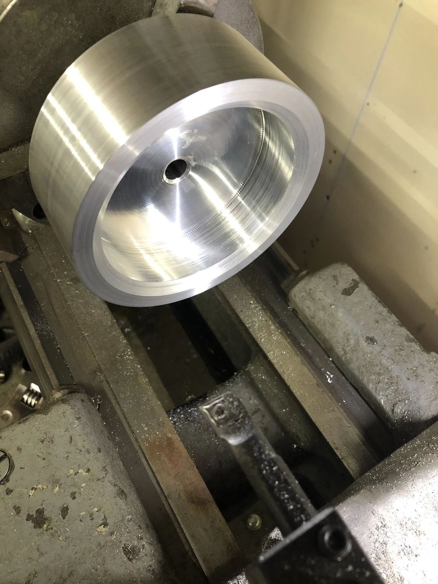

Can you guess what I’m doing?
ya I’m not happy with the water pump pulley so I’ll make my own.

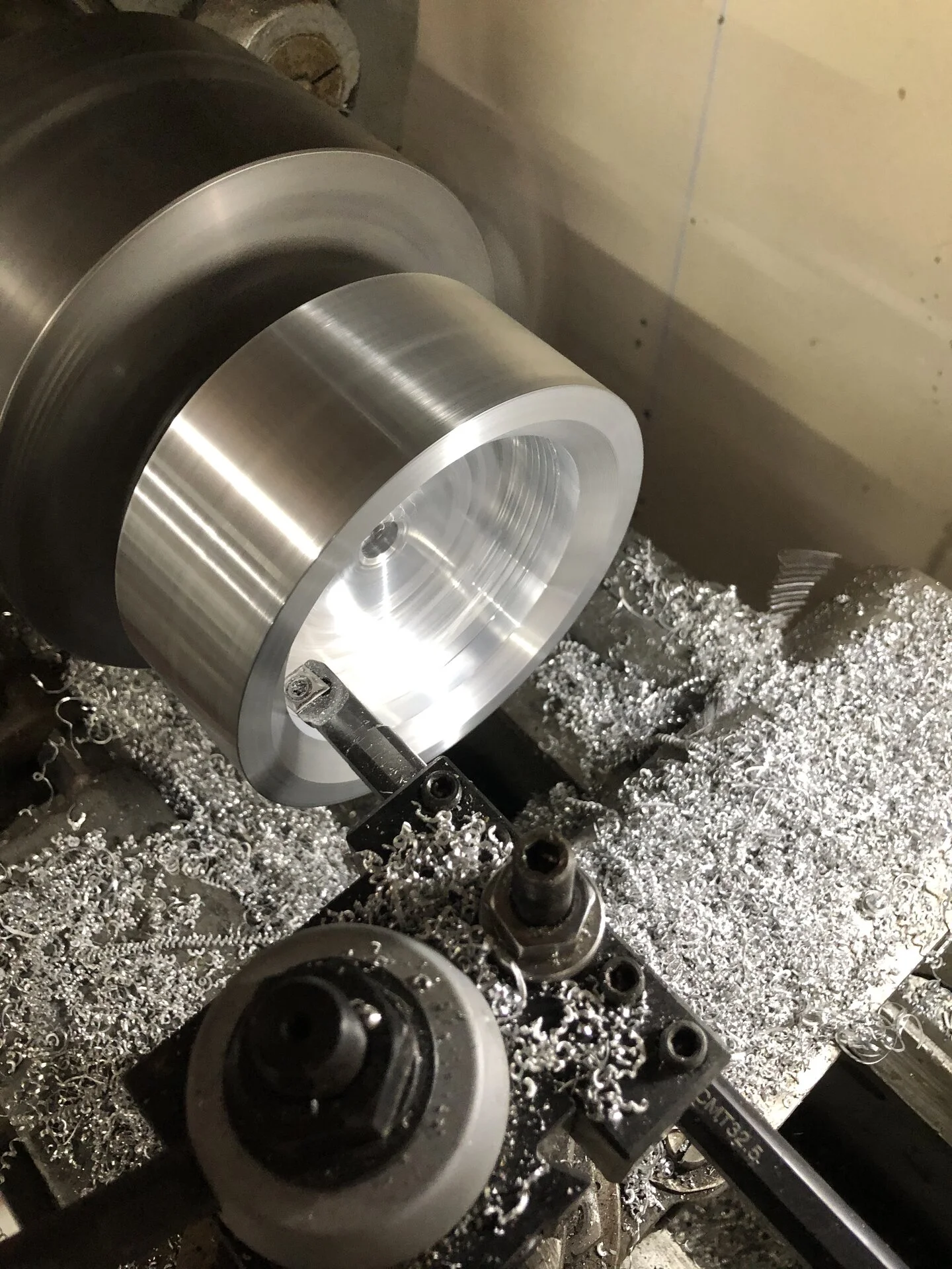

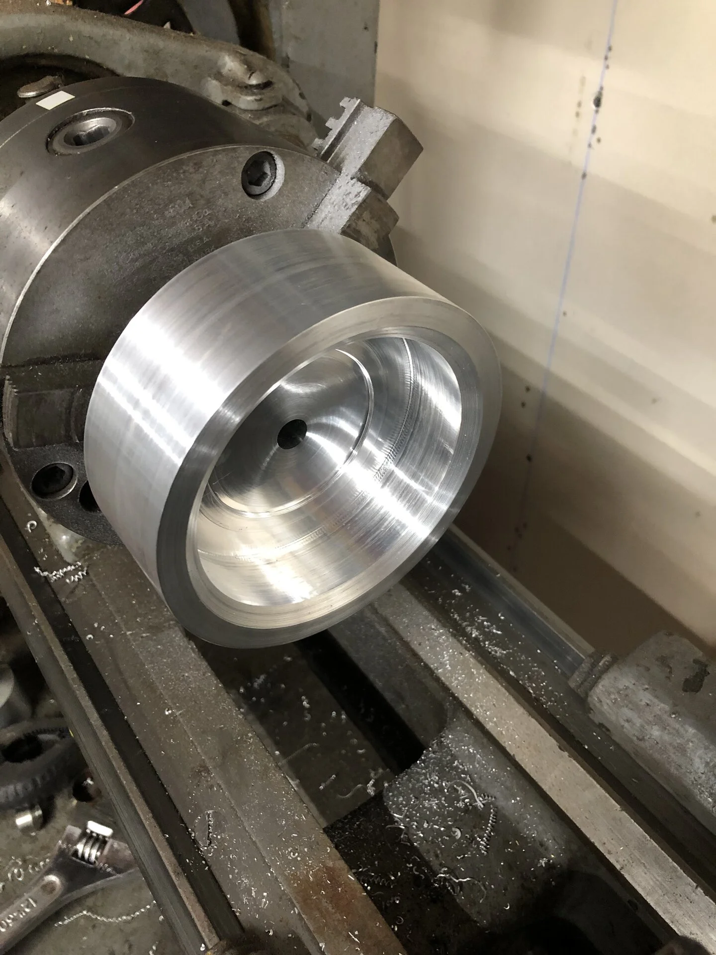

At home. I have a mill at my brothers house too. I worked at a machine shop way back when I was in my early 20s. I’ve always enjoyed it. I’m no expert but I get by.

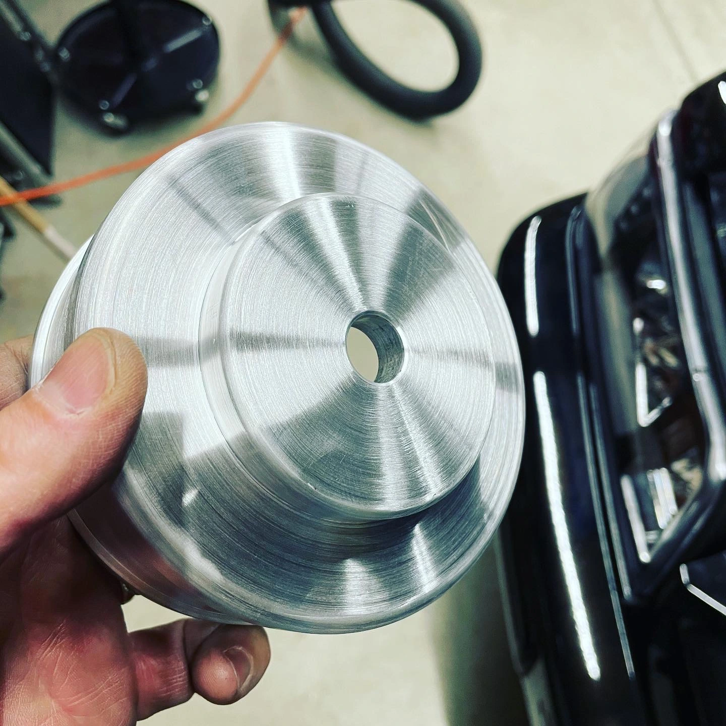

Worked on this off and on today. Got it roughed in. Now I have to make more precise measurements.

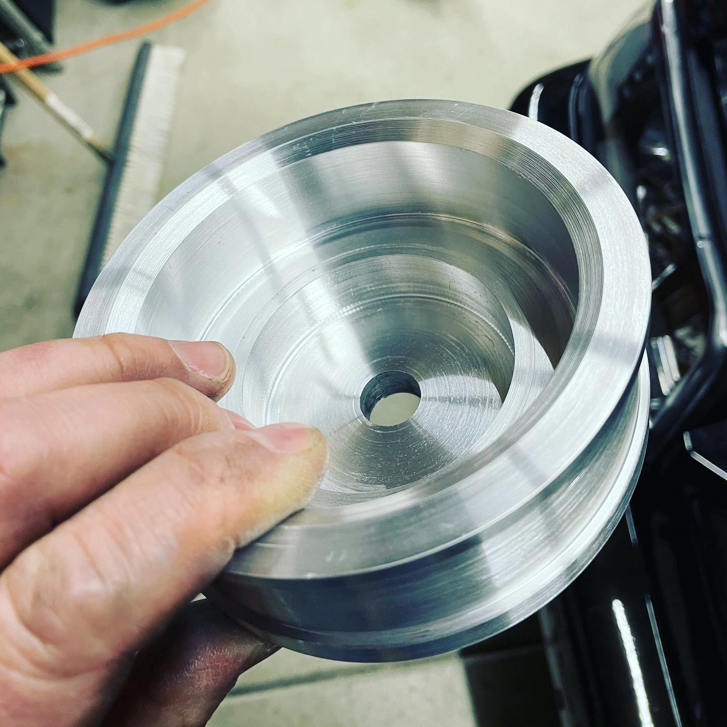

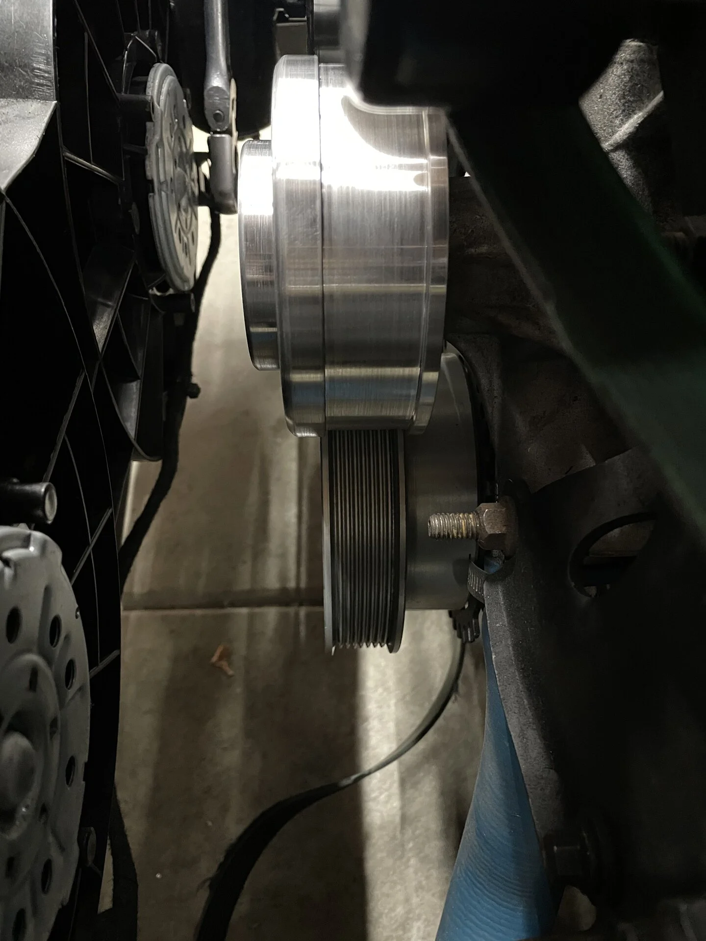

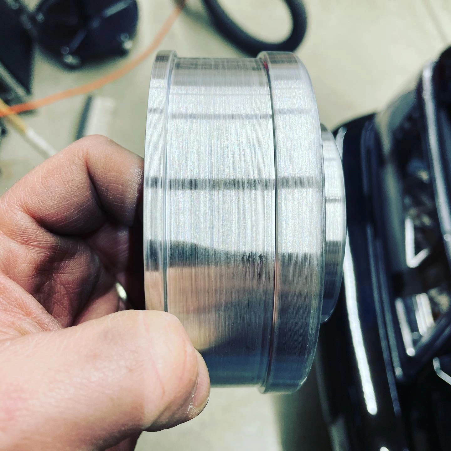

Just about done. It’s a bit hefty. Might trim some more material off. Still need to drill holes. I might take it to get anodized.

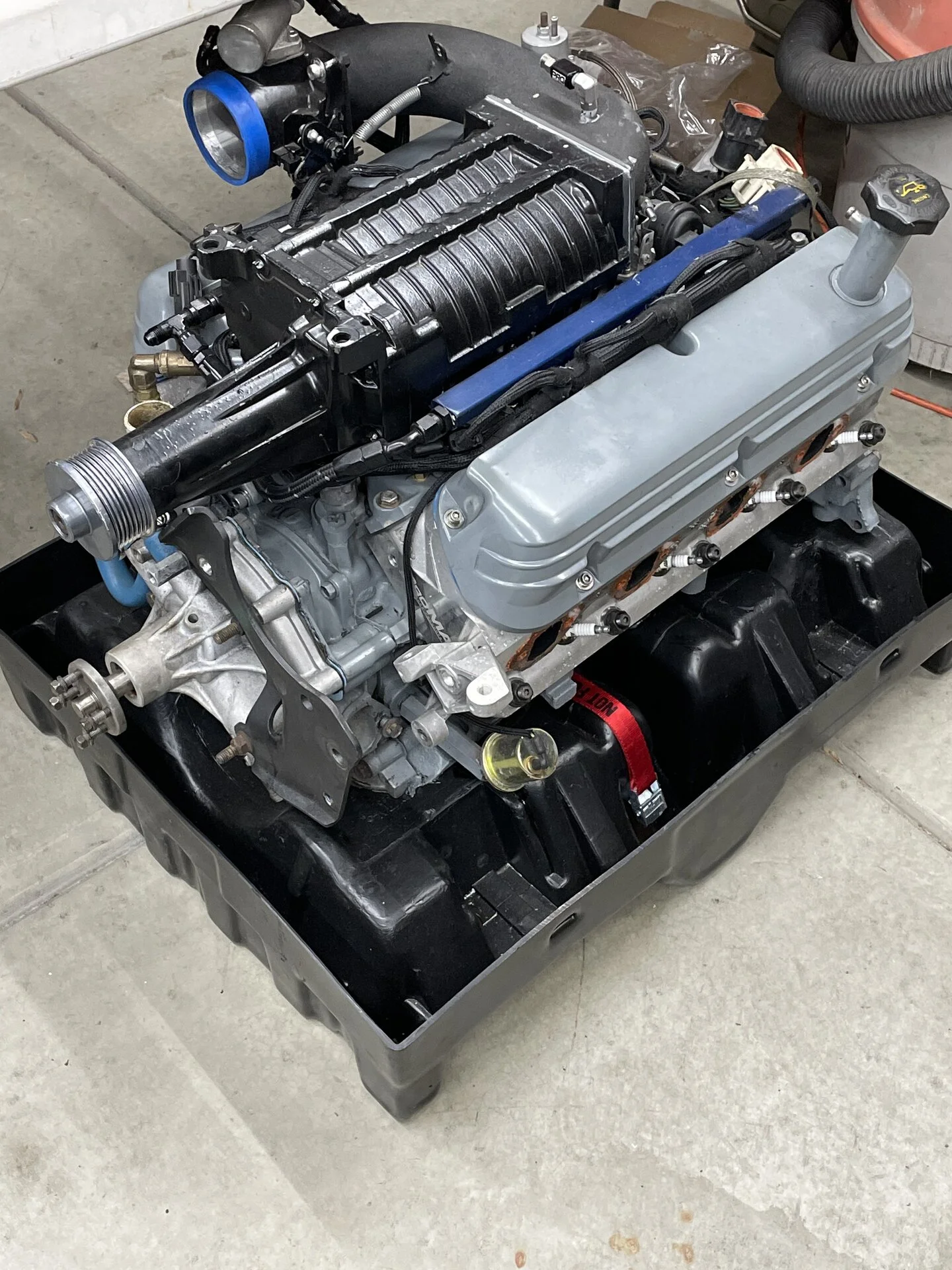

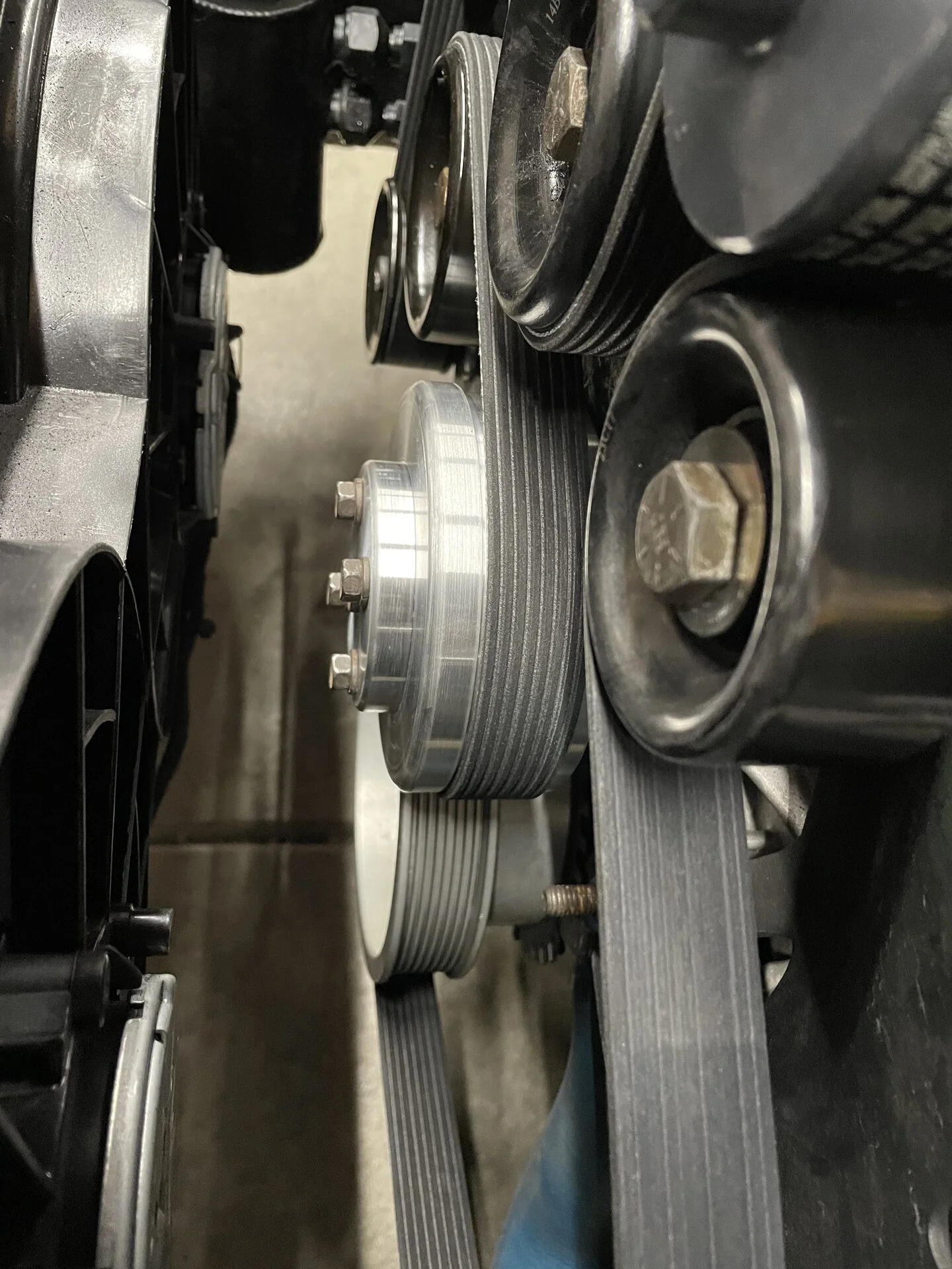

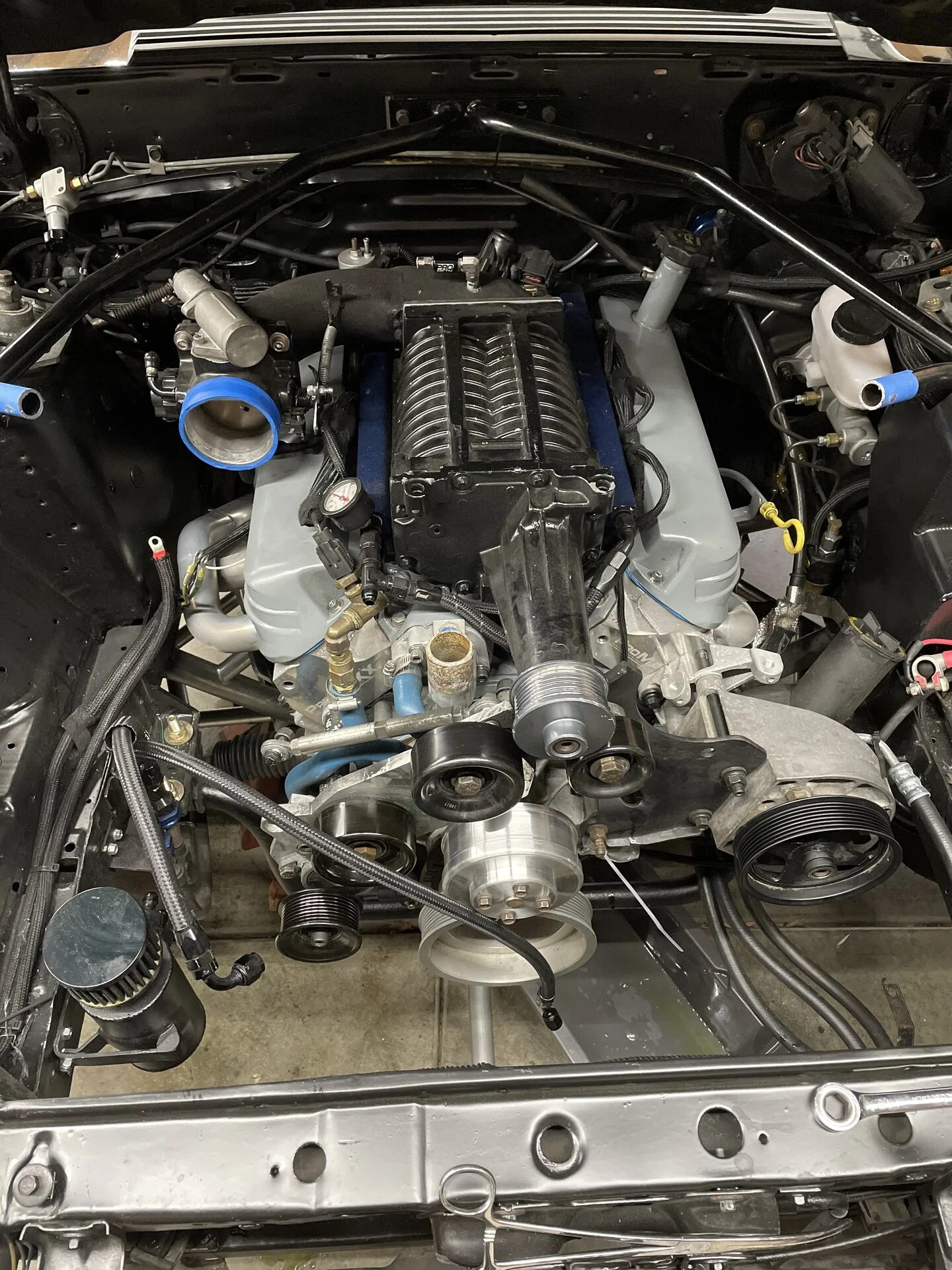

It all fits and tracks good. I ordered some arp hardware for it. I also noticed a click coming from the tensioner I think, I’ll address that later though. This thing is probably coming out possibly over thanksgiving

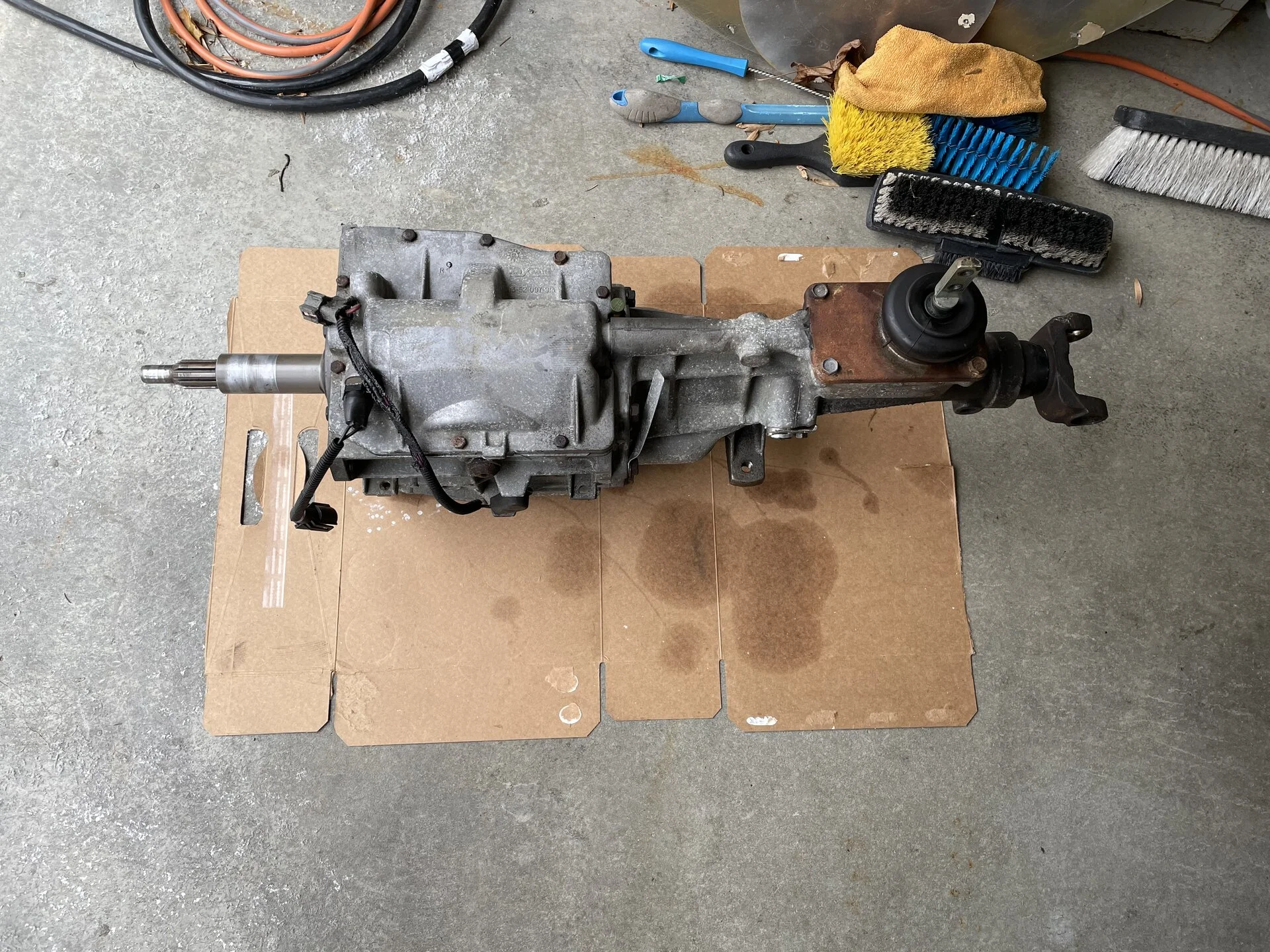

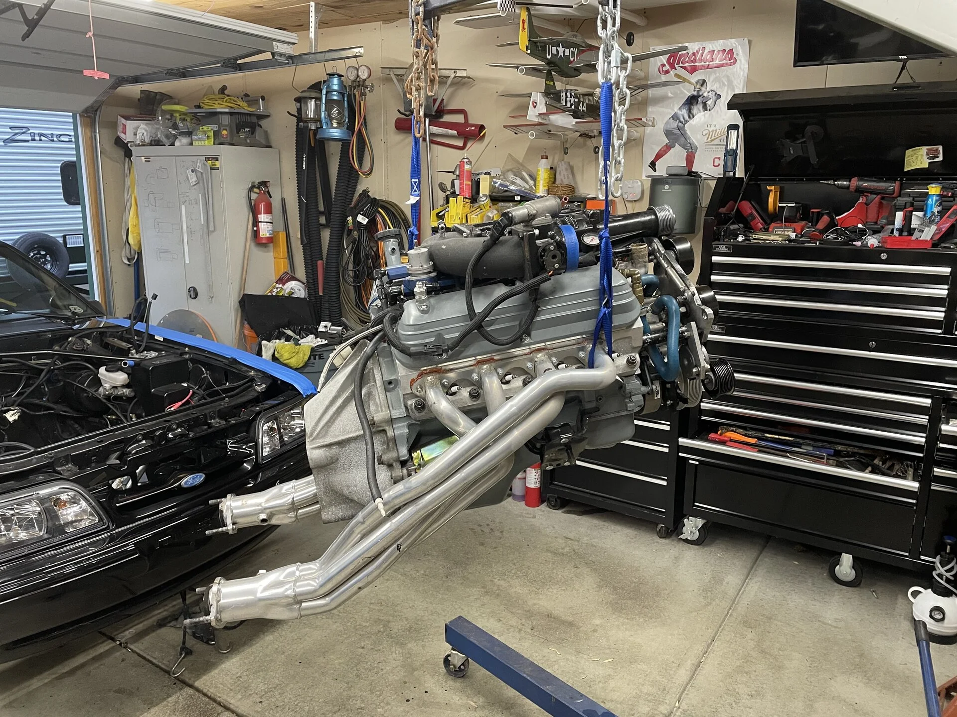

Well day after thanksgiving starts the winter build season up north here. Figured I’d start by getting fluids drained and maybe accessories removed. Well I was on a roll...
