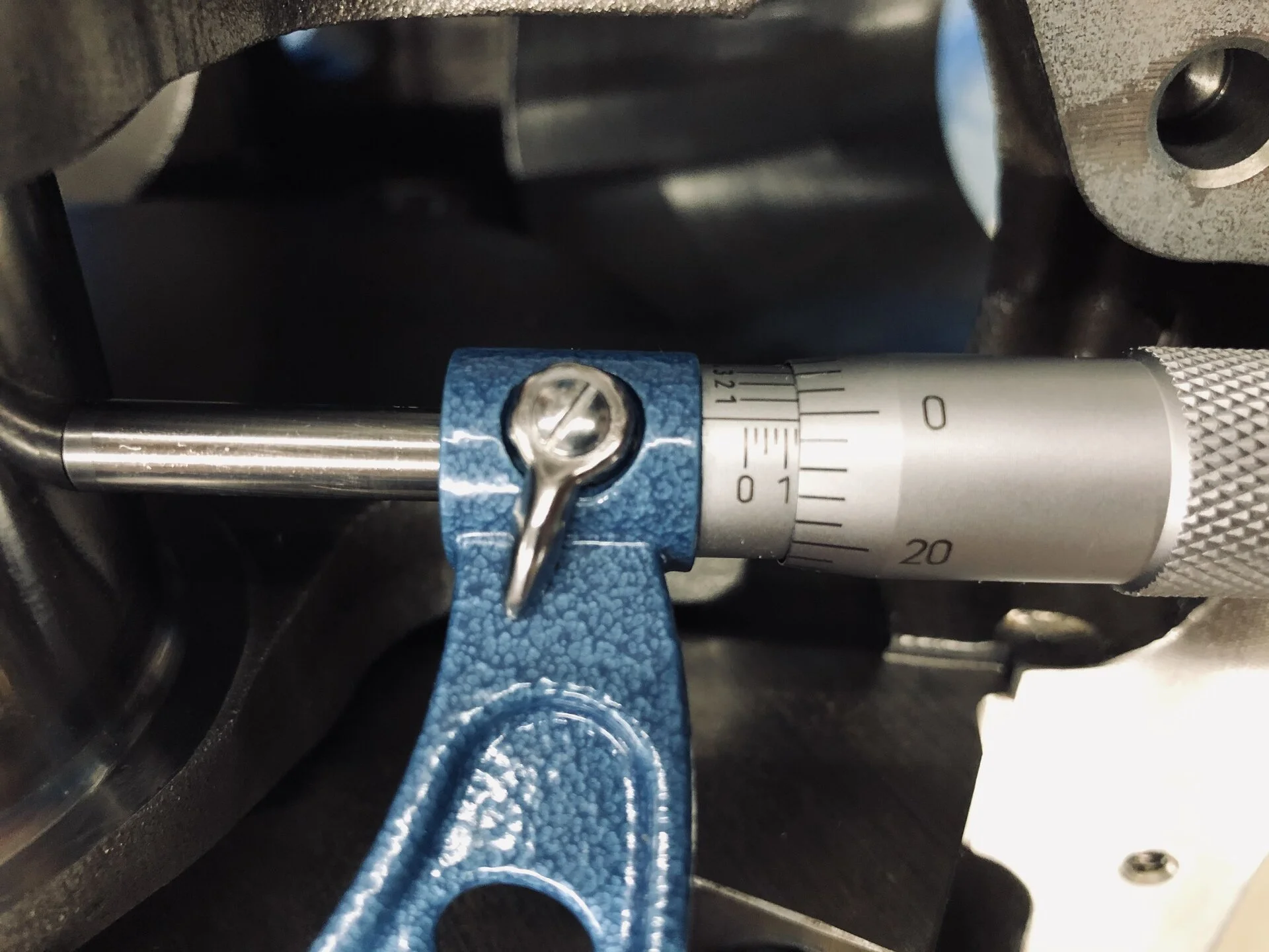

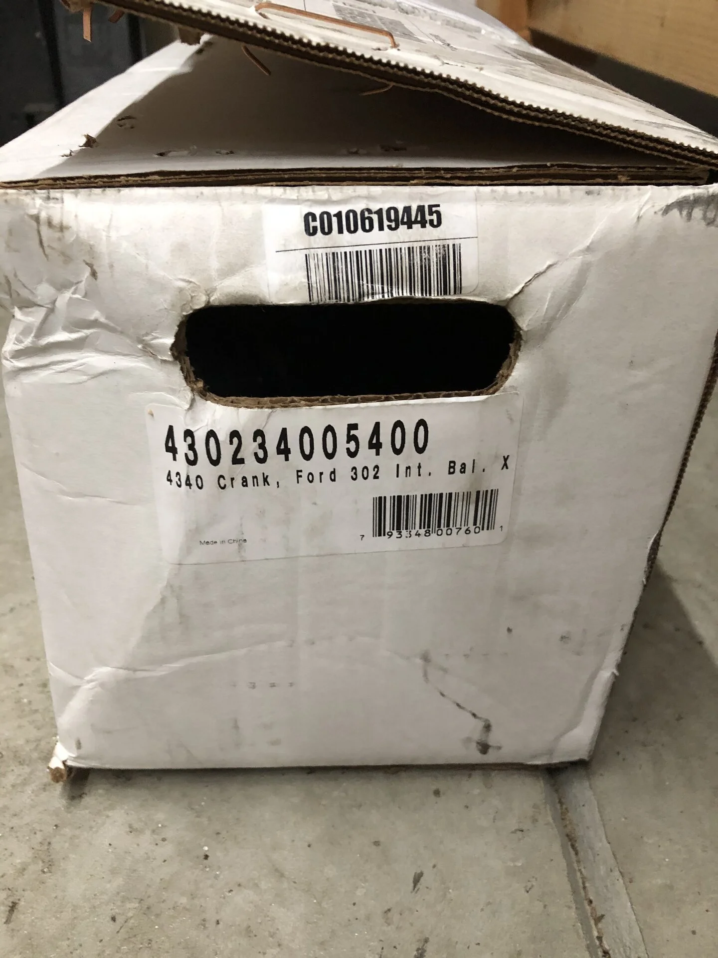

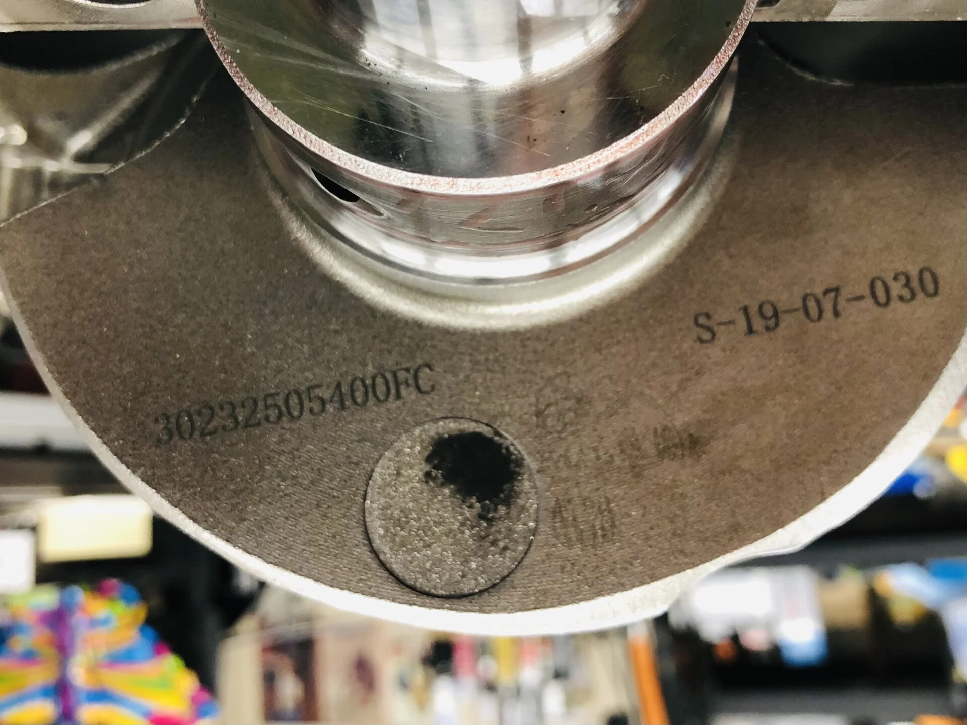

Well this is completely unbelievable. The crank has the wrong rod journal size. All part numbers from box to those etched on the crank point to a 2.100 rod journal. This one is 2.124!! Hopefully eagle will make this right. So frustrated

So with a clearer head this morning here’s what’s up. The crank is marked as a 3.25 stroke crank but the box which was not opened and stapled shut has the correct part number. Now It’s not even the correct 3.25 because that crank should also have 2.100 journals. I just really hope I’m not gonna have to eat this....

The crank saga continues....
