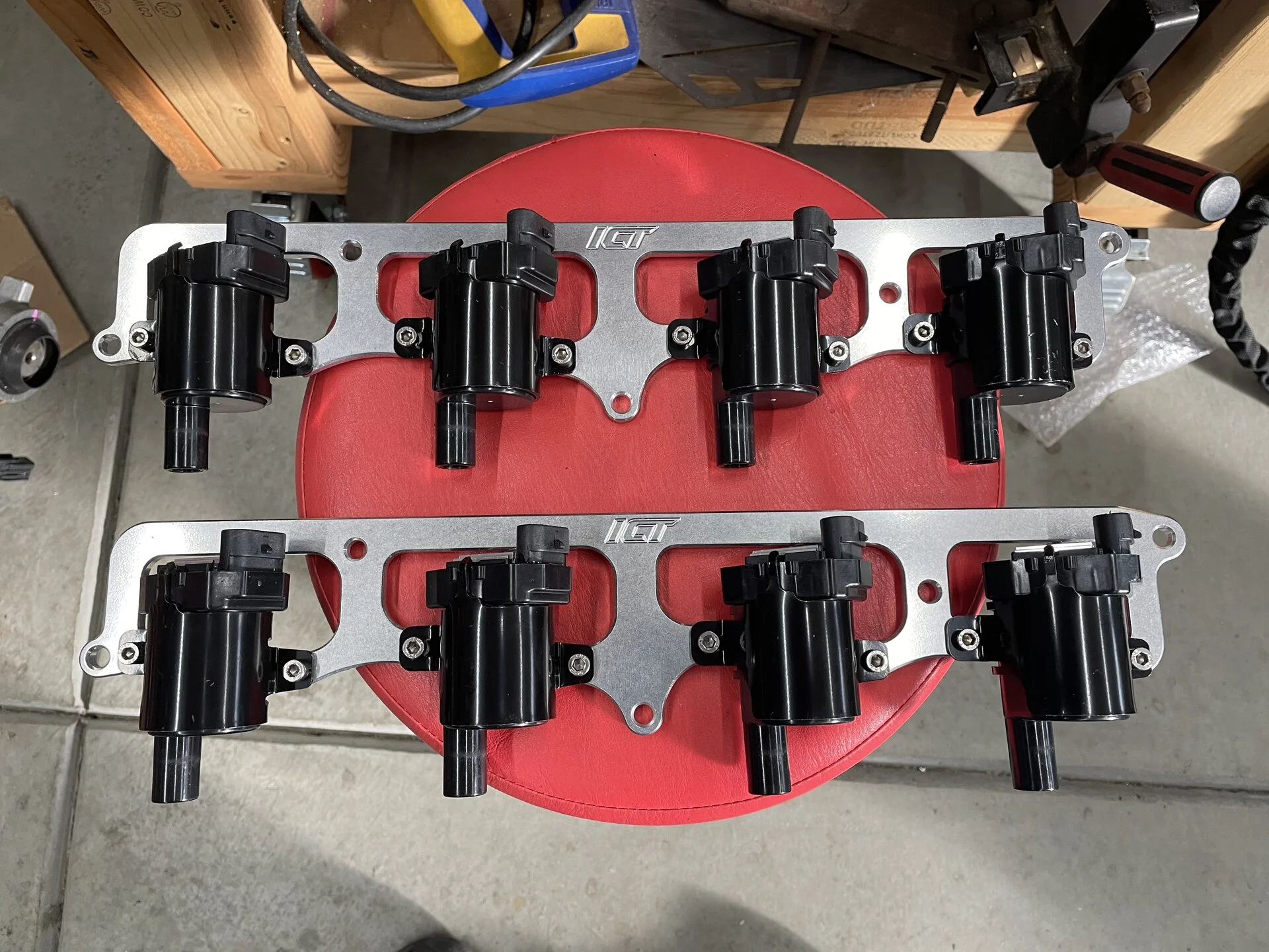

Not too much to report today. I got my throttle cable. Checked factory cable and it pulled 2” when I checked the TB I’ll have to do some math to mount the lug to get wot. This tb is made for a lightening so the cable will pull from behind instead of from in front. Also after some consultation with my favorite tuner and just overall knowledgeable guru I think I’m gonna run LS coils. Build my own harness or buy one and modify? Still need to search online for a wire diagram and also buy coils etc

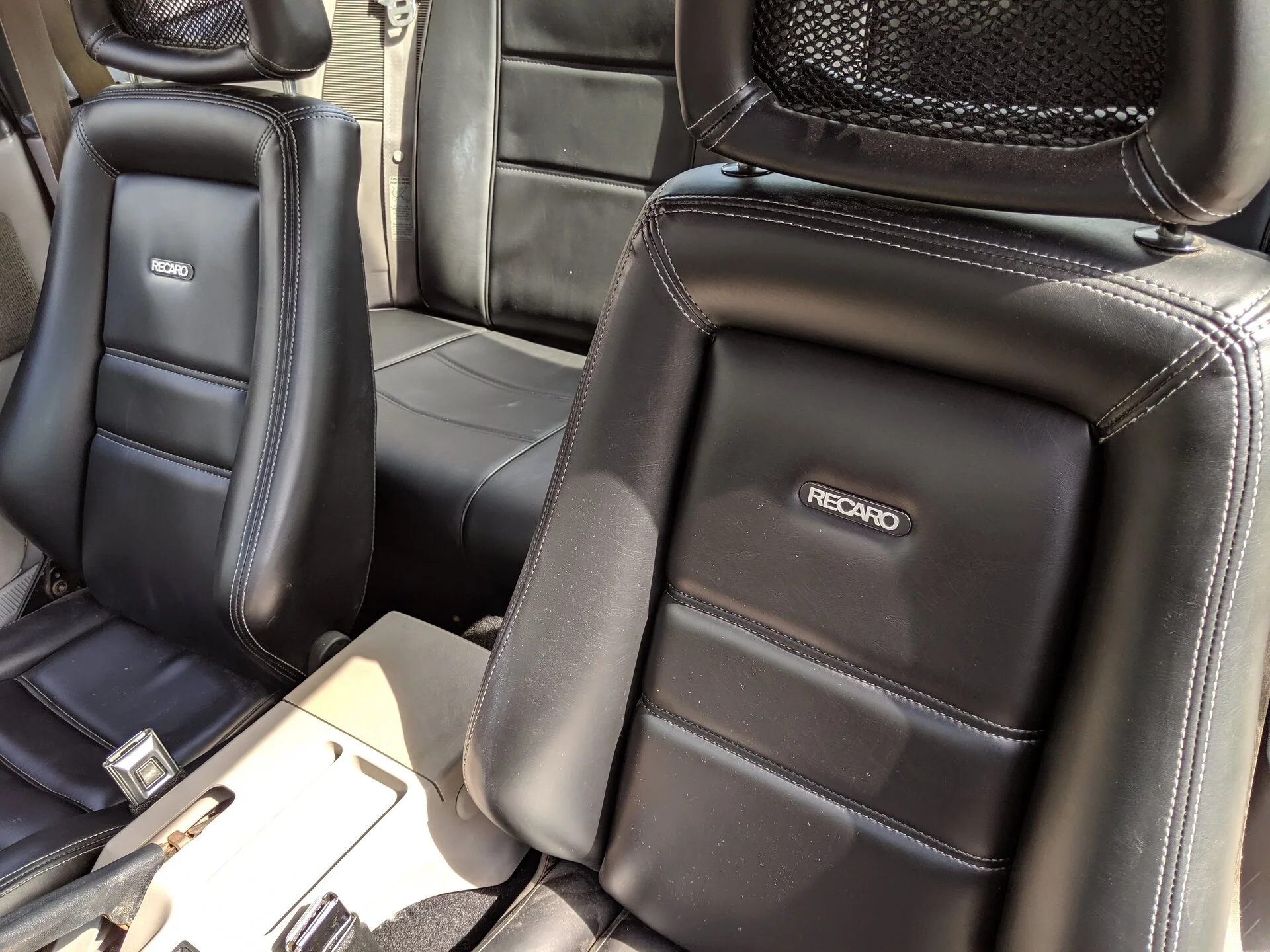

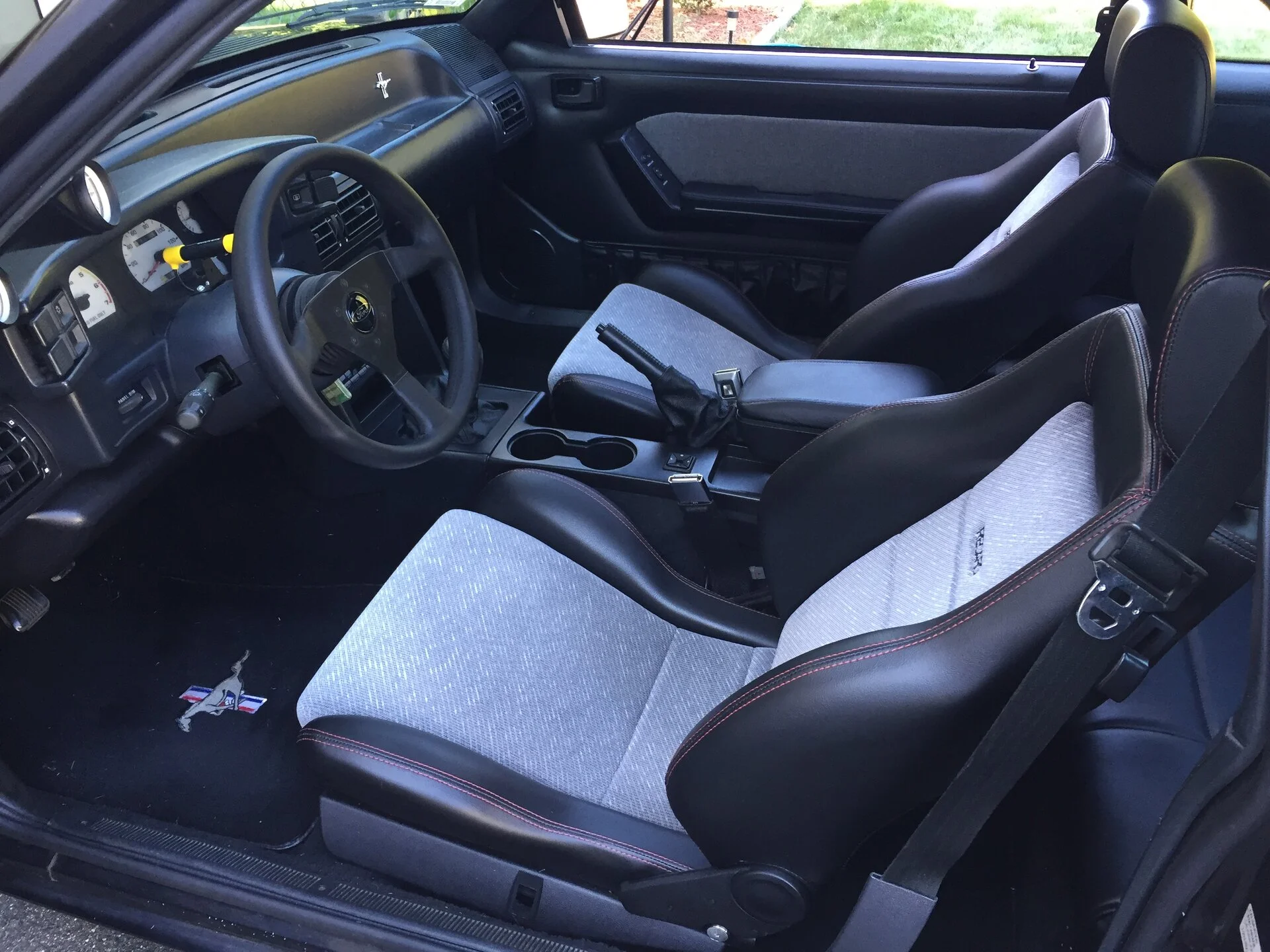

Anybody use recaro seats from a VW GTI/GLI ? They seem like size wise they’d work. Or am I missing a better option. I do like the 82 recaro lx seats but they seem hard to get and expensive

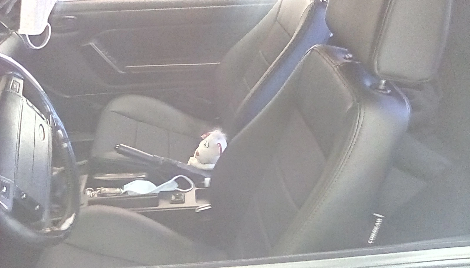

Well I just installed a pair of corbeau sport seats and let me tell you they are comfy and firm.I used my stock sport seat brackets so just the cost of the seats,and cyber mon deal was under $600 shipped,thank you American muscle.
Reactions: KZGUNS
Here a pic

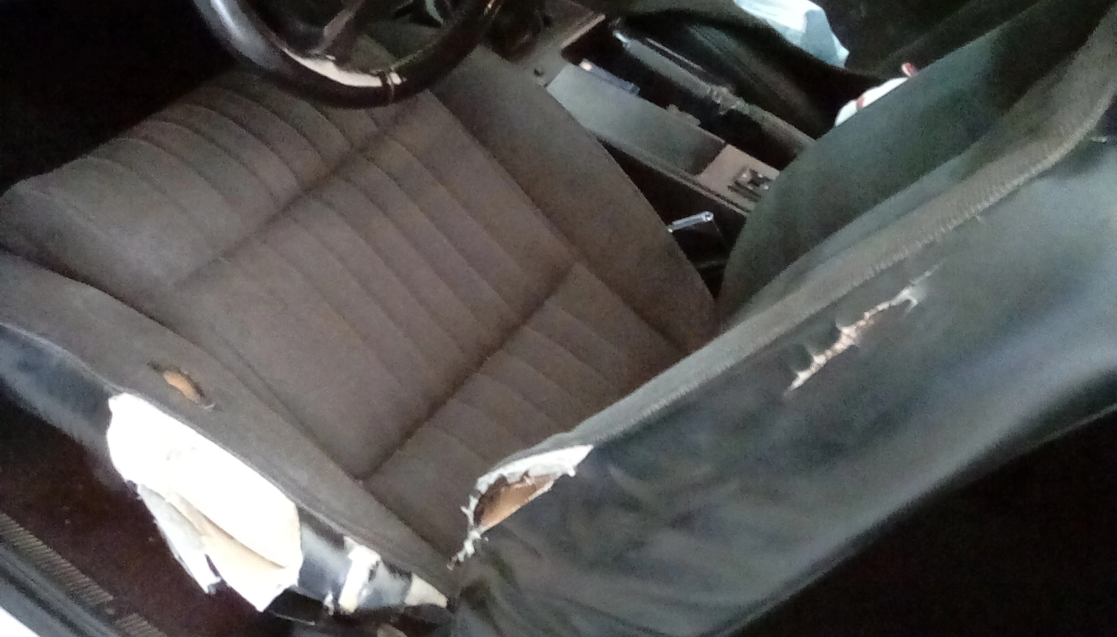

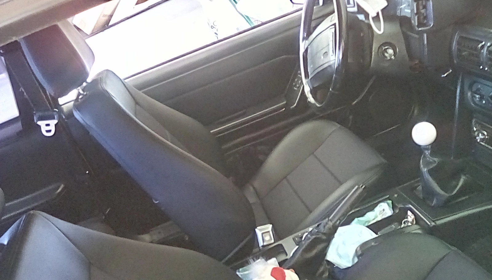

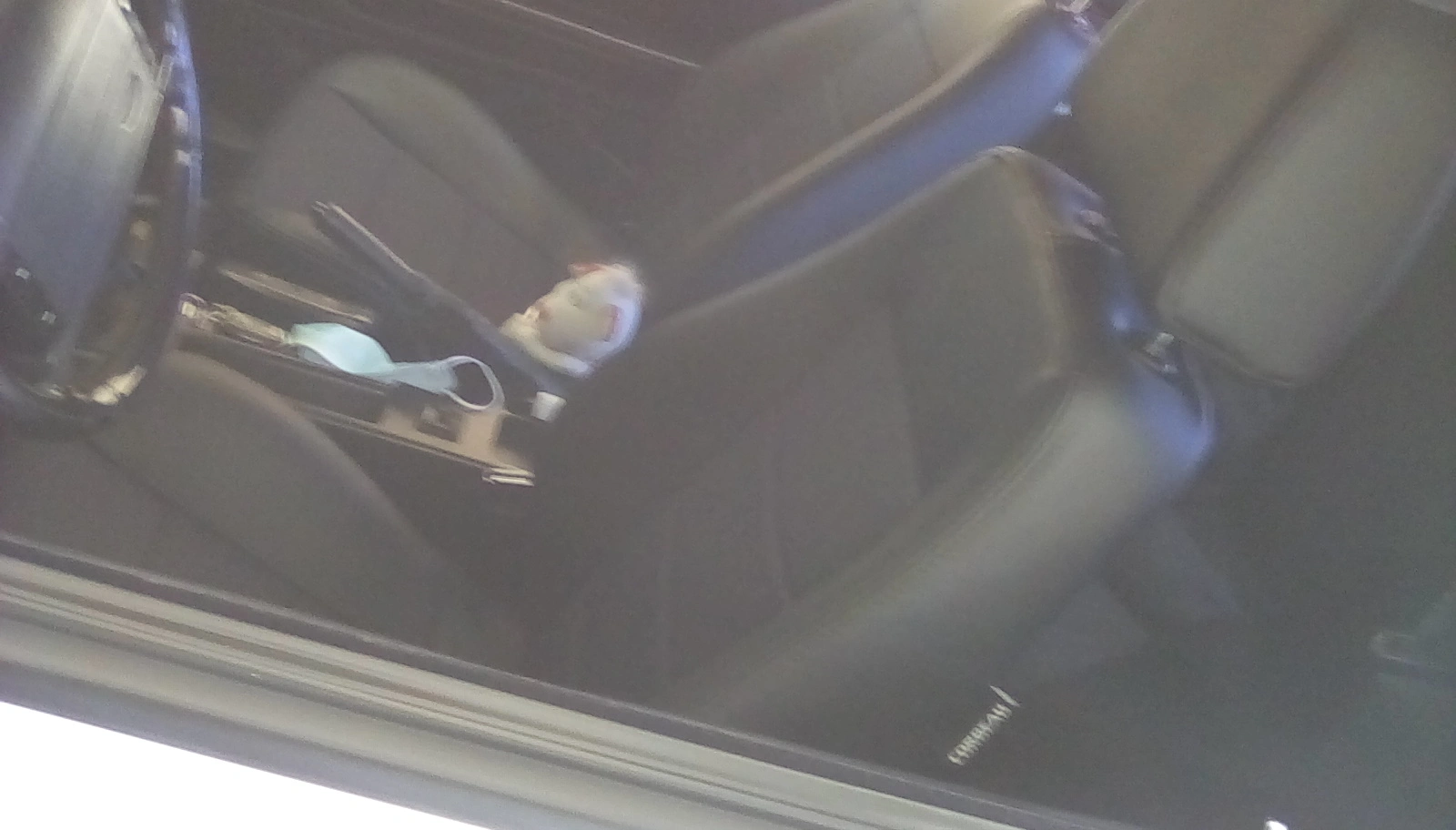

Those recaros are sick,but too much to spend on my daily. I got the corbeau seats for less then I could redo my originals They were tore up from the floor up..

The sun obscured these pics of the rears, but they match.

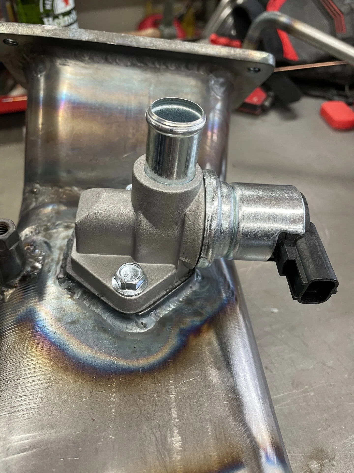

Back to the intake for now. I got the iac mounted. I’ll probably just put a breather filter on this with a short piece of hose to clear the valve cover. Hopefully those show up soon so I can figure out how I’m gonna mount the coils.
