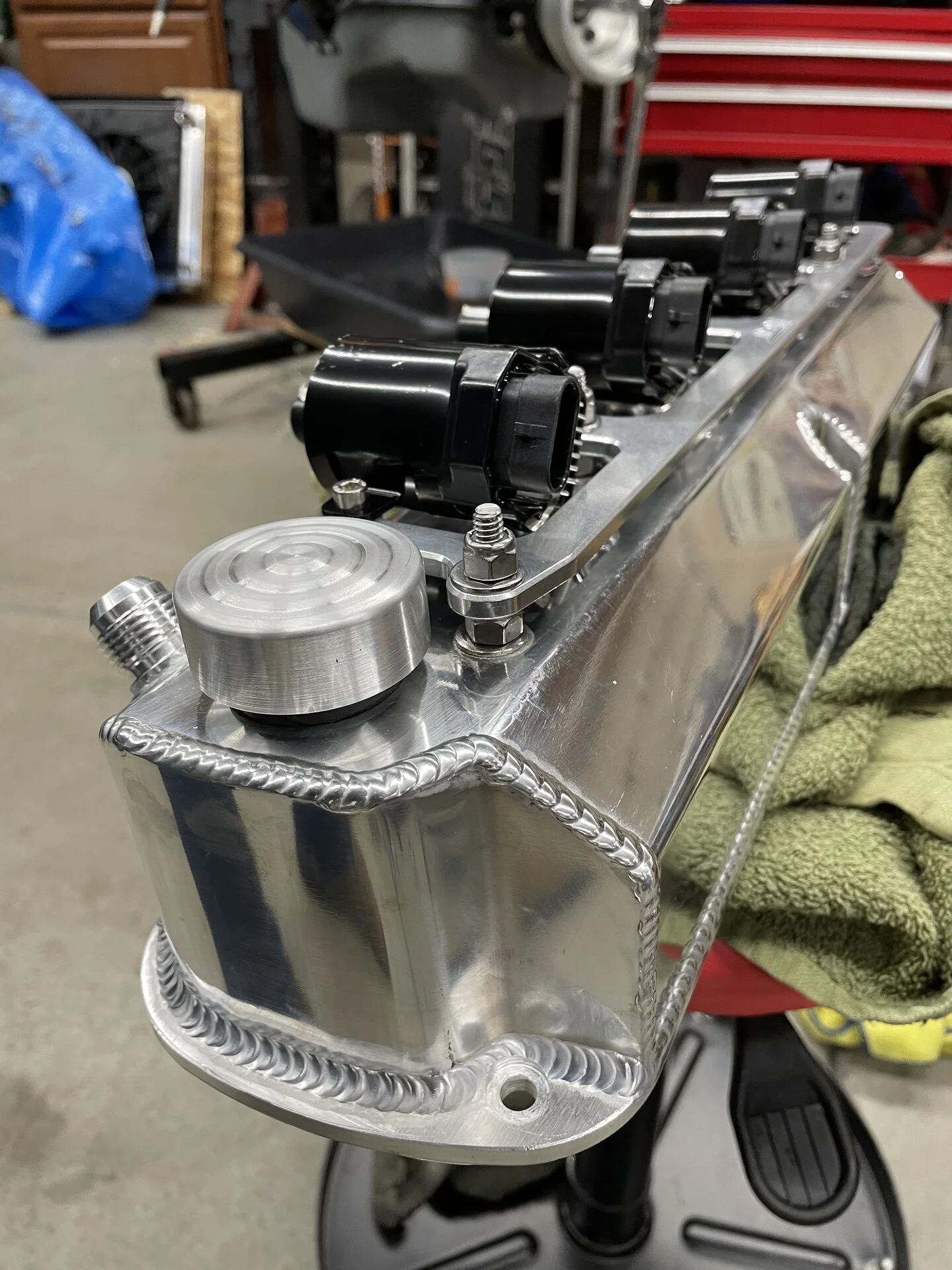

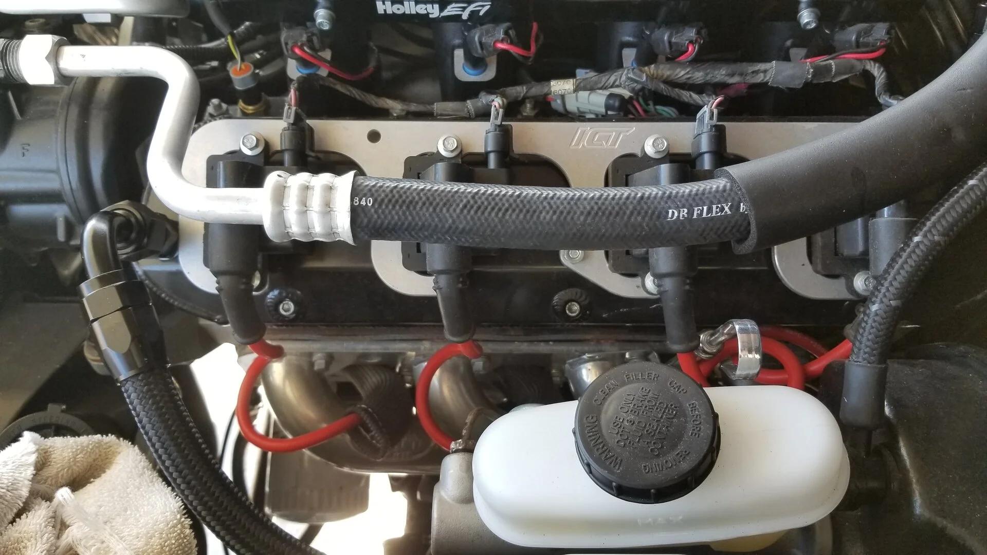

Notice the center bracket mount hole and the center valve cover bolt line up. This center's the coils well and provides enough room for a filter or bulkhead.
I used short 1/4-20 stainless machine head bolts and silicone them in place a nut on the top side to space the bracket.

Thanks! I do have a nutsert tool. Nothing special but it installs aluminum nutserts if I use that I’d need to seal them and use sealer on the screw threads. What you did probably makes more sense

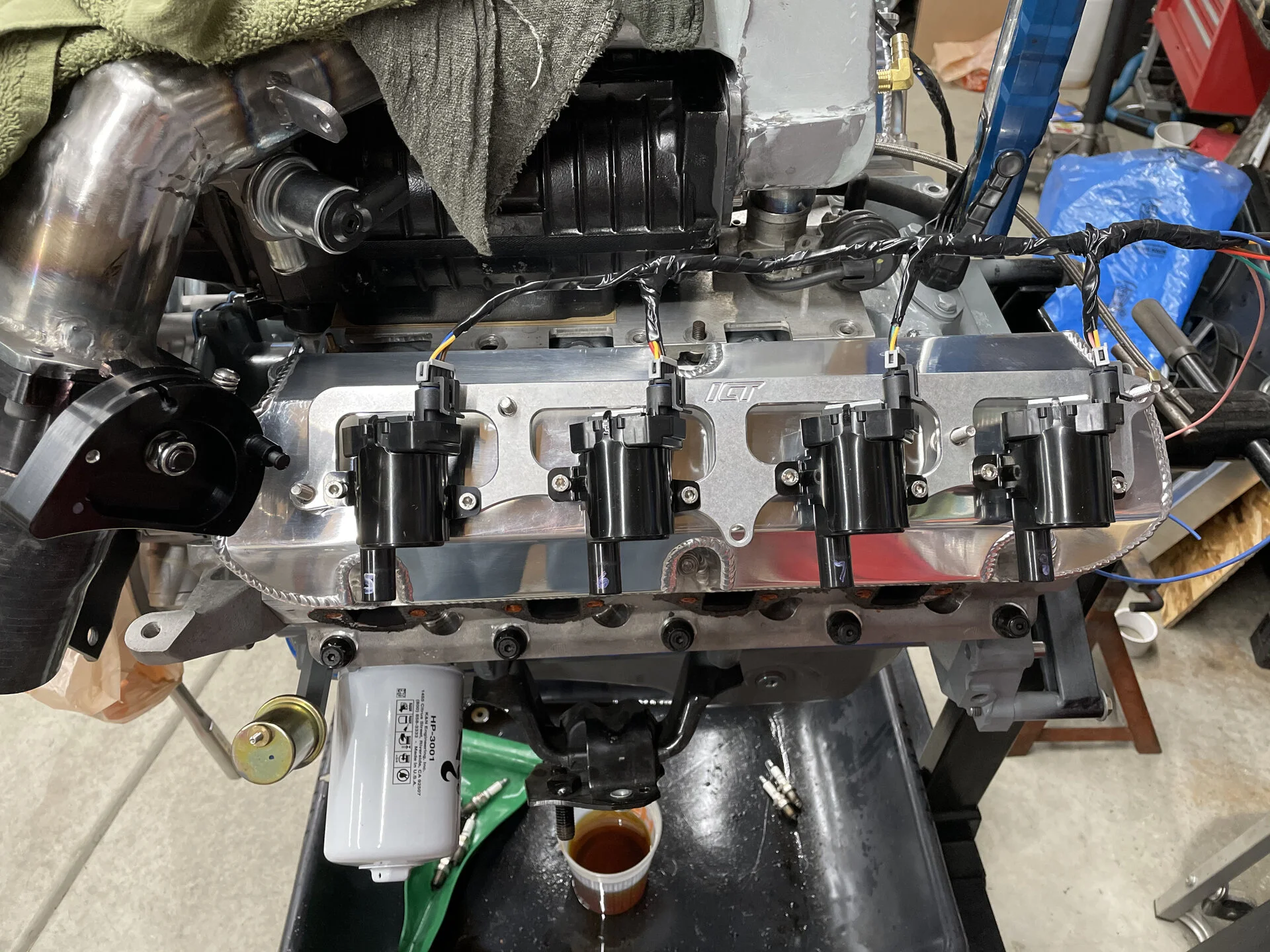

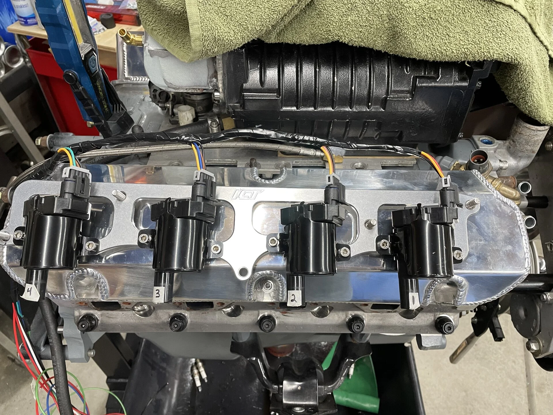

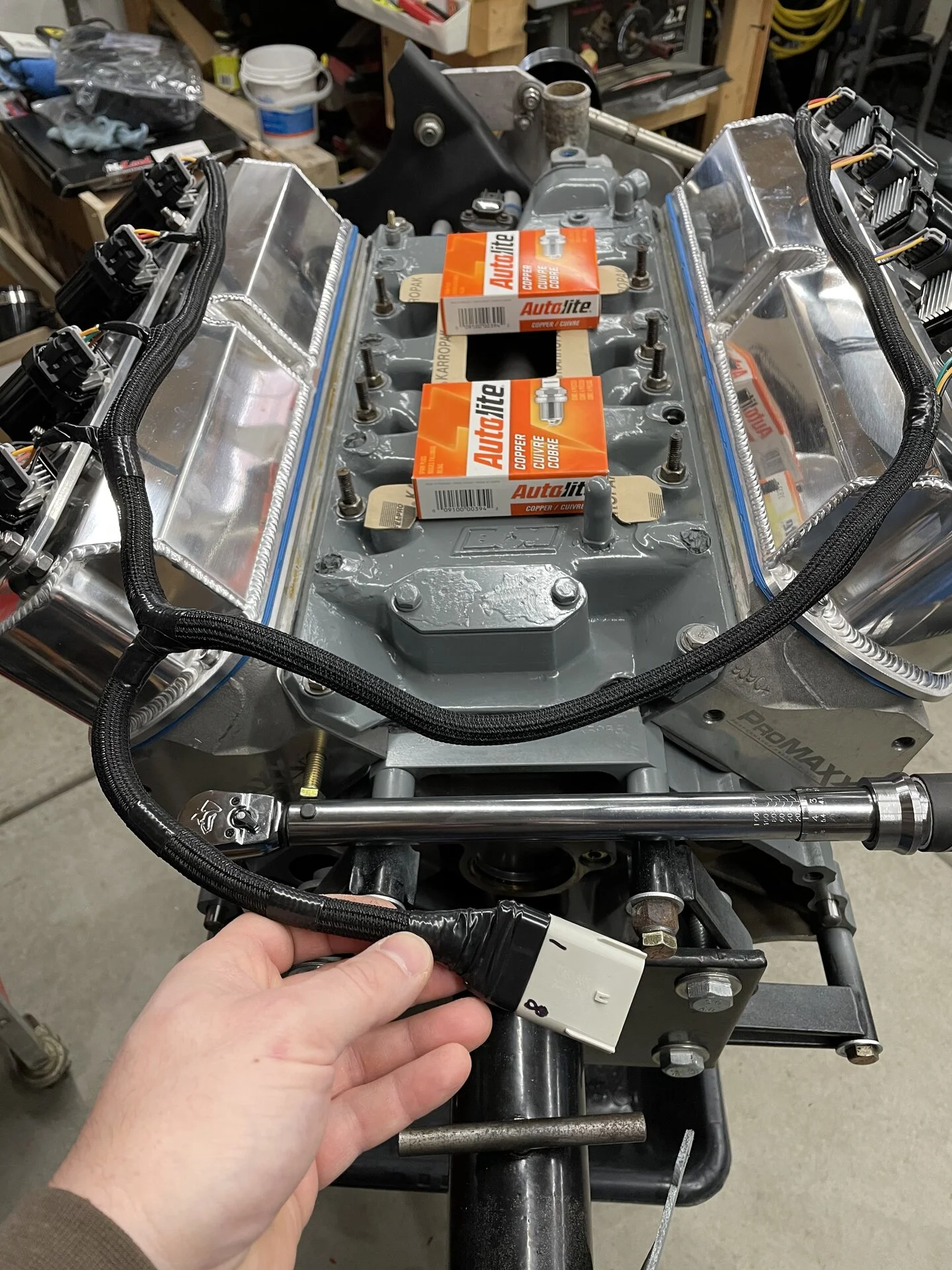

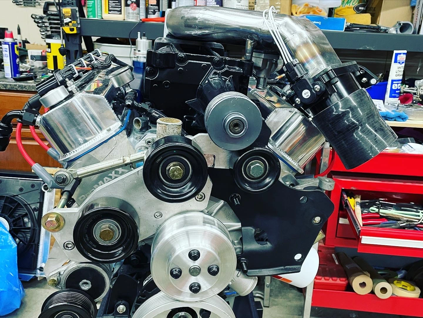

I got the coils mounted. I shifted them back as far as I could to clear the throttle and leave room for an -an 10 for a breather/catch can. I guess I’ll use those to fill the oil. Don’t really have any room for a separate fill.

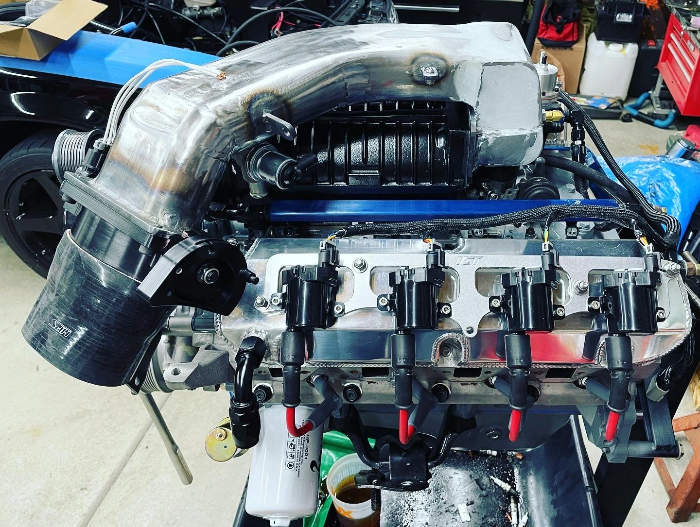

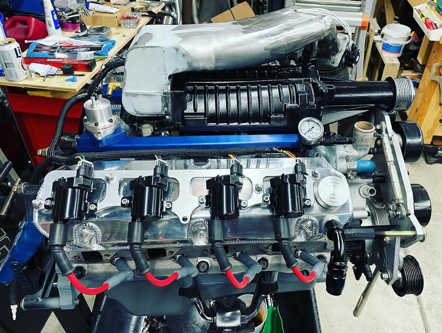

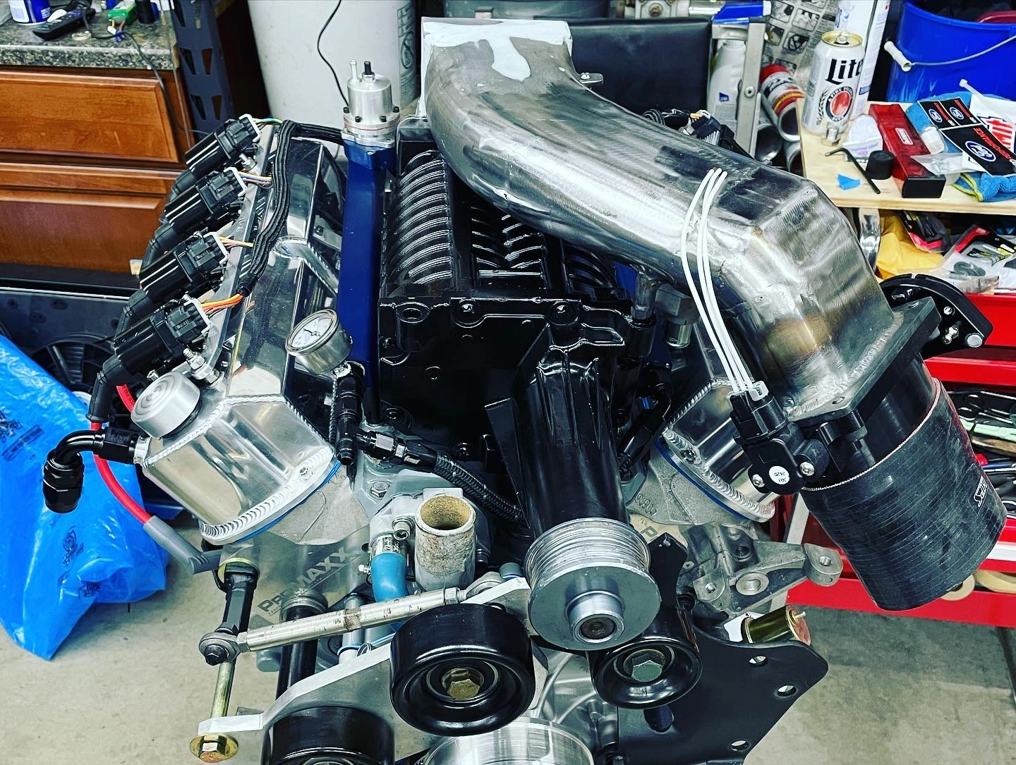

Little by little this thing is coming together. Still need to add a port for the second methanol injector and then I can finish the intake track. Little clearance issue with the IAC but I’ll figure that out no big deal.

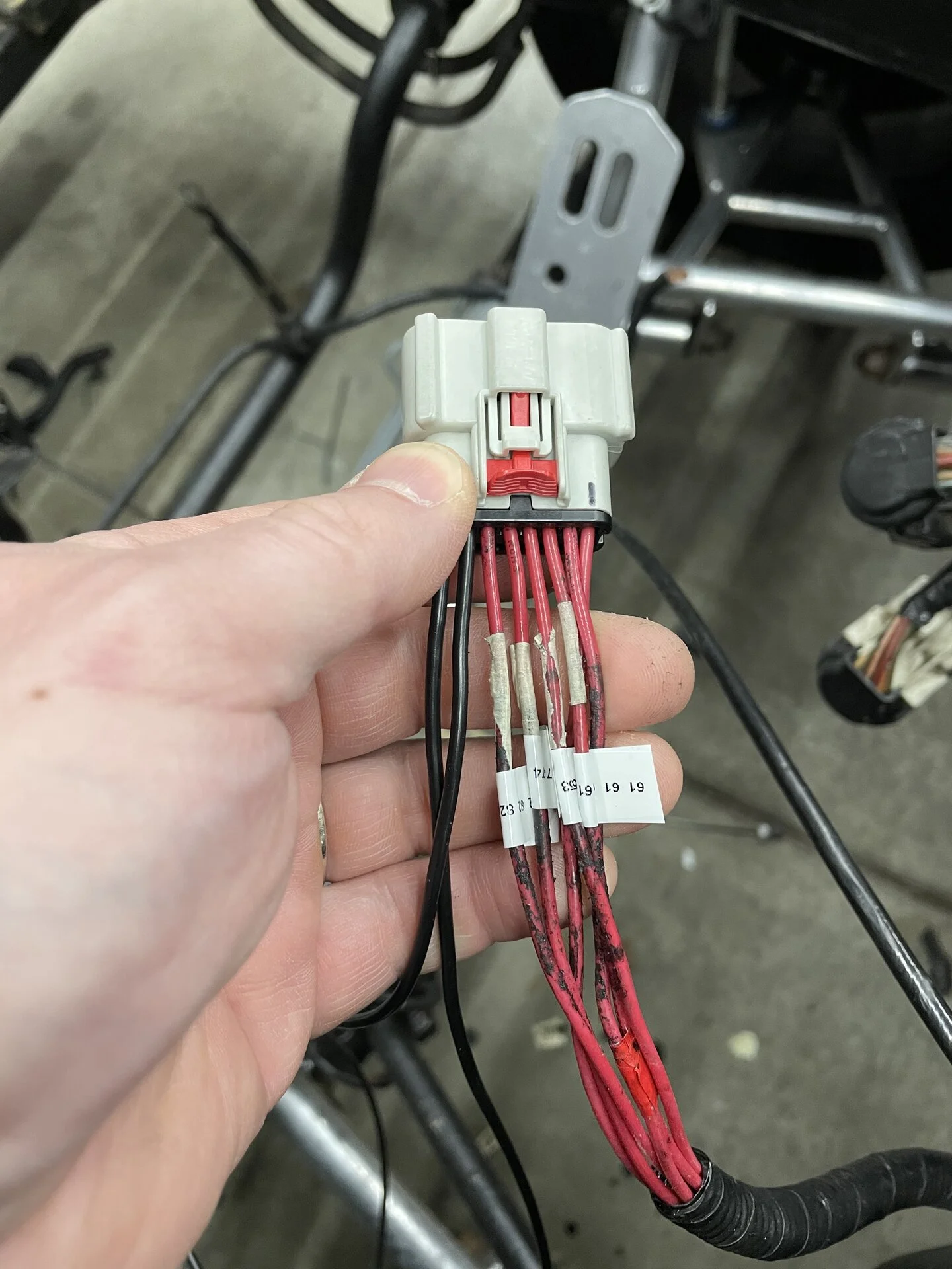

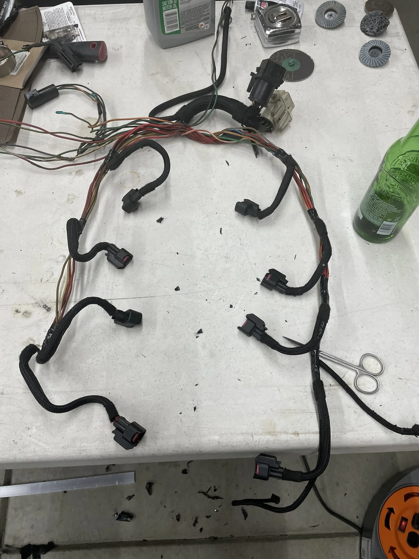

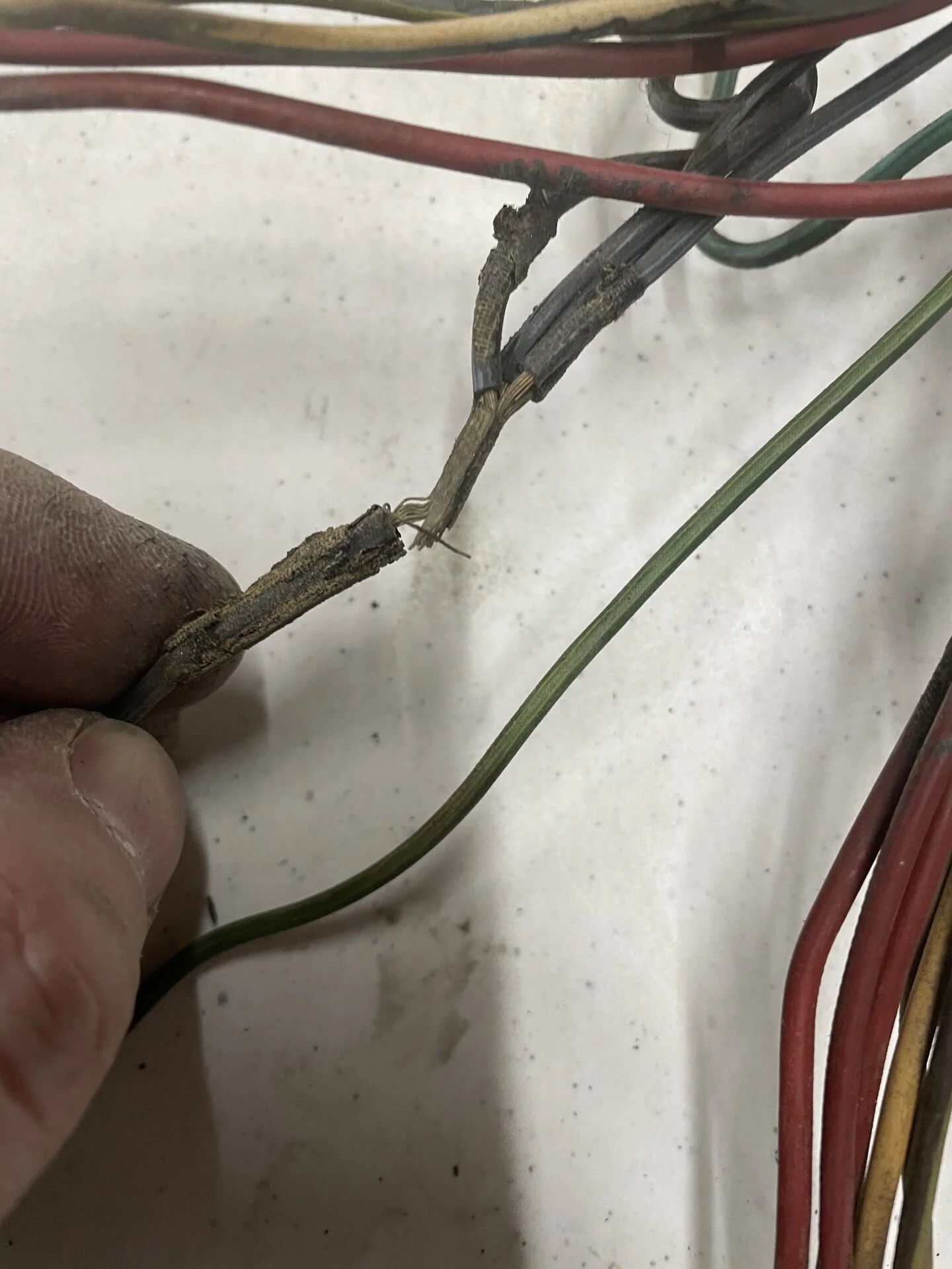

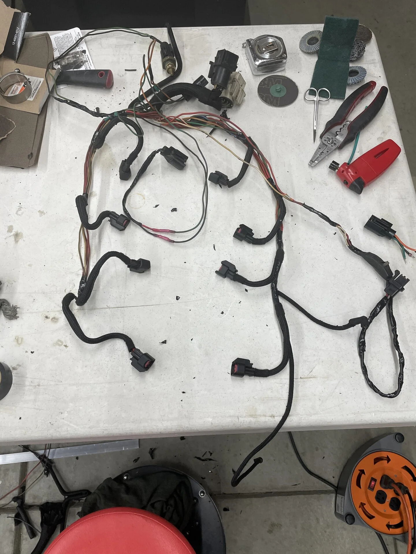

Well I decided to tear apart the injector harness to clean it up since I have to reroute some stuff so I can also get rid of unused wires. Found this sketchy factory ground splice barely hanging on. Have to extend the tps wires and put the right plug end on the iac. Then I’ll reloom everything.

Thank goodness you decided on relooming that harness, because that could have made you pull your hair out with a bad ground like that especially if its the sensor ground or injector ground to the ECU.
My thoughts exactly! Its also a good reference for people having ground issues, that splice is right by injector 4. i had no idea there was a splice there.
