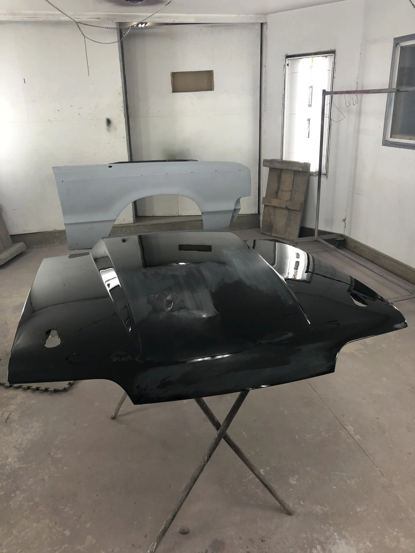

Nothing too much to report. Waiting for my hood to be done at the painter. Got a new truck. Really like it!!

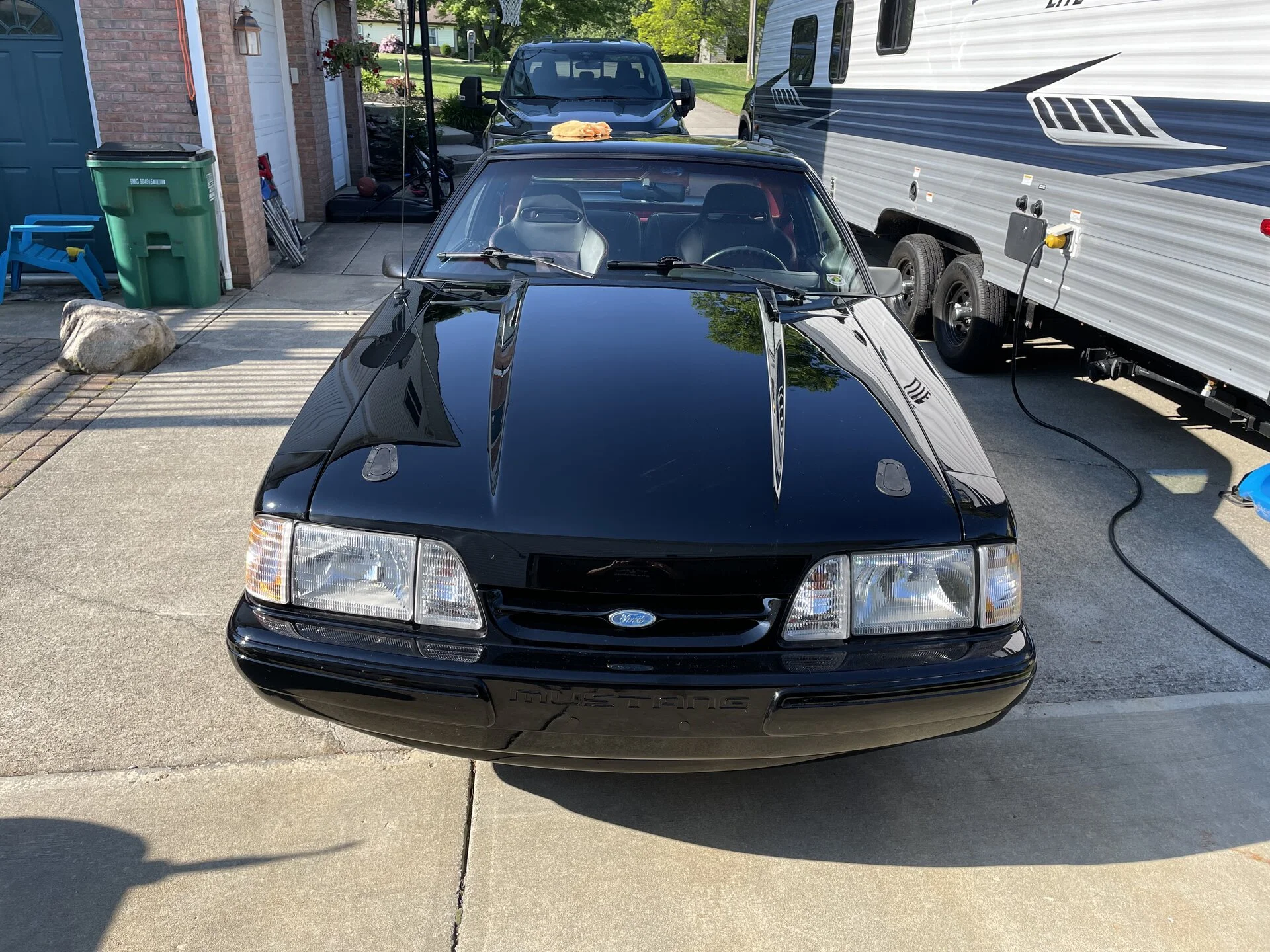

Fresh off the gun. Hopefully pick it up this weekend

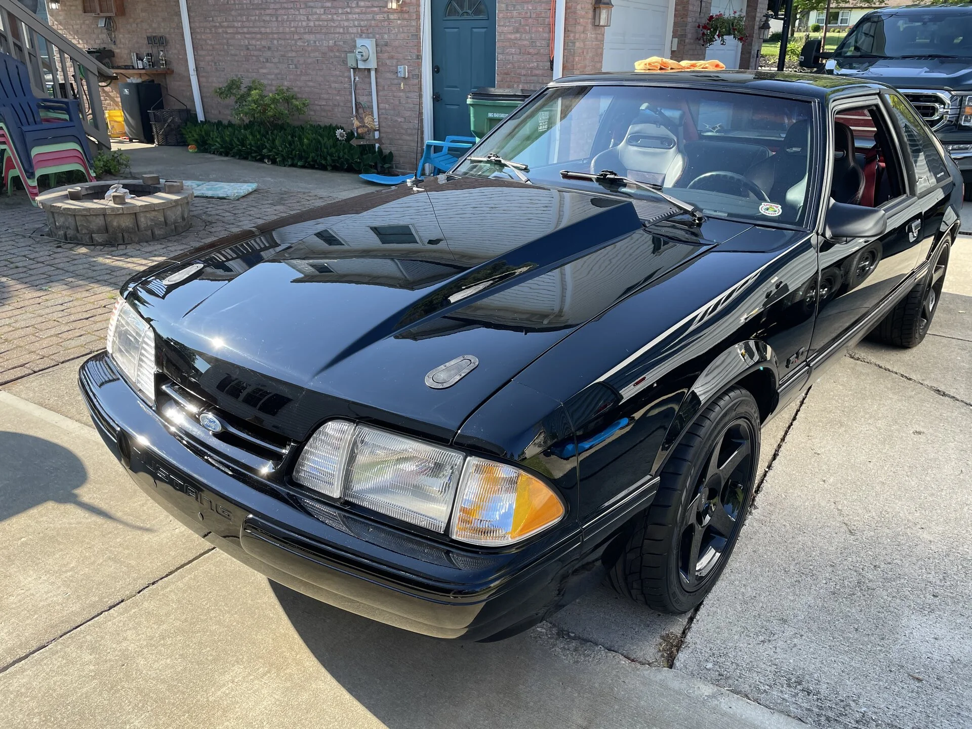

Looks great!!
