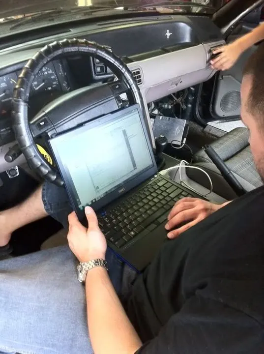

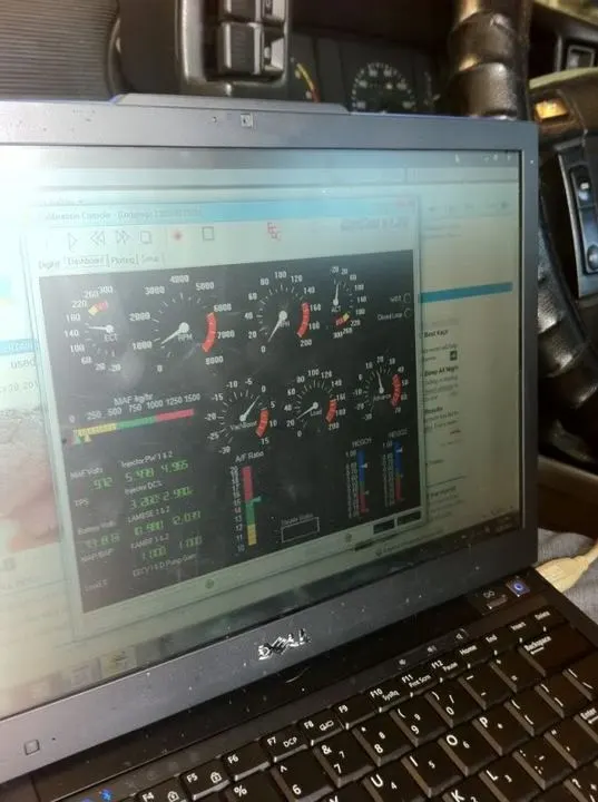

Using a twEECer with an AOD-E tranny is well worth it. With the twEECer you can change the shift points, add a redline, etc. With the economy the way it is currently you could probably pick up a twEECer for nothing. I know for our project the twEECer has been a life saver because of it's datalogging capability. We changed so many things and getting the car just to idle took mere minutes with the twEECer. We could have been chasing gremlins for days even weeks without it. Nowdays a tool like this is worth its weight (rather money). If you don't get a twEECer then look into a P.M.S., Megasquirt or getting the car running and take it for a dyno tune right away. Regardless after this swap any of these will be a need.
I use the BE software with my twEECer. The software that comes with the twEECer is a bit outdated.

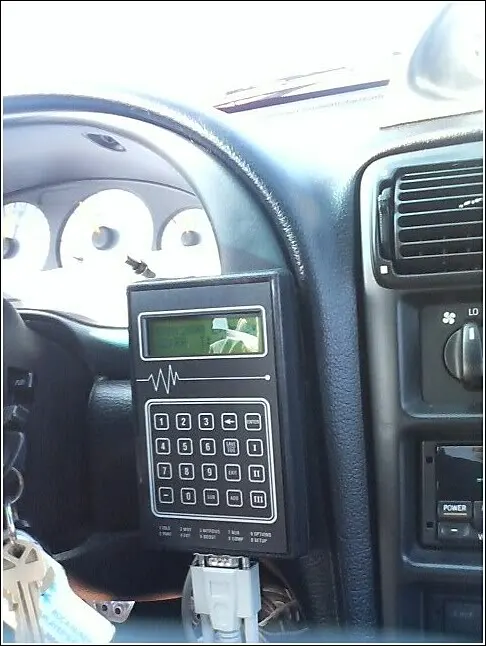

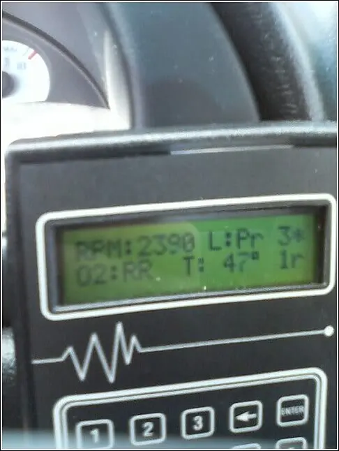

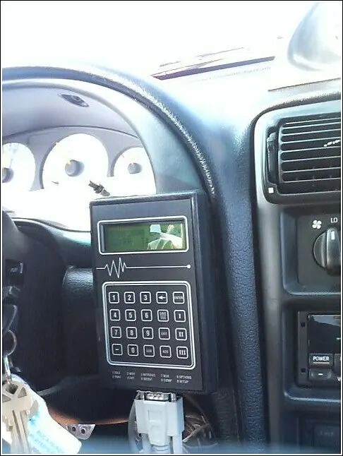

Is that because the P.M.S. is easier to use by the general public? I had one on my 94Gt and it sure did help my 347 run great. I had an older style P.M.S. too (non Nitendo controller). For what I paid for it I was pleased with the performance.
