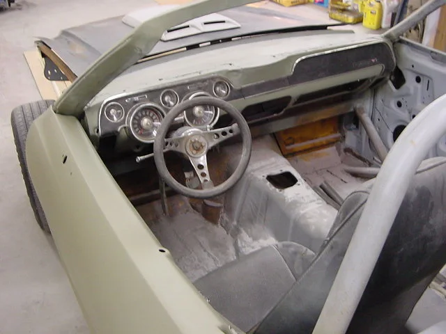

not sure if this is what you had in mind :D

My dad and I did it.. it involved some 'modifying' of plastic pieces behind where the gauges sit.
You know those aluminum sheets that you sometimes see on the bottoms of doors? I dunno how to explain it well. Well, we bought a piece of that, cut it to size, then figured out what gauges we wanted where, cut those out to size to fit the gauges, then of course had to cut the wiring harness for the factory gauges, getting the wires we needed, and extending them onto the gauges we bought.
It's a pretty long and tedious process, and I absolutely hate wiring, so it was all the more painful for me.. but luckily I had a patient brother with me to help with the wiring, and a patient dad to help with the designing portion.
My uncle had a nice gauge setup on another II that we had, with VDO gauges, so we changed it up with the Autometer gauge setup. We took a lot of what was already done originally and adapted it to mine. I need to find a way to add a few more gauges after I finish the EFI swap.. I really want an in-car fuel pressure gauge.

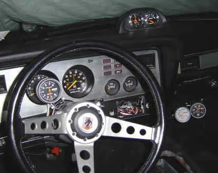

i wanted to have something with a little more accuracy than the stock guages. i went with easy removal in case i want to go back to stock. probably would take less than an hour to remove them all.
fuel guage is just visible under the cover and it mounted in the cowl. inside the car: clock and volts in the dash pod. h2o and oil under the glove box and a small tach on the steering column. dash pod is something i always wanted to do but was not sure how it would look. a member on this site posted pics of his dash pod setup and i really liked it.

i wanted to have something with a little more accuracy than the stock guages.QUOTE]
I'm surprised at that comment, I was shocked and pleased by the accuracy of the stock gauges. My fuel gauge in the '77 maybe reads a little higher than most, but it's startlingly consistent: I run out of gas the moment the needle covers the last line. I've done that 3 times, always exactly the same spot (most cars let the needle go a ways under the line, not mine). My speedo was dead on the money every time I tested it, tach seems spot-on, temp gauge is extremely consistent, and the clock keeps damn near perfect time! My only complaint is the lack of an oil pressure gauge, which a setup like your dash pod would be ideal for. That does look very sharp.
i guess inaccurate is not the best of terms when comparing guages that have numbers intead of a hot/cold type sweep.
the only one i could compare is the tachs and the new reads about 400 rpm higher. i also borrowed a monster tach from a friend to confirm the higher reading.
keep in mind this in no race car or highend combination but the engine and electronics are far from stock which could be the reason for the difference.
parthos, did you just gut the original assembly and replace w/ autometers? that looks real sweet.
