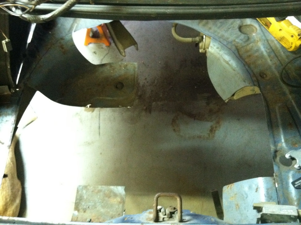

The trunk pan is (over)trimmed and the rear is mounted. @84Ttop was dead nuts on it when he said it was gonna be a tight fit, but it's going to all work up in there. I got a new bottle of gas today so I can start welding now that everything is stuffed up in there. Progress!!!

It's all just set in there now, hope to get some welding done tonight. I need to get it on the ground asap and the engine set in, there is a cheap cowl hood local and I dont know if I need it yet or not

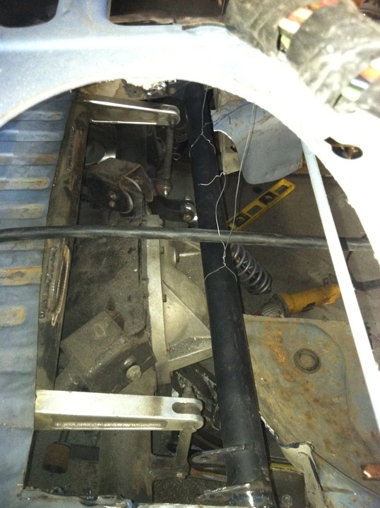

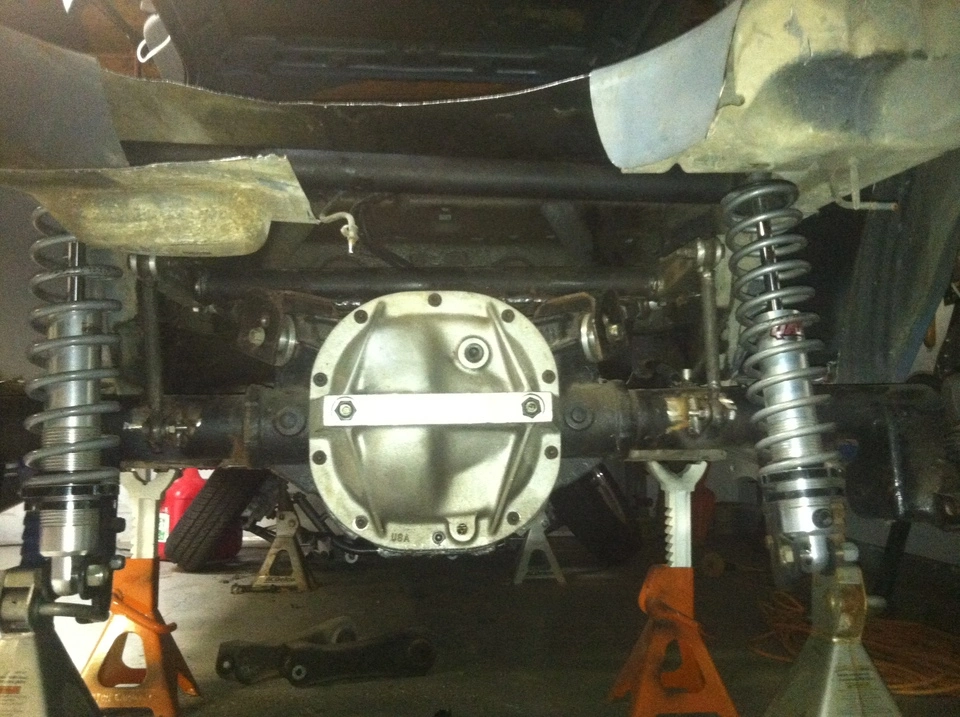

As for tonight:
Uploaded with ImageShack.us
I painstakingly removed the shock cross bar (at a cost of 2 sawzall blades and some cutoff discs) and moved it back about 2" after cutting more of the trunk pan out for more room to work with. The welds still aren't great, but they're better thantime and Im not too embarrassed, considering that it was still a PITA to get the welder in there.
Got a couple more beads to run on the ARB and then it'll be on the ground as a roller again. Who says turbo cars live on jackstands?
To anyone considering building a race car, I'd suggest making friends with a chassis shop and hanging out to just learn. This learning as I go business is expensive...

Did you mock up the rear shocks when you moved the cross member back? The shocks need to be plumb when sitting at ride height. If the shocks lean for or aft at all you may have trouble with the suspension binding. When they compress on launch they need to travel straight up and down. Looks good, keep up the good work.
Fwiw, in years past. Have installed, cut, ground, removed, reinstalled, cut, welded, rewelded, ground, scrapped, bought new, changed my mind, welded, ground, removed, quit and succeeded. This stuff takes years or practice and more importantly patience! If I can do it, any one can!
I got it as close to plumb as I could. All I did was flip the cross bar 180°, so the mounting location for the shocks didn't change. My garage foundation is settling and cracked, so I really don't have a good gauge for level/plumb. When I get it on the ground this week, I'll roll it out and check on the driveway.
