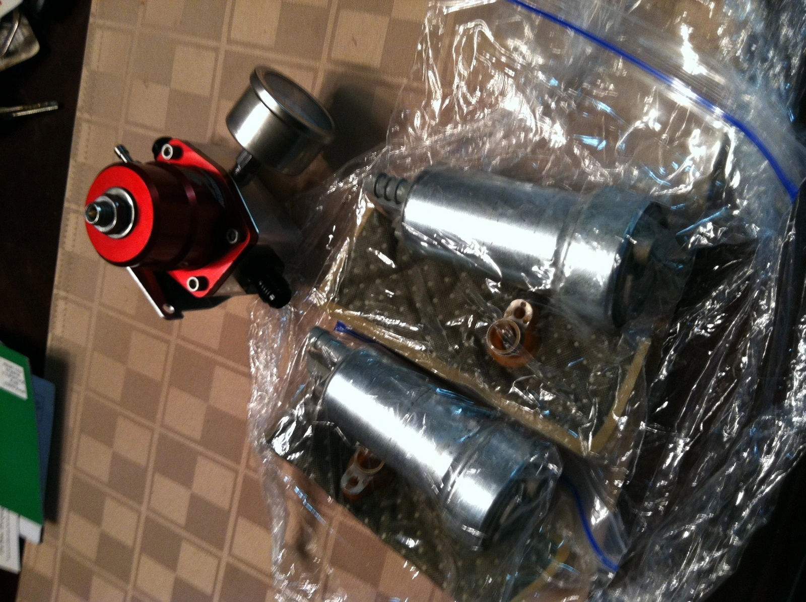

Good news: Two pumps and a new reg. also getting a FREE engine harness.
Bad news: repairing two bad coils and a broken spark plug in my f-150 ate my entire turbo fund, which I literally JUST saved enough to buy next week.

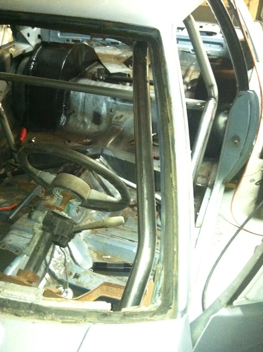

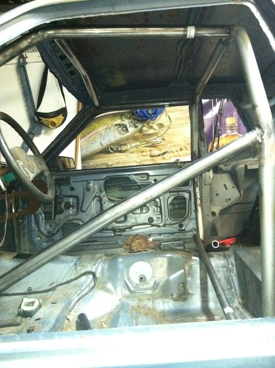

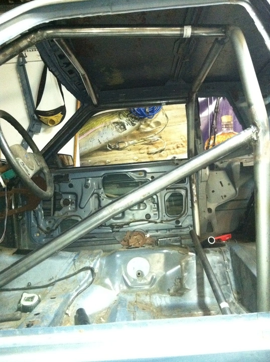

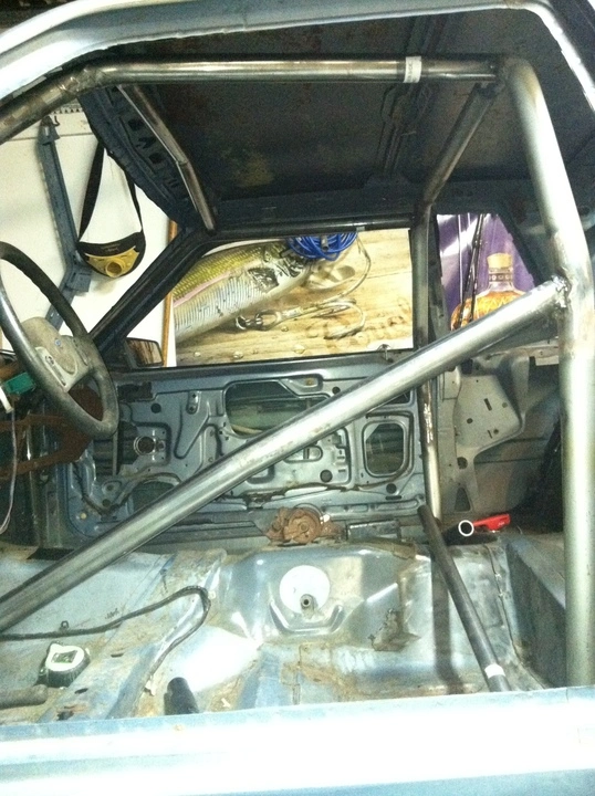

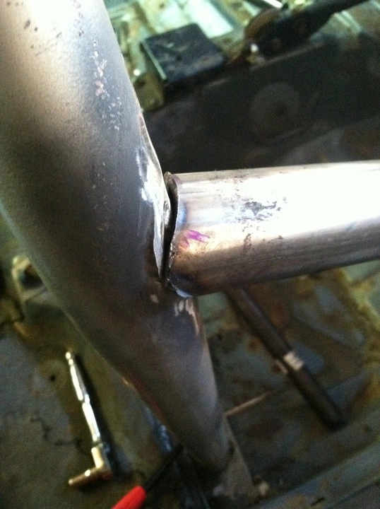

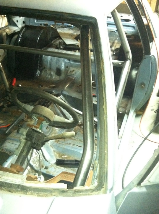

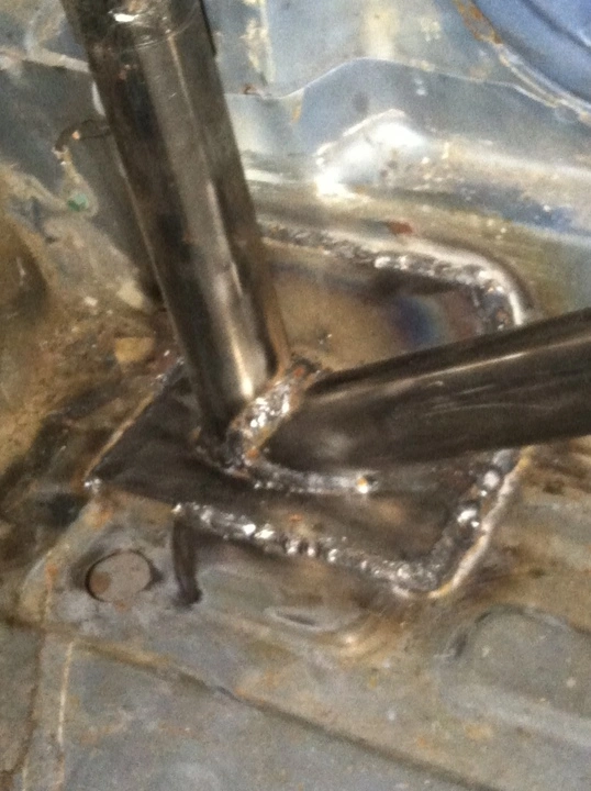

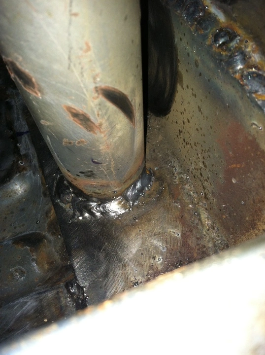

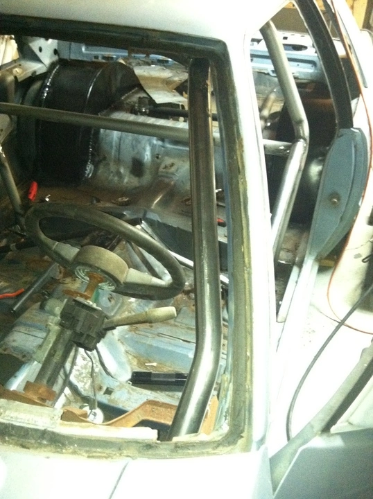

Got most of the cage finish out tonight. I'll never be accused of having professional looking welds, but good enough for the girls I date. Still no rear bars because there still isn't a trunk floor.
Not bad for a hand job... err I mean... using a hand held grinder to notch...
And the money shots...
And then I spun it around so that I can stick the engine in soon after I make some sub-frame connectors and finish the cage...

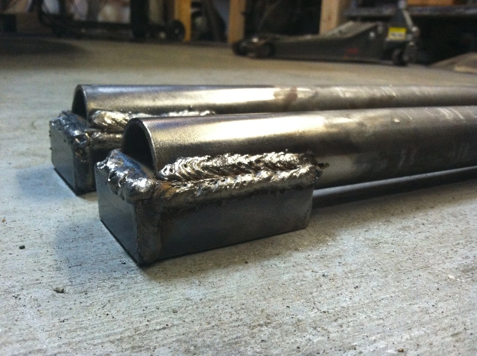

It's really too late for this uh,.....er...."advice", but I'll offer it anyway.
When you are welding w/ a 110 based wire welder, and joining fishmouthed .134 wall tubing ( like exibit A here)
You should bevel the contact surface of the intersecting bar to insure your (how'd you describe it..... good enough for the girls I date?)welds, penetrate into each other.
Getting two bars to "stick" to each other is monkey business. Getting the bars to stay after one of the welded joints is subjected to an impact at 100+ miles per hour is the stuff for the more advanced homonids.
I've looked at some of the pictures you have posted and have bit my tongue, but considering what you are showing me, better to offend now, then to offer my prayers later.
Being concerned that your bar will pass NHRA tech based on diameter and wall thickness is one thing, disregarding that a prick tech inspector will also fail you for weld integrity is another.
Take it for what it's worth. Practice more,...weld on things other than the parts of the car that are supposed to save your life.
Well, having used a 110v welder, tossing it, buying a 220v, and continuing on, I understand what you are saying. I've been welding for the better part of a decade but am no pro. I appreciate your advice, I do listen to those more experienced then myself (ex. - the pipe/tubing debacle that I replaced), but I'm confident that there is a substantial amount of penetration in the seams here... If this were chromoly or some other weird s hit, you bet I'd farm the work out.
Unfortunately, if I waited until I had enough money for a chassis shop to install the cage, paid them and waited until I had more money to continue on with the build, I'd be the disgruntled old man that had to sell his unfinished projects because he started a family and never could get around to making it happen. <--- yes, this is a fear I have.
I don't work offshore anymore and don't have the cash flow, so it's just a game of making due with what I have. I do appreciate you looking out and voicing your concerns though. Glad someone is paying attention!

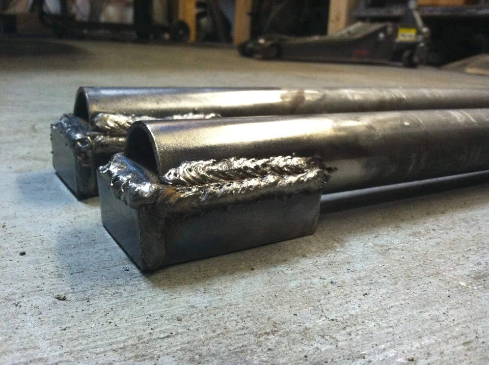

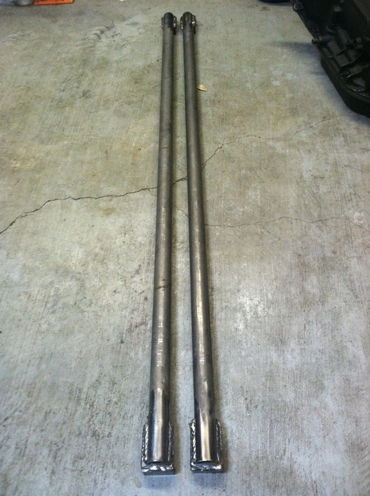

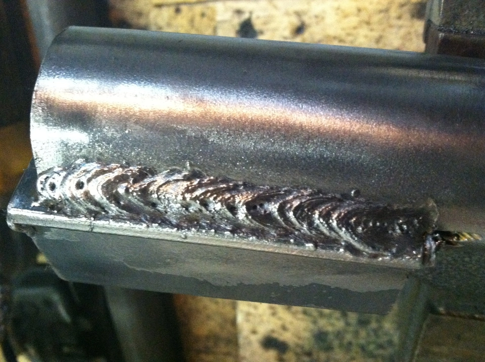

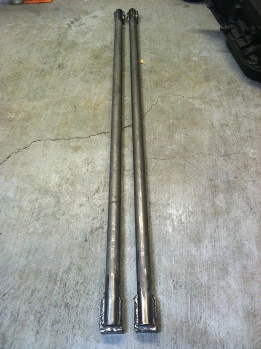

Well I decided to make some subframe connectors tonight.

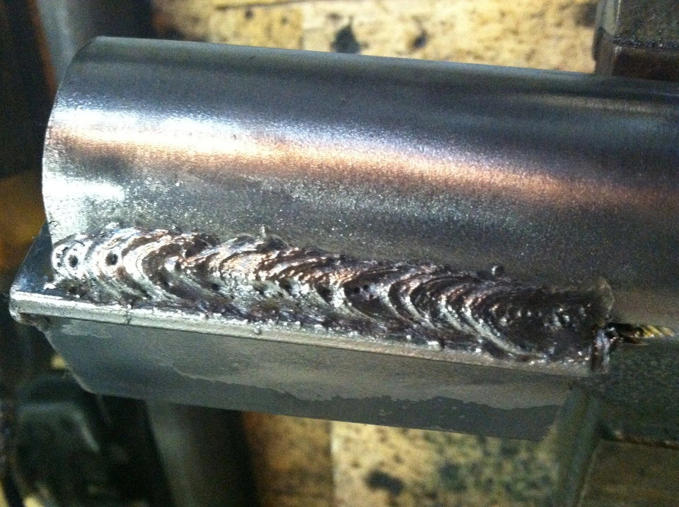

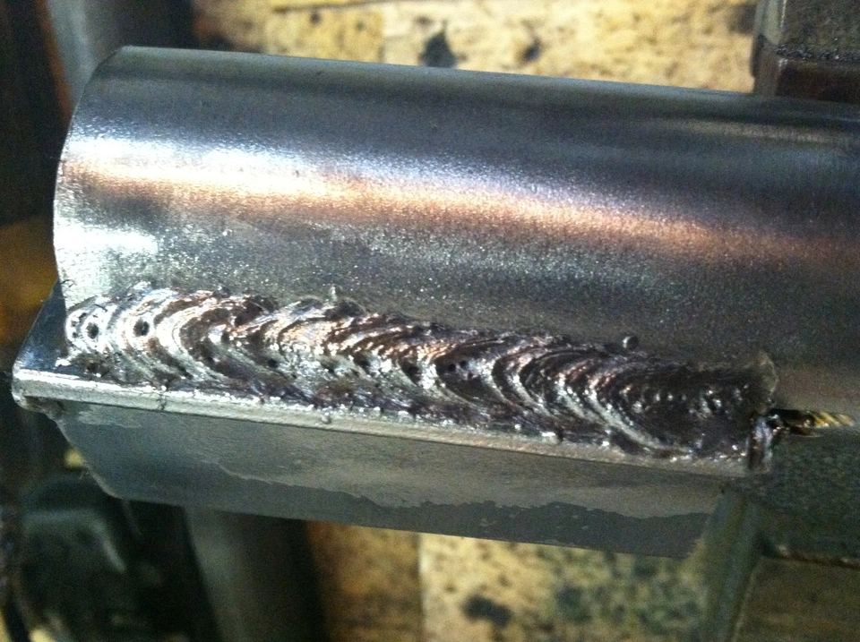

Some of the welds came out nice, others.... (I'll be really technical here) - others seemed to be full of air and "deflated" as I went, leaving a bunch of little holes in the bead. (the first two pictures show what I mean with the little holes). Since my technique has been under scrutiny lately, I'm offering up pictures of my work in hopes that I'll get some constructive criticism on what to adjust to make the welds better.
I adjusted the wire speed and voltage to no avail. Its a Hobart 220v MIG with 75/25 mix gas, and its incredibly simple to use, just seems to pick and choose when it wants to make nice beads.
