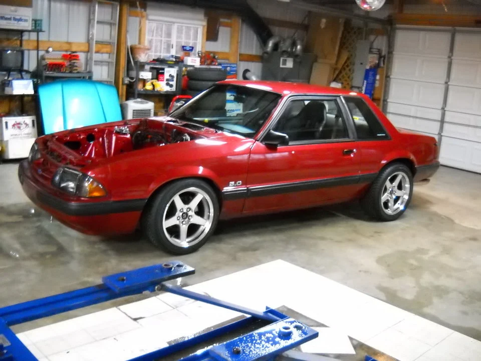

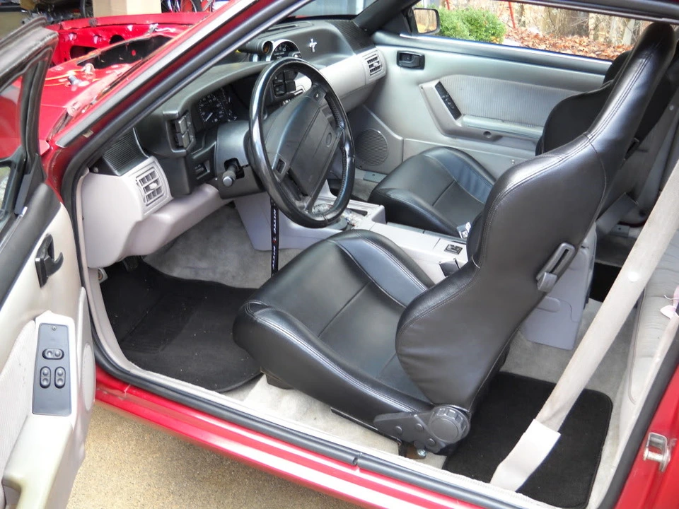

thanks guys! my name is Ryan too! hmm..:rolleyes: the seats are summit sport seats. i think i may be picking up another set of wheels here very soon... we will have to see if i can talk the guy down more. but theyre gonna look really sexy if i can get them.

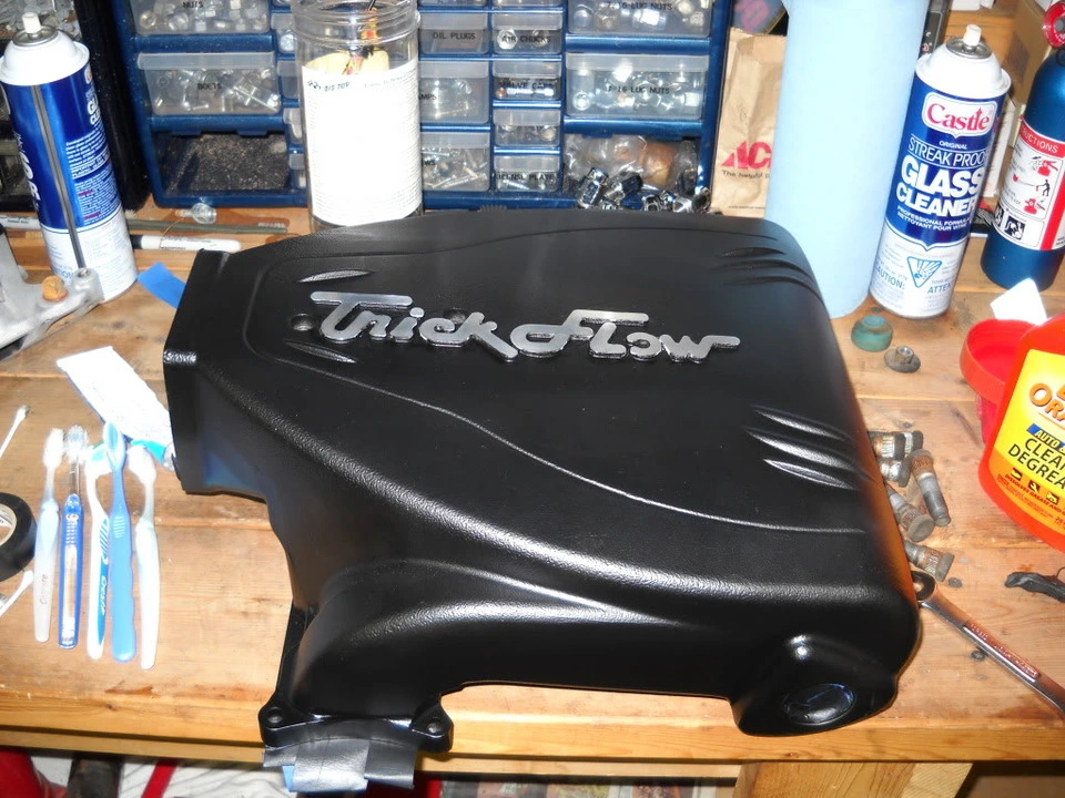

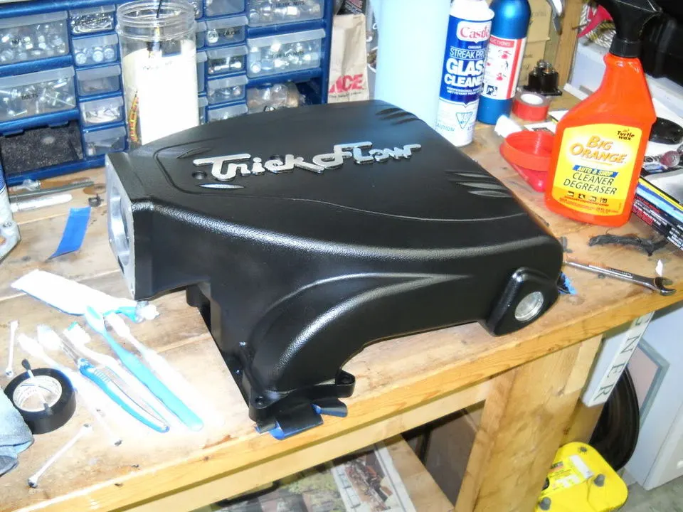

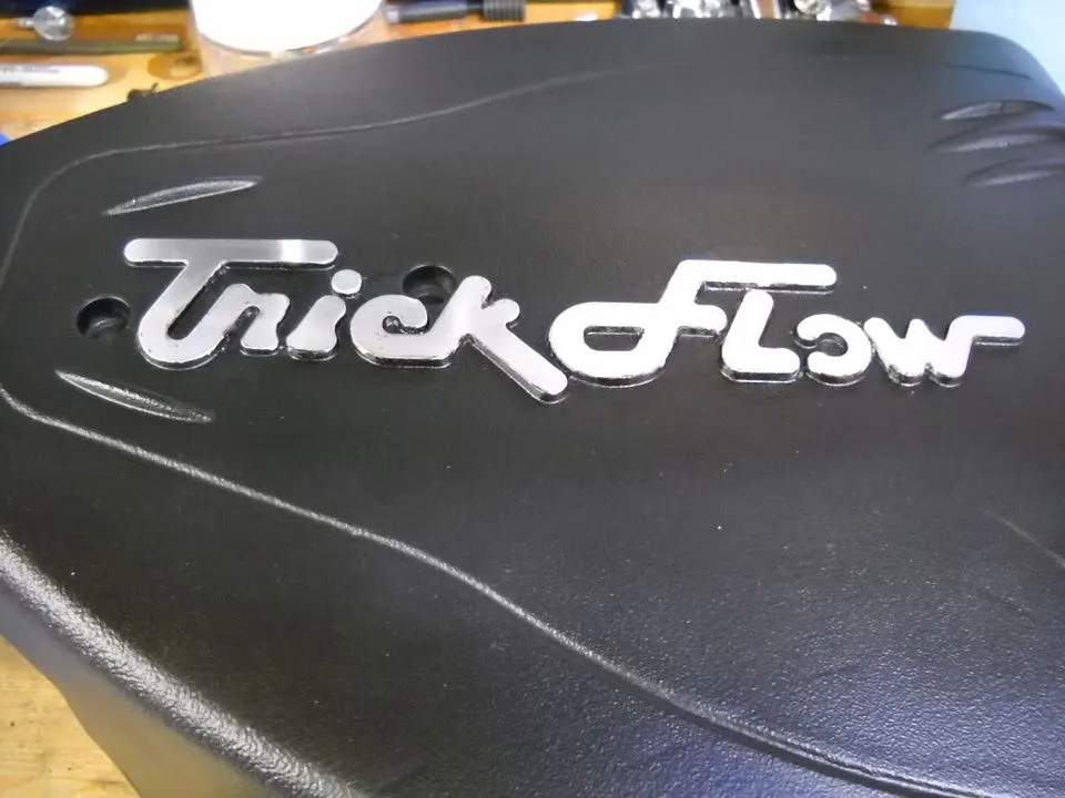

then i painted my Trick Flow intake black
Looks great! what paint did you use on the intake?

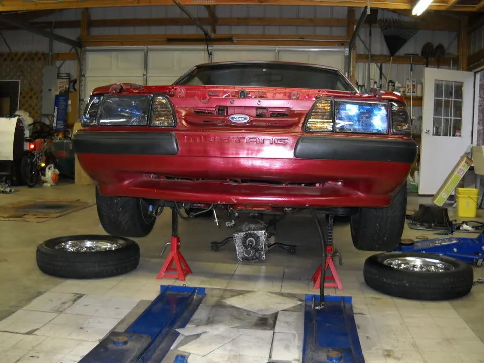

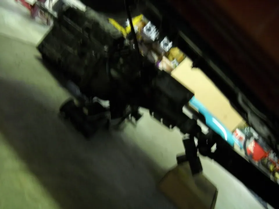

i pushed it back and started to fool with the tranny a little. i put a new seal on it to see if that will possibly stop the leaking, but id doubt it. its prolly the bushings back in there.
a full set of decent jackstands would be a nice thing to have!
i gave up right here. i had to slide it under there because my jacks wouldnt go high enough so i could get the tranny and the jack under the car... it was a pain but i finally got it on the jack under the car... but i couldnt get it jacked up so i said screw it! we will mess with it some tomorrow hopefully.

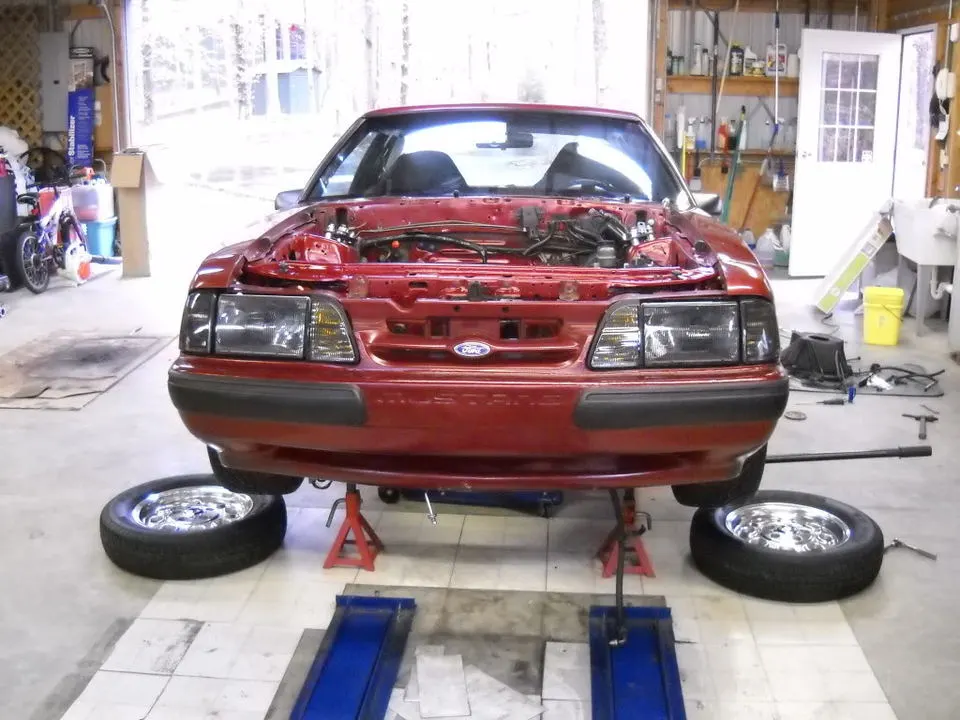

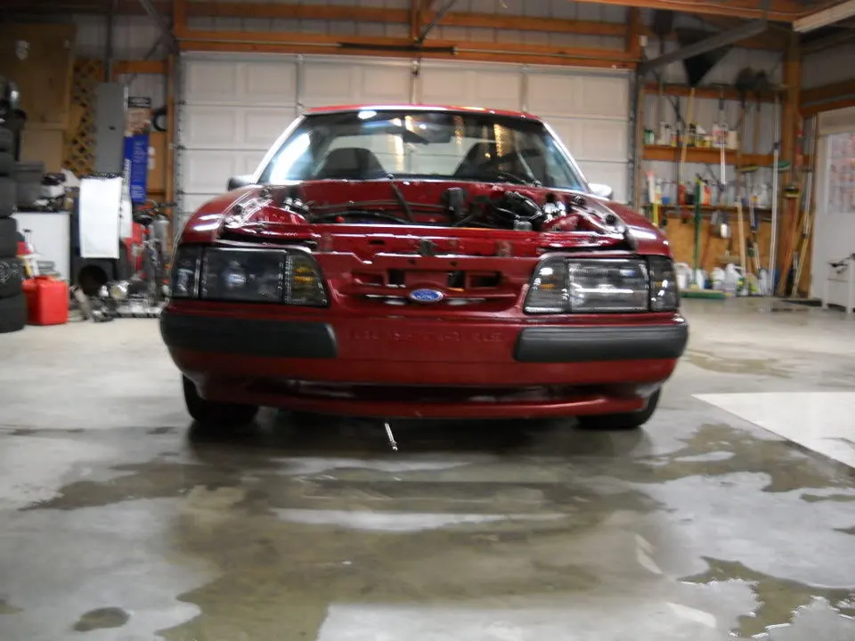

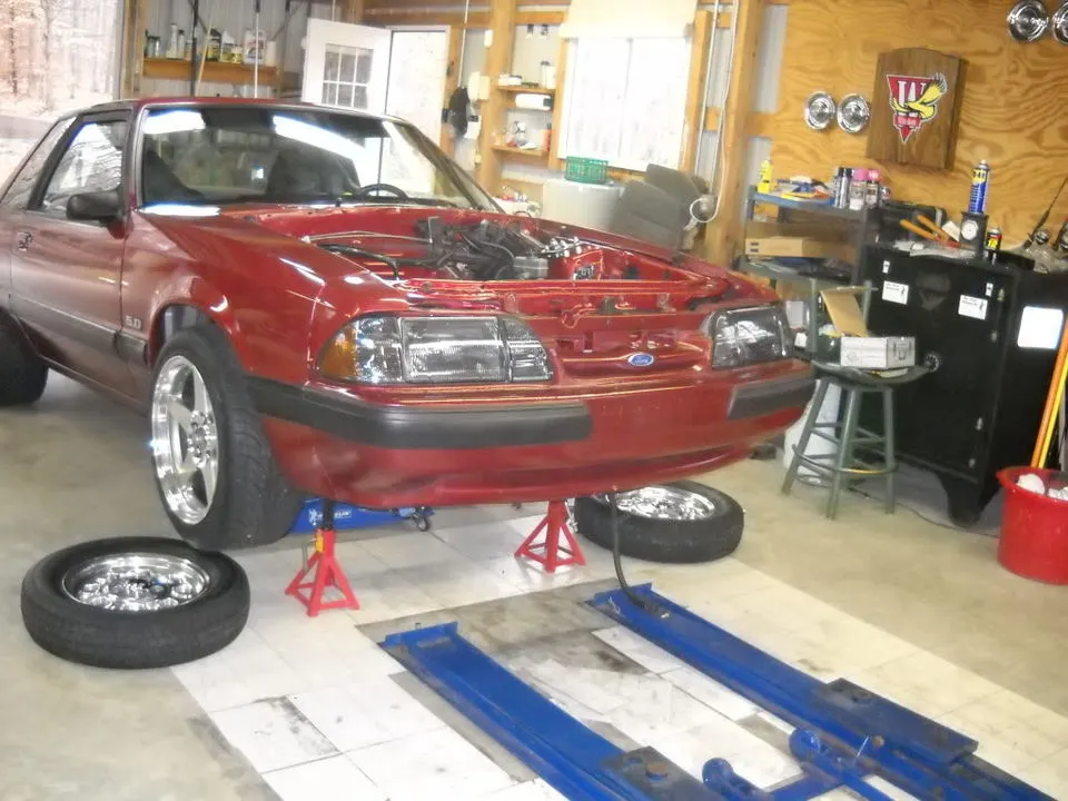

front end is back on for the first time in about 6 months.
i put a different set of corner lights in it too..
1 more showing off my new bulbs and my bumper cover which is in TERRIBLE condition... but hey it was yellow when i got the car so the spray can paint helped it out a little!

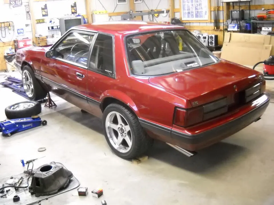

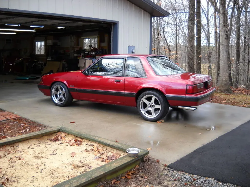

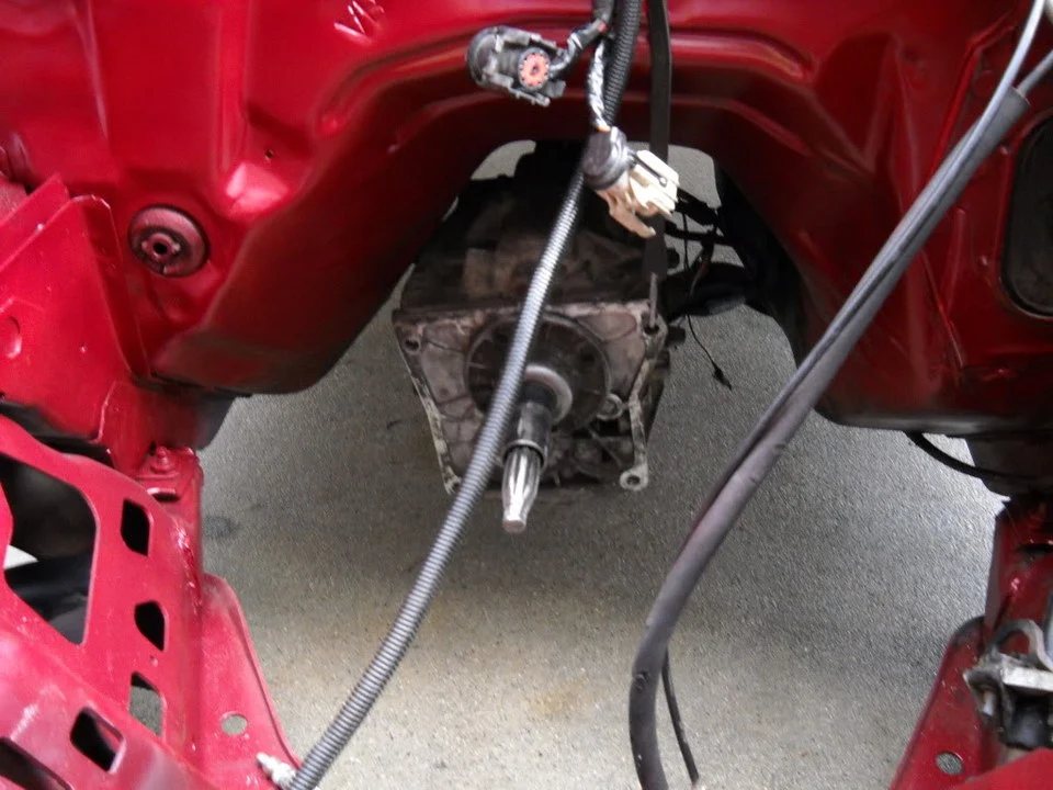

well today i got the tranny in!!! i just had to plan it out better. i was able to jack up 1 end at a time, put something under that end, jack up the other end,stick something under that end, and repeat this about 8 times. but i finally got it in!!! then, i pushed her outside and then dusted it off, quick detailed it, and took some pics!!
the interior needs a vacuuming but still is in ok condition
front looks good now

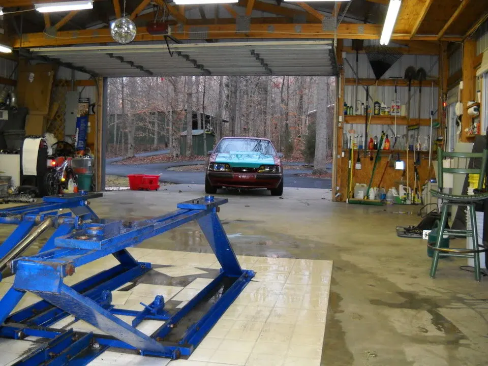

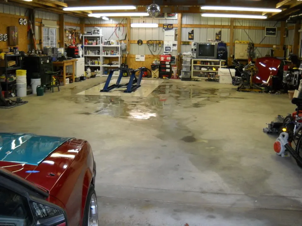

i spent most of the day cleaning up my garage. i hadnt really gave it a good cleaning in a while
thought these pics were cool as well
tucked her back in for a few more weeks. then she will come to life!!!!

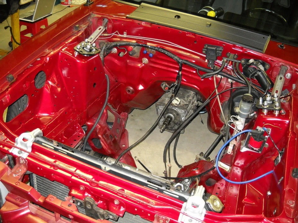

ok i made a little bit of progress on the car today.

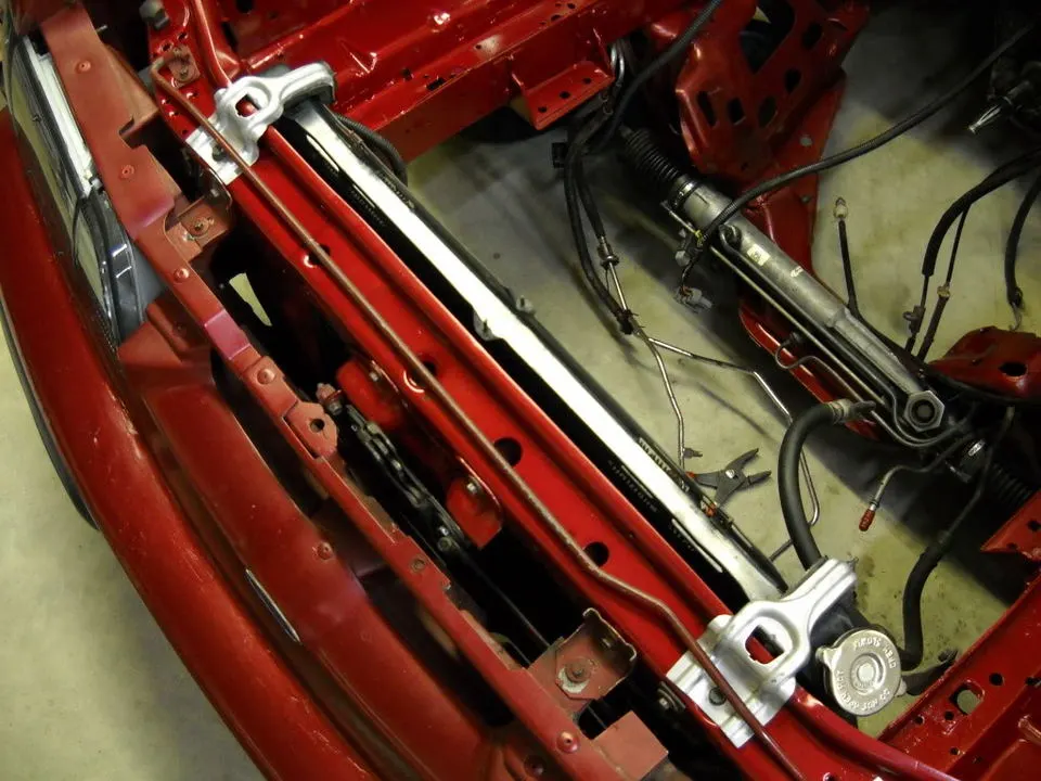

put in my radiator and ran the rest of my wires and PS hoses..

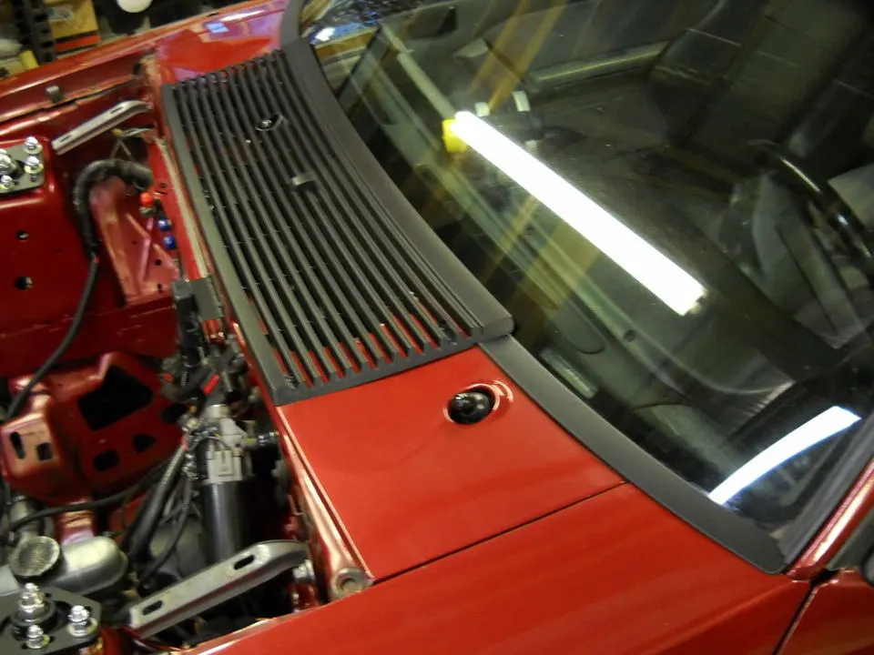

put on my new cowl panel and trim pieces.. still got to figure out what to do about my dented cowl. my cowl hood flew up during my FIRST time doing a WOT pull. the car hasnt been started since that day. that was when i tore it apart out of anger.

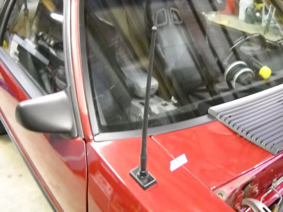

heres my retarded looking ghetto antenna

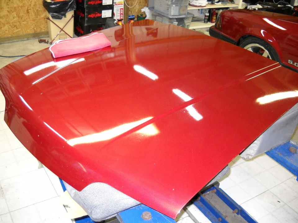

and i got my stock hood out and polished it up. its going back on for sure.
