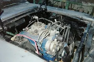

Lman, conversion was completed back in '04. I used a 302 I found in an 84 mustang (it was an origional block from a 68 galaxy). Conversion went pretty smoothly until we tried to fire up the engine and found out it had a 351 firing order. Whoever rebuilt the car put on some newer parts.
I've included a picture to show the engine right after I put it in. The only dif now than in the pic is I went to a v-belt instead of keep
