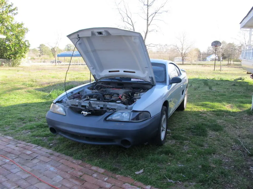

here she is before the tear down.

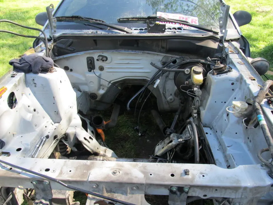

motor out

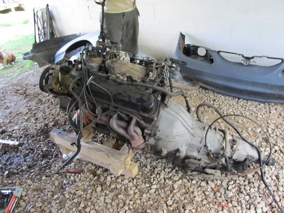

motor ready for to be scavenged off of

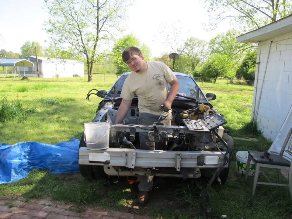

my goofy self working on cleaning out the bay

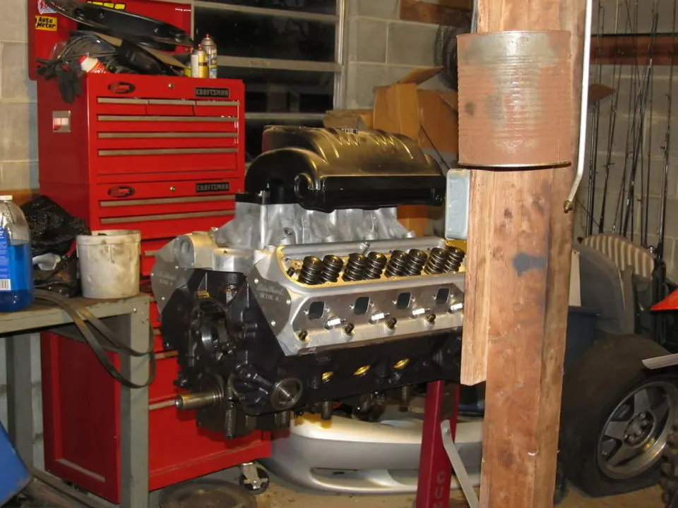

the new motor on a mock up just to get my moral up
