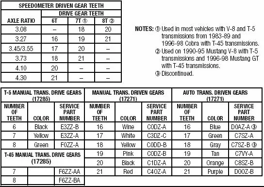

This chart refers to factory OE configurations and tire sizes, so only use it for speedo gear part number if you have changed things.
Middle part number is 17271, so if you wanted a 20 tooth black gear, look up part number C1DZ-17271-A

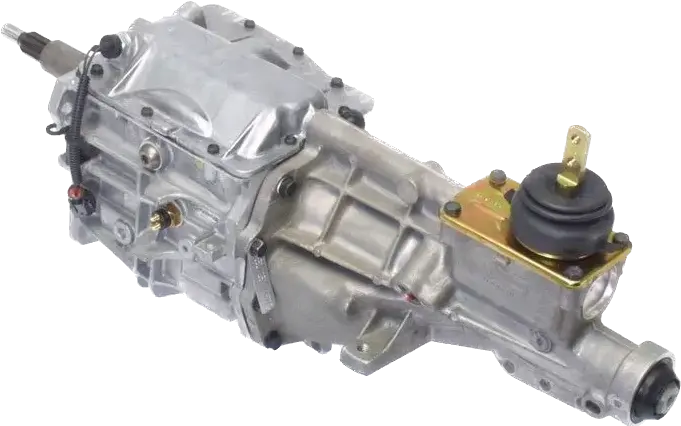

No possible way to remove the tail housing without removing the shifter and driving the roll pin down just enough to release the detent block (block on shifter rail that the shifter ball goes into). Once that is done you slide the tail housing back being careful to capture the ball and spring under the block.

Hey so what about on a lift and is it possible to do all of that or not even on a lift but if the car is on jack stands is it possible to leave the trans in remove the shifter ball, in other words can you drive the pen out enough and put it back in can you get to all of that decently with the trans still in the car?
