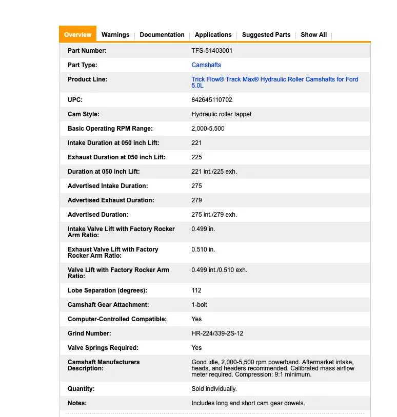

Trickflow twisted wedge heads, track heat intake, Track Max cam
