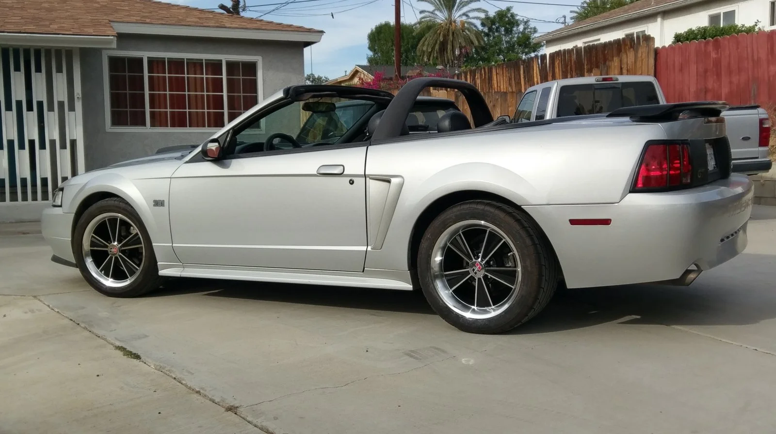

17x9 and 17x10.5 with 275/40x17s in front and 315/35x17 in the rear (needs to be a bit lower though)
