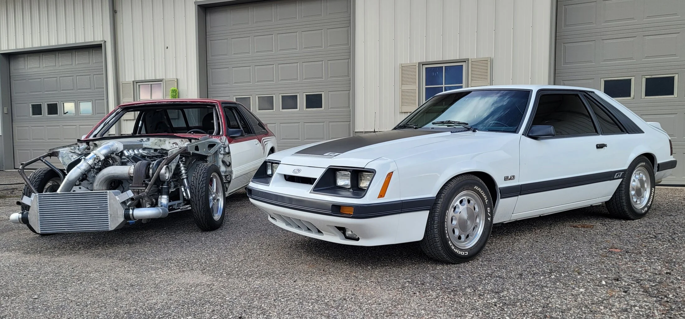

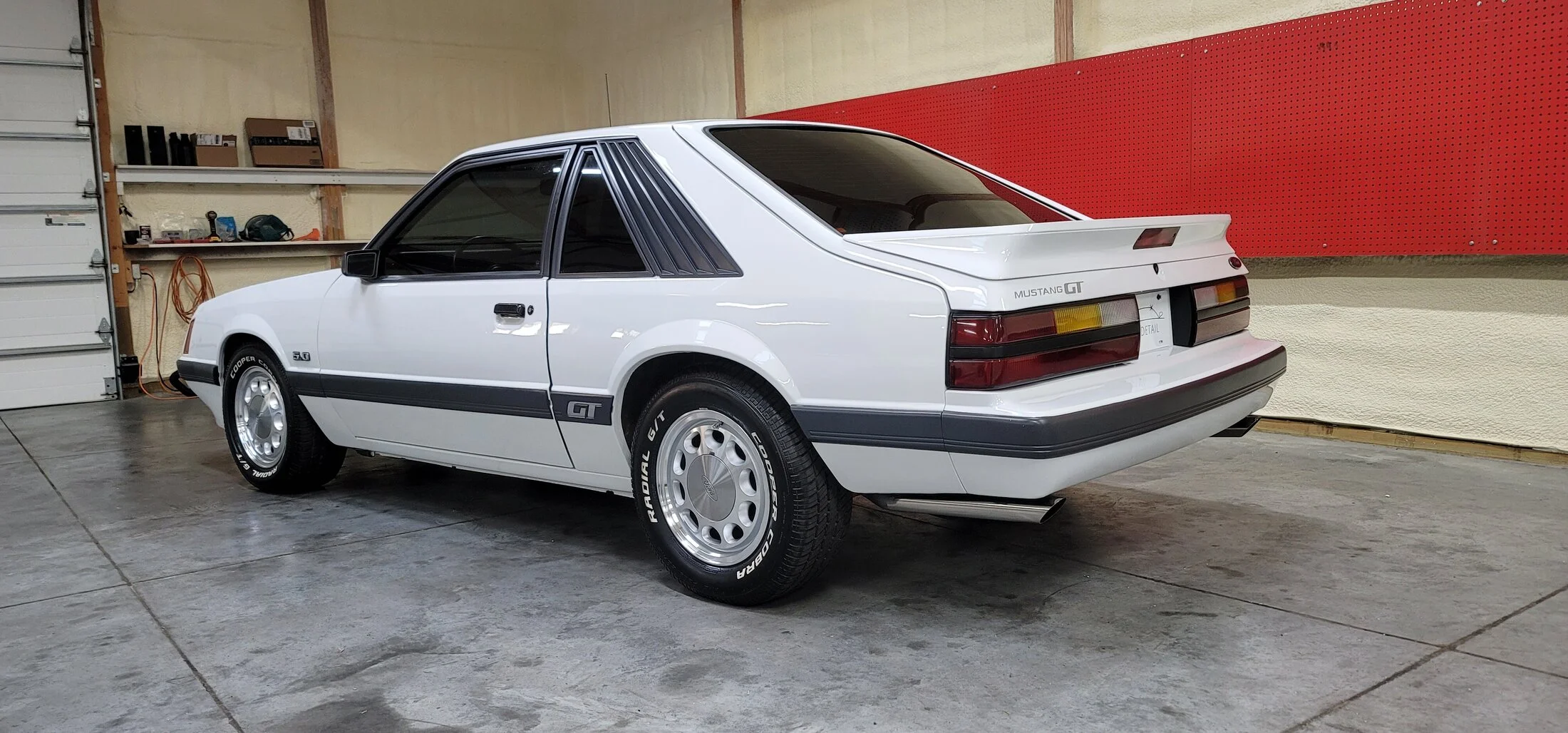

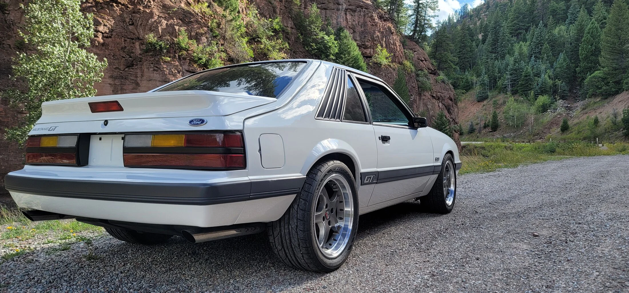

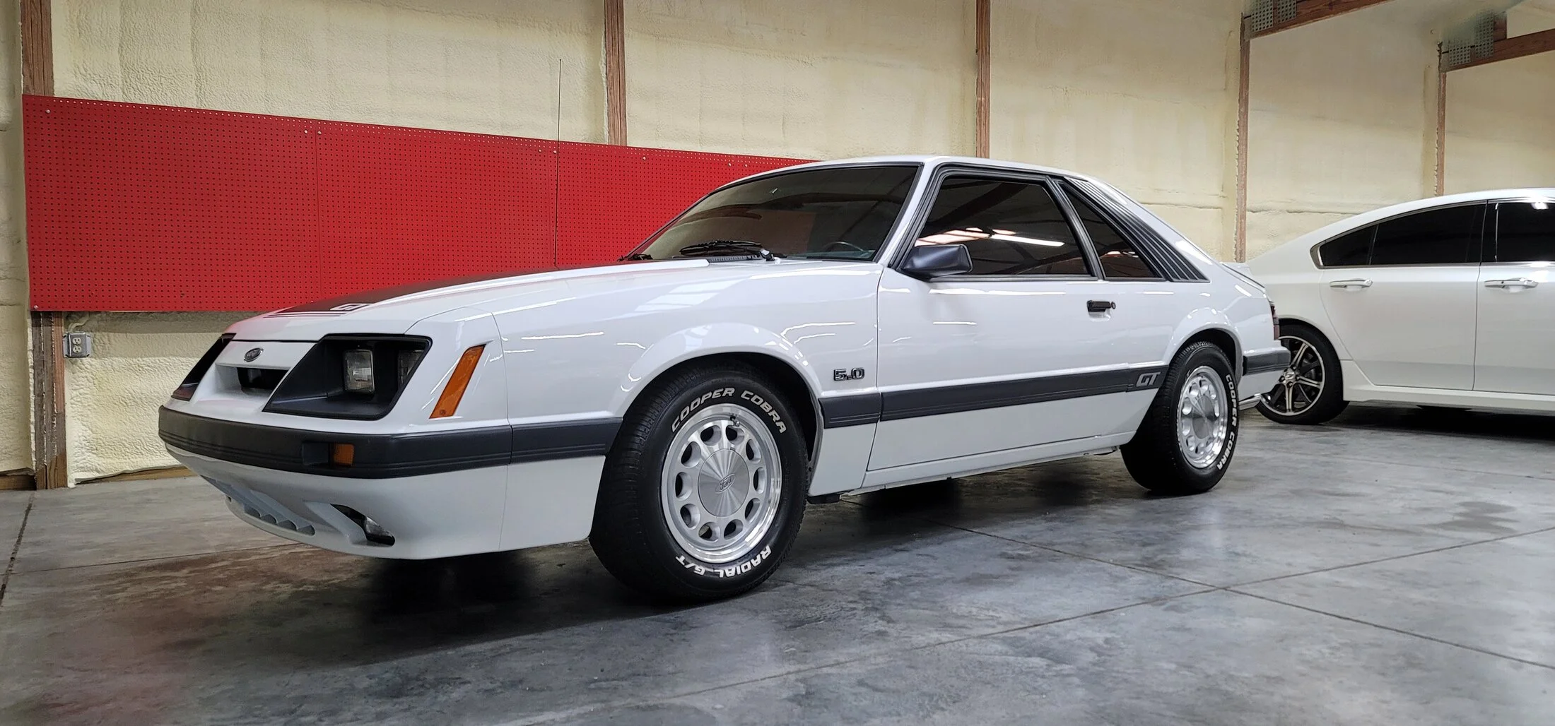

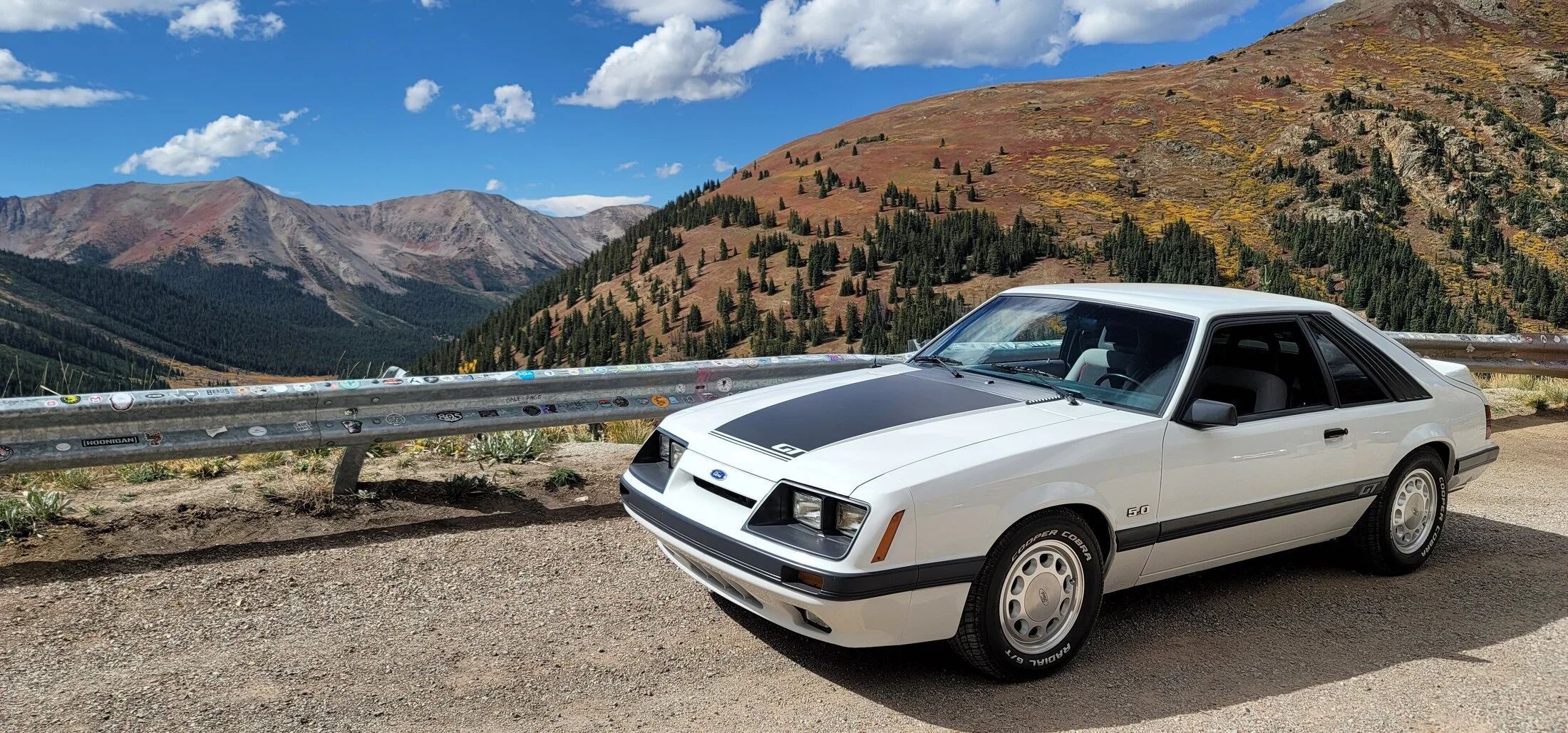

I bought this car from the guy who purchased from MRaburn. It was in pretty much the same form with some repo Cobra R's and tint.
Intent is to leave it alone as a cruiser since I have a full tilt 92 that's under the knife. First thing I did was put the 10 holes back on.

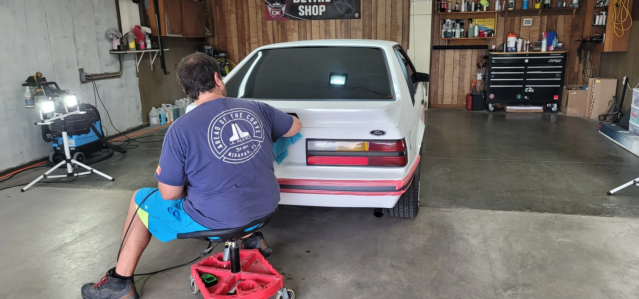

Paint was cloudy so cleaned, corrected, and ceramic coated.

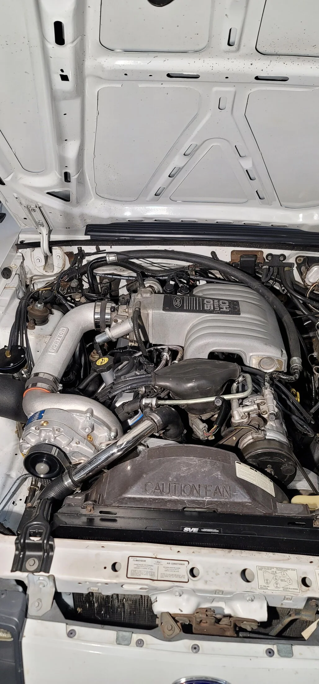

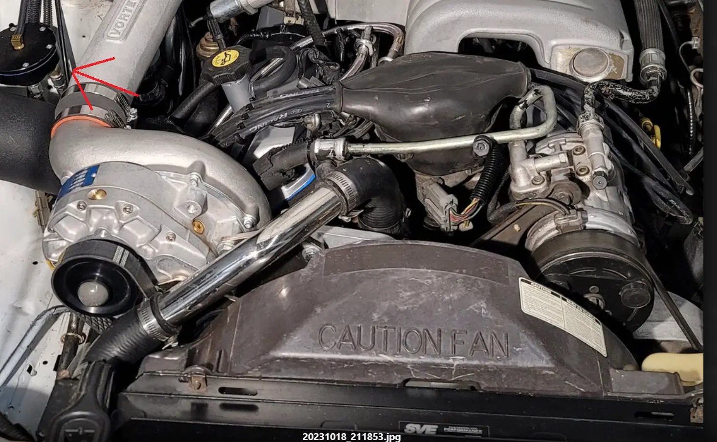

Car had a pretty significant rear main leak, so installed new seal and clutch. Cork VC gaskets were leaking and was a nice mouse nest under the intake so replaced those as well. Ran hot on the trip home, added a 3 core radiator and new fan.
Always wanted a Vortech on my 92 when I was in hs, and found a sci heritage gear kit on sale from Beefcake racing.
Excited to enjoy the car, it has some other issues I'm going to iron out over winter but it is exactly the car I was looking for. Thanks @MRaburn
