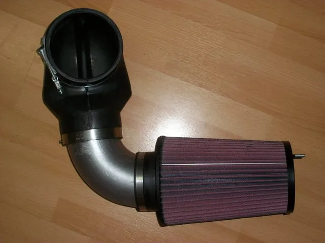

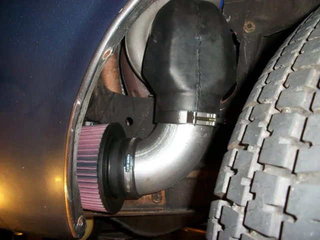

I'm sure he has an air filter, or screen at the minimum since its pulling air out of the fender where the tire is. Unless he has it ducted somewhere else on the intake side of the turbo.

Power steering is over rated IMO. I did not own a car with it for the first 11 years I had a drivers license. With skinnies on the front it definitely is not an issue. The air cleaner is tucked in front of the front tire.

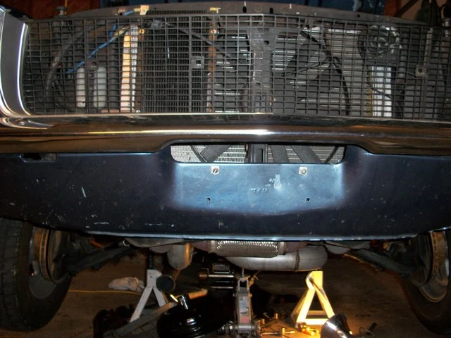

This is two 3" pipes going under the steering. It is much less noticeable when it is on the ground. With a 302 block you can go over the valve covers and down by the fire wall. I would be easier at that point than long tubes.
