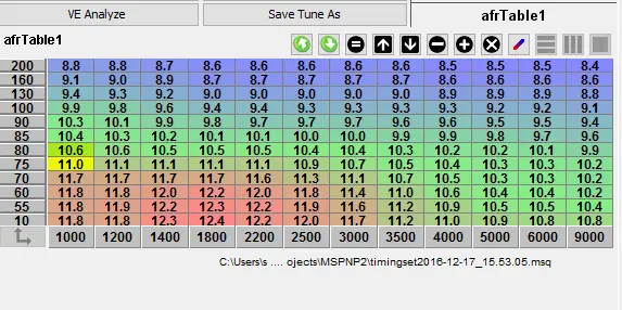

I did this with my " snippet " never knew I could do this... These are the different afr table view between MLV and TS
The lower table is correct and is what should be used. The upper table is totally fubar. The upper table says you want 8afr in boost and is totally wrong it's not even close to a useable table.
Load your new tune into megalog viewer it's still referencing the old tune.

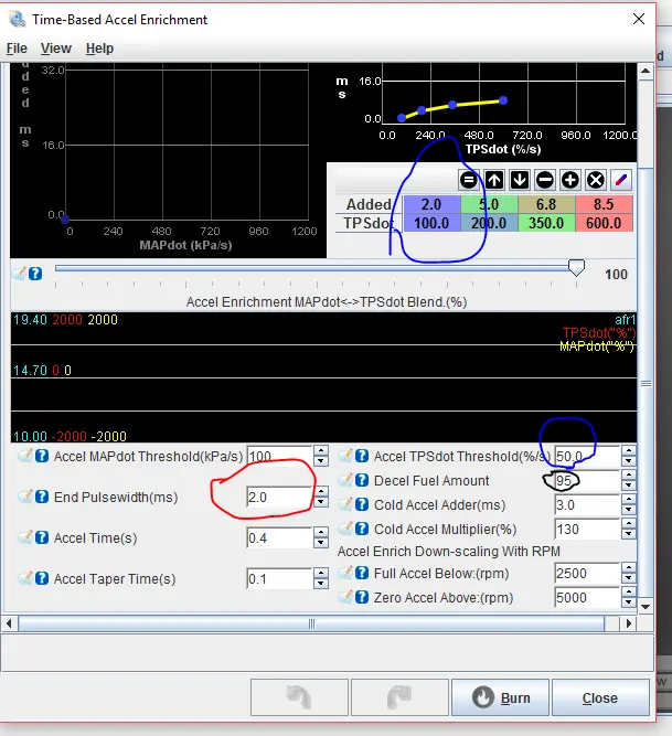

That's what I did. I shut-off over-run fuel, but my decel is at 85% per the logs showing a very quick rich state at (-) tpsdot values. this helped correct that. I was planning on what you recommend after tuning the VE table for decel. Since over-run was ON it ignored those sections of the VE table. I will probably lowered to more like 16.1 AFR to get a little better mpg.

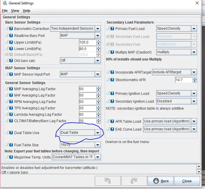

Found your problem its a simple fix.
change this to single table, right now you basically have 2 separate fuel tables to each injector bank.
Next up is your AE settings these changes will be mostly for drivability...
-blue needs to be changed to 10 for tps dot this will stop the lean surge on light accel.
-red needs to be 0 and nothing but 0 or it will skew the entire fuel table while tuning I don't even know why its an option.
-black should be 100

On the second go round, I went with 2 fuel tables (additional one for boost). should I just stick to one?

one table is best for simple builds. you will need 3 lines above 90kpa
100kpa
135kpa
170kpa
that is all.......
in ign... just one above 100kpa
170kpa set your total boost timing in here this will pull timing linearly just like a btm
