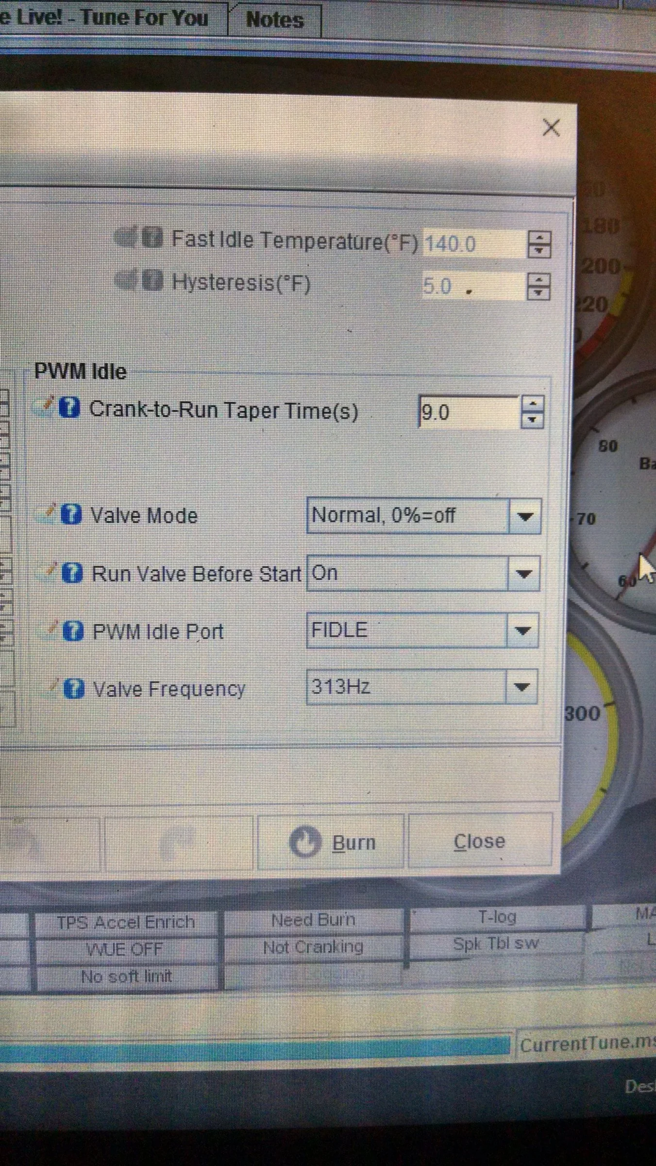

just got done looking at the datalog and if you chart rpm with PWM idle duty you can see the car idle away at 900 rpm with the iac open 100%.... when the duty cycle drops the rpm comes up.... this is backwards to what should be happening. the valve is working in reverse.
go into startup/idle then [idle control] on the right side of the box in pwm idle settings change the valve mode.
this should fix the problem the mode should be set to "normal" 0% =closed
on a side note the datalog shows you idle very lean in the 20afr range please verify this.

I just added PWM to the datalog graph and instantly saw the problem...smh. I'll change those settings and check out how he runs tomorrow after work.
The lean condition is from an air leak at the v band behind the turbo before the WB. I planned on fixing it when I put the down pipe sleeve on. Starting and idling has been my focus thus far. I'll fix it before I really drive it.:burnout:
Just checked my idle control settings in TS. The valve mode is set to normal, 0℅=off.
I switched it to inverted, 100%=off. We'll see what happens tomorrow. I'll post a catalog.
Thanks, Steve !!!
I've read were people had to reverse polarity with certain IAC valves. I'll see if I can command it open and closed and watch what it actually does.
