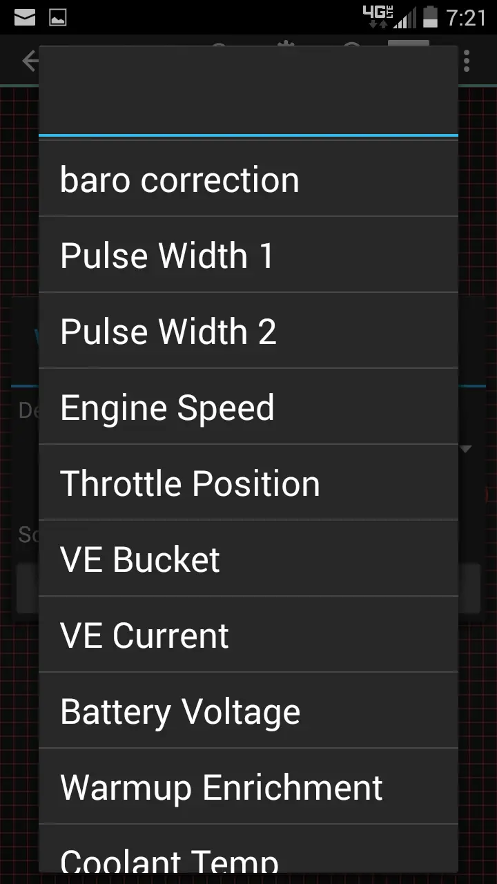

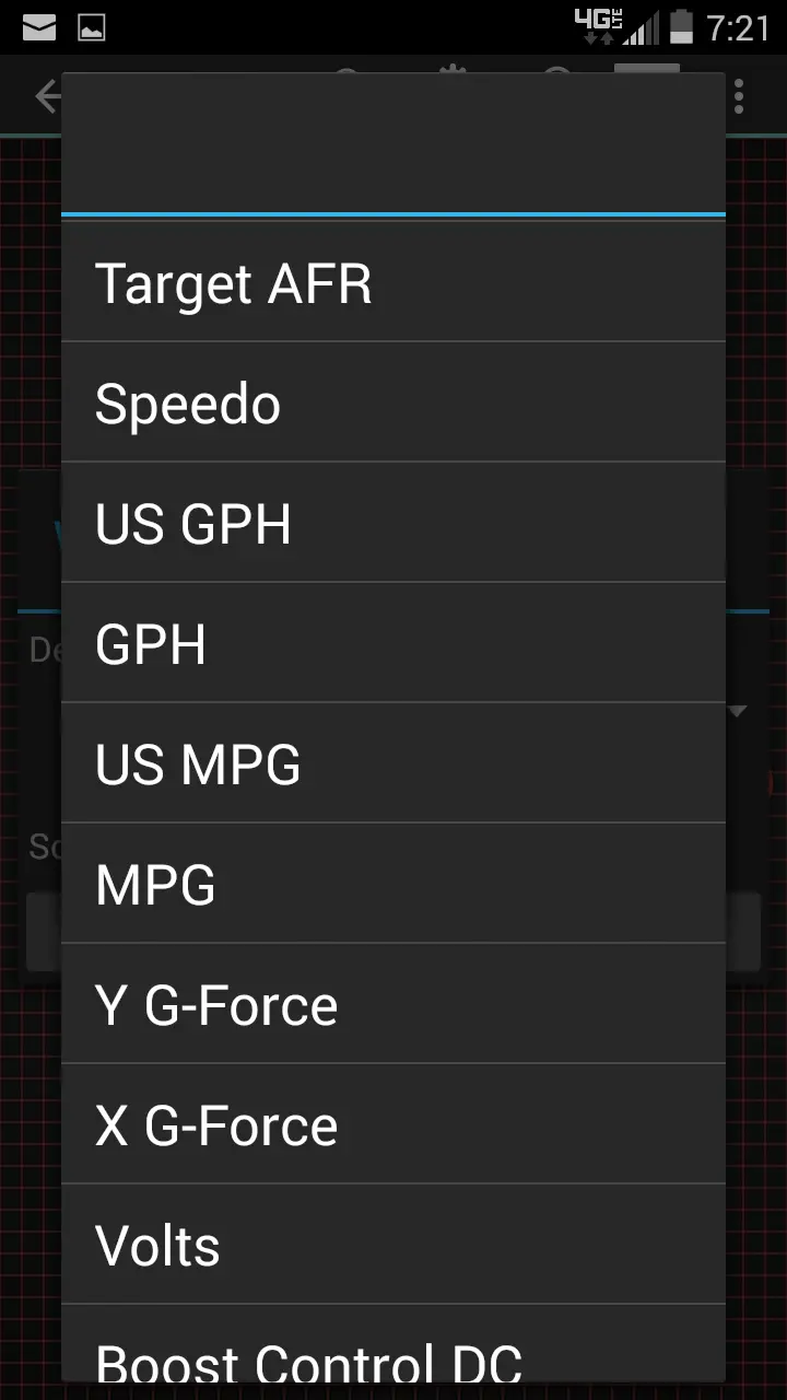

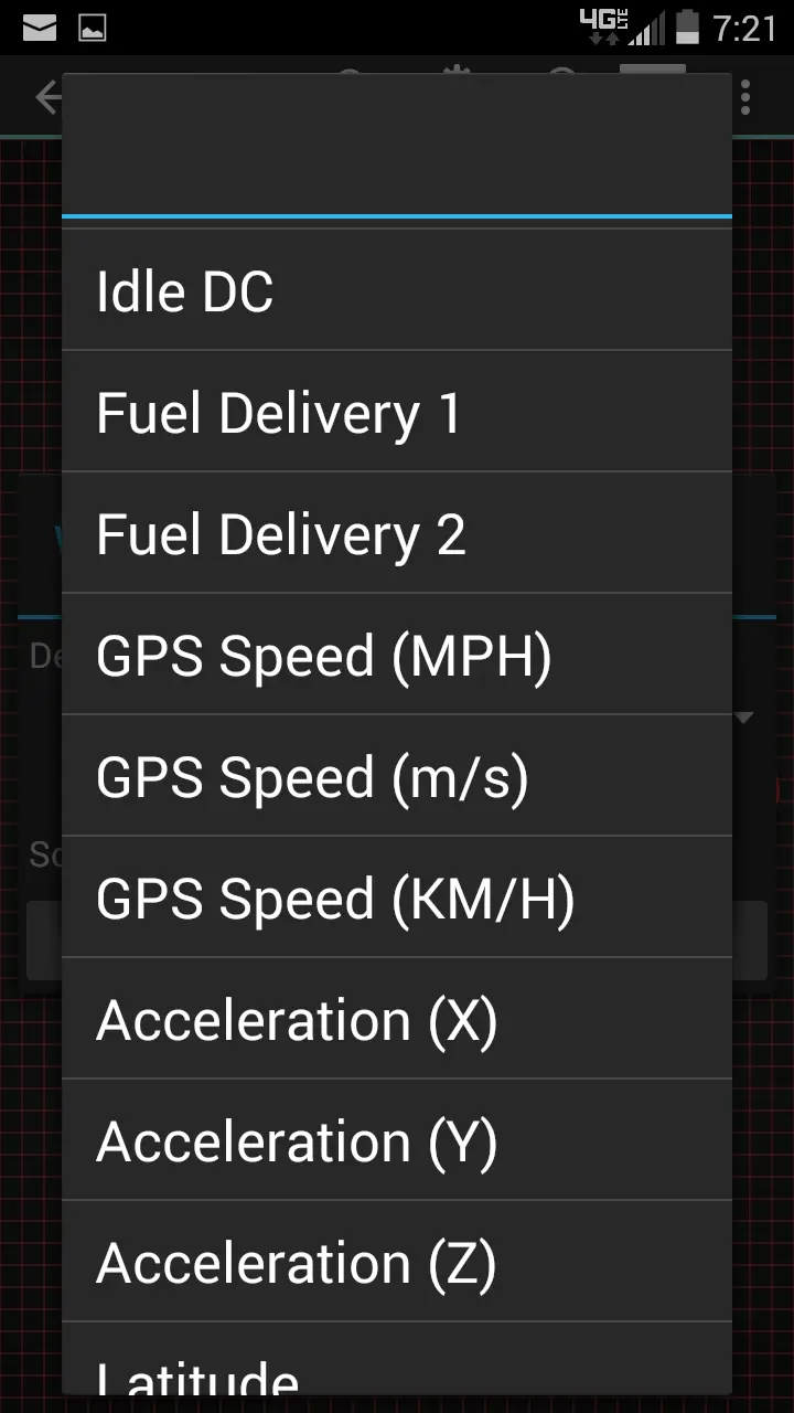

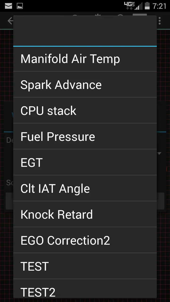

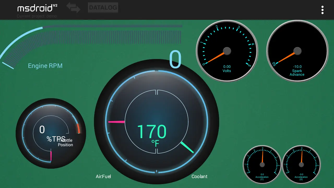

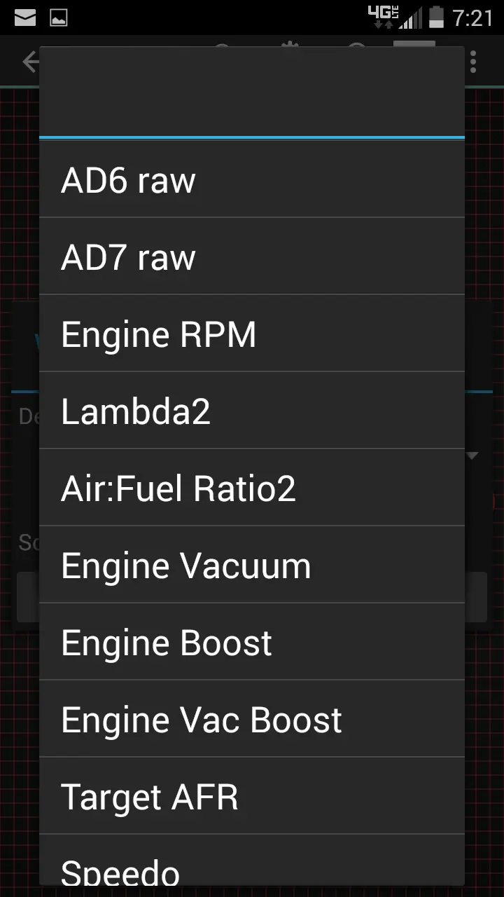

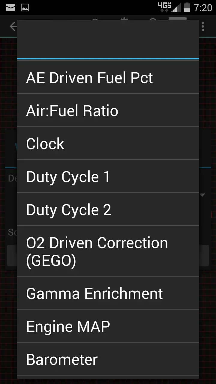

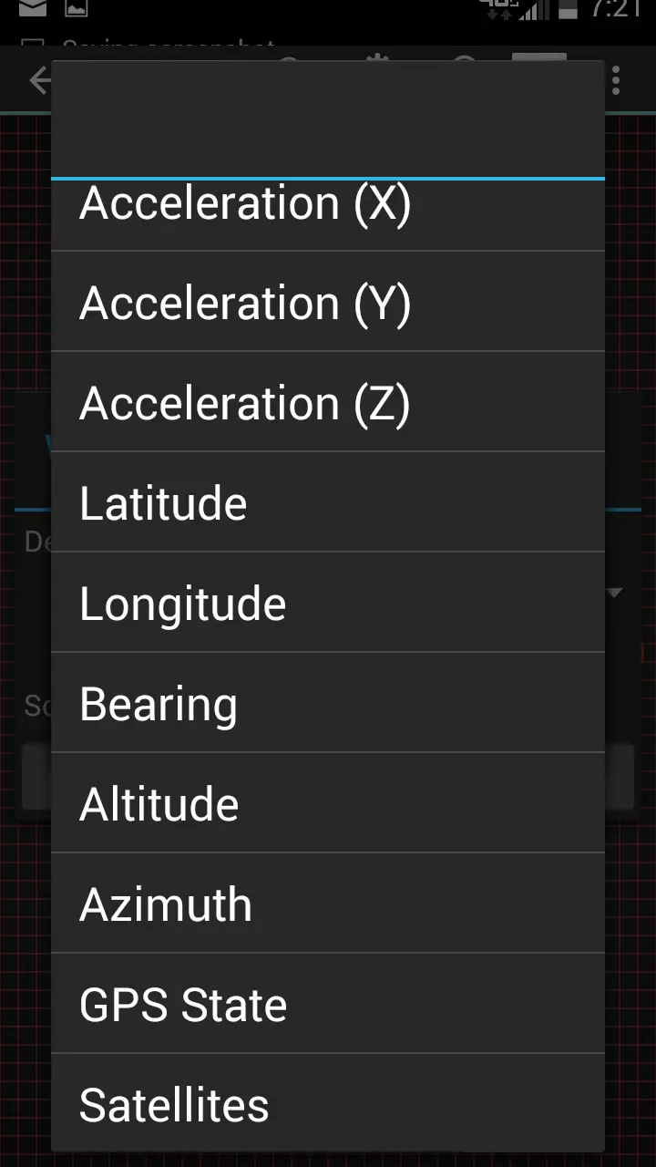

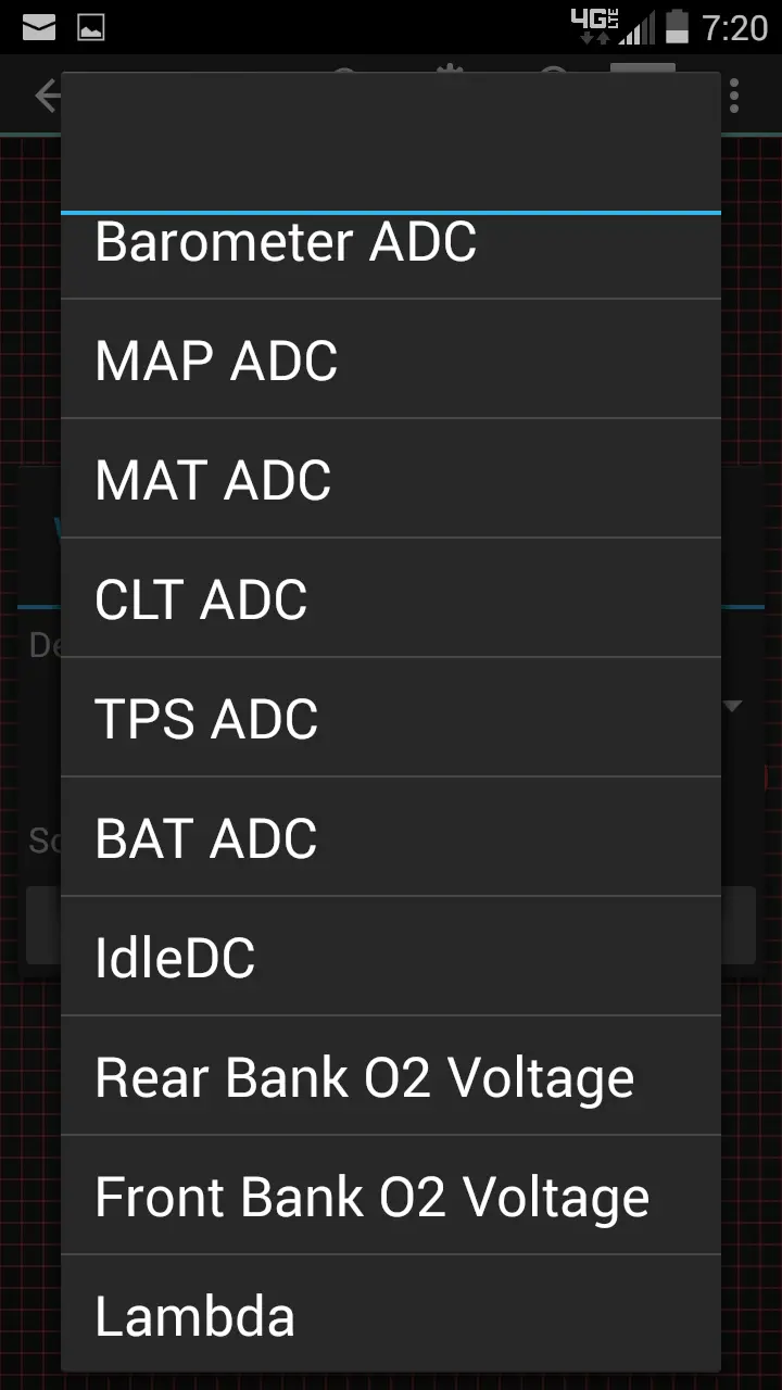

I'm going to try it on my verizon droid mini dumb phone. The app works OK. The gauge editing is similar to TS.

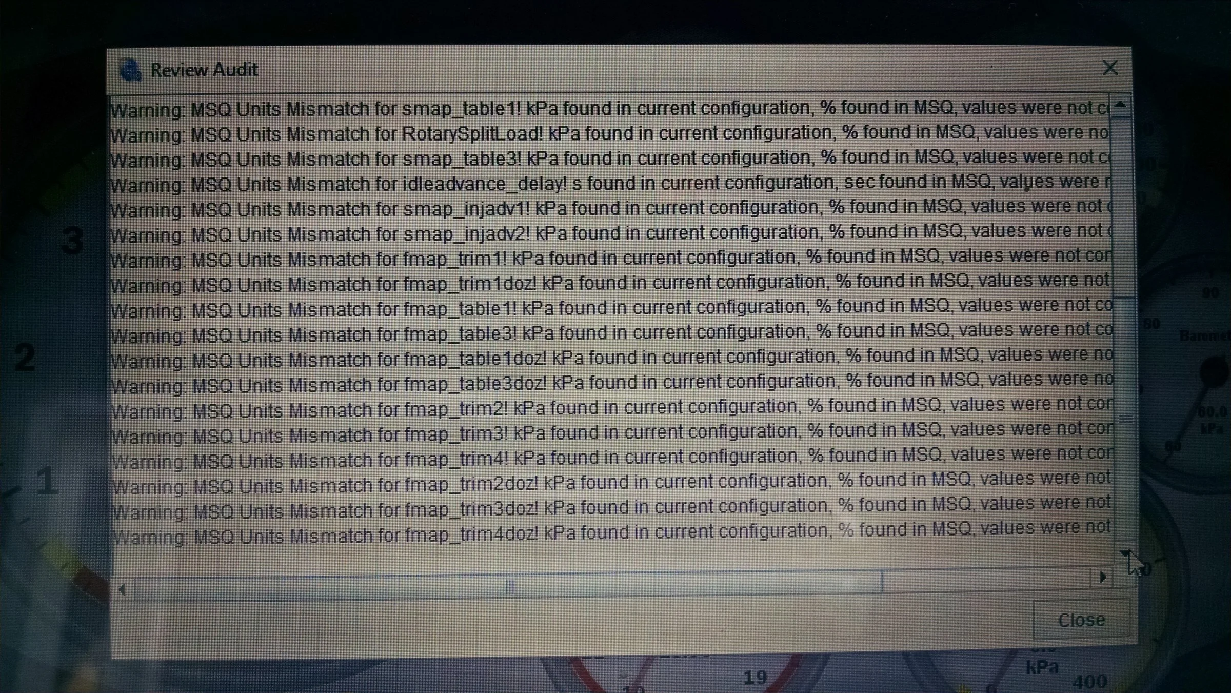

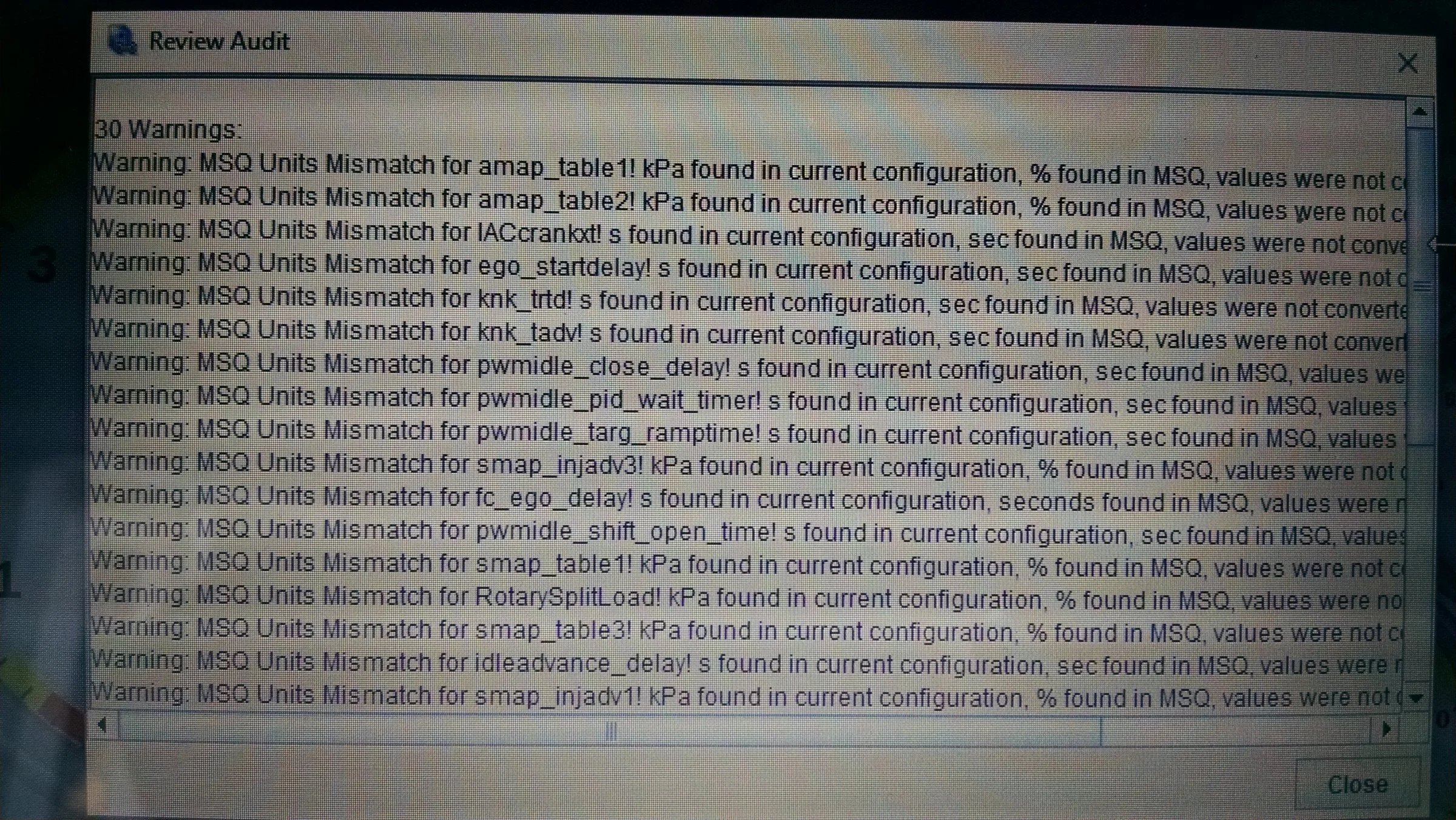

I tried to load the tune you posted but got warning that it was running 3.3.0 instead 3.4.2.
It gave me 30 warnings about MSQ unit mismatches. Values not converted.
