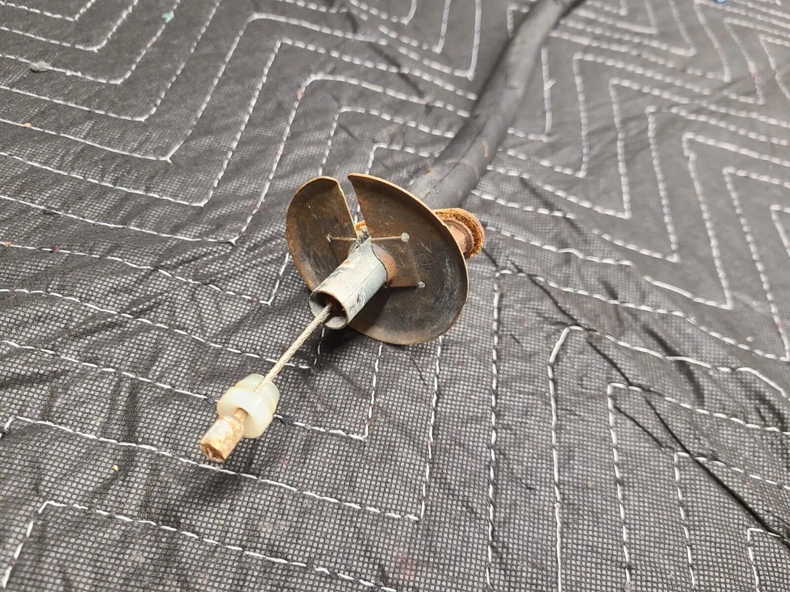

So what is that disc anyway? Where does it go? I have not been able to u cover much about it. I'll put it back In If I need it.
Hey there, on the outside of the firewall you have your 2 screws that hold your throttle cable to the body of the car, the black disc is what holds it inside to the inside body of the car,its basically a reinforcement. if one had X ray vision, you could see it right behind those 2 screws holding it onto the firewall
Once you secure the cable to the firewall you go inside of the car and align the disc onto the silver looking shaft the best you can (there is hardly any room in there) and then use something to push it in, you could use 2 really long strong screwdrivers , one on each side and just drive it in slowly, eventually it will go in all the way and seat against the black Dinamat looking pad inside the interior firewall.
The disc is spring steel and it has a cut down the middle,if you grab each side of the disc and bend one side in and the other out with pliers on each end the inside shape of the disc will change and make it slightly bigger and it slides with no effort onto the cable metal shaft,once you let go of the pliers the disc returns to its original shape.
Problem is, you cant do that inside the car cause there is no room so you just have to push it in real hard and it will slide in slightly scrapping the metal shaft, its a tight fit believe me,i would assume by the shape of the disc and how it has a cutout and a little hole in it Ford probably had a special tool to put that disc in in 5 seconds OR they put it in before they mounted the dash,lol
Here's a good picture of what it looks like.
