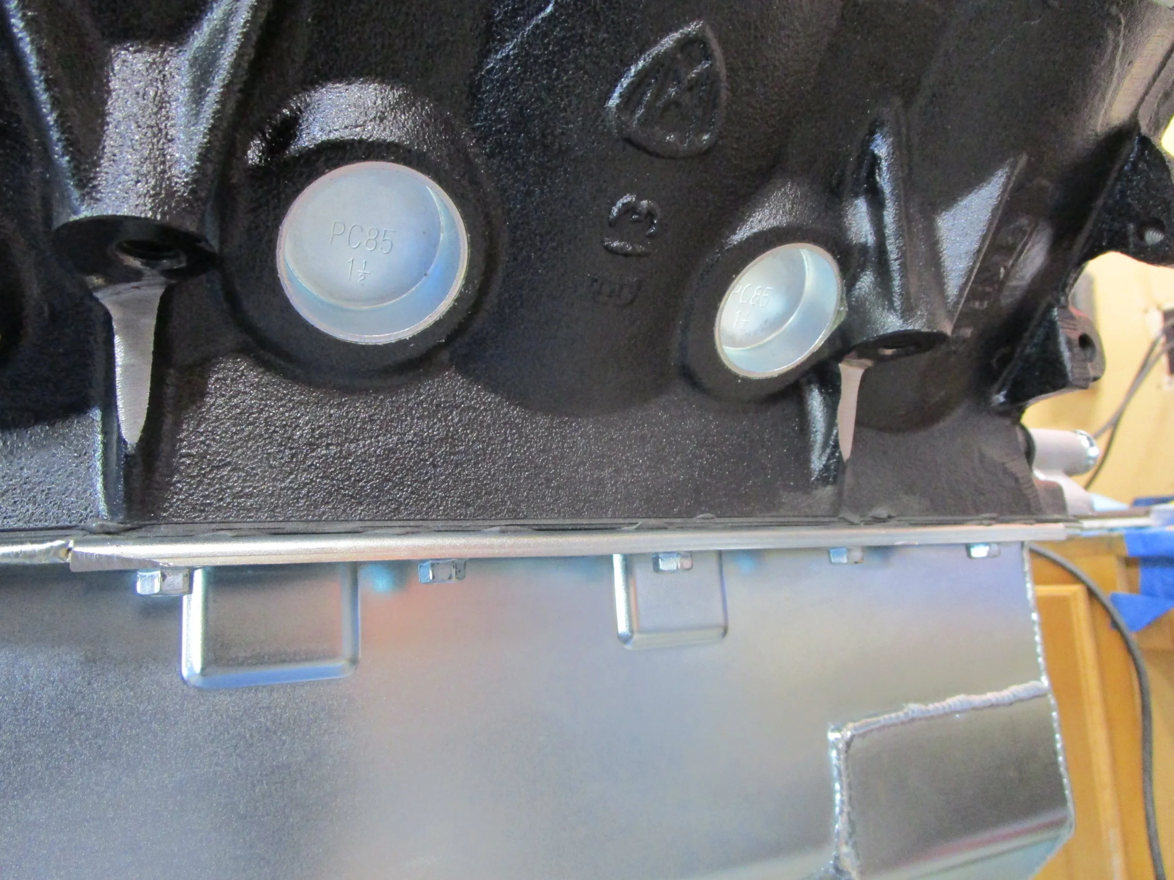

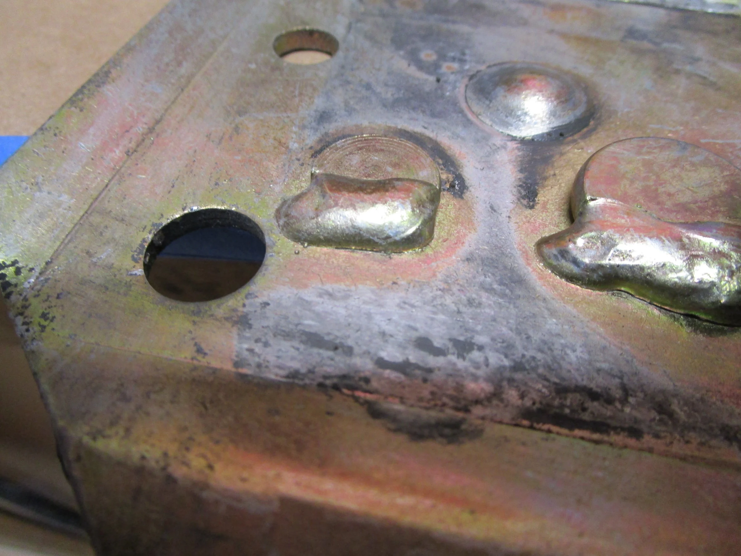

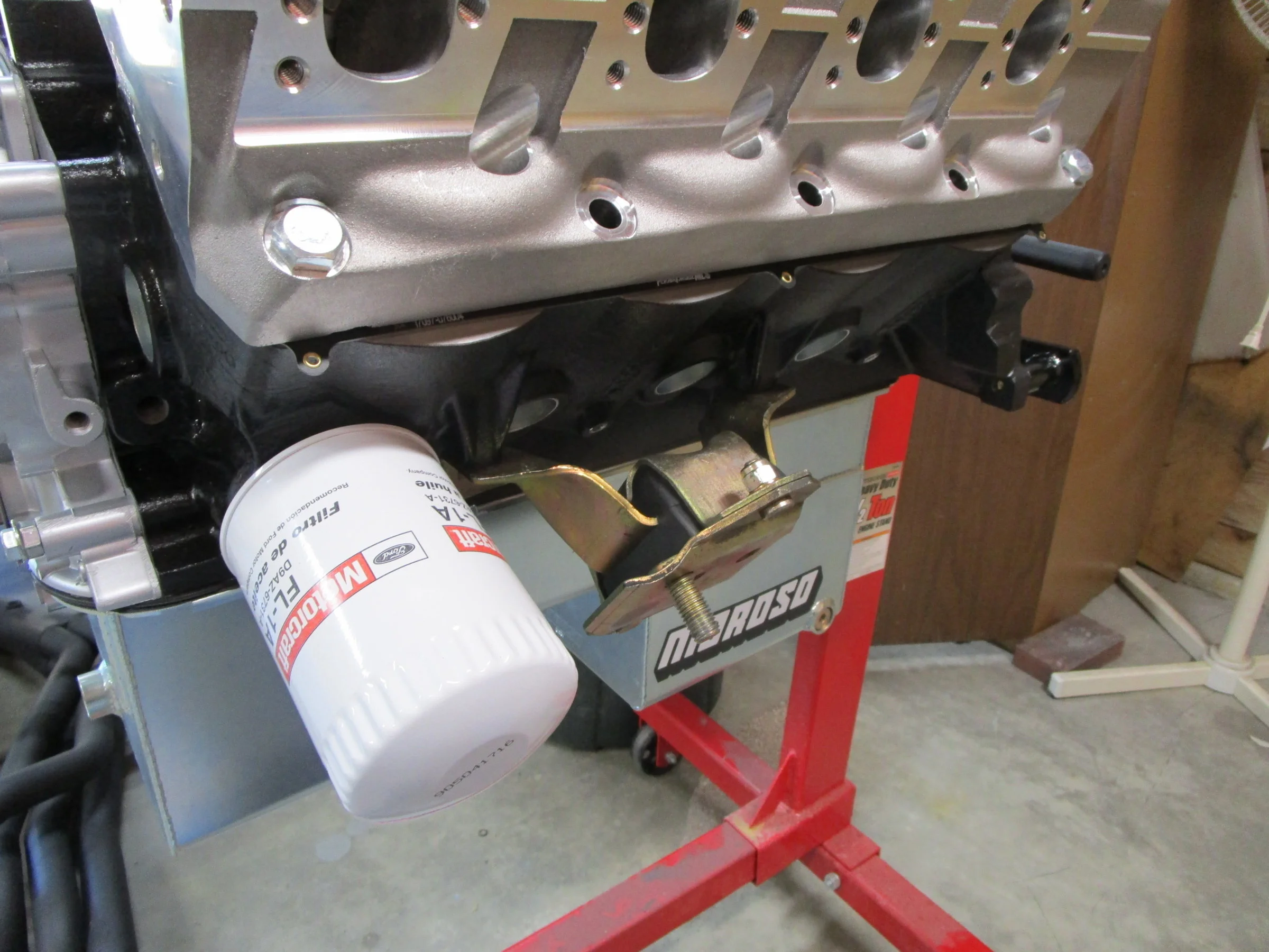

#1) of course the "pins" in the motor mounts don't fit into the K, thankfully I checked this BEFORE I put them on the engine.
Looking at them, and seeing their bolted together and the pin looks to be a separate piece that maybe I can just press out. Its' not. Big ole chuck of weld on it :poop:
A 40-grit flap wheel ended up getting rid of the pins. At least I got to see how these mounts where made though so :shrug:

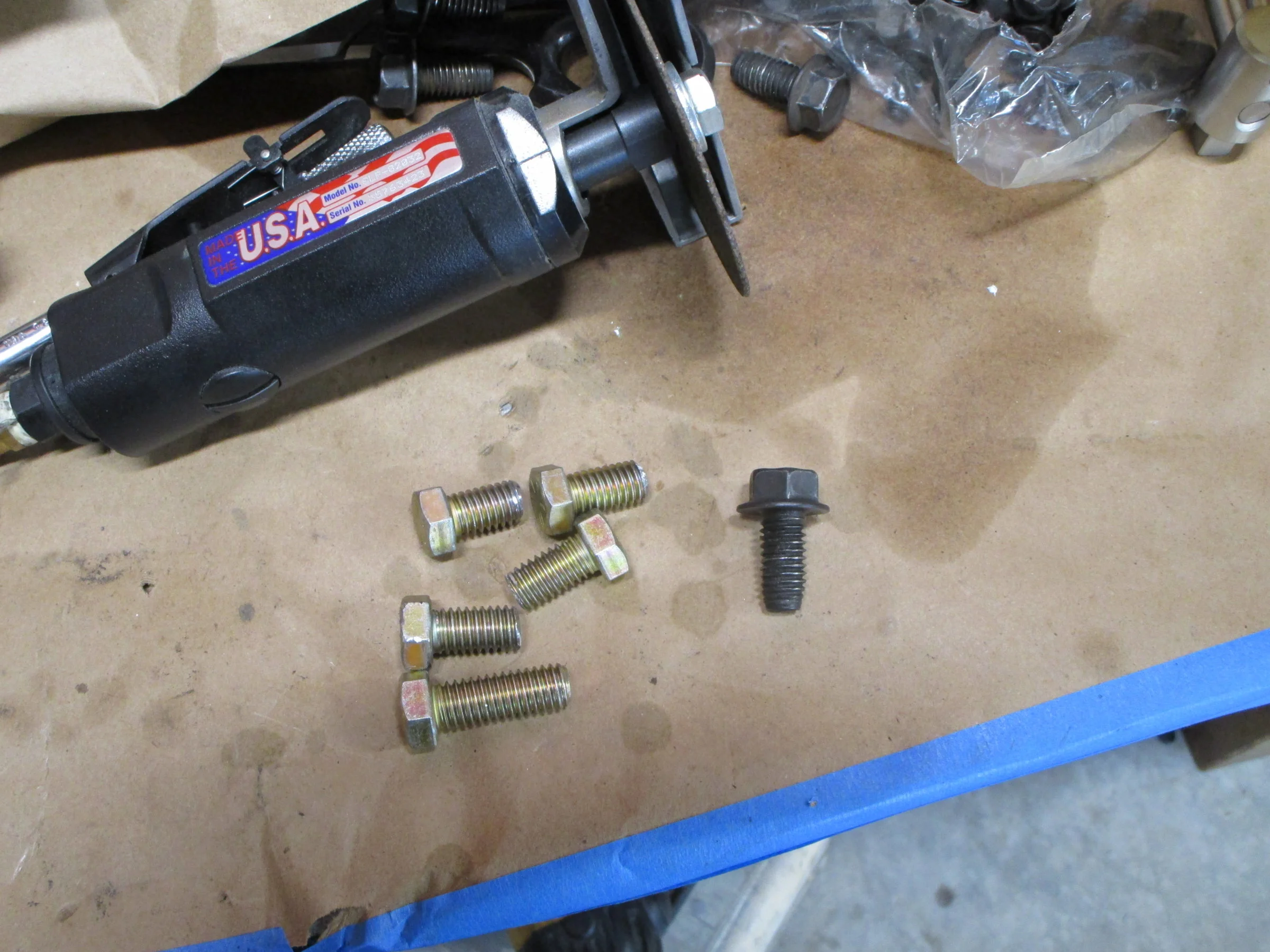

#2) The old bolts to attach the mounts to the engine were goobered up and wouldn't thread in, and the only length I could get locally was 1-1/4" (supposed to be 7/16-14 x 3/4 btw) which meant cutting some bolts down.

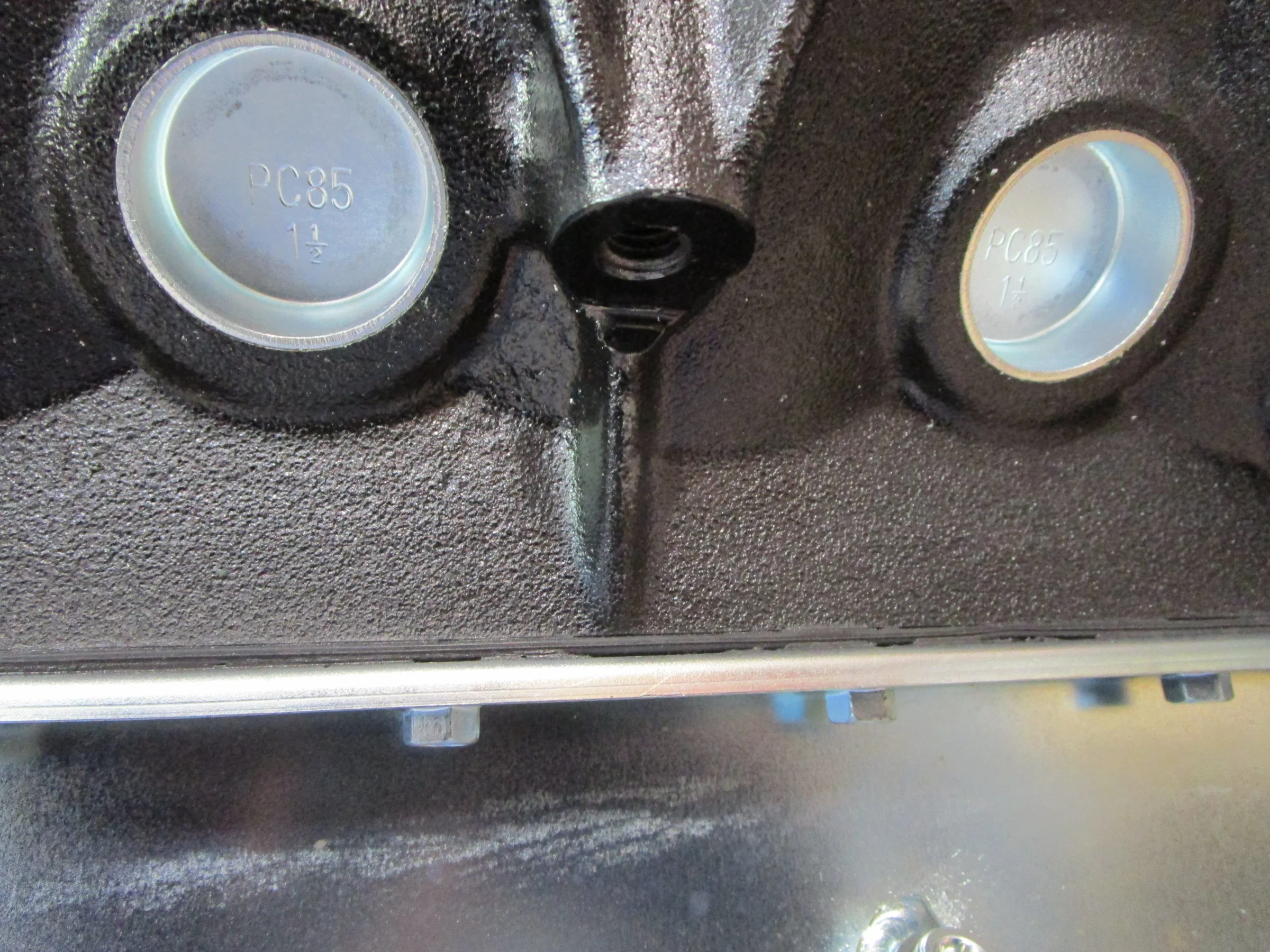

#3) There's a web cast into the Dart block where the mount goes that interferes with stock-style mounts, so out came the die grinder
FINALLY, the mounts go on. First group of hurdles clear.

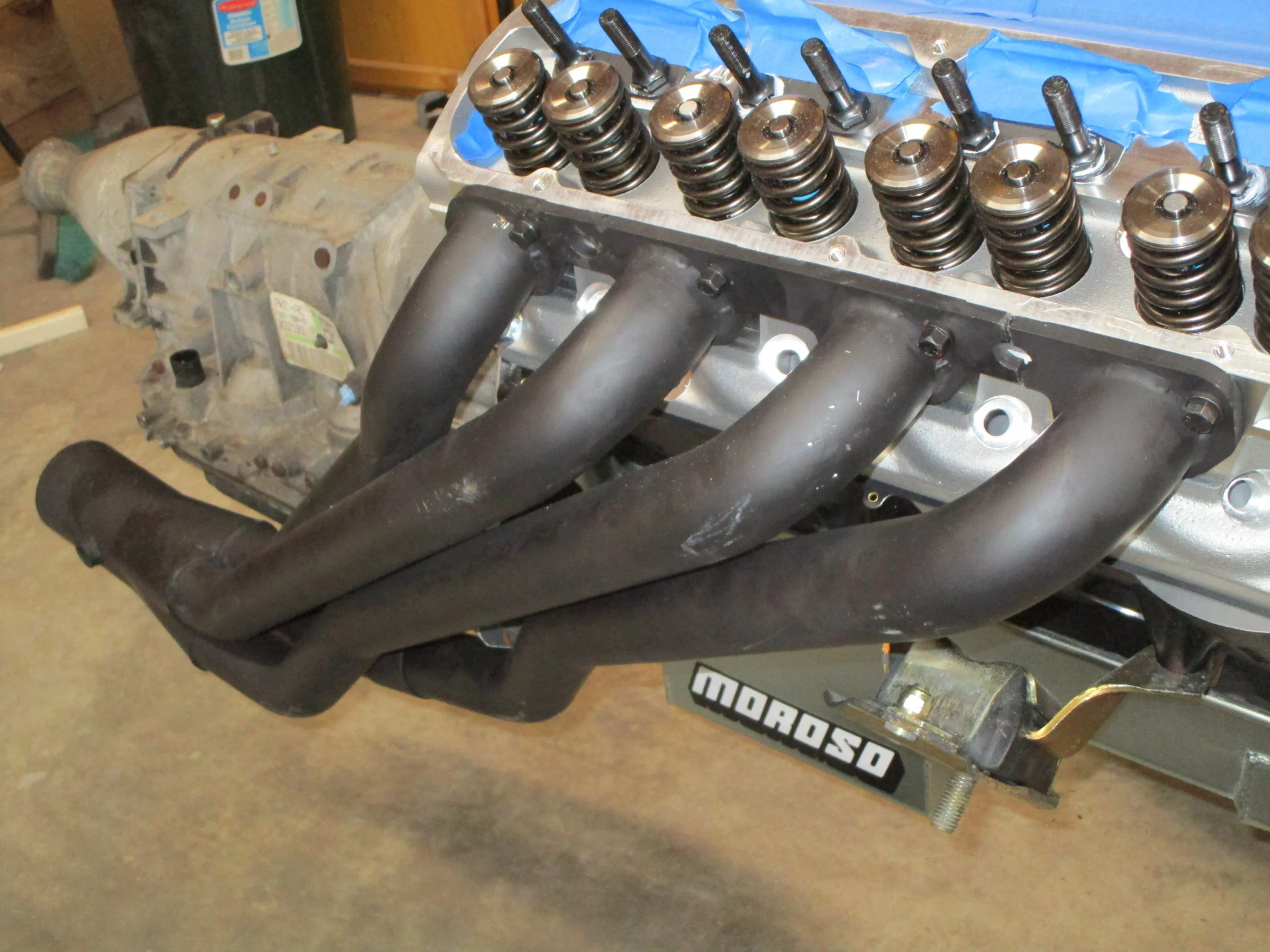

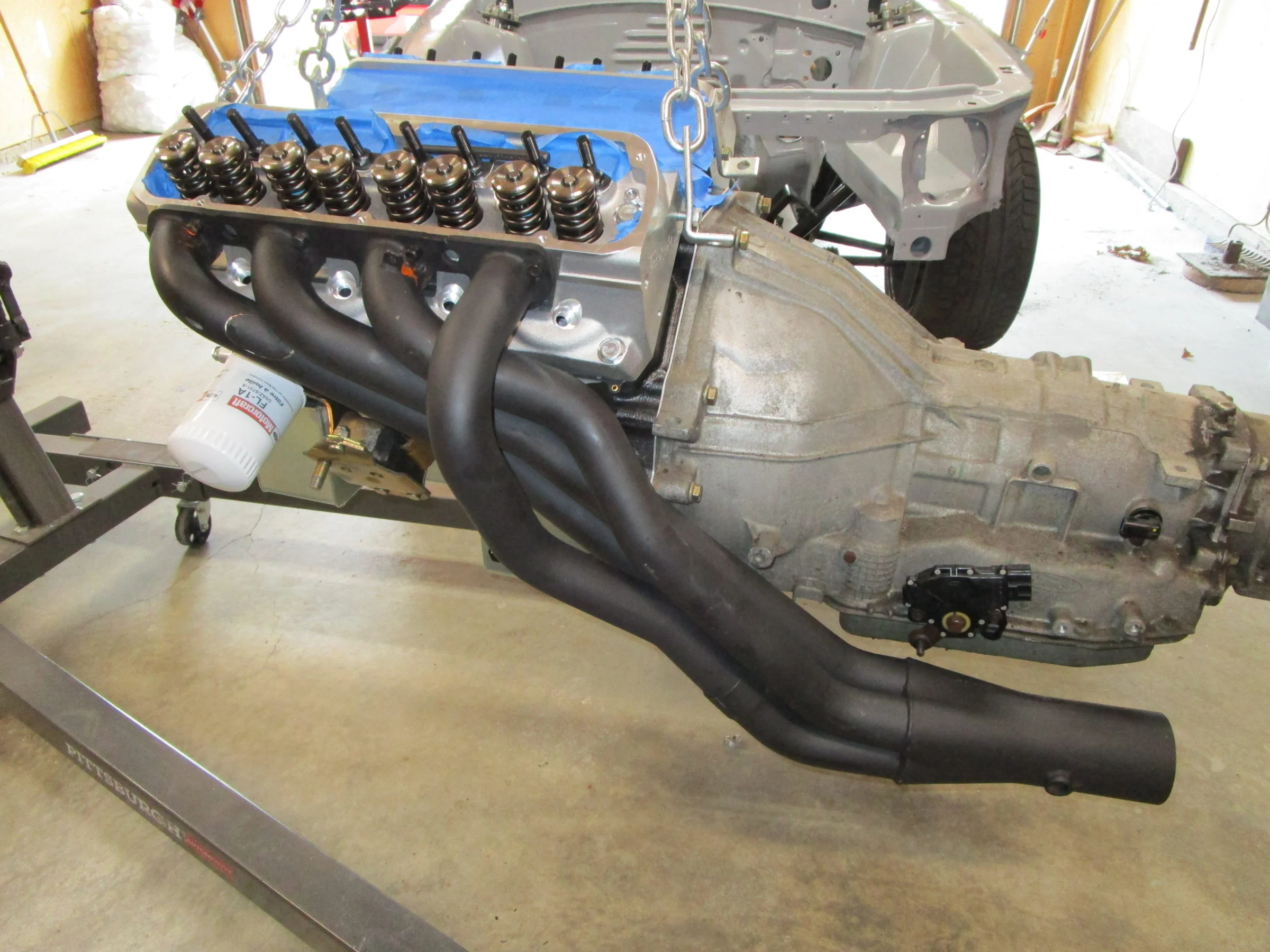

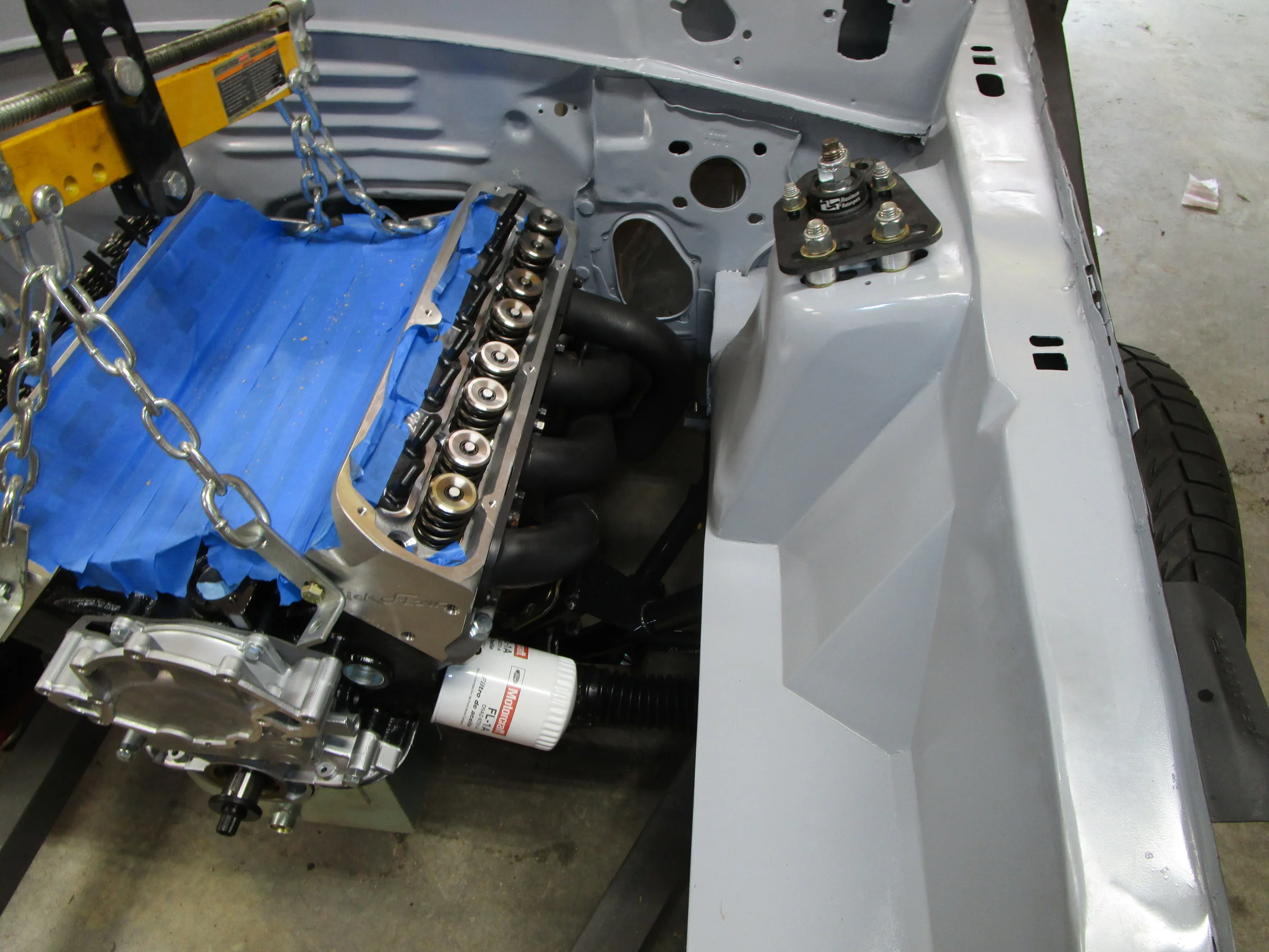

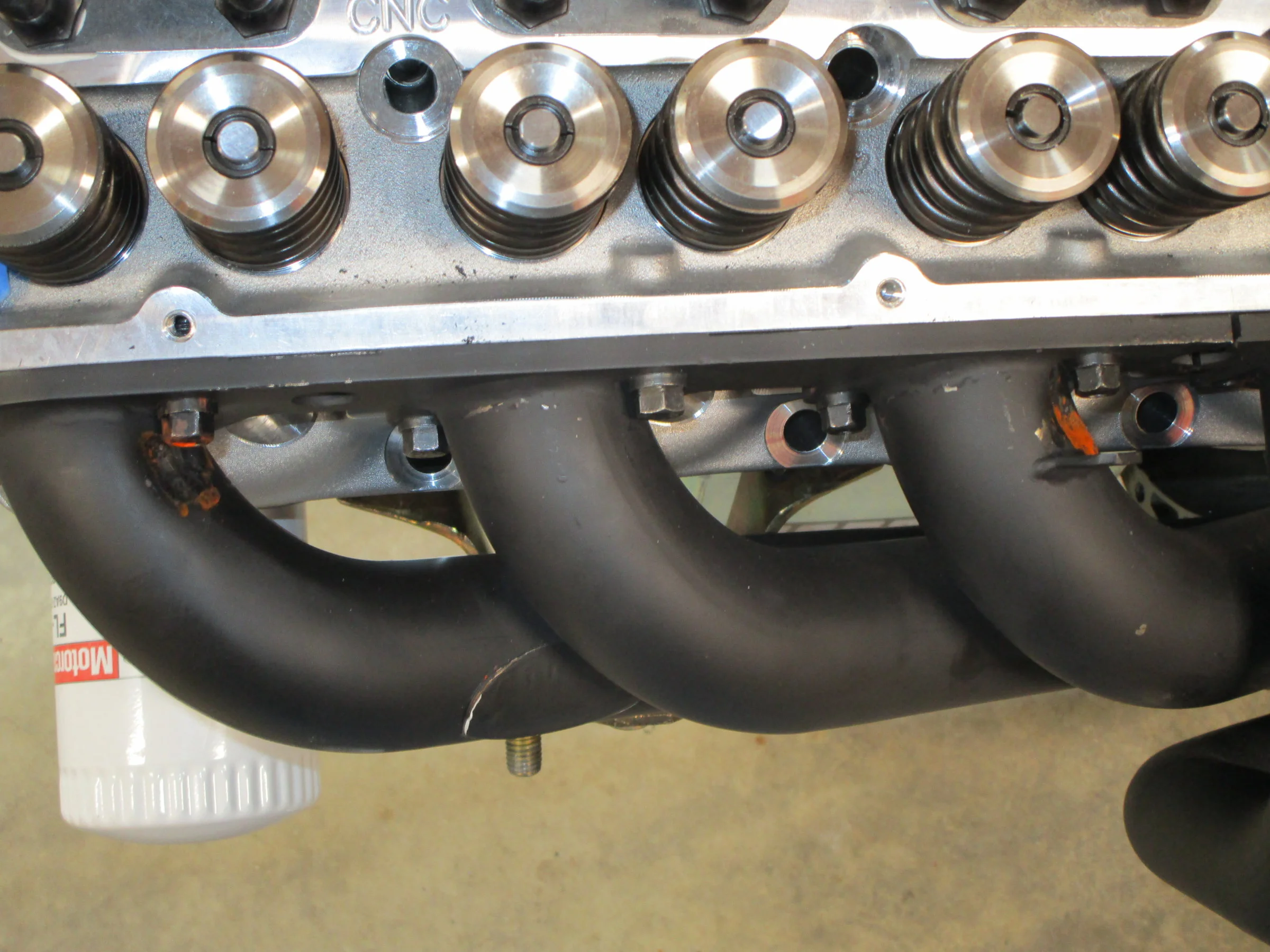

Next up, dealing with the headers. These come with adapter plates to use the standard 2" pattern, but also have the diagonal pattern the high ports use as well. Using the adapters, I probably wouldn't have had to mess with much, but I didn't, so I had to. Trans went on beautifully btw, even got a brand a new separator plate from cj's (that is NOT a perfect fit, the dowel holes either have too much spread or the holes aren't big enough).

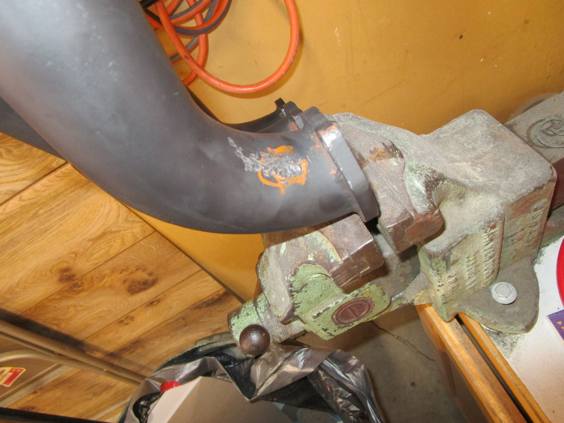

Obstacle #1) The #6 primary just catches the corner of the block, a little grinding on the block and some tube smashing and it clears
#2) Bolts heads get blocked on the tubes on cylinders 5, 7, and 4. Again, a little smashy-smash and it works out ok
The bright orange is just paint marker, but obviously, you can tell these have been sitting on a shelf somewhere for a while cause there are rust spots here and there. I'll eventually have these stripped/blasted and then coated.

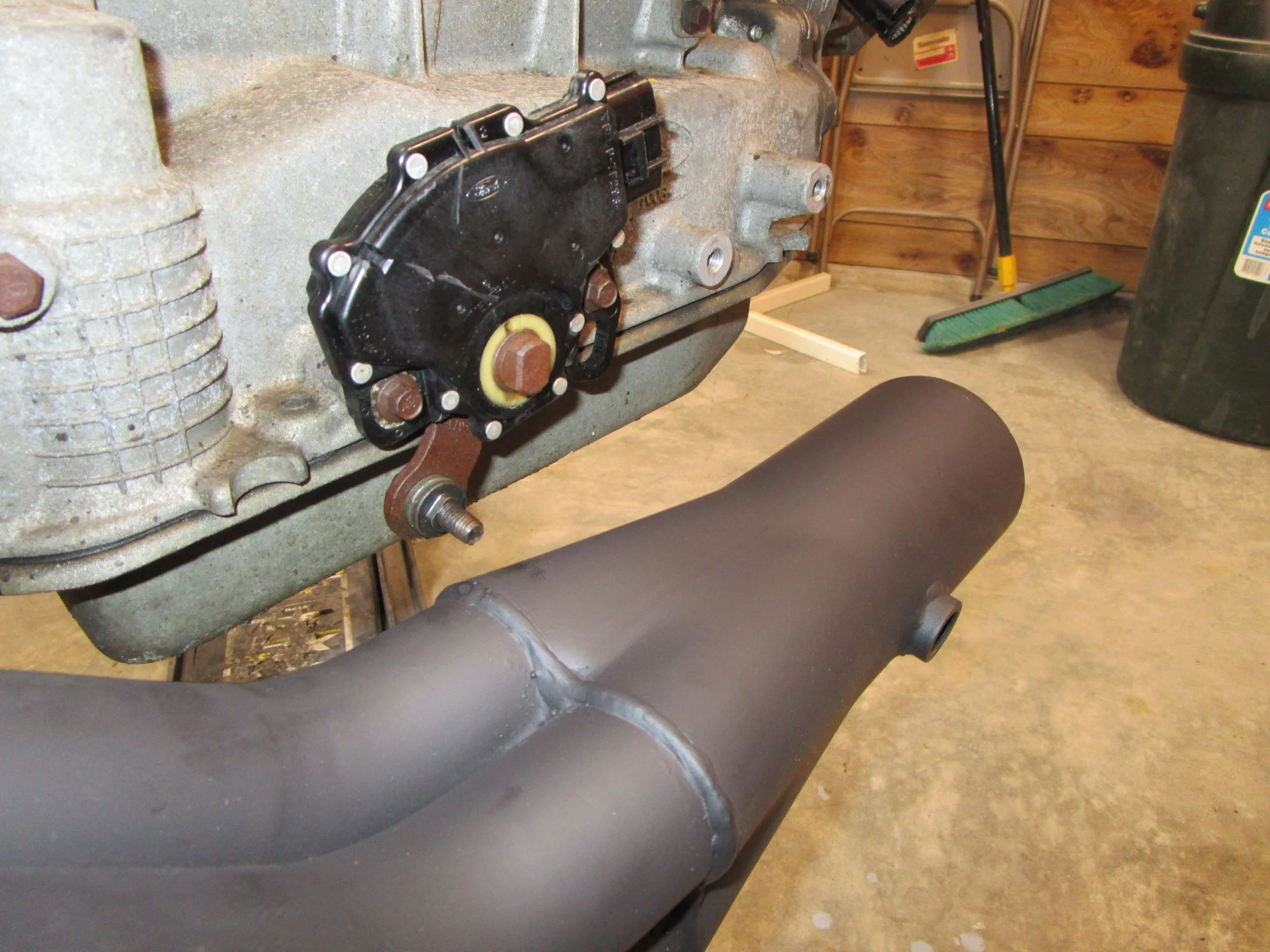

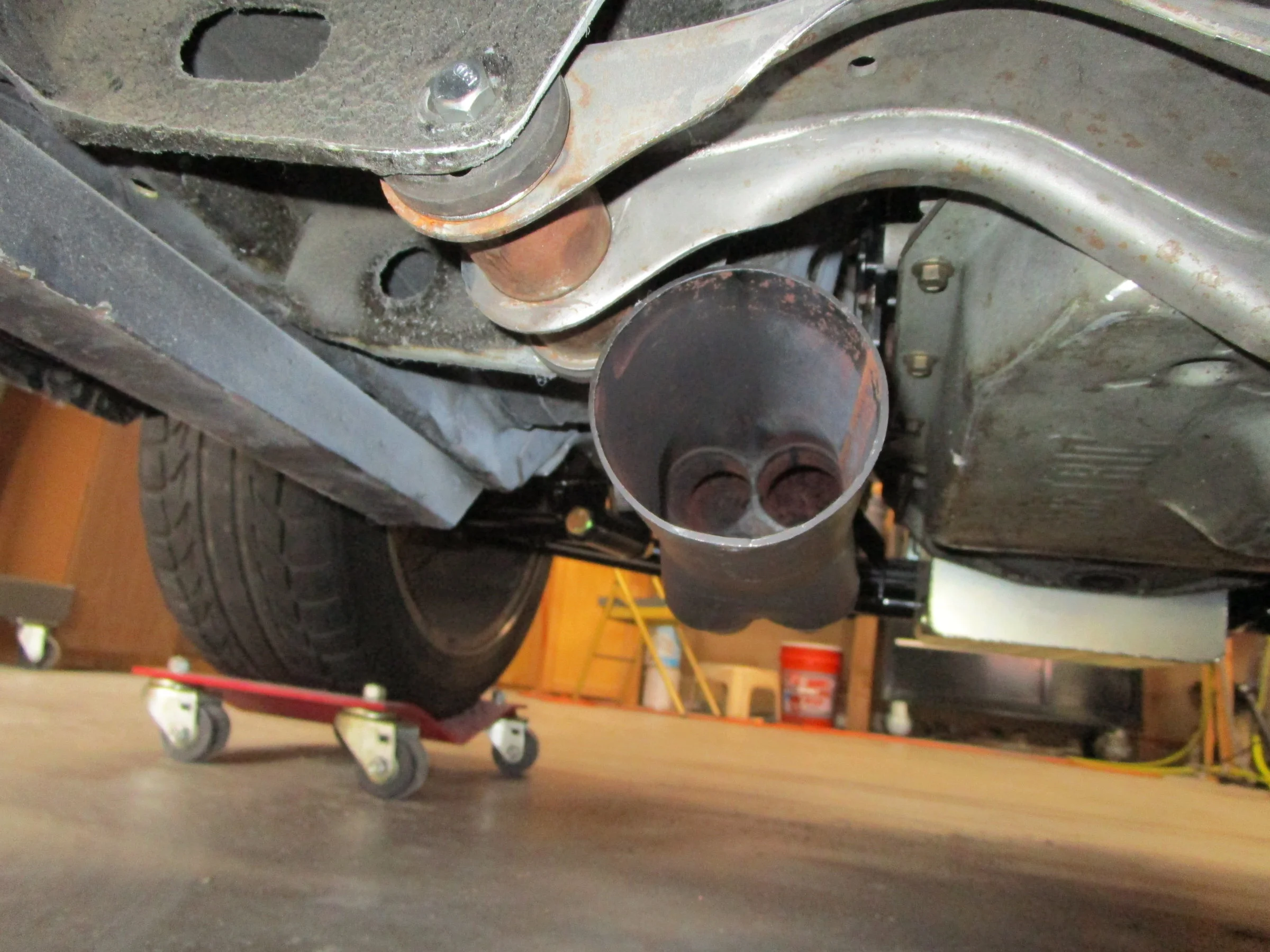

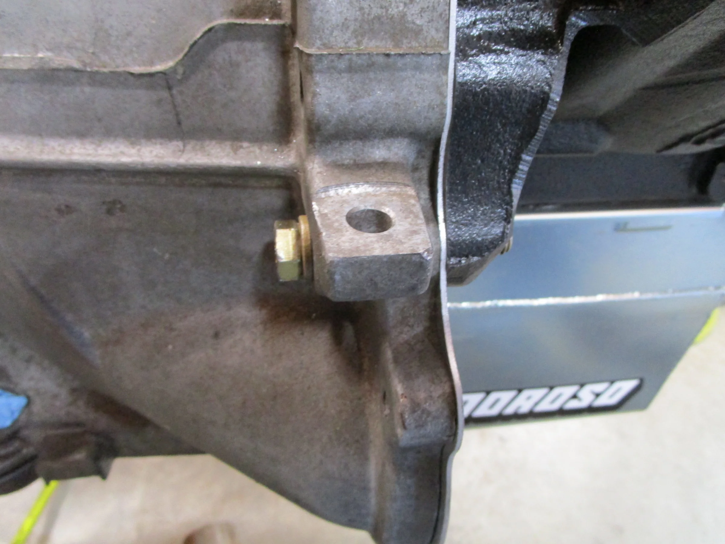

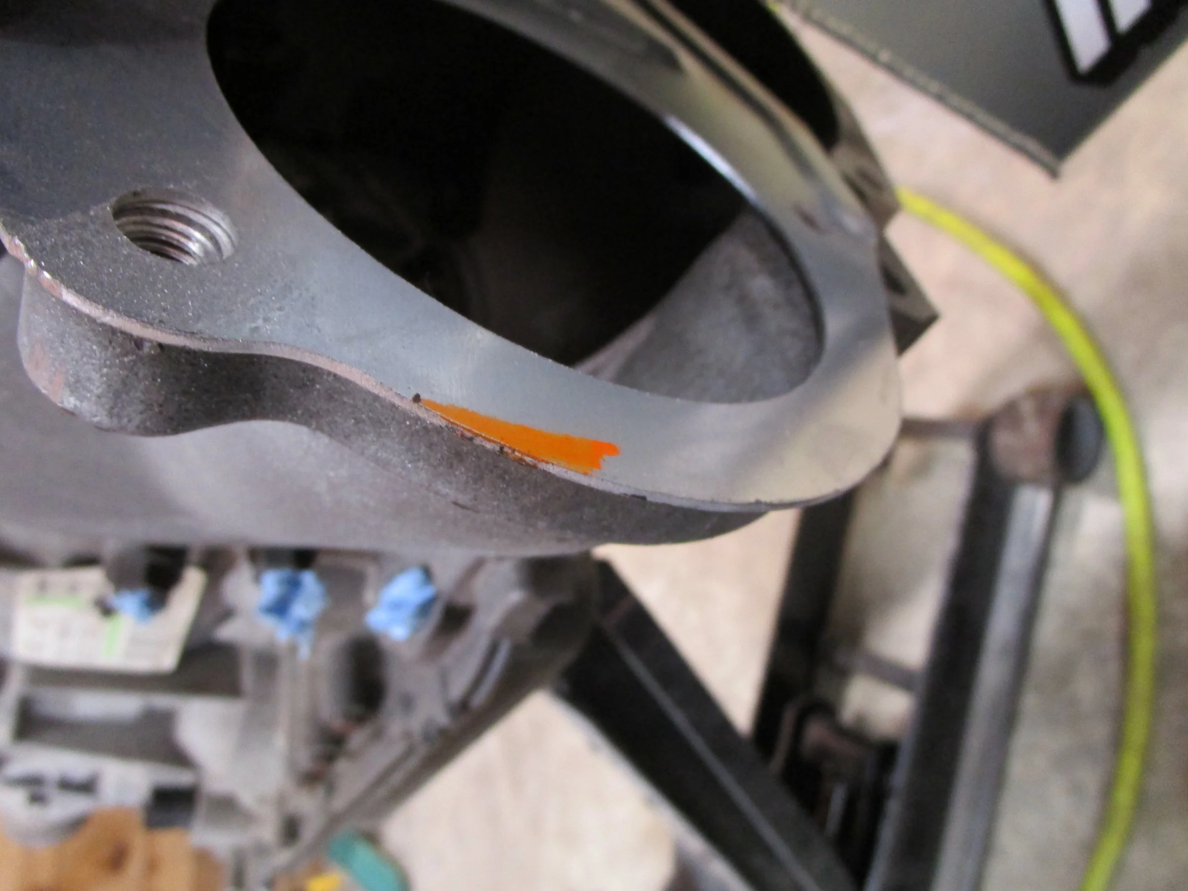

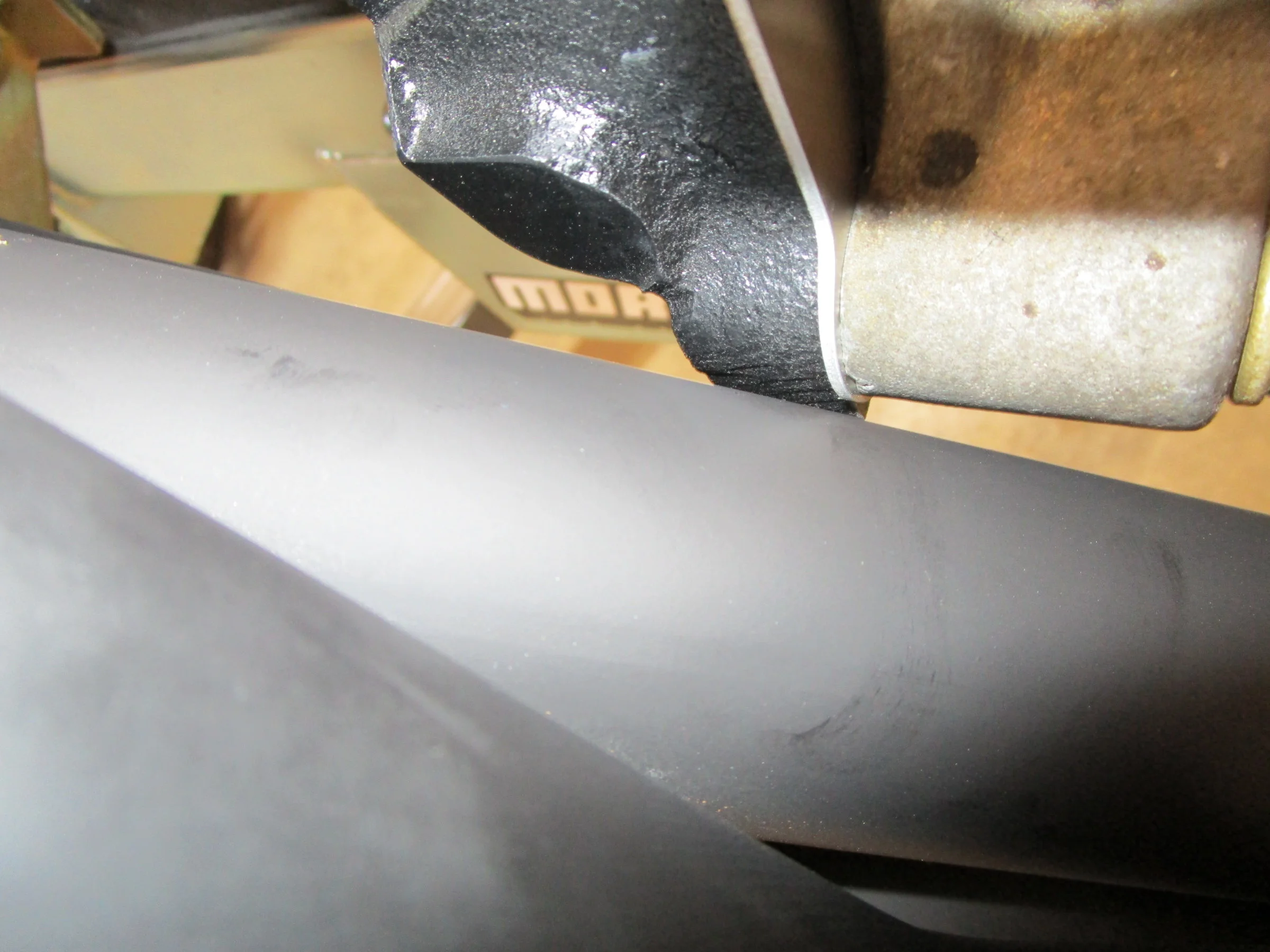

#3) Over on the passenger side, this ear (which I'm hoping is just a tooling hole for when they're machining the case) needs to disappear as the #4? primary needs to be there.

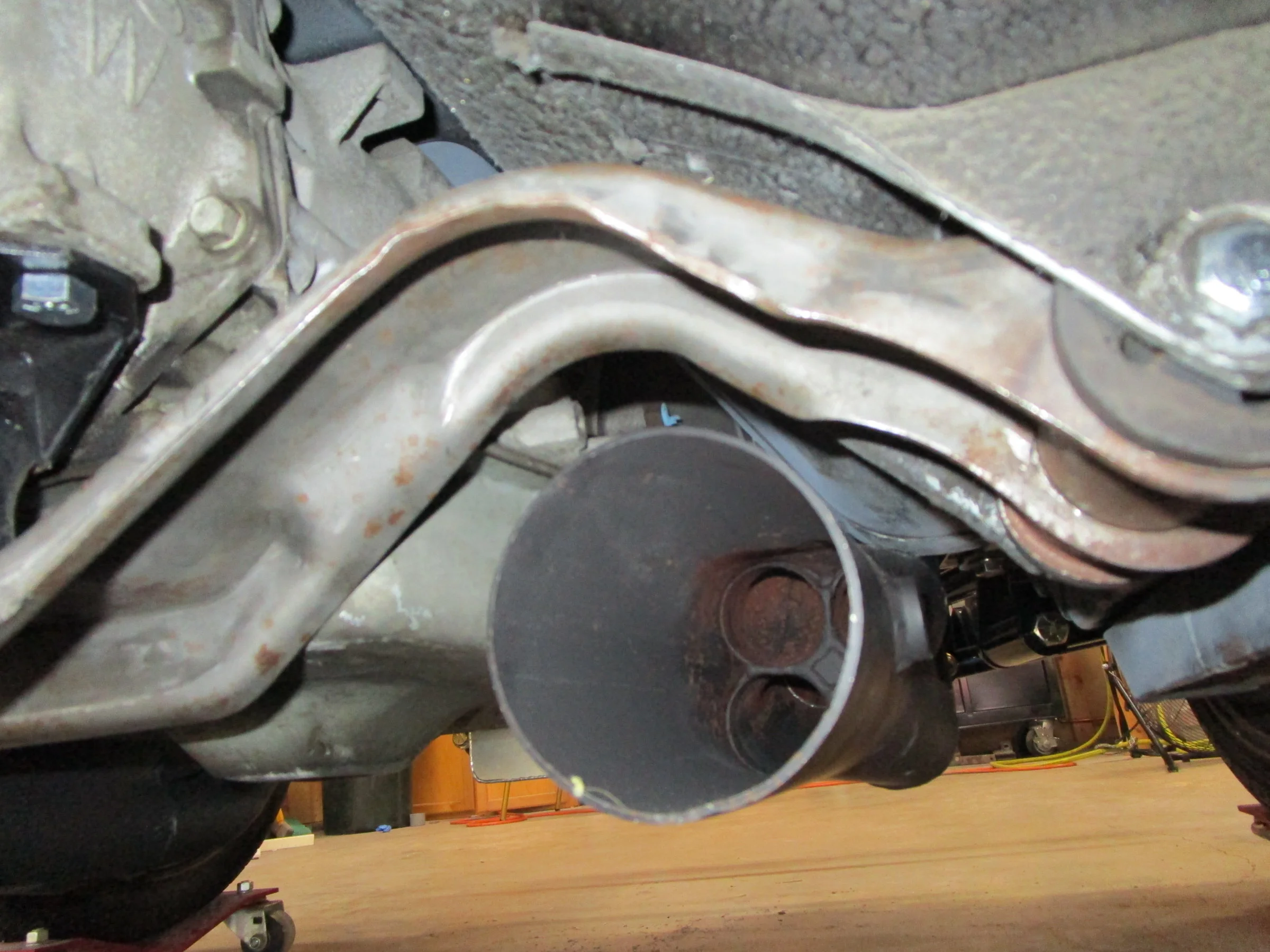

#4) this little bit of index plate also needs to go away, as well as some pry-bar action between the trans and the collector, the #1 primary (which is a slip tube) wants to rub there. Otherwise, plenty of room for a mini starter.
There is plenty of room around the linkage though, was a bit worried about that.
Also don't seem to hand too low below the motor either

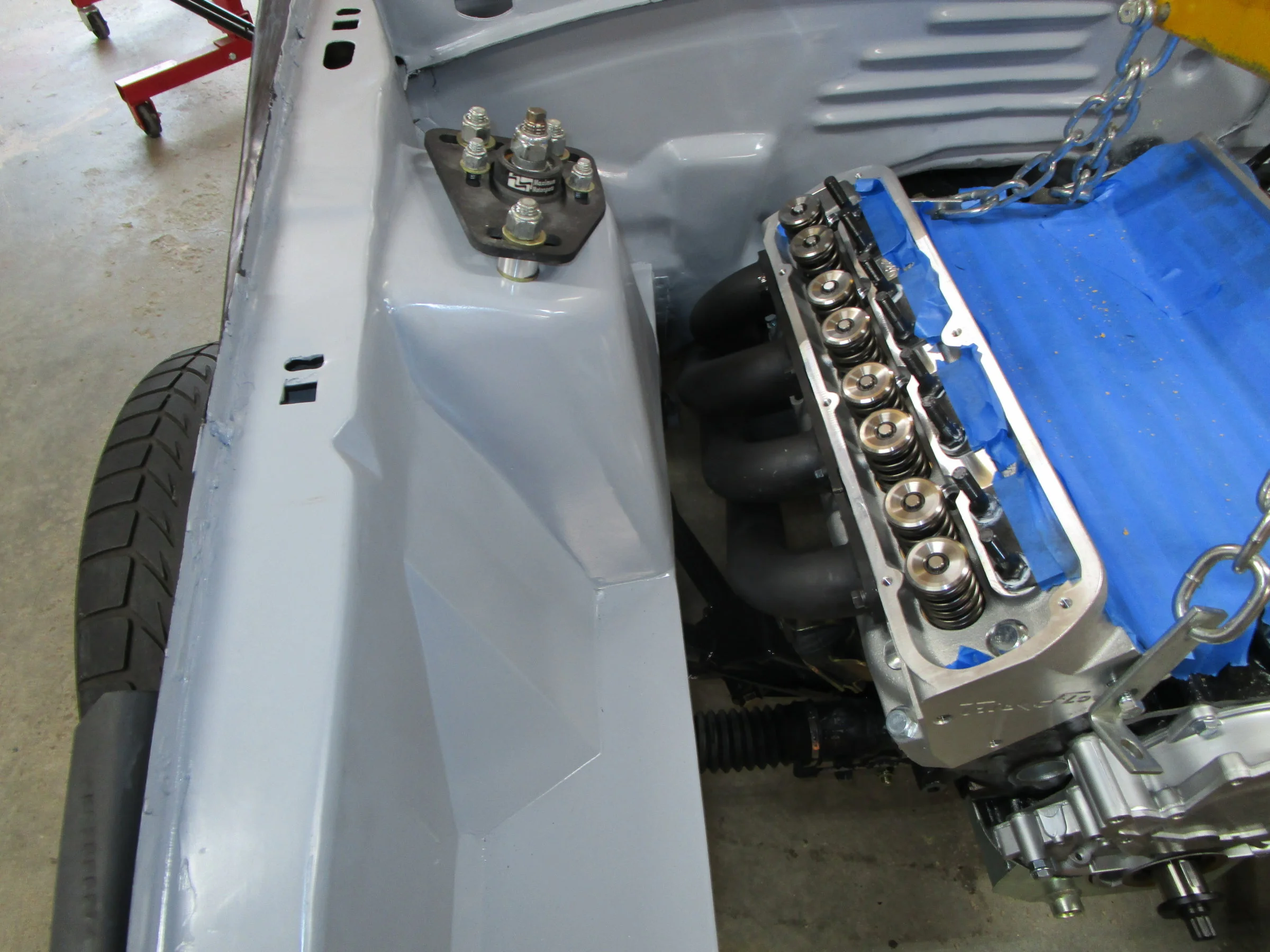

Here's the whole assembly getting ready to go into the car, those back brackets for the leveler proved to be my arch enemy about 10 mins after this. They kept stopping the thing from getting close enough to the firewall and the sawzall had to come out and make them gtfotw.
More pics in the car

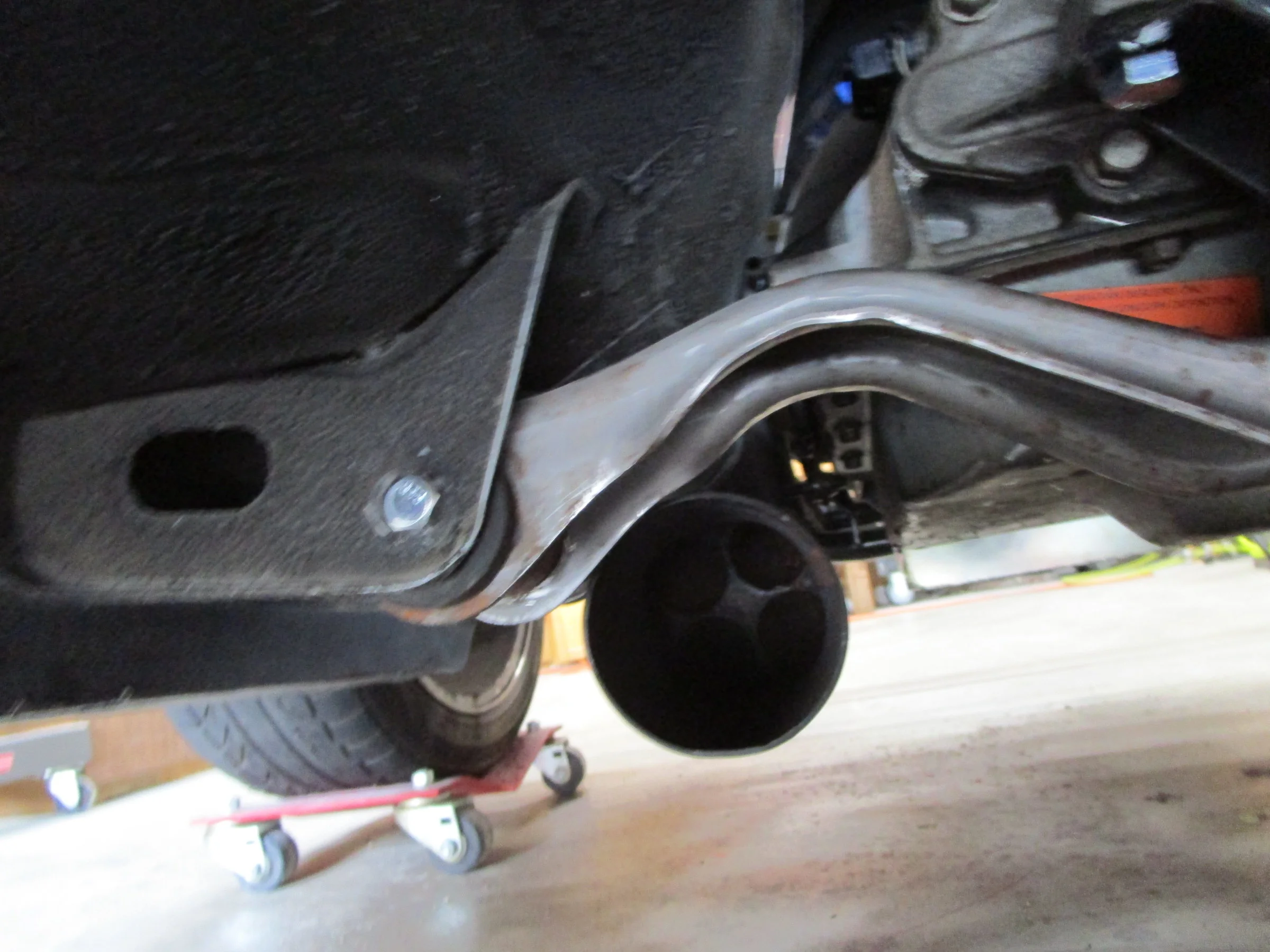

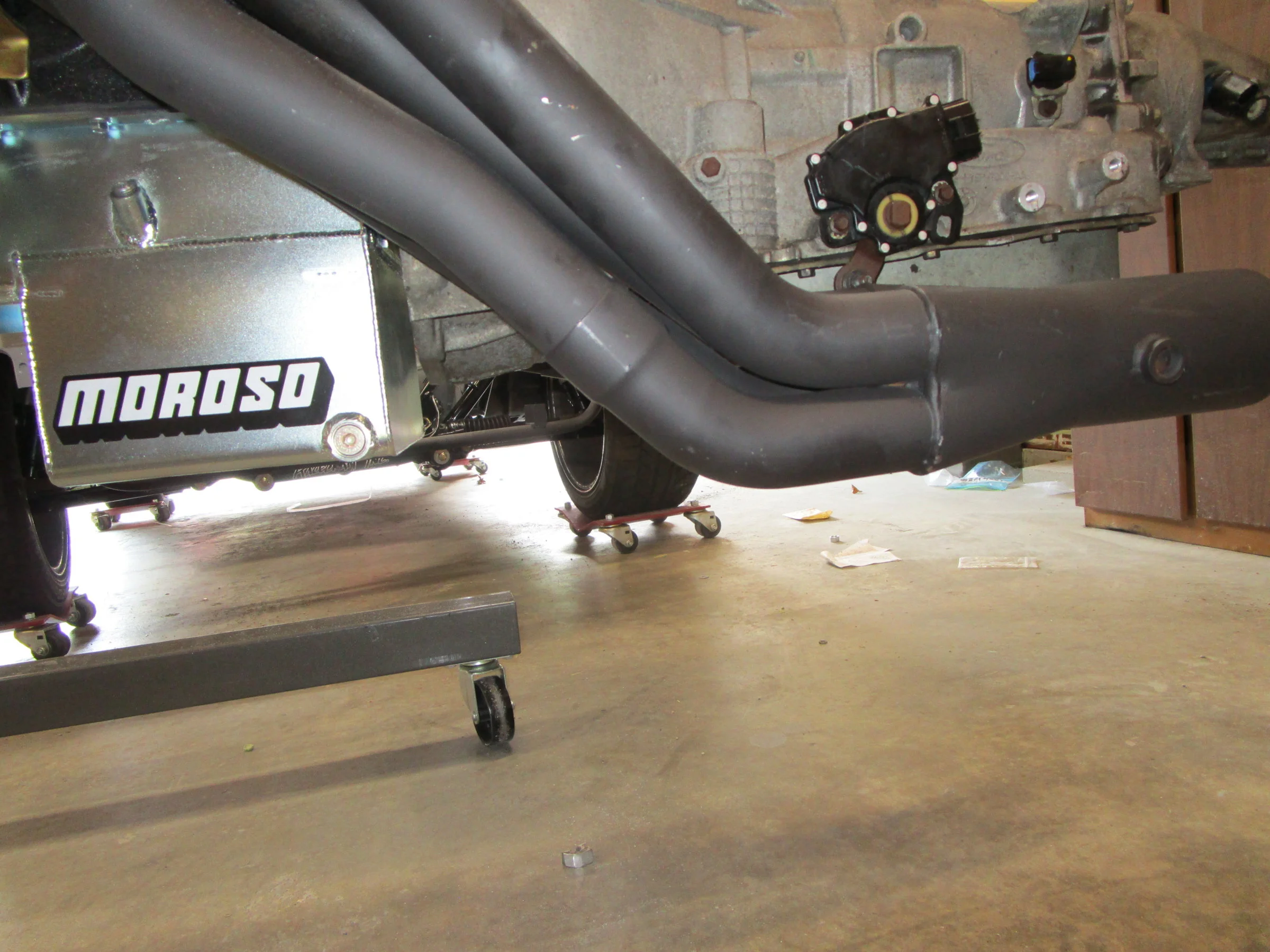

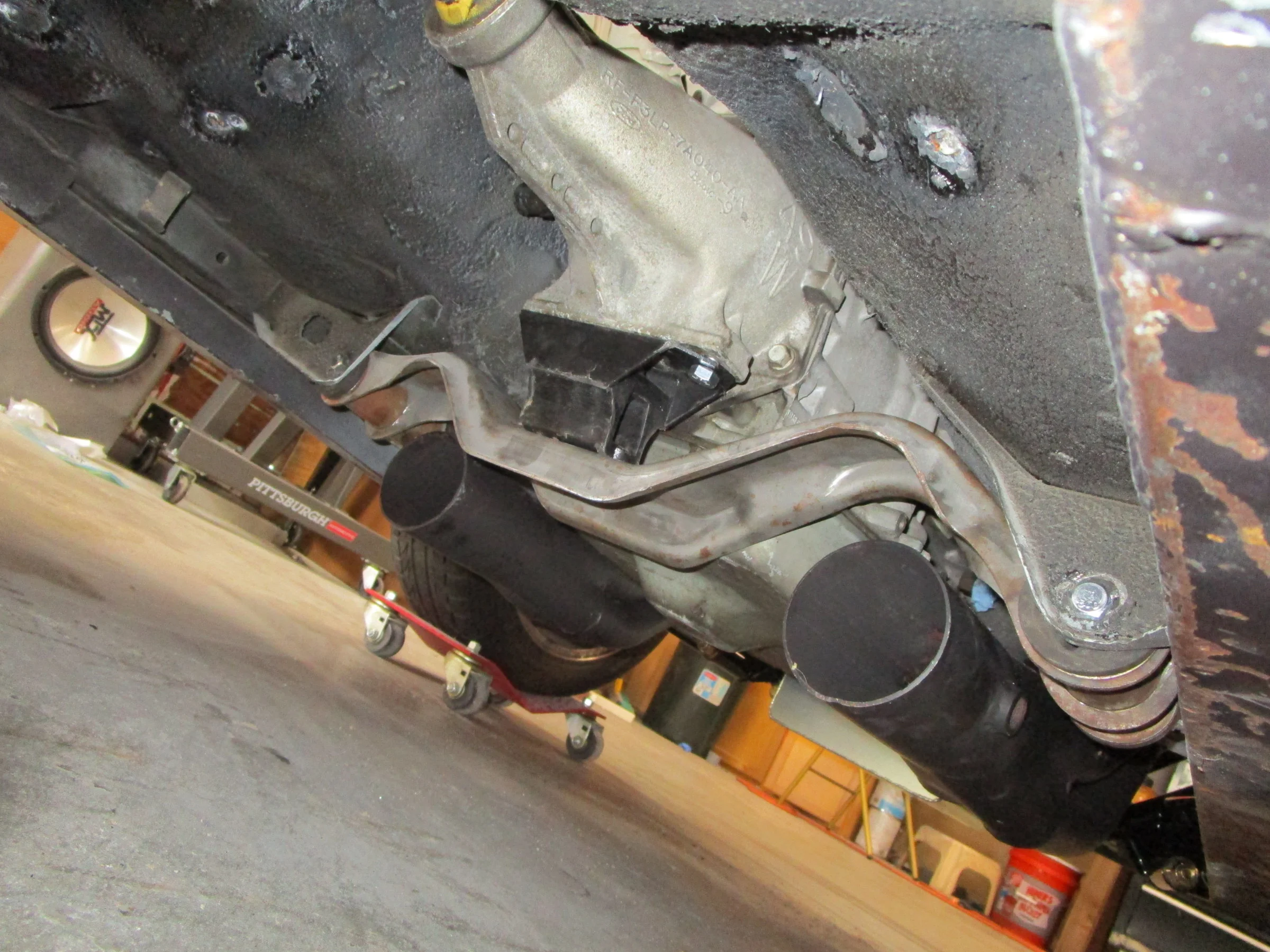

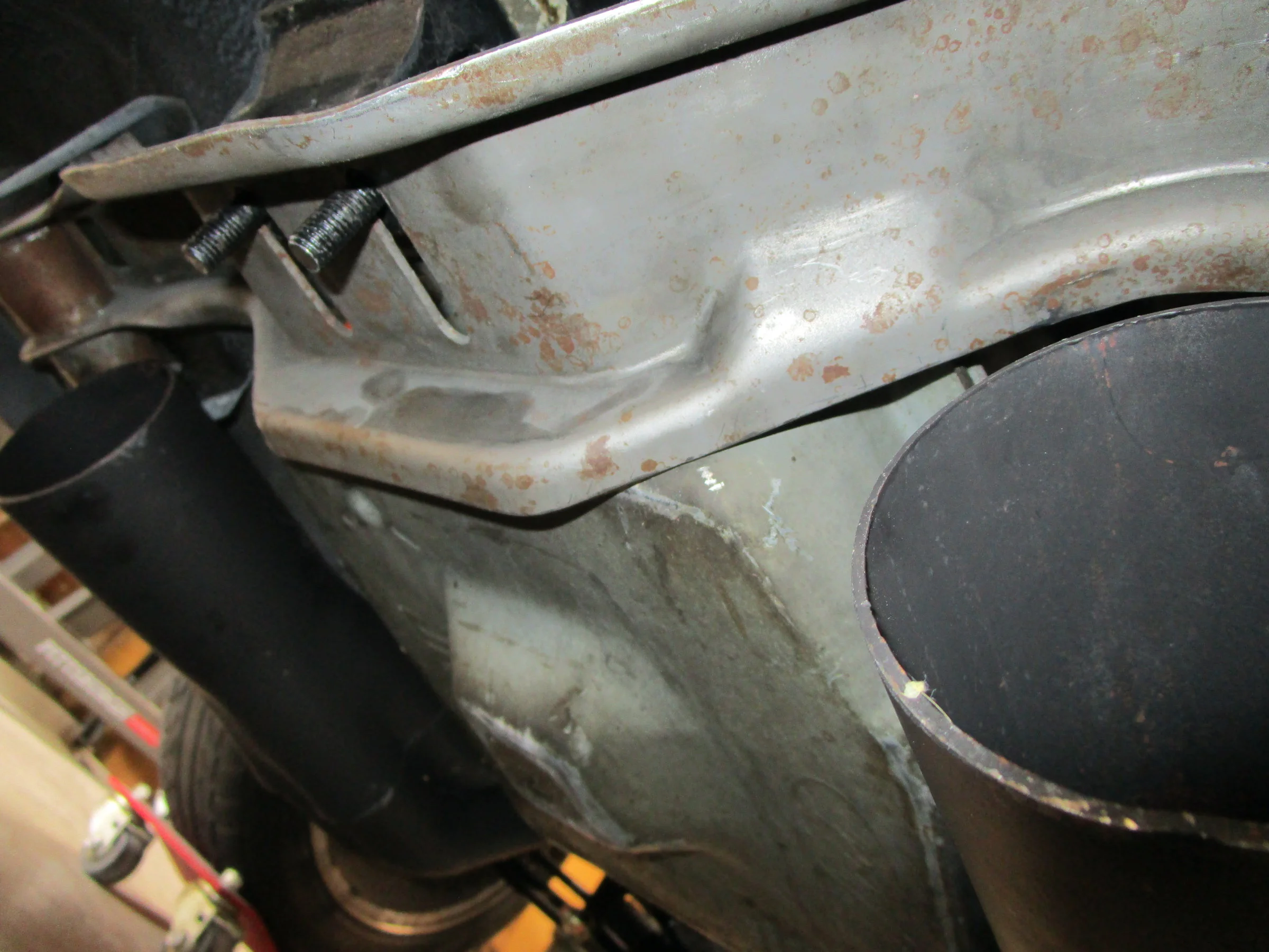

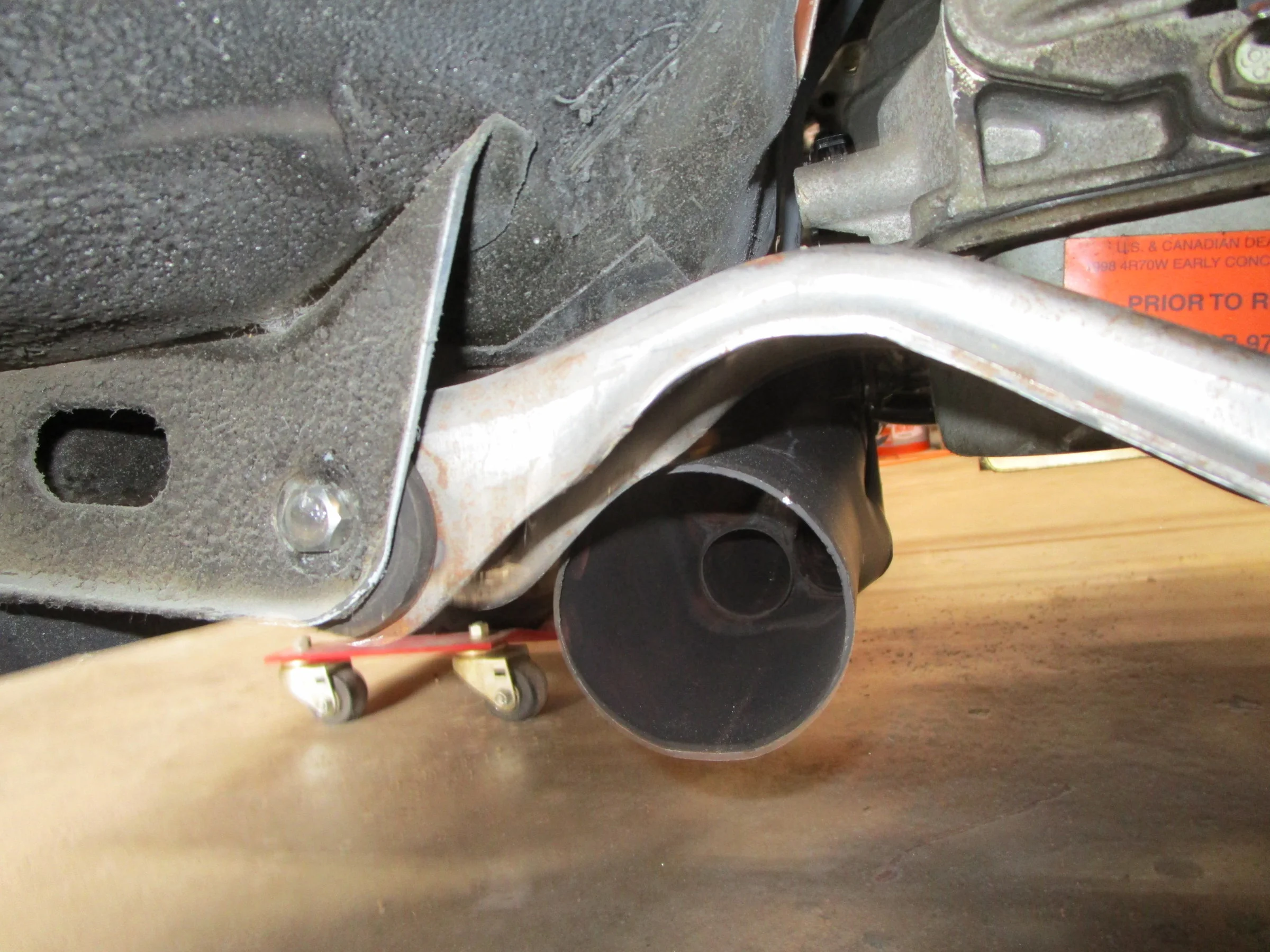

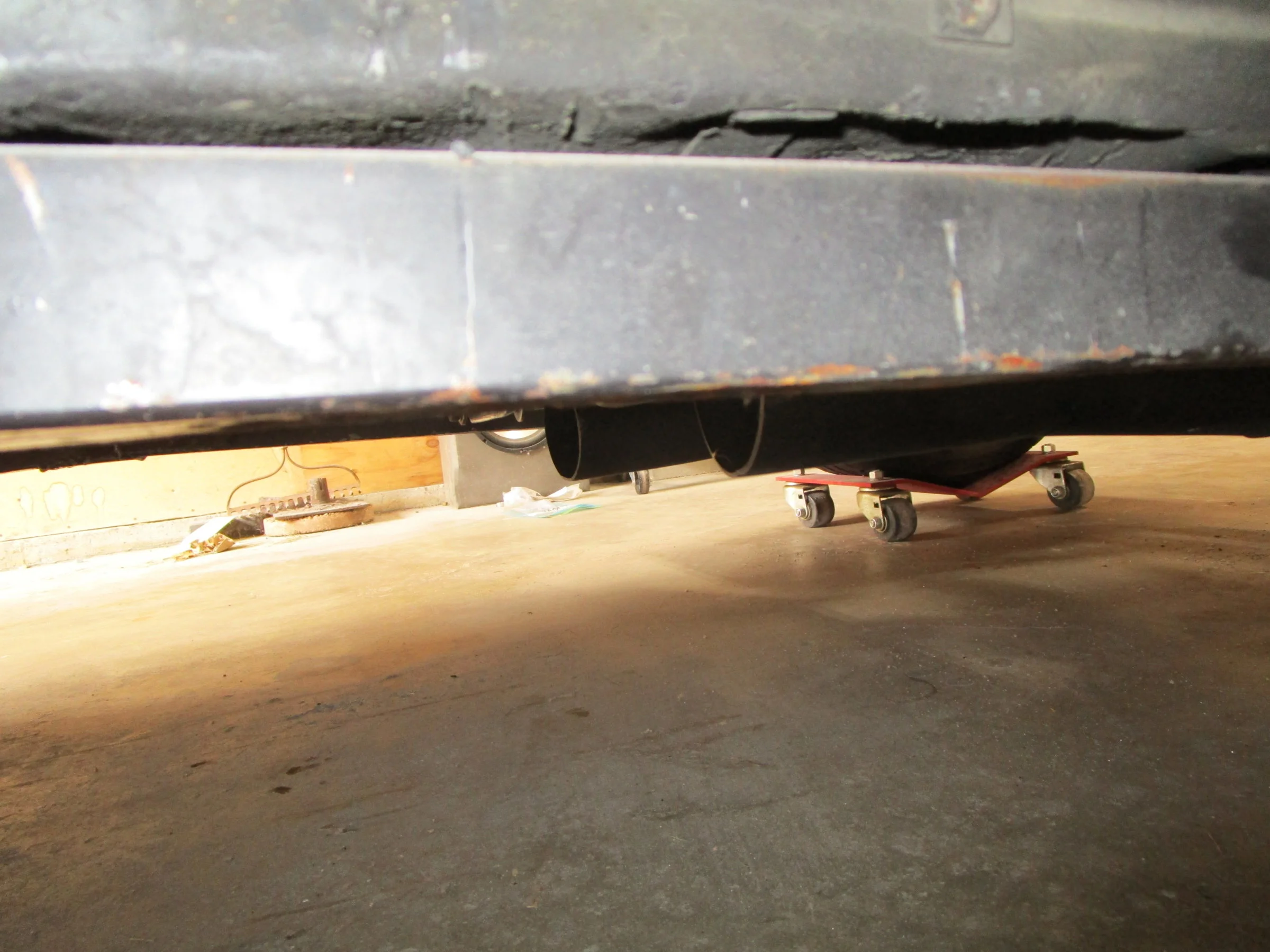

stock trans crossmember in with a cheapie trans mount. surprised how well this actually all fits together, usually hear horror stories about longtubes, but this honestly has not seemed too bad (may have sucked more if i was installing on a motor already in the car). they don't hang all that low either, less than an inch below the mm subframes. will be getting a stiflers crossmember at some point, as there are some clearance issues (getting the pan off in the car would be an absolute pain), but for just getting things mocked up, not too bad :shrug
next big purchase (once the bank account recovers) will be intake stuff so i can figure out if my 1.5" cowl will fit

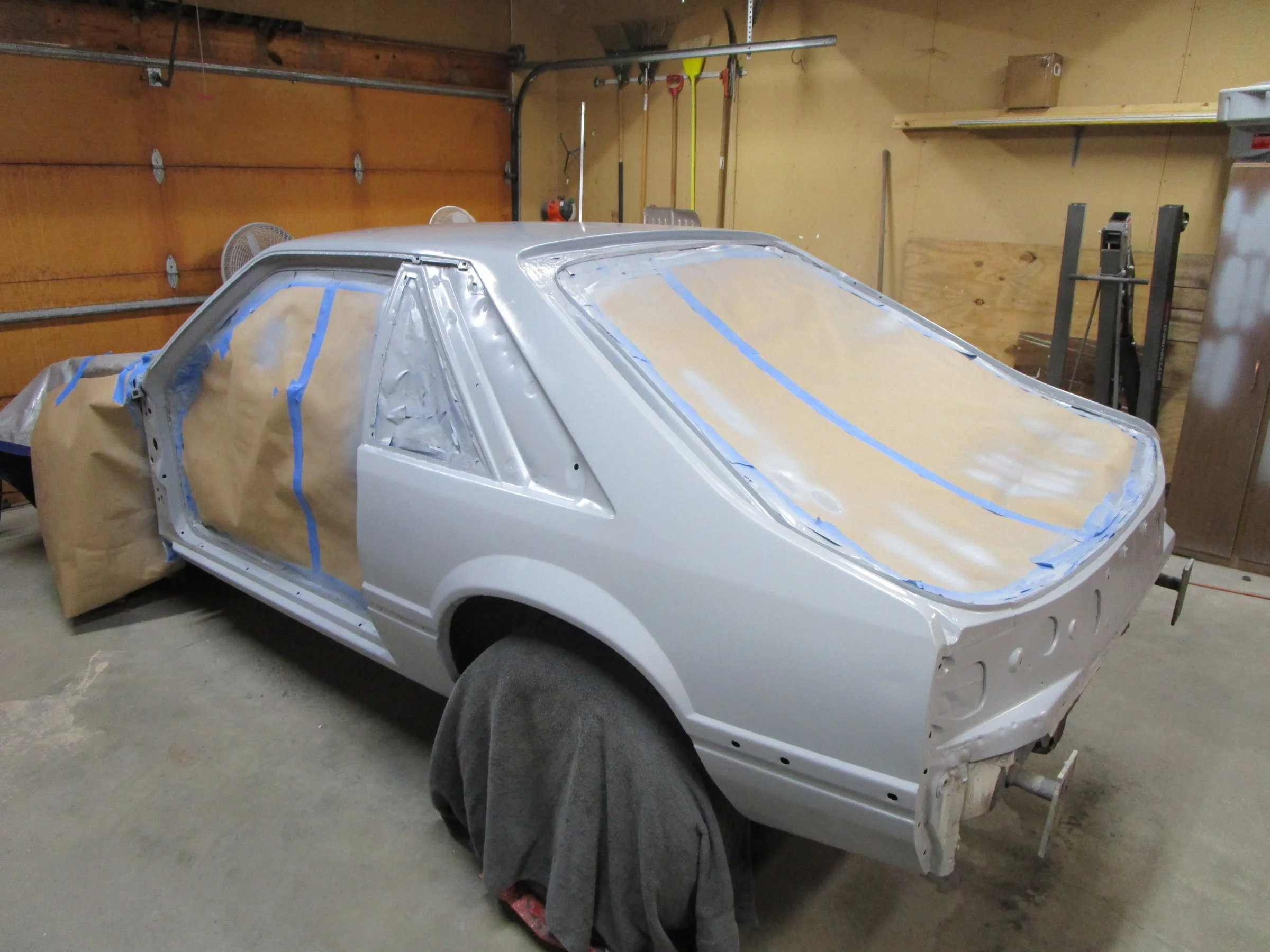

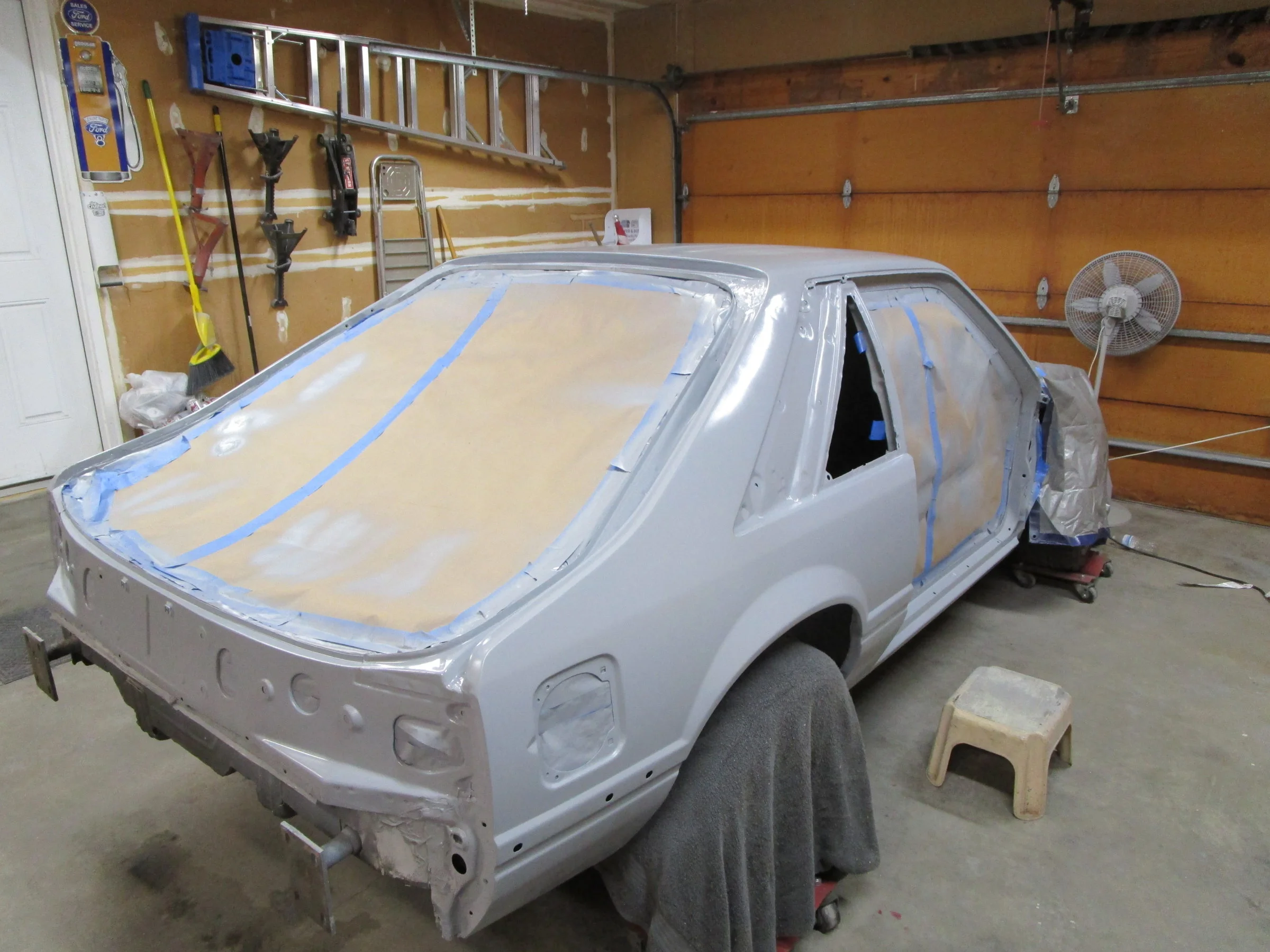

Well, I kicked the lazy bug's ass and, on my first weekend off in almost a year (got moved to 2nd shift :rolleyes: may have to get a new job soon) finally managed to get the shell stripped (debacle), cleaned (cake), and primed (big debacle). Didn't really come out the way I wanted it to, but I think I can just block it and be ok.
Learned myself some things like:
A) Aircraft stripper works wonders compared to a cheap DA
B) I really, really need to figure out a dryer/cooler system for the compressor when using the DA
C) Some people apparently LOVE body filler
D) Check your gun setup BEFORE you start painting (apparently I had setup my gun for high-build after the last time I used it for epoxy and just assumed it was still setup for epoxy)
Anyway, here's how it sits after about 20-30 hours in three days:

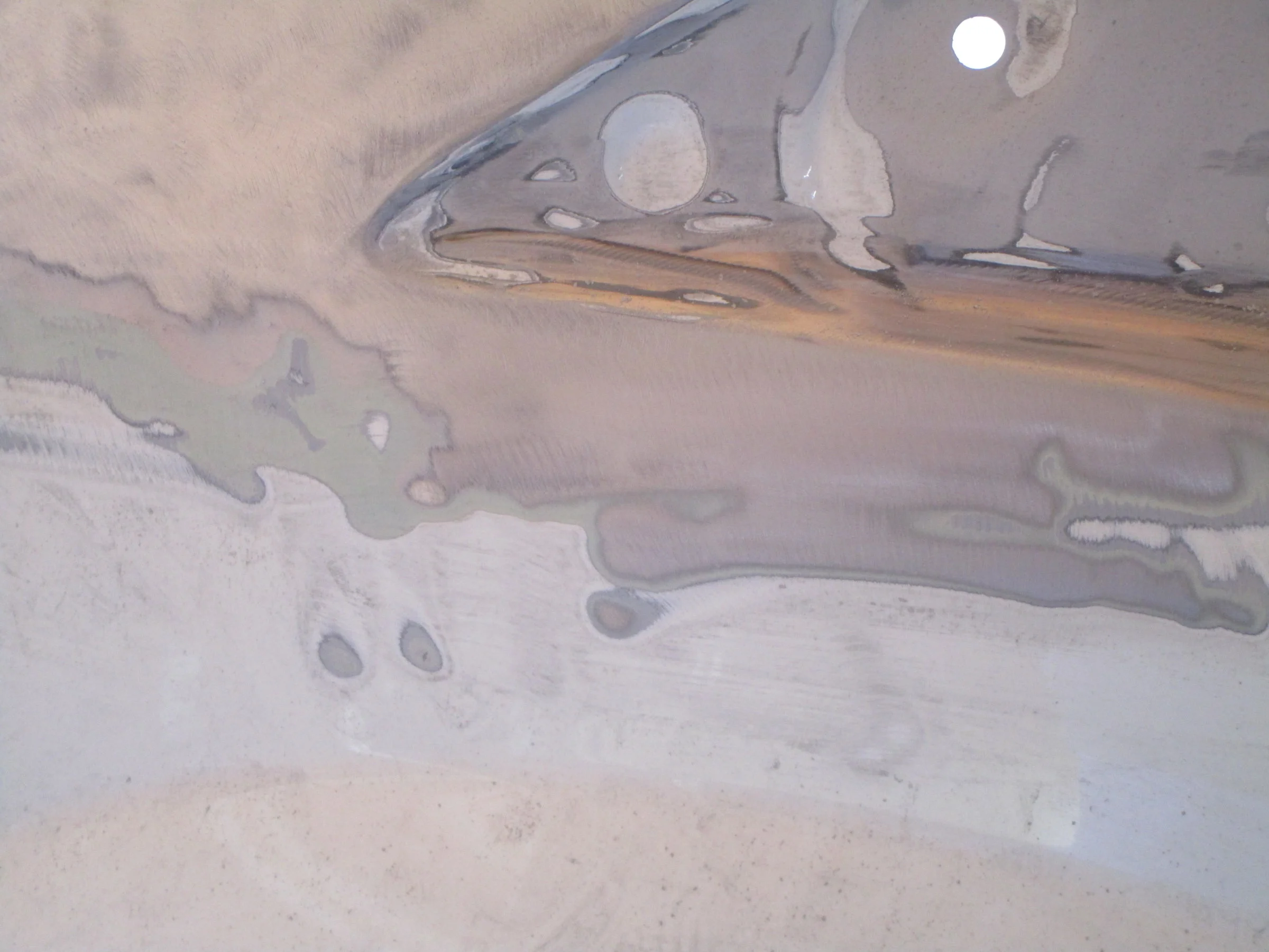

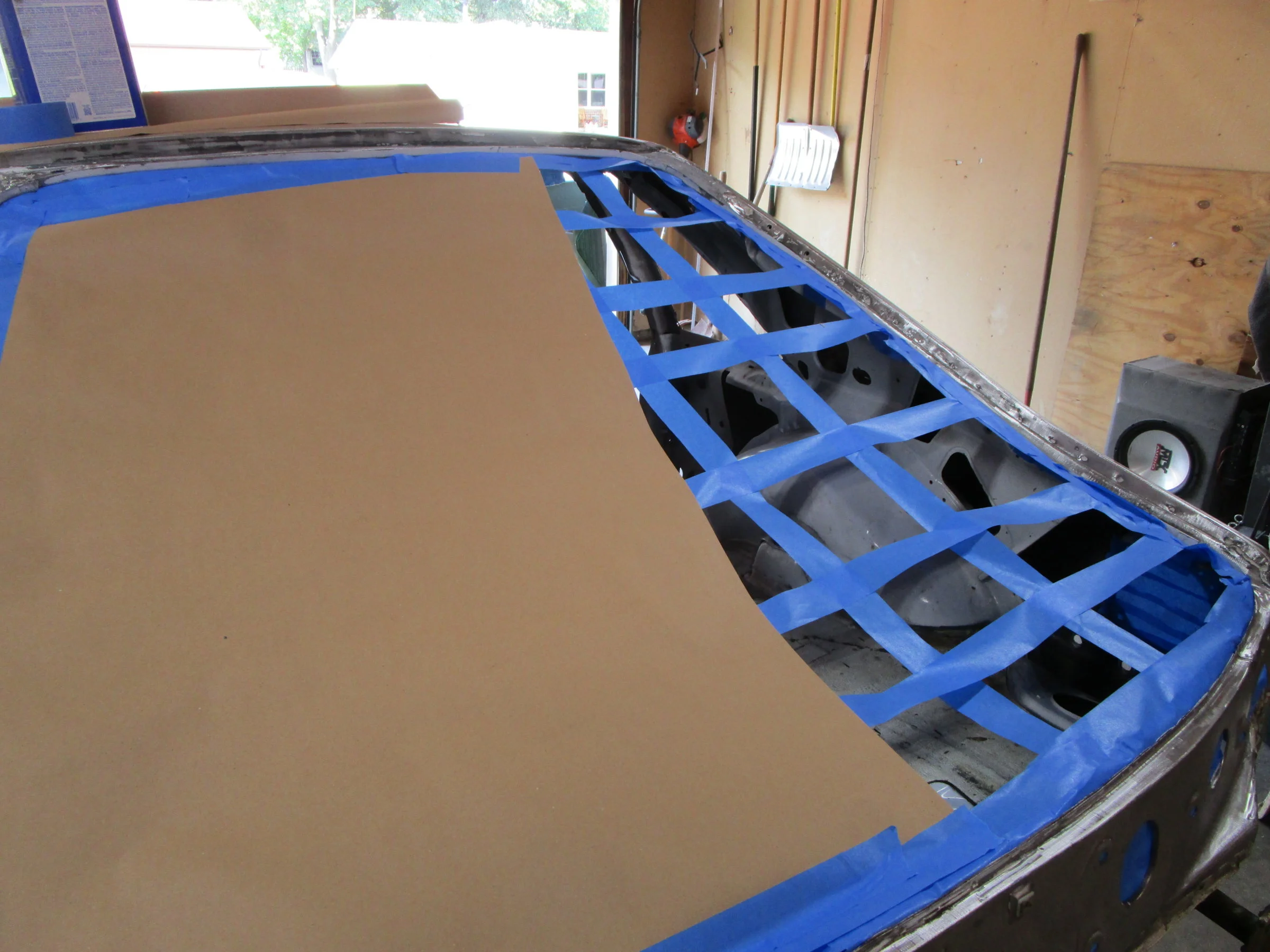

There were two distinct layers of bondo on both c-pillars that was probably somewhere around 1/16-1/8" thick, guessing they were trying to sharpen up the style line since thats as low as it got, but on the drivers side it ran all the way up to just past the factory filler at the roof seam. Don't know if I should be super worried about this?
An in-process of masking off the hatch opening, did the doors the same way.

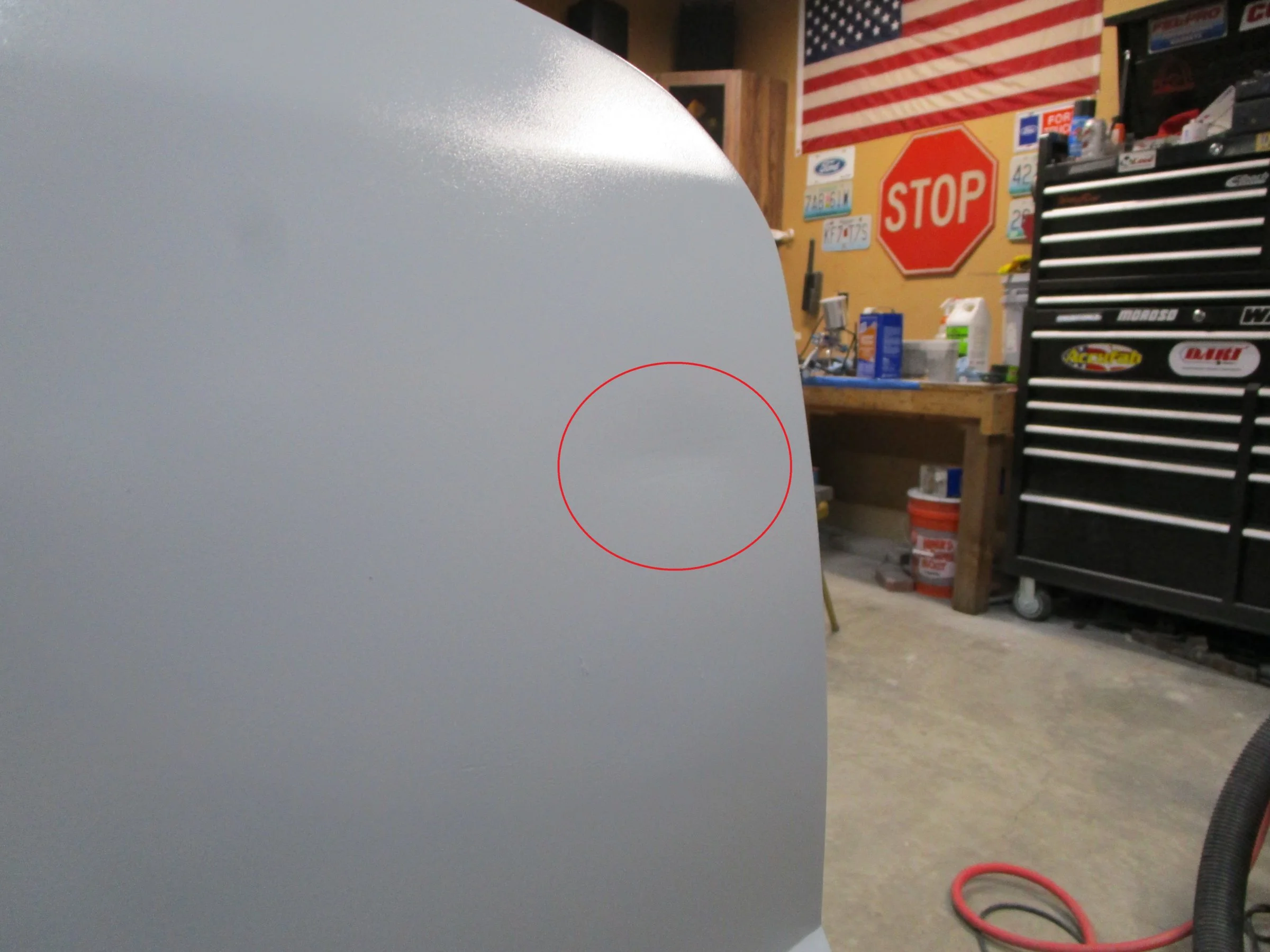

@Davedacarpainter I was hoping this pic would show better, but theres this 1-2 inch long dent in the drivers side quarter that the old bodyshop just bondo'd over, would you actually try to pull this out, or just do what they did and fill/blend? I know I filled seams and blended overlapping joints deeper than this in the bay (and truth be told, I didn't even know this was here until i stripped it), but this will be visible all the time instead of just when the hood is open so....:shrug:

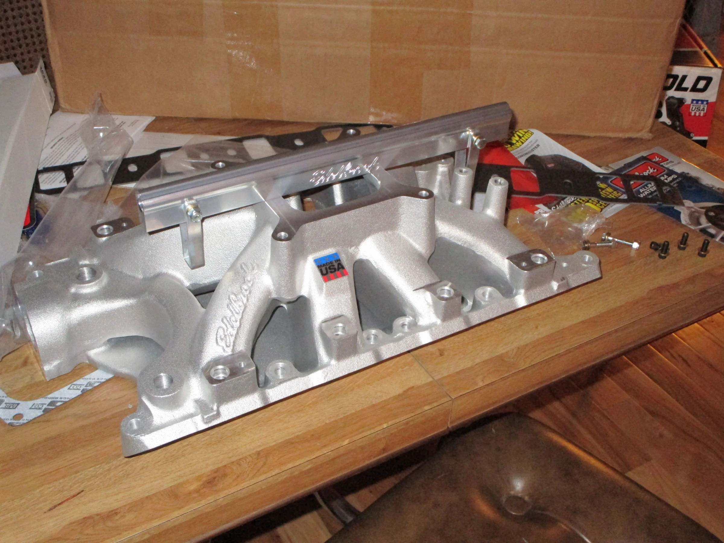

Oh and this got delivered last week
Of course the fuel rail kit only came with brackets for one side:bs: Summit as usual was super cool about and is getting a bracket kit shipped from Edelbrock, but of course it's come from commifornia and will take over a week to get here.
Reactions: A5literMan
That's really not much of a dent, but if you have access from the backside you could try flattening it out a little first.
After that, spread a little bondo over it and reprimer that small area.

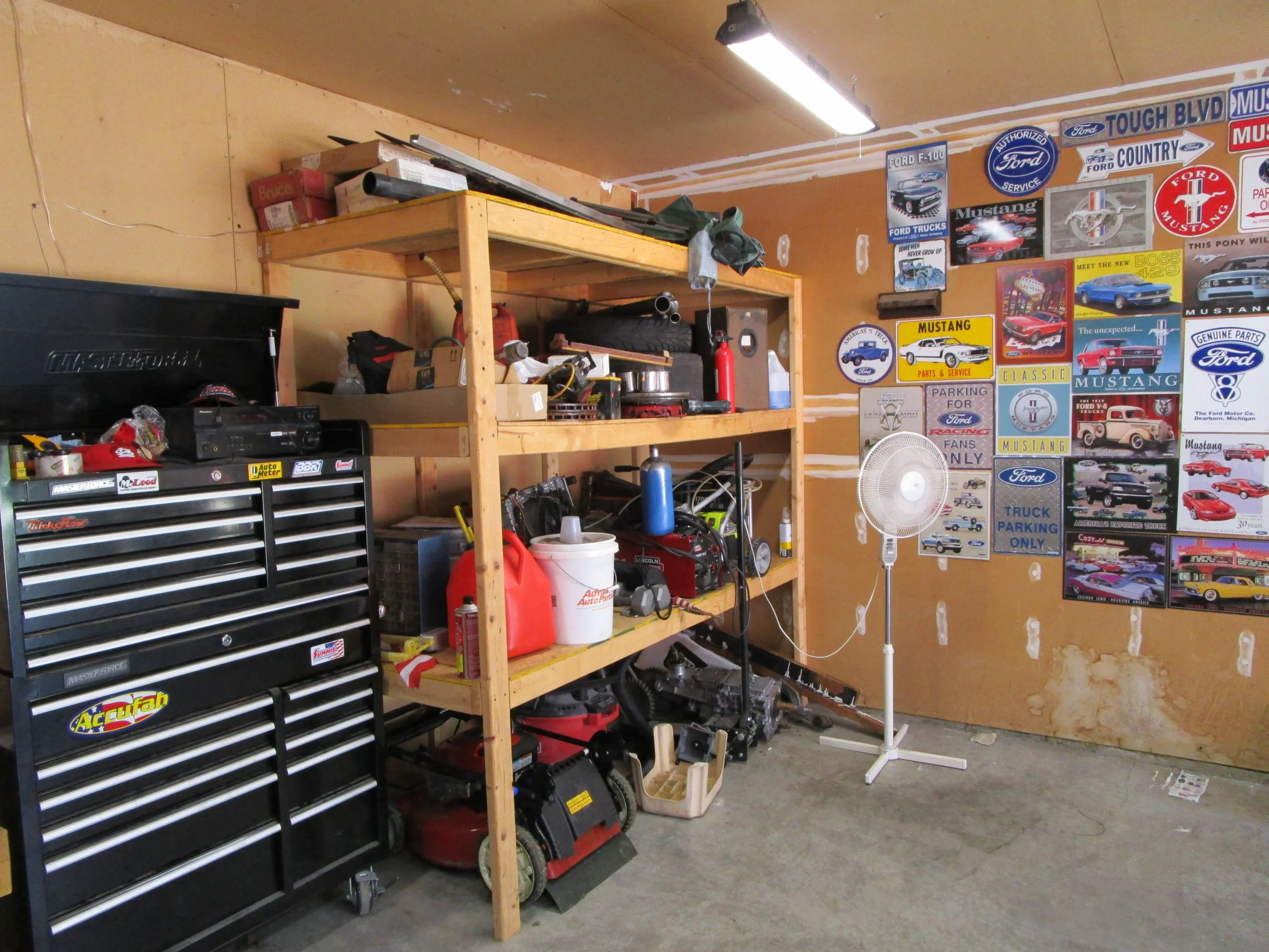

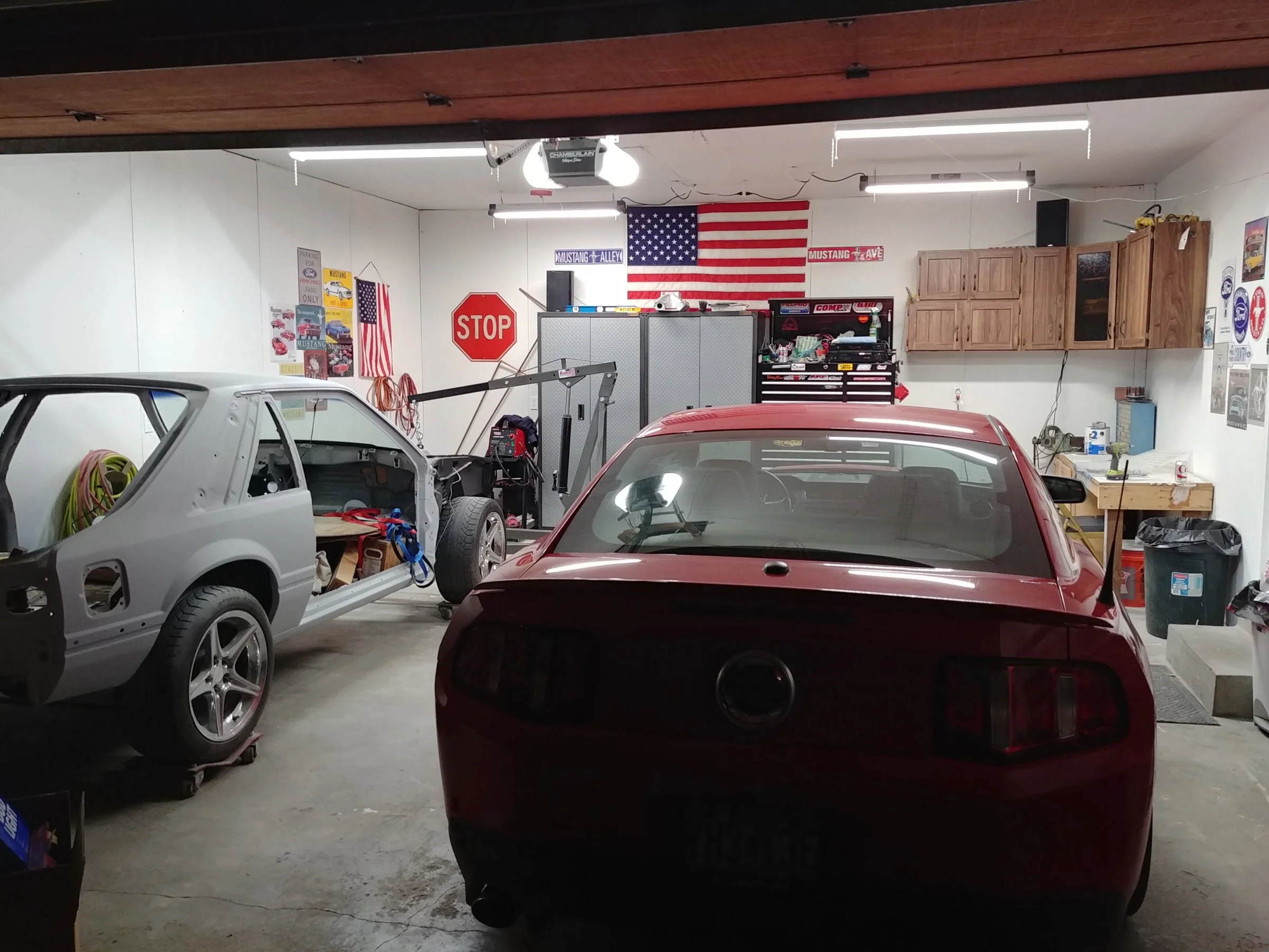

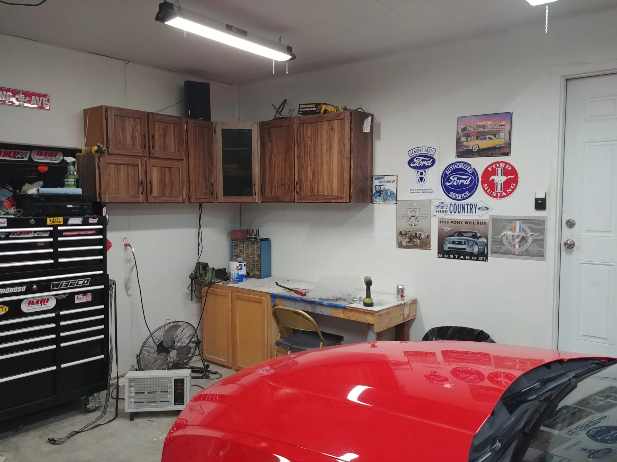

so what have i been working on? well, the state of the garage was getting a little frustrating. too much clutter, too much equipment taking up space, too many tools/supplies out in the air getting covered in sanding dust, and ugly yellow drywall. so, i went fixing it.

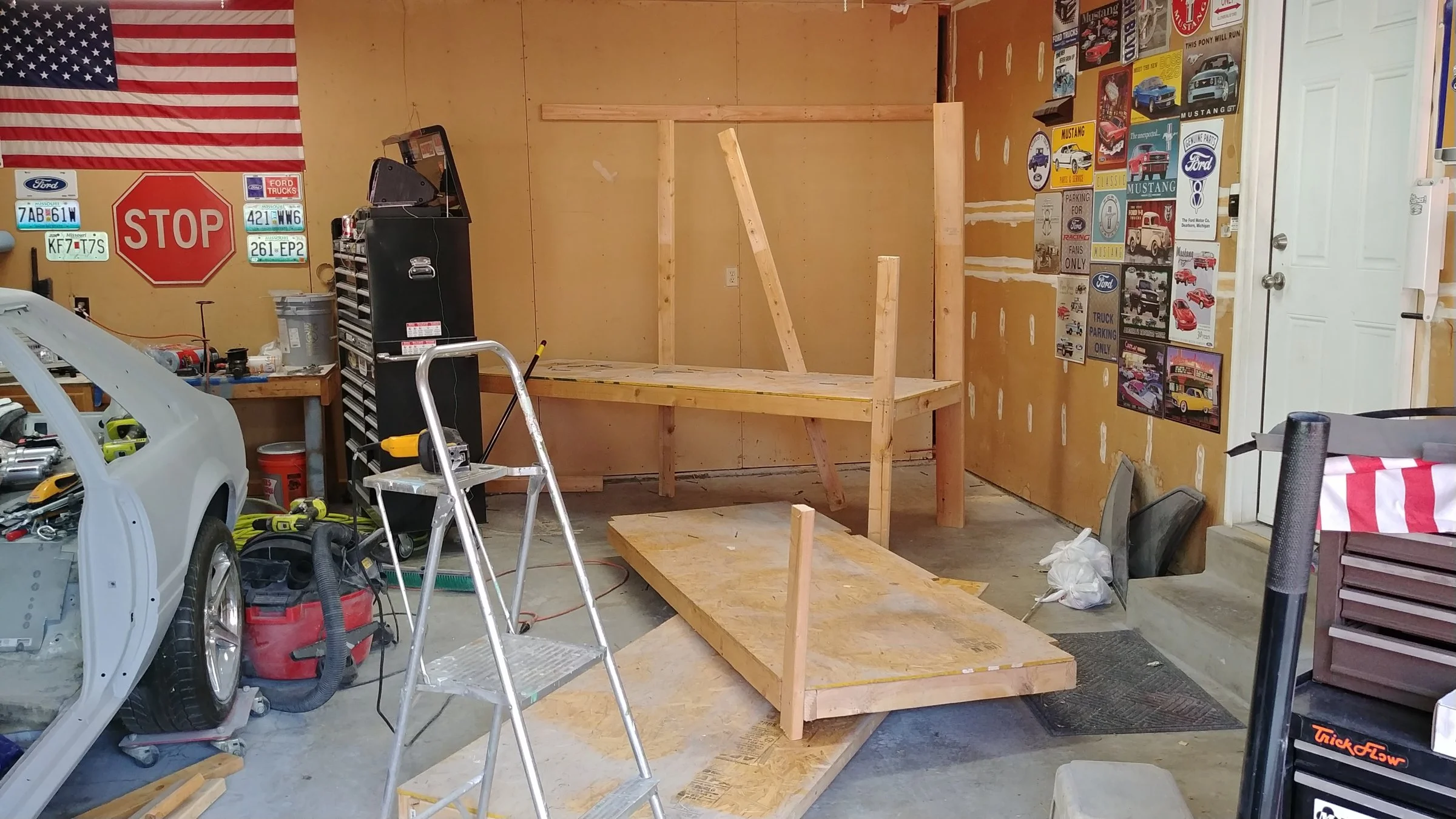

this big old shelf thing was the biggest culprit of the clutter. just became a catch-all for everything, so it had to go.

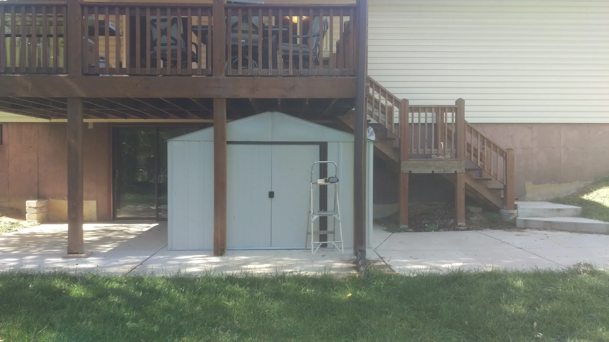

of course, all that :poo: has to go somewhere, so i built a shed under my deck
busted up the "contraption"
painted, patched some holes,moved some cabinets around and added some more, a couple gladiator lockers that were on sale, and this is how it sits now
ill be building a new bench soon, and need to re-do the air lines, but at least the walls arent yellow and theres not a huge pile of junk anymore.

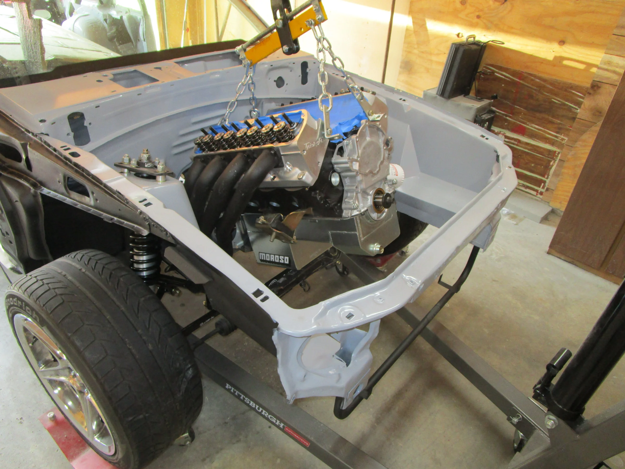

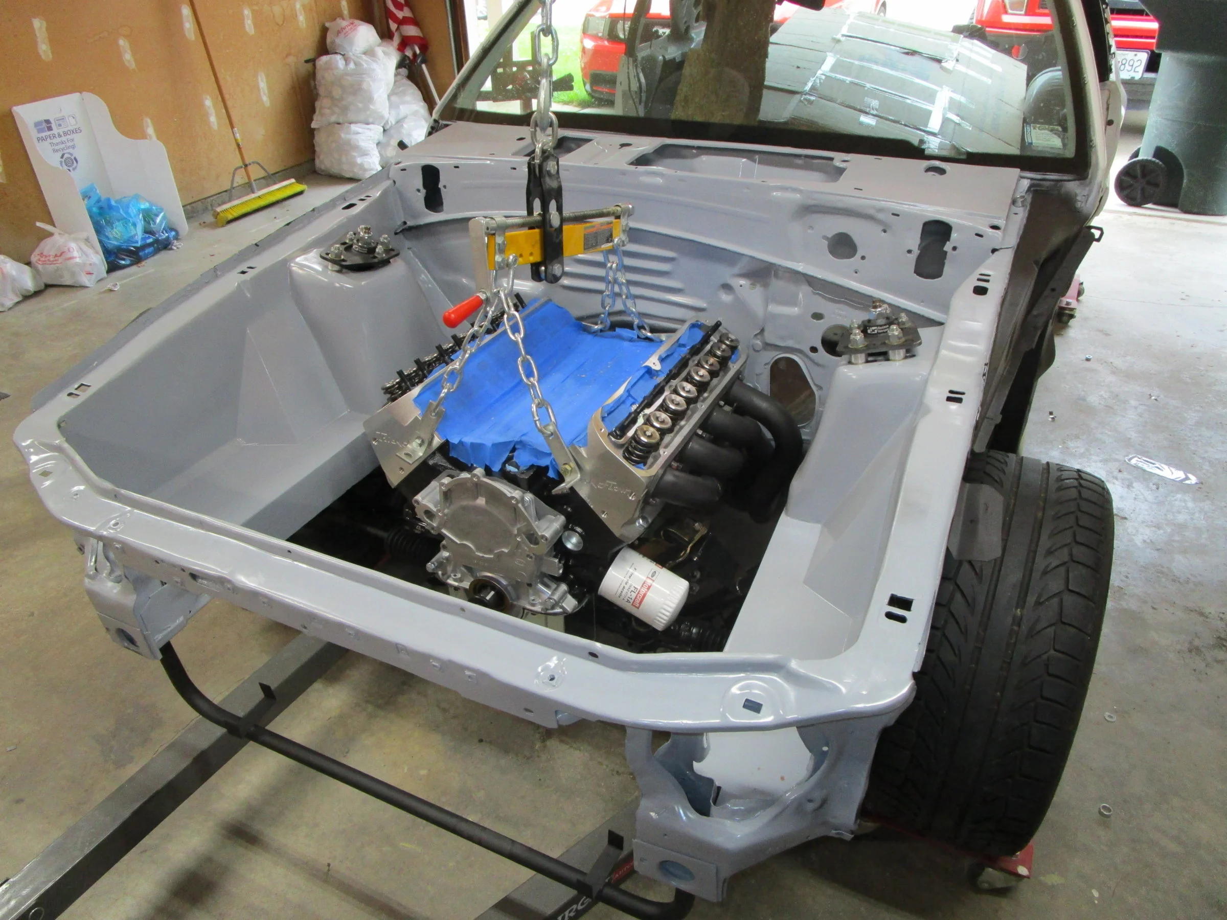

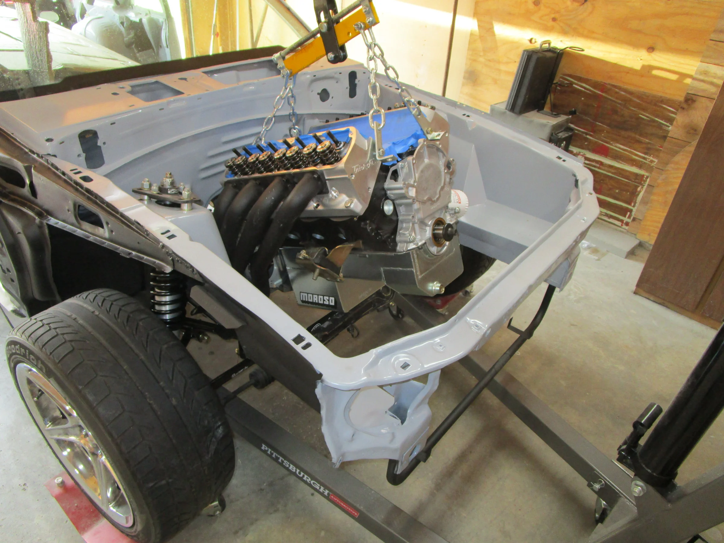

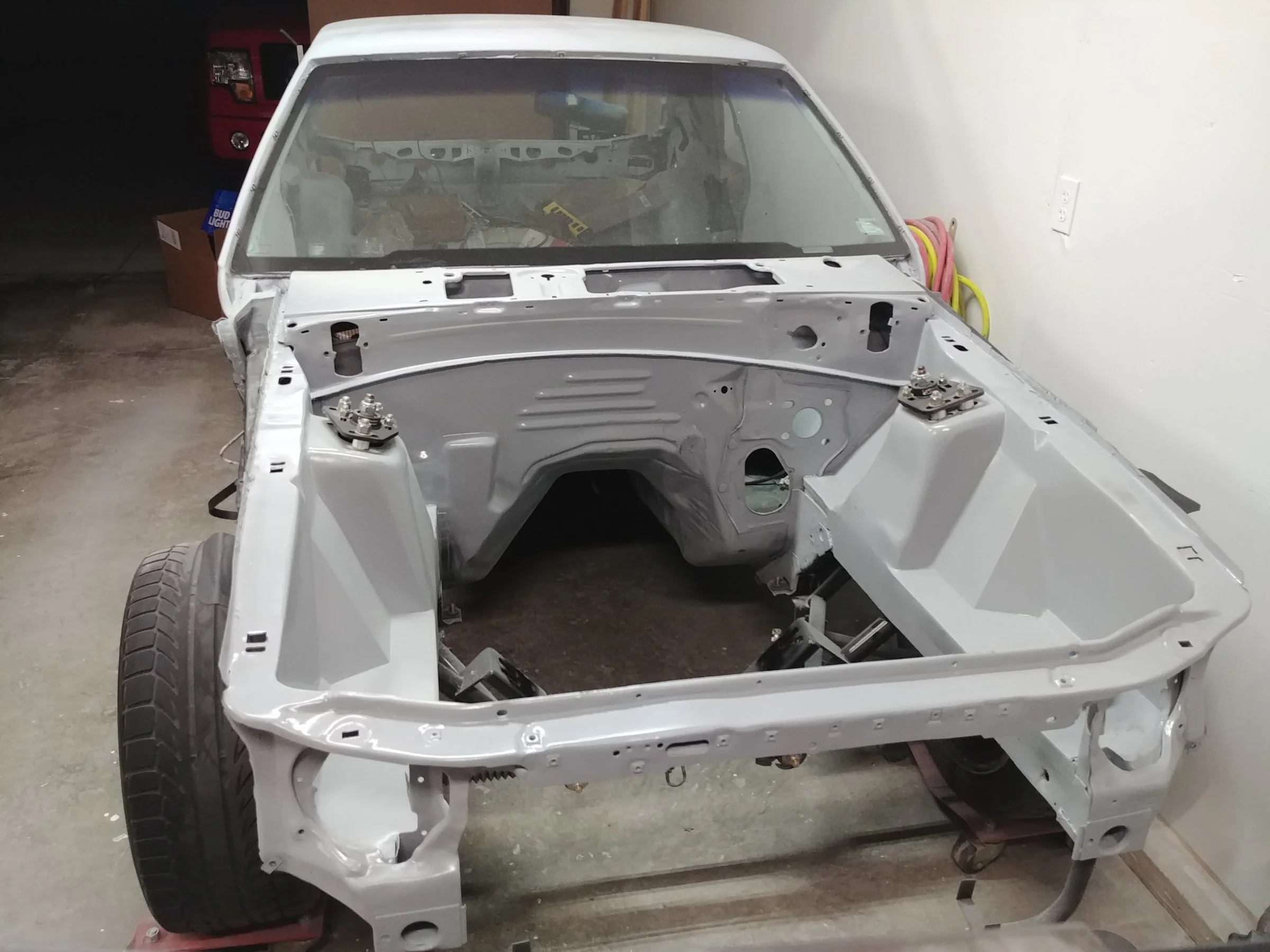

as for the fox: i got the shell stripped, epoxied, bodyworked, and a few coats of high-build on it a week or so before starting the new job, and in preparation for my summit order, got the motor pulled out in about an hour and a half this afternoon.
plan for the holiday weekend is to basically button up the motor, maybe paint it, hopefully without freezing my ass off (high in the 20's on tap the whole weekend :fuss:) .
