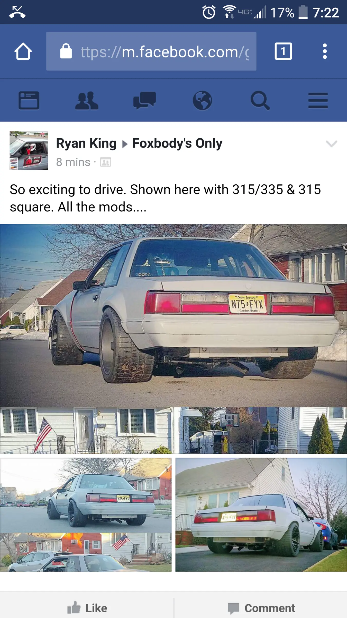

Most of the regulars know I've got super huge wheels and tires out back. Upgraded the rear control arms and went with mach 1 shocks but left the stock springs. Body roll is obnoxious. I'm looking for a spring/shock combo that will severely reduce if not eliminate this. Not really looking to get lower although I probably could drop up to an inch but would prefer stock height if possible. If I can't figure this out the 315s are coming off.

Up/down isn't a problem. It's taking a corner at anything faster than a crawl and the body pitches over like the Titanic.

Oh Jeesus. #goals
