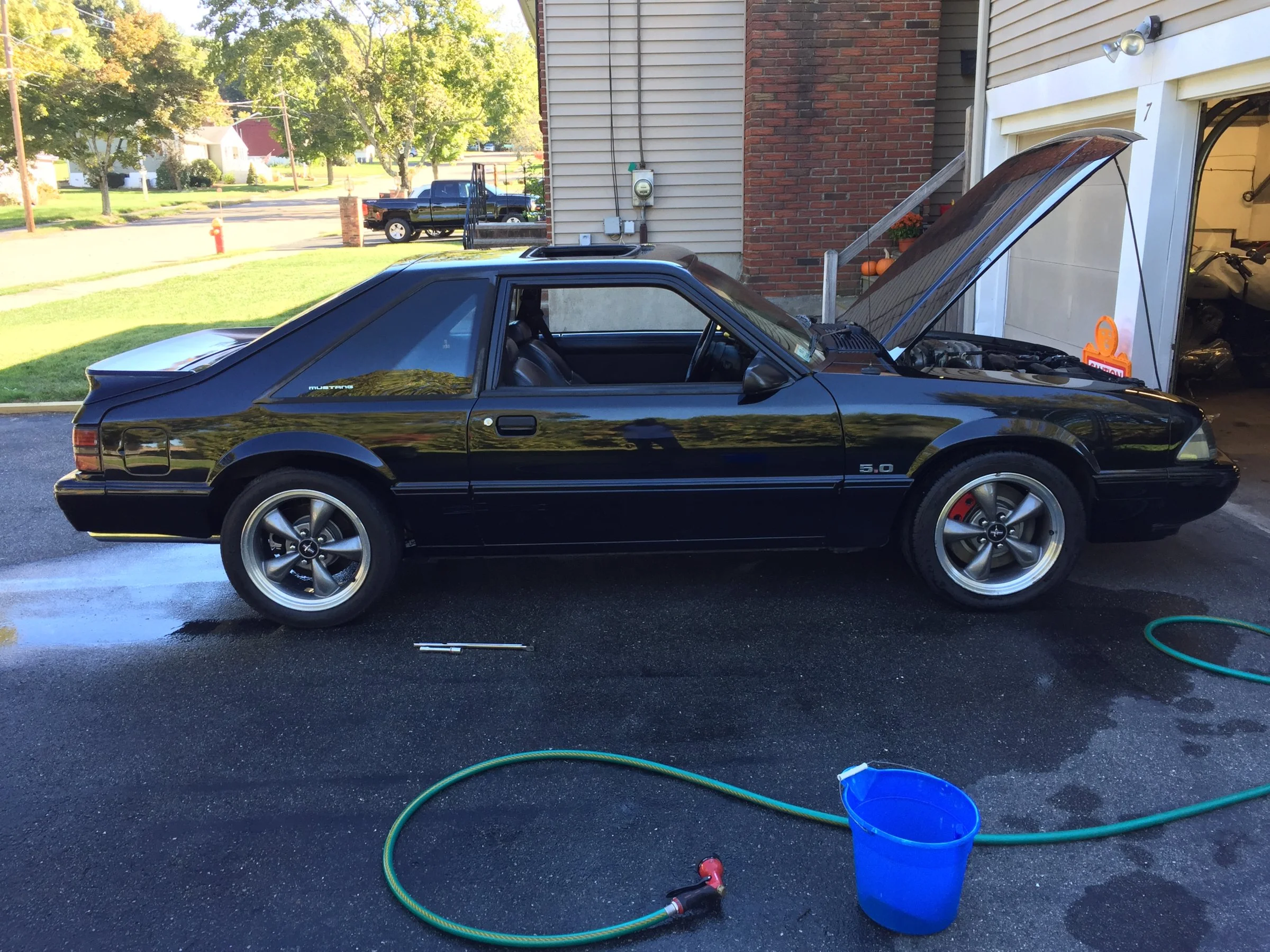

Did your height drop with the mach1 springs?
It's probably at stock height, or maybe a tad lower. I could definitely go for 1/2" lower. I have the MM adjustable arms out back, so that's easy to do. The front? Might have to trim 1/2 a coil. The spring rates are 600 lb front, 250lb rear. I believe stock Fox spring rates are 425-530 front, and 200-300 rear.
