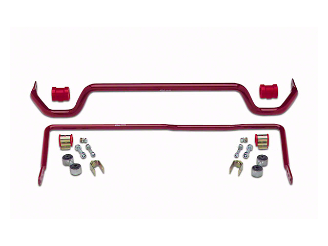

Most of the body roll is generated at the front of the car, but the Eibach rear swaybar makes a noticeable improvement, and pretty cheap too. The only problem is it hangs down ridiculously low at the corners.
