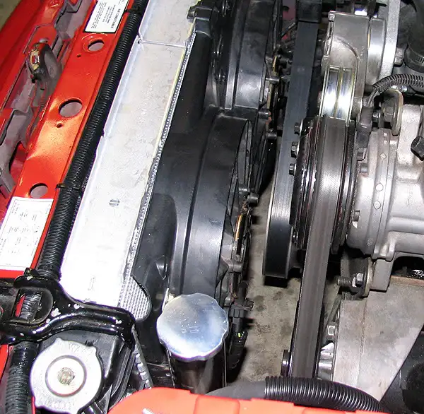

I run a dual fan out of Contour with DCC control.. works great and keeps it cool.
