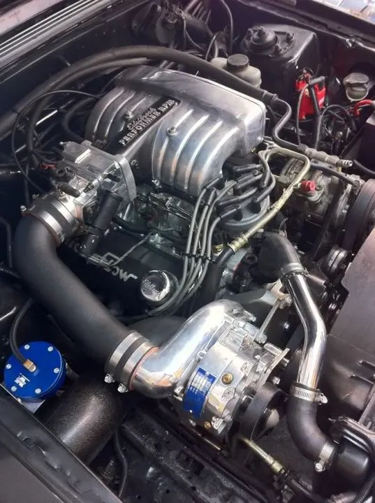

Here is the V3i kit they we installed on a friends car. We ran the FMU and 30lb injectors and UPR power pipe.
Okay thanks for the replies. I assume the FMU is some type of fuel management? I could be wrong. But, now I know what I need to get things started. A buddy had a 190lph pump brand new in box but I want to do it right, and once.

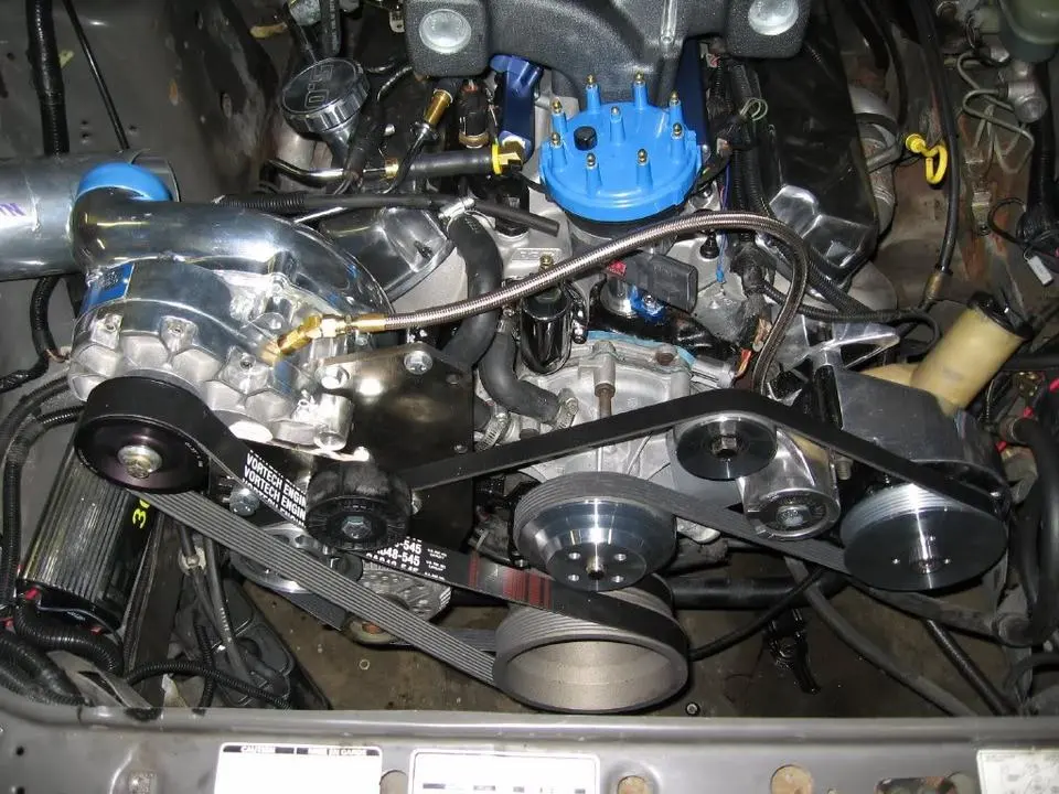

Bringing this back from the dead. The vortech kit will be here in a week or so and I want to get any additional problems I may have delt with before hand if possible. The newest one on my mind is I am running a trickflow a/c delete, that is, the bracket that relocates the tensioner pulley plus no smog pump. Is this going to be an issue when installing the vortech kit? I see from the pictures that the bracket relocates the alternator down by the smog pump. I could put the a/c bracket and compressor back on for the time being until something else could be done. Just need to remember to take it to my buddies house where we will be doing the install. Anybody with experience?
This picture should answer your question. You will need a smog pump delete pulley for everything to work.
