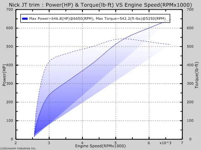

Here is the dyno graph from my S550 with a JT trim. Car makes 11lbs of boost and has no other mods with the exception of ID1000 fuel injectors, Boost a Pump and Magnaflow Catback exhaust. The car makes a ton of torque right of the hit and makes power all the way to 7200 rpms. Our first trip out to the track in this car at over 4,000lbs yielded results of 10.98@131 with more on tap for next year.

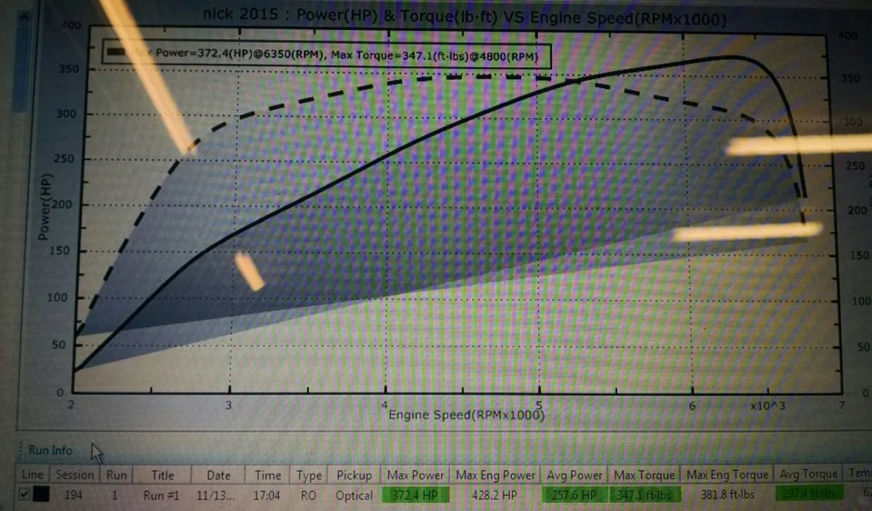

Compare this to the stock dyno graph:

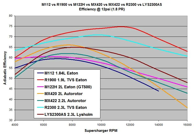

What I'm about to post was pulled off of the Corral. I have been following a build by one of there members for a long time. This info is based off of a lot of effort by one of there members.
This first graph is efficiency at 12psi.

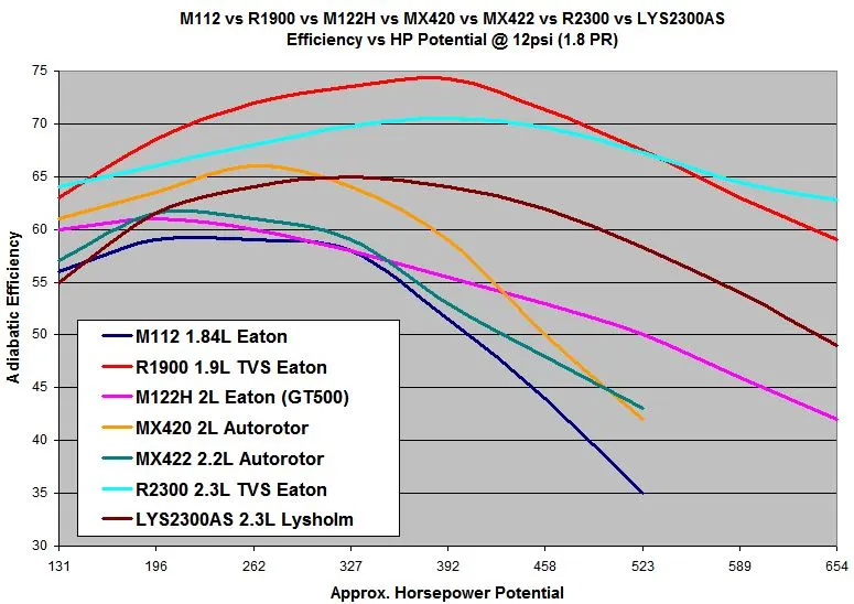

This next graph is the same info but based off of HP potential, this info will change based on CID and other factors it's just nice to see it put plainly.
Of course there are many others to choose from, some twin screw blowers have even better efficiency than these. However the one depicted here are the most common.
