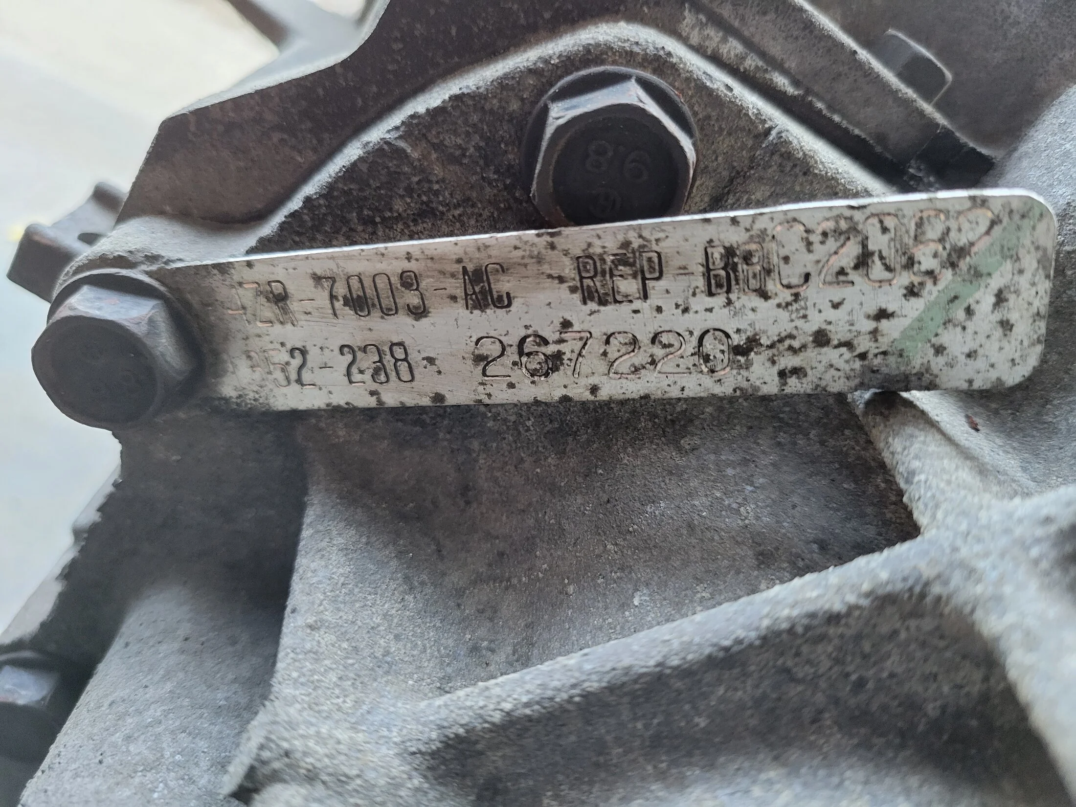

This is where the tag on your trans would be very helpful. A pic of the tag on one of mine sitting on the shelf...
Second row starts with 1352-xxx. In the above case xxx is 238. To me, that is the most important info when identifying a T5.
