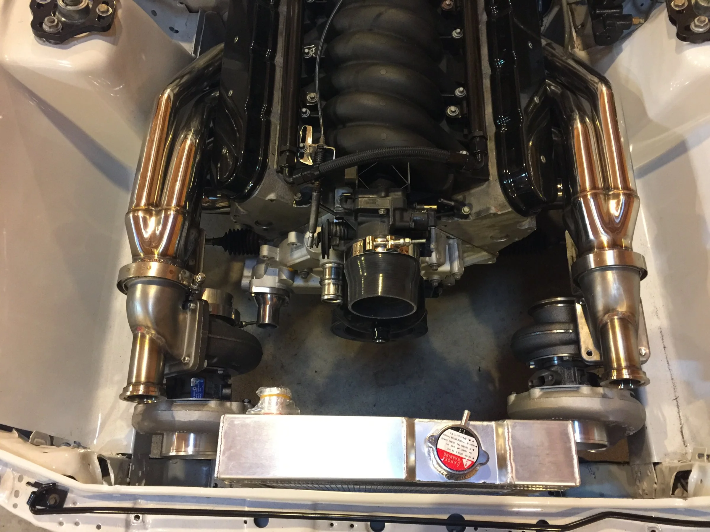

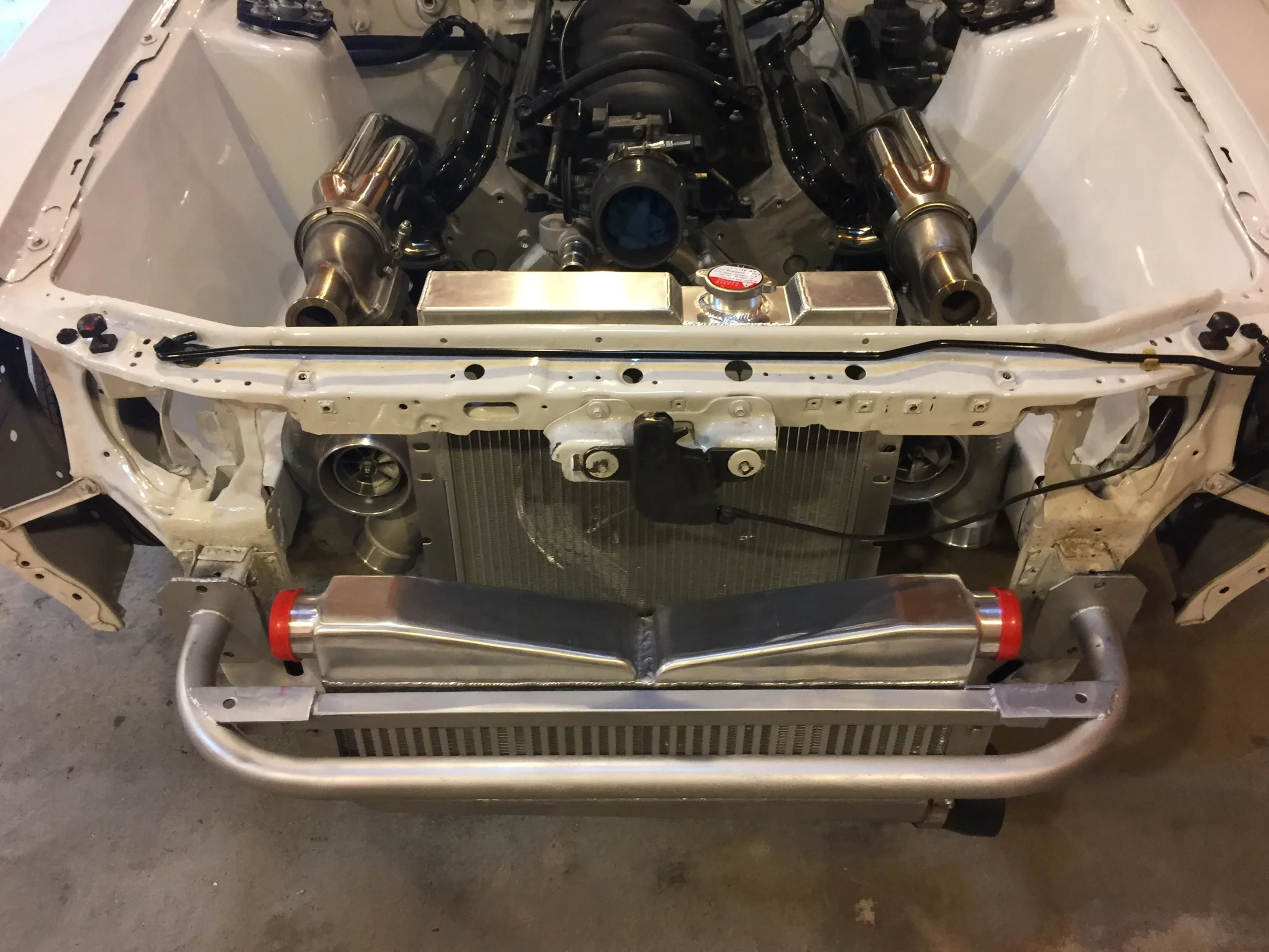

Woke up a couple hours early for work today and worked on the car a bit. Managed to run a grinding disc across my finger but was otherwise productive. Trimmed the side tabs off the radiator and sectioned out a piece of the core support to set the radiator down in. More than likely will still be cutting it off entirely Friday when I start building the coldside as it still needs to come down below the upper core support.
Still need to cut off the rest of the side brackets but it looks like I'll have plenty of room for filters and the radiator ports line up great. The fan that came with the radiator is grossly undersized so maybe a contour fan or something will be in order.
I recommend my black hole causing, time warping, cat sucking fans.
It's a wonder that the fans don't consume the radiator that they are attached to.
Need a link?
I had to reduce the height of my saddle as well because I was using a really tall radiator and it stood above the upper as well.
Need a link?
Yes please. So far I've been recommended a contour fan and and Acura TL fan but I'm open to suggestions. I kind of sort of want to run it as a pusher fan but having the thought is as far as I've gotten. I know they're far less efficient setup that way.
Also wondering if there's any real statistics on cooling improvement with a 93 cobra grille insert. I like the GT nose just fine, but I imagine the whole operation would benefit from the additional air.

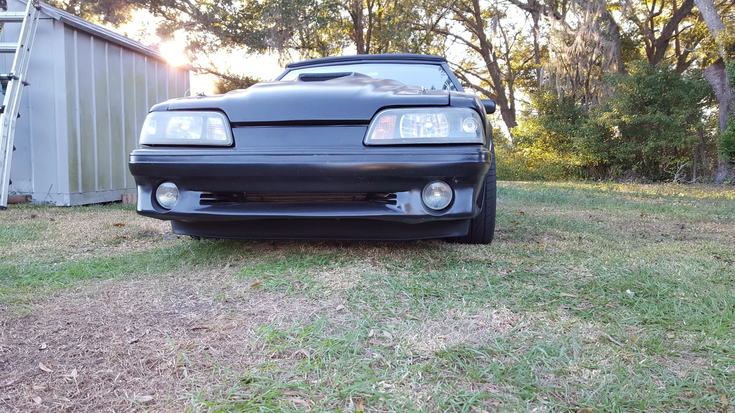

To increase air through the grill, increase the height of the front air-dam.
There is an air-dam out there for either a 93 or a 96 Ford Bronco (I think it's the 93, I'd have to look to be sure). It's ABS plastic and is drill and sand to fit. It makes an amazing difference. Splitters are badass on Fox bodies IMO, if you're into fabricating one.

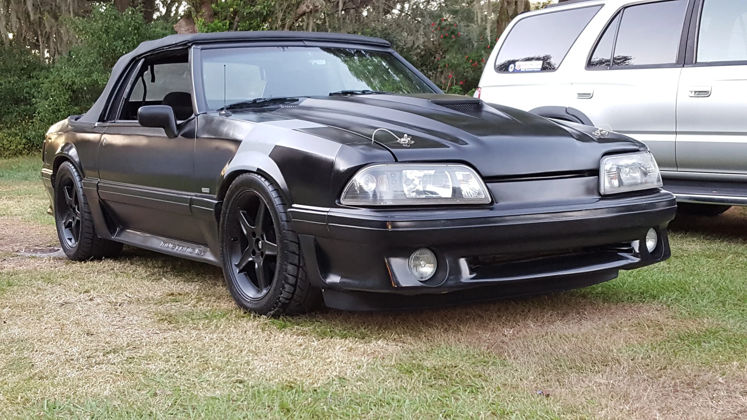

The air dam in question.....
I just installed this last week
It's still on there then! Thought for sure it would get tore off.

stykthyn said:
I've read mix reviews on how well it works( none actually documented by scientific or engineering methods)
Works very well I no longer get the temp creep when blasting down the interstate. and it looks sweet. only cost me 38$
