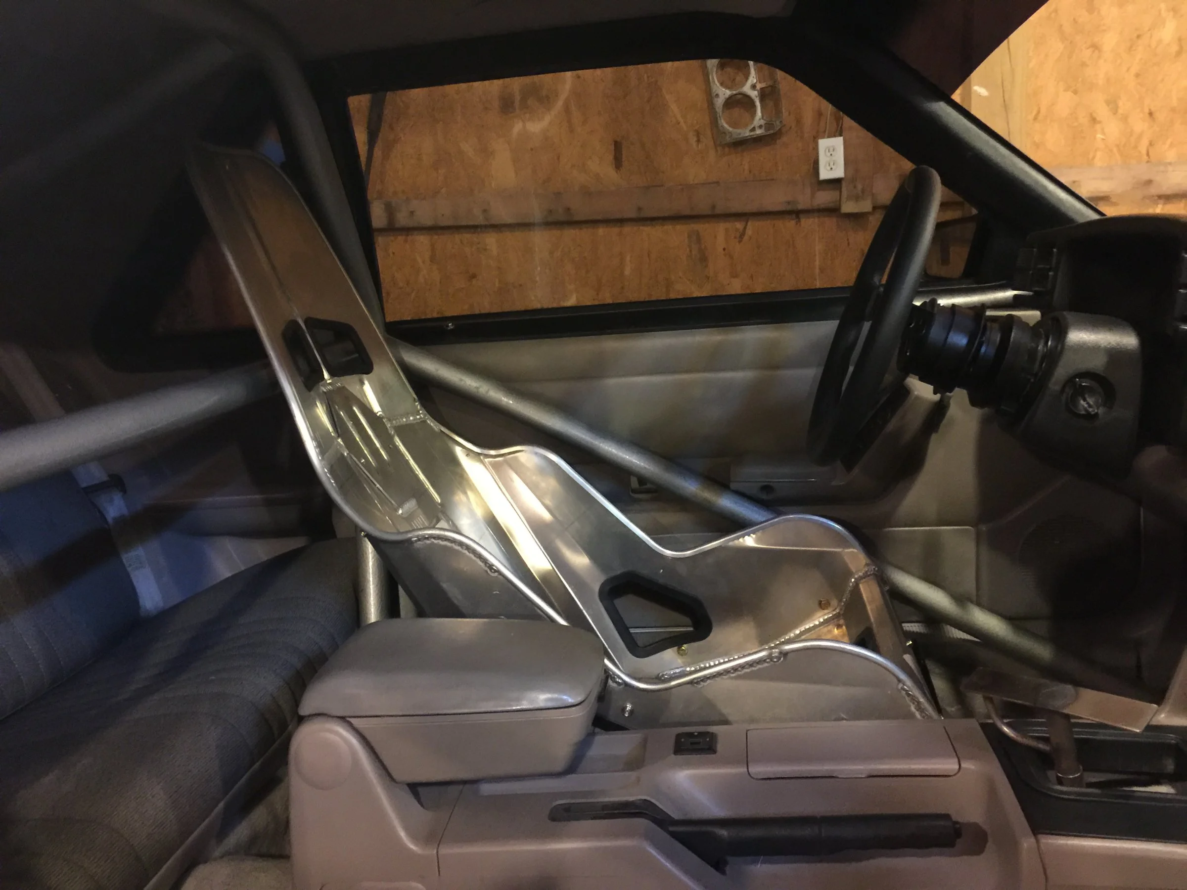

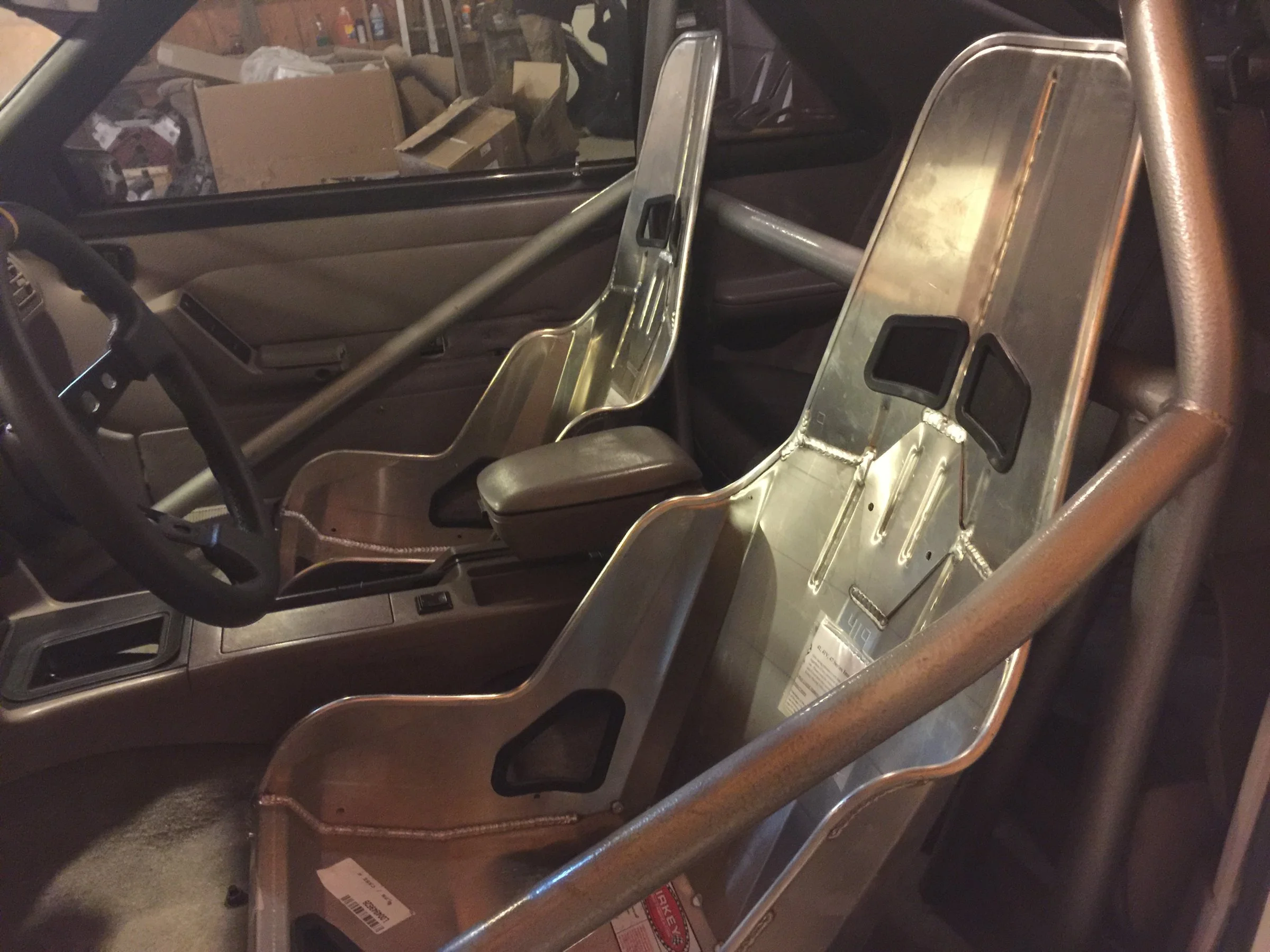

Test fit the seats, will get the brackets installed tomorrow and get the drivers seat mounted how I like it. The Racecraft mounts allow for a ton of adjustability. Some won't care for the seats but with a cover they're really comfortable.
Feel free to admire my hacked up arm rest, still irritated that it looks like that but don't have any good solutions at this time.

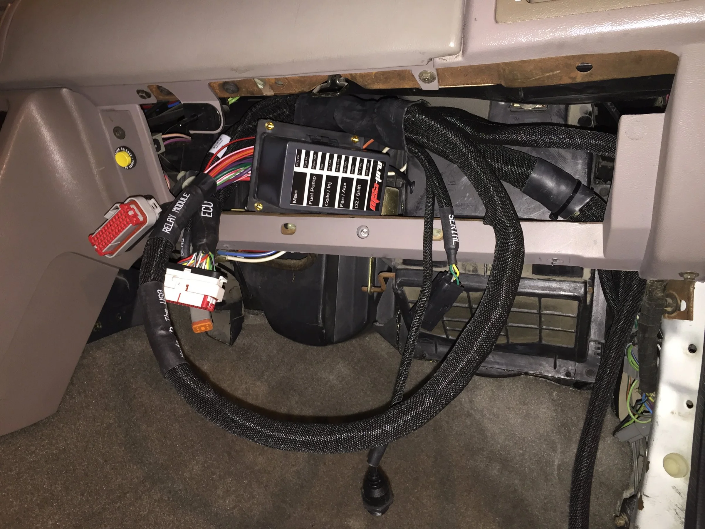

Also got the MS3 harness into the car. Which was a lesson in patience to say the least.
This car still has every bit of factory padding/carpet/sound deadening etc etc and for whatever reason I really like it that way. Not even going to pull the heater core out.

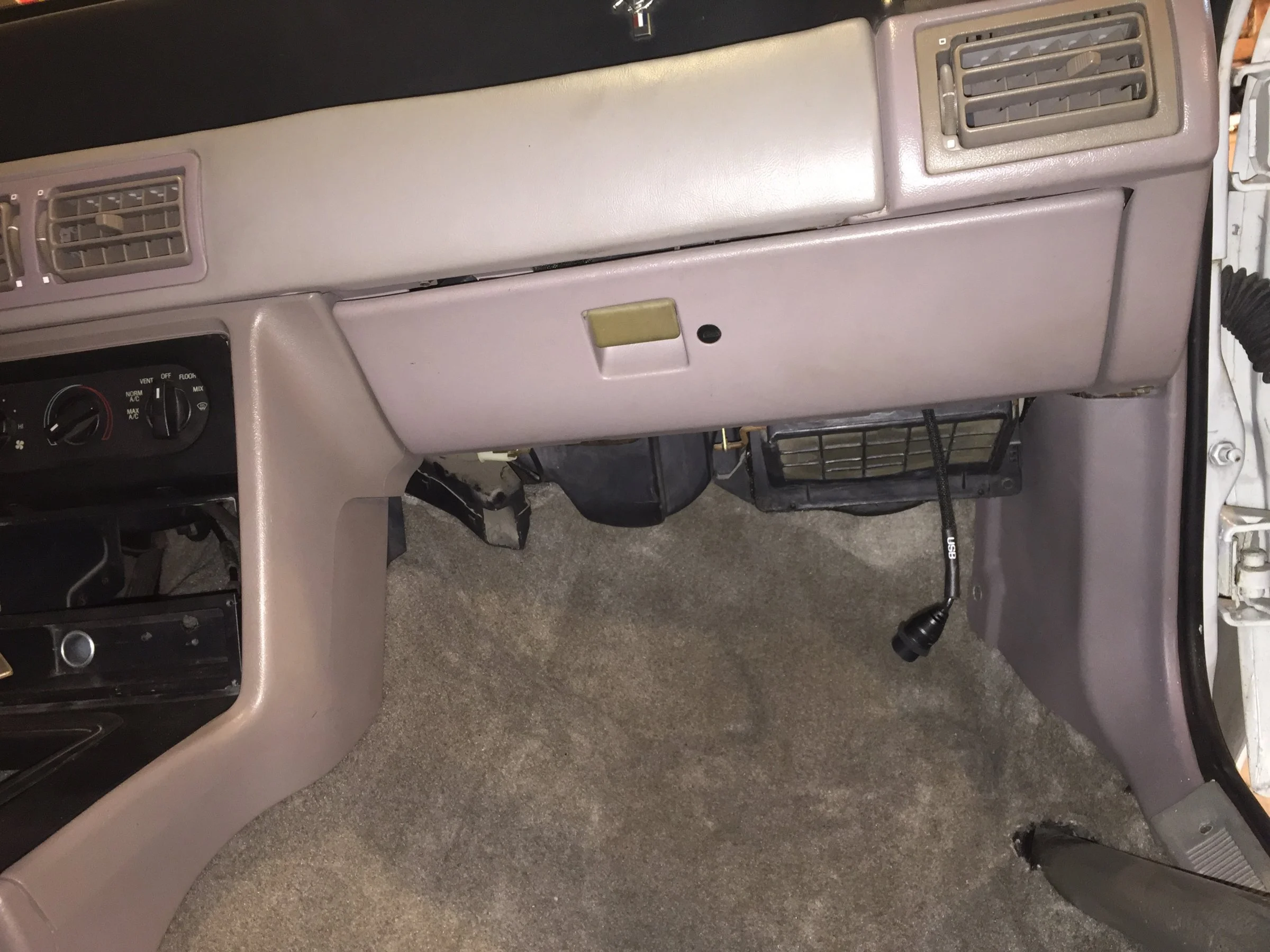

I cut as small of a hole as I could in the passenger footwell area to run the harness. From there it went under the frame rail between the K member and up and behind the passenger cylinder head. It's all kind of strung out in the picture below but as far as rats nests go I think it still looks fairly nice.
The fun part was when I realized I hadn't passed it through the glovebox like I meant to. So I unplugged it all and took it back from behind the passenger cylinder head, down between the k member and frame rail, around and through a small hole in the footwell. One awkwardly shaped clip at a time. Then through the glove box and down through the small.....you get the idea.
Good times.
I'll be modifying the glovebox guts a bit and mounting the fuse panel/ECU up here where it's accessible but not visible. Battery leads look like they're long enough to make it back to the battery so for a non-fox specific harness it's worked out great so far. Will have to cut out the coil pack plugs from the main harness and move them towards the coils mounted in the fender well. I'll also have to extend the alternator pigtail but I was already prepared for that one.
42" plug wires are a bit excessive as you can see.

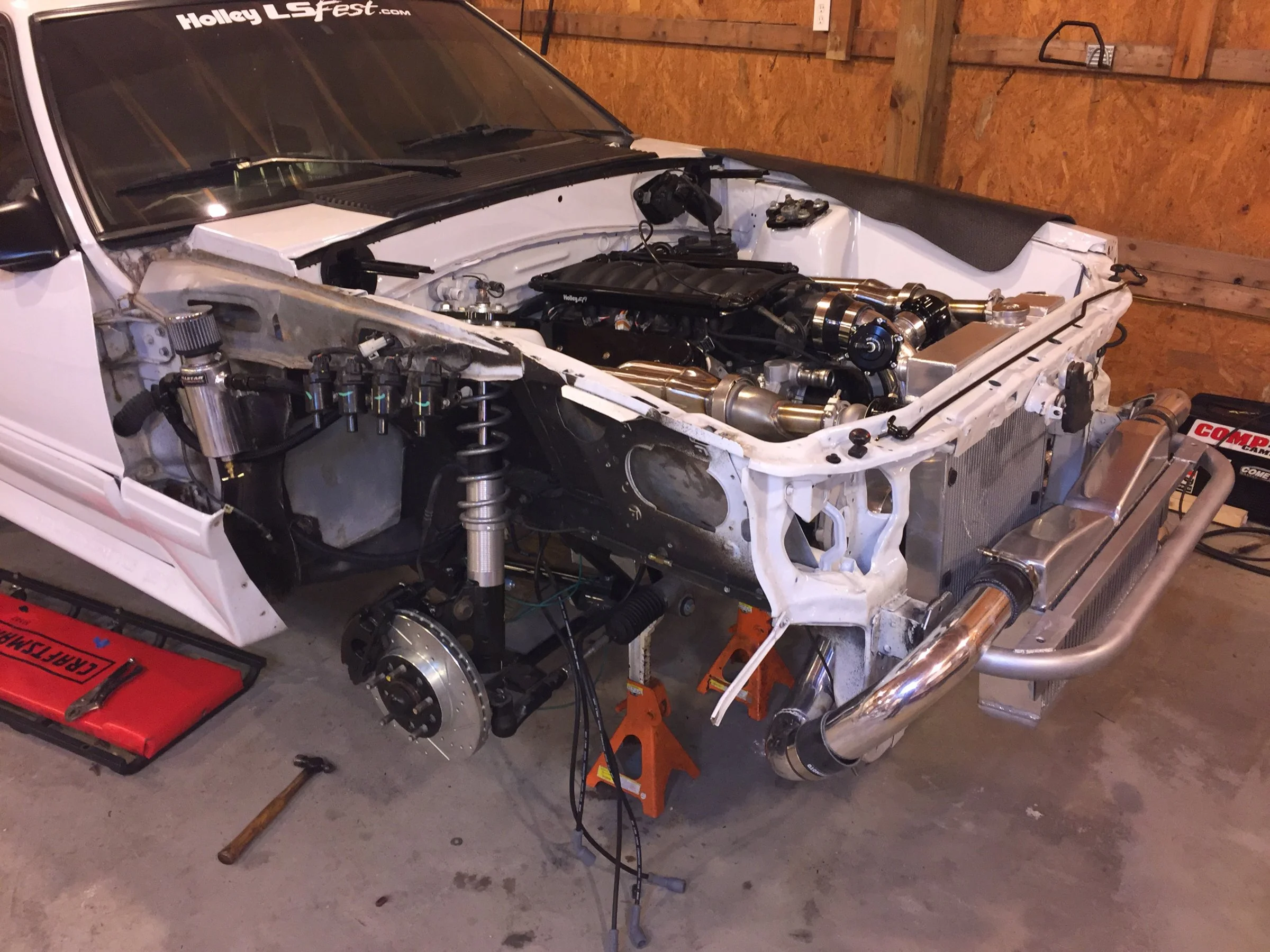

Also started laying out the pushlock setup I bought to plumb the gates and BOVs. I'm really green when it comes to the required layout so it'll take some trial and error I suppose. I've got a vacuum block mounted to the cylinder head you can see above, I'm hoping will be a centralized home to nearly all of it.

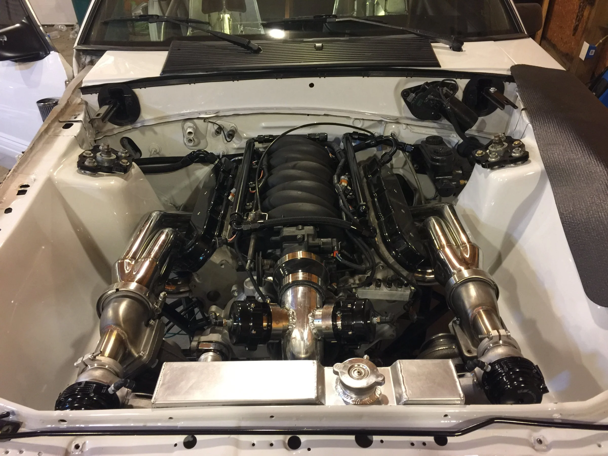

My only 'negative' comment is that the breather tank is going to be a whore to drain when it's all back together. Other than that, it looks fantastic.
Can reach it with a water bottle through the wheel well without removing anything. My only concern is its alignment with the rear tire should it leak. Really don't want it in the engine bay though.
Good point.
should I move mine?

I'm not going to. Might mist the fenderwell pretty good but I don't want it in the bay or the trunk. Might upgrade to a nice Mighty Mouse fan with a check valve and better baffles it it's a problem.

Mikes exactly is that same orientation save for it being on the other side. Makes for interesting conversation....
"hey there Bud,....your fender's smokin'"

Cool. I didn't like where mine was to begin with, so I feel good about moving it out now.

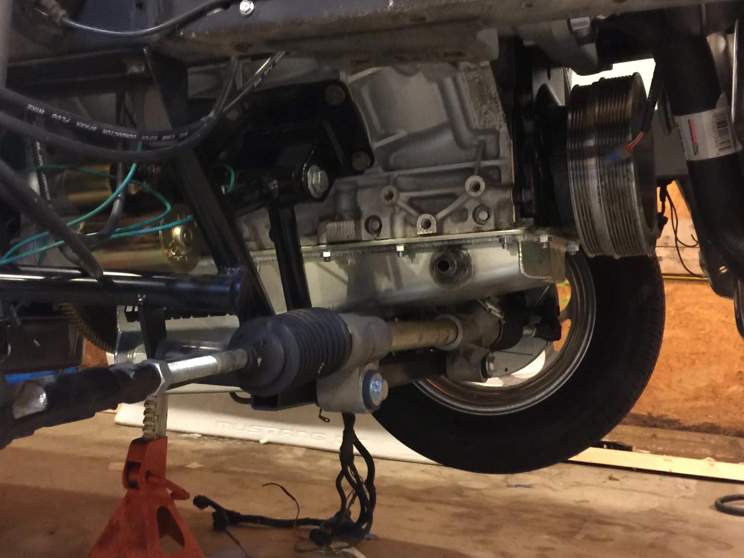

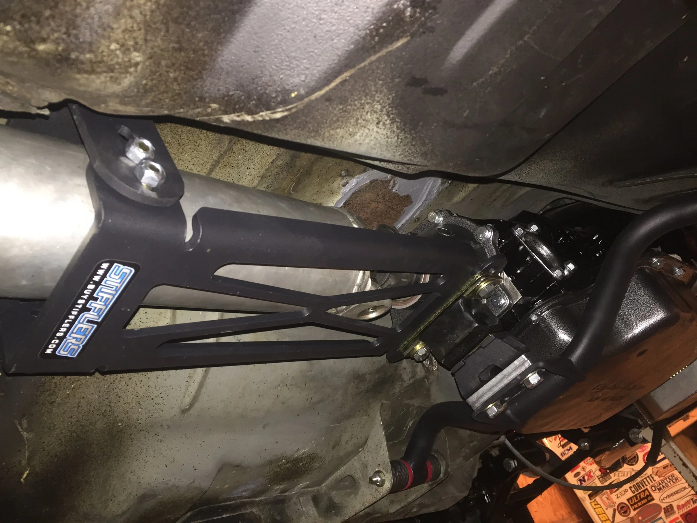

For whatever reason I've had it in my head that this nice aluminum driveshaft I've been saving is for a powerglide. It came with the cobra when I bought it 2 years ago. I measured it right after I picked up the white car and I've had 51" in my head ever since. I pulled it out today for the hell of it and it measured a little over 48" which is roundabout the length needed for a th400. So I swapped the yokes (it did have a pg yoke?) and it fit like a glove.
Saving me $300+ I would have spent putting a plain old steel shaft in it.
Calling that a win.
Also put the new driveshaft loop in which I'm a big fan of. No welding/cutting/drilling the car anywhere.
Worked on the wastegate/BOV plumbing a bit today as well as the engine harness, still trying to figure out where it all goes.
I gut the glovebox and made room for the ECU and fuse panel to fit inside with the door shut. It's all kind of stuffed in there though. Heater core will have to go if I want to make it look nice and neat I think. Just not much room.
Ignore the USB connection hanging down I will tie it up somewhere accessible but out of sight.
The Racecraft seat brackets are fantastic. Car is up on jack stands so I haven't got to take it for a test ride but it looks nice. Need to decide on covers. Thinking the grey tweet is the right way to go.

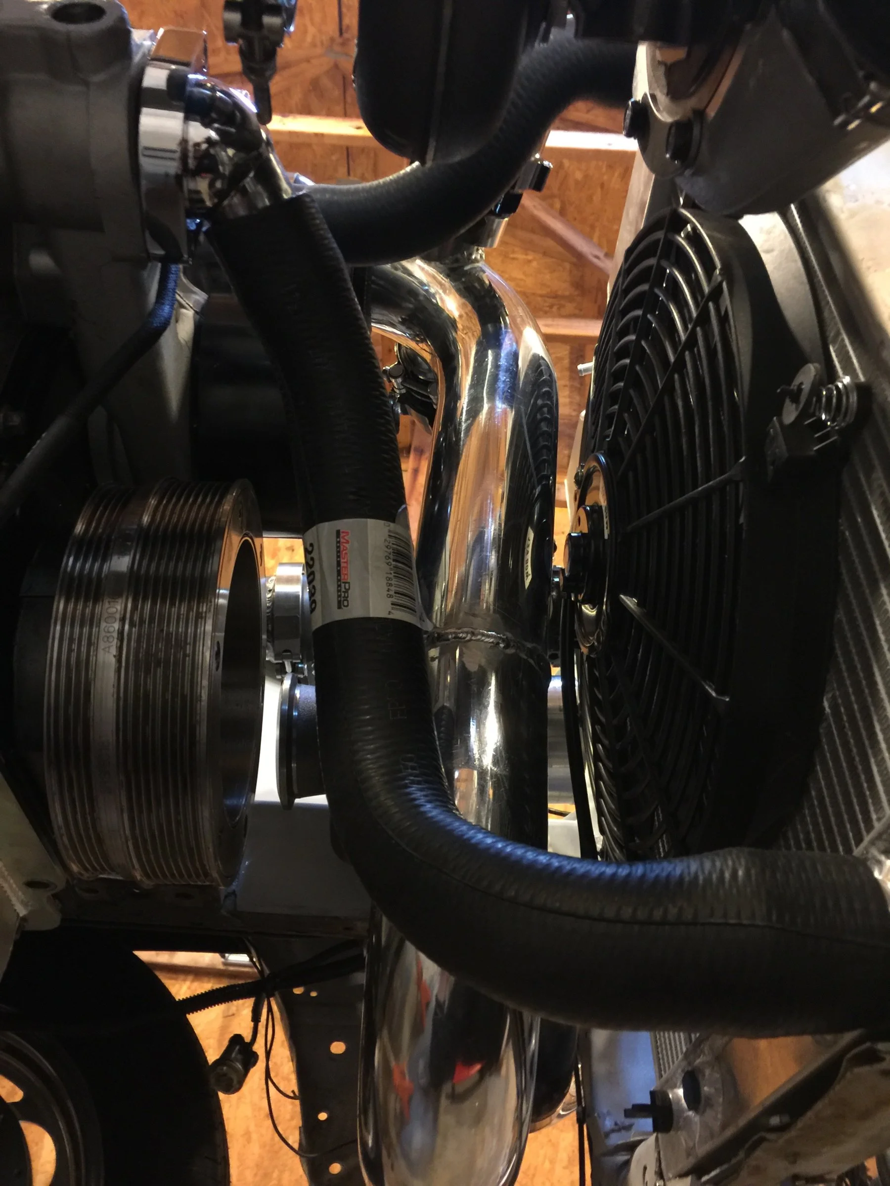

Lastly I took another trip to the parts store for radiator hoses, this time a Chrysler town&country and a Chevy blazer donated hoses for this attempt.
The upper hose contacts the passenger side BOV but I couldn't put it any higher for fear of contacting the hood. Might live with it, might have to go to something like an AN line or braided ugliness. Lower worked out well though. Crossing it off for now.

I think you are going to want to rotate the seats forward, going to be really tough to see with them like that.
Yeah it's got a pretty serious gangster lean. Don't trust the jackstands it's on to flop my big ass in the seat to try it out lol
Mine are pretty much straight up

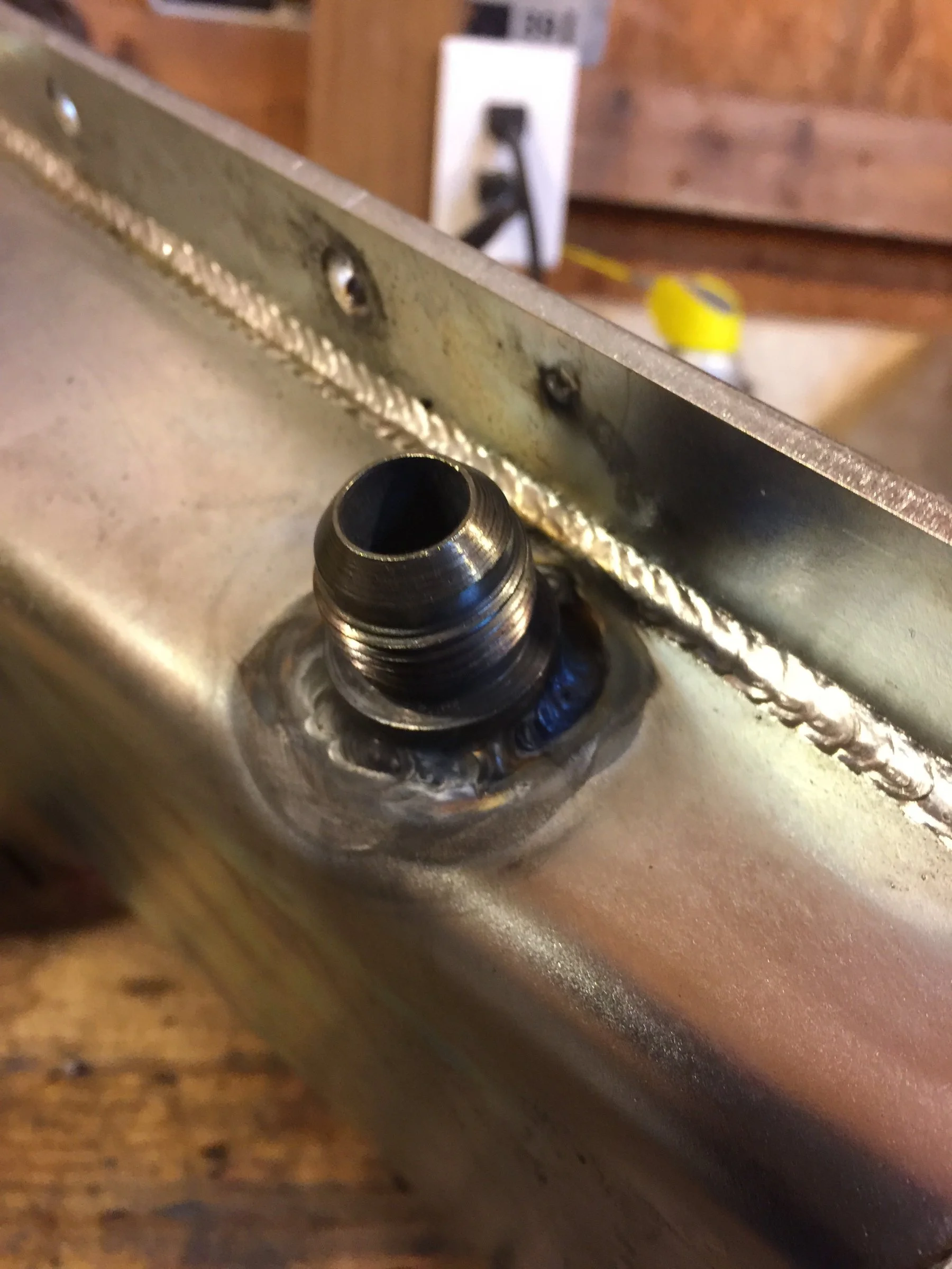

Got the bung welded in my pan today. I bought a holesaw kit from harbor freight a while back and put it to use. I could see the bit moving down further and further but when I lifted there was still no hole in the pan. Just a toothless holesaw bit lol. Stepped drill bit did the trick luckily.
