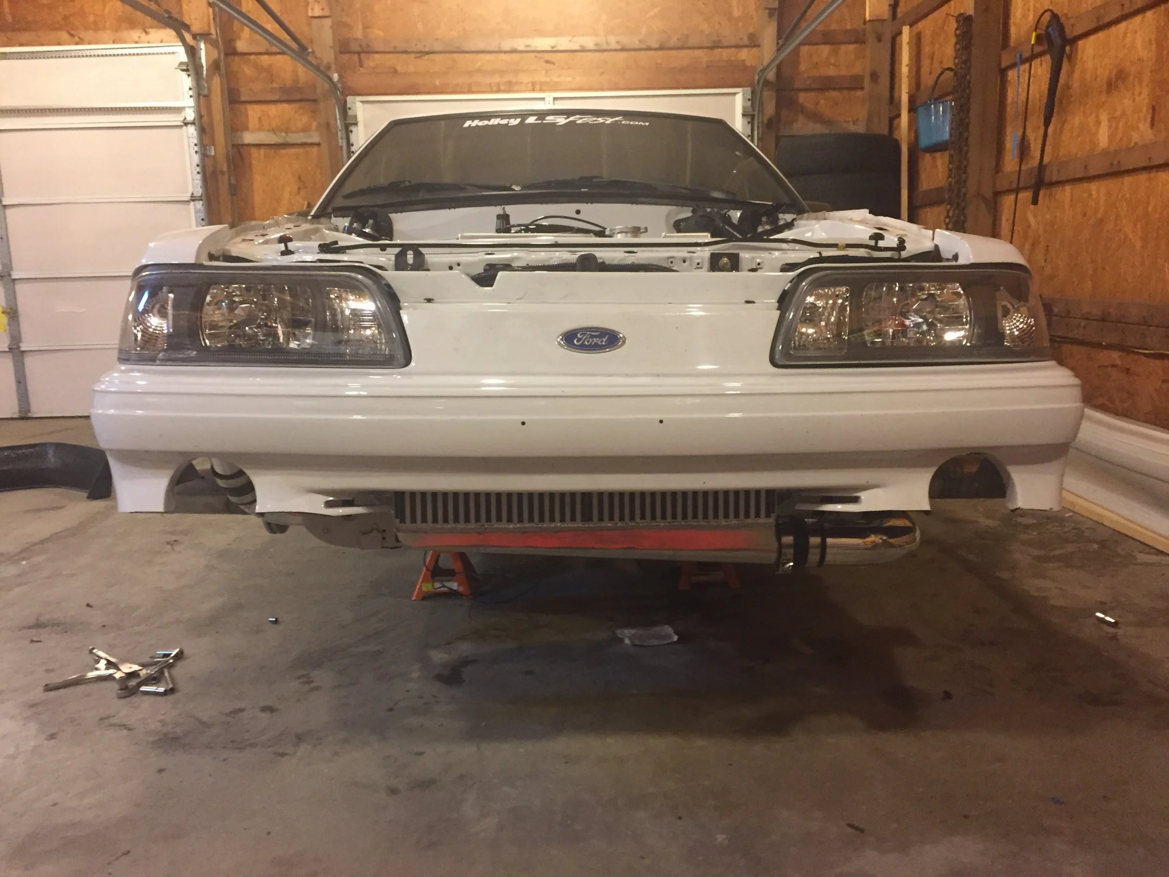

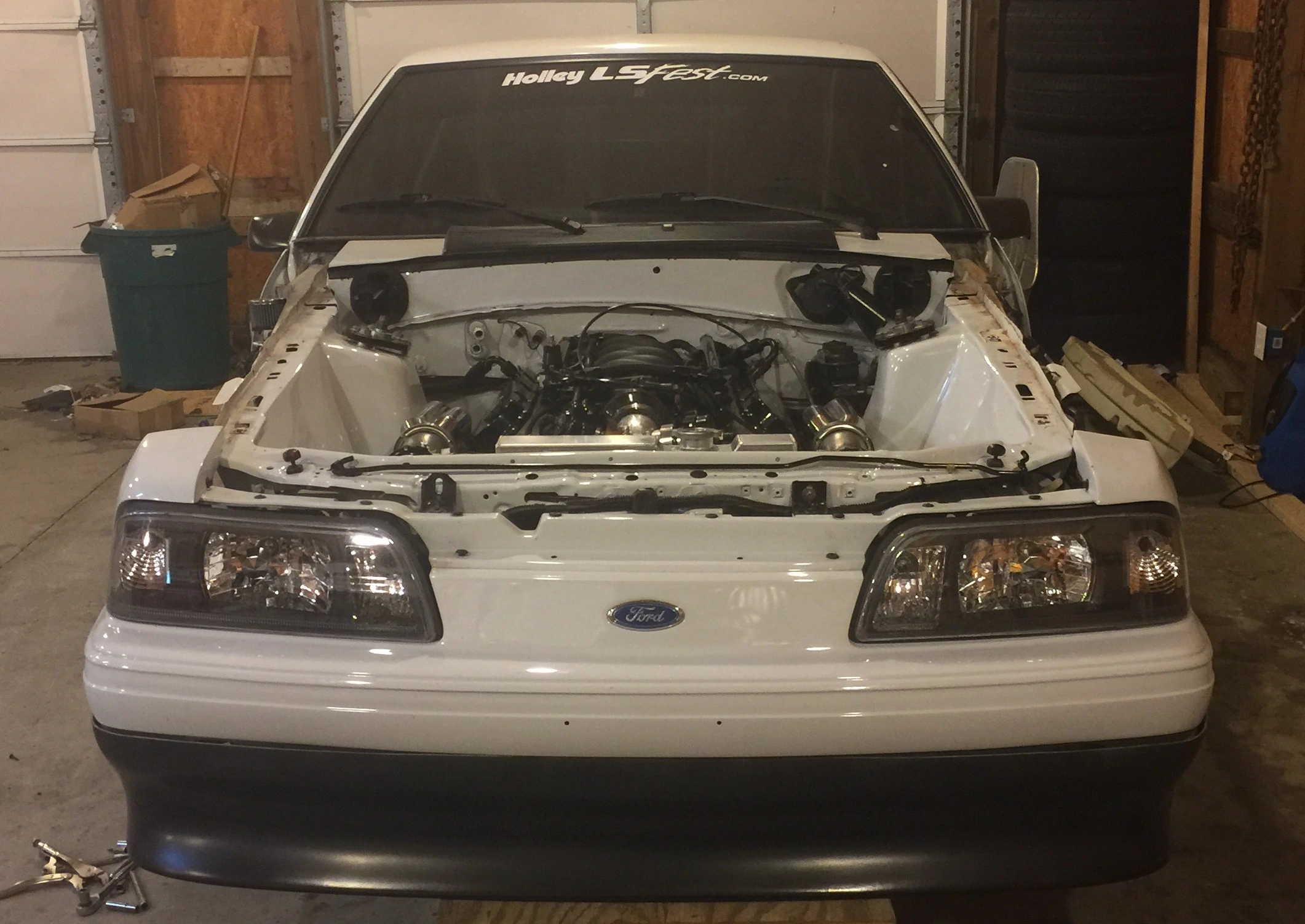

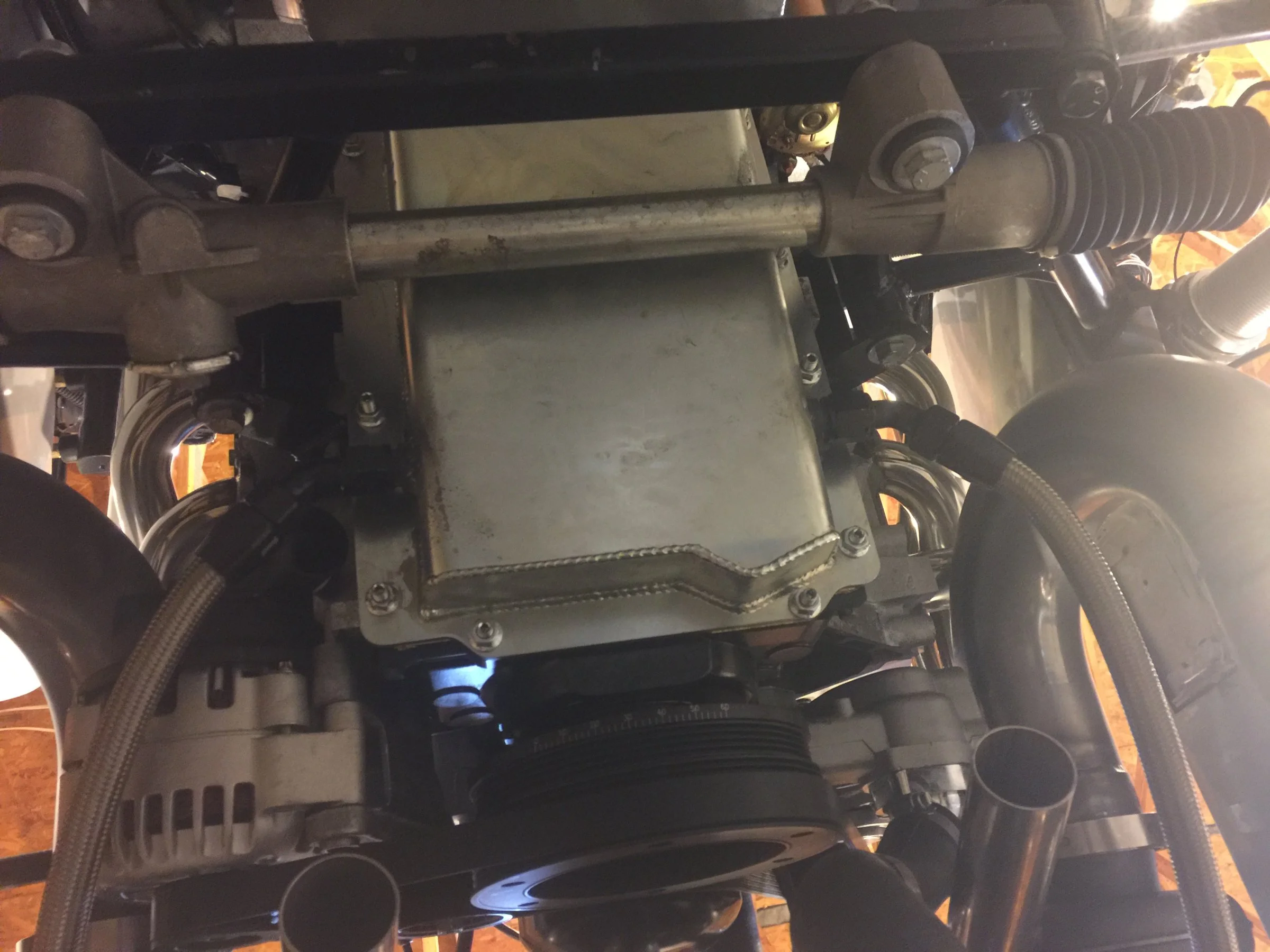

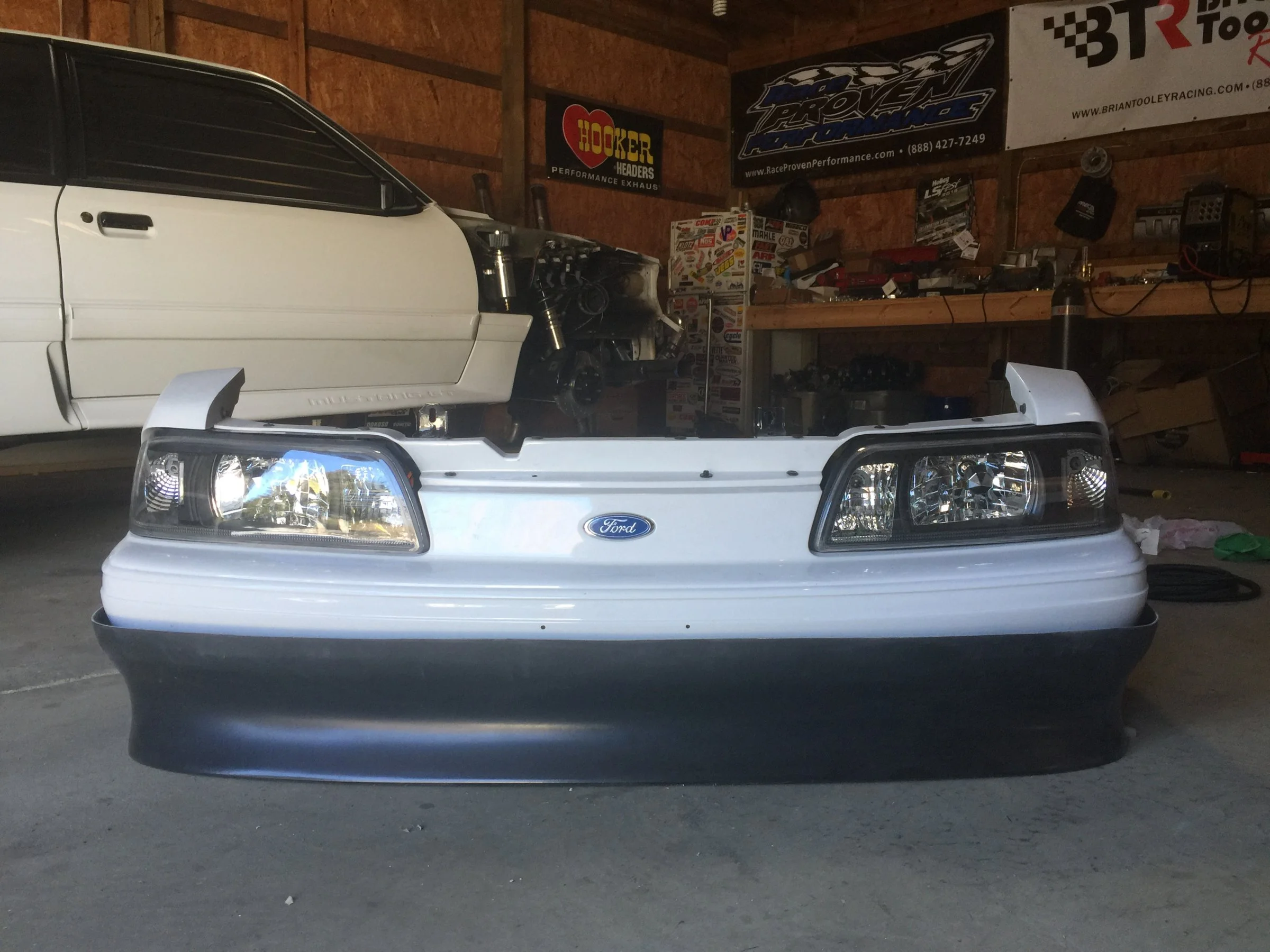

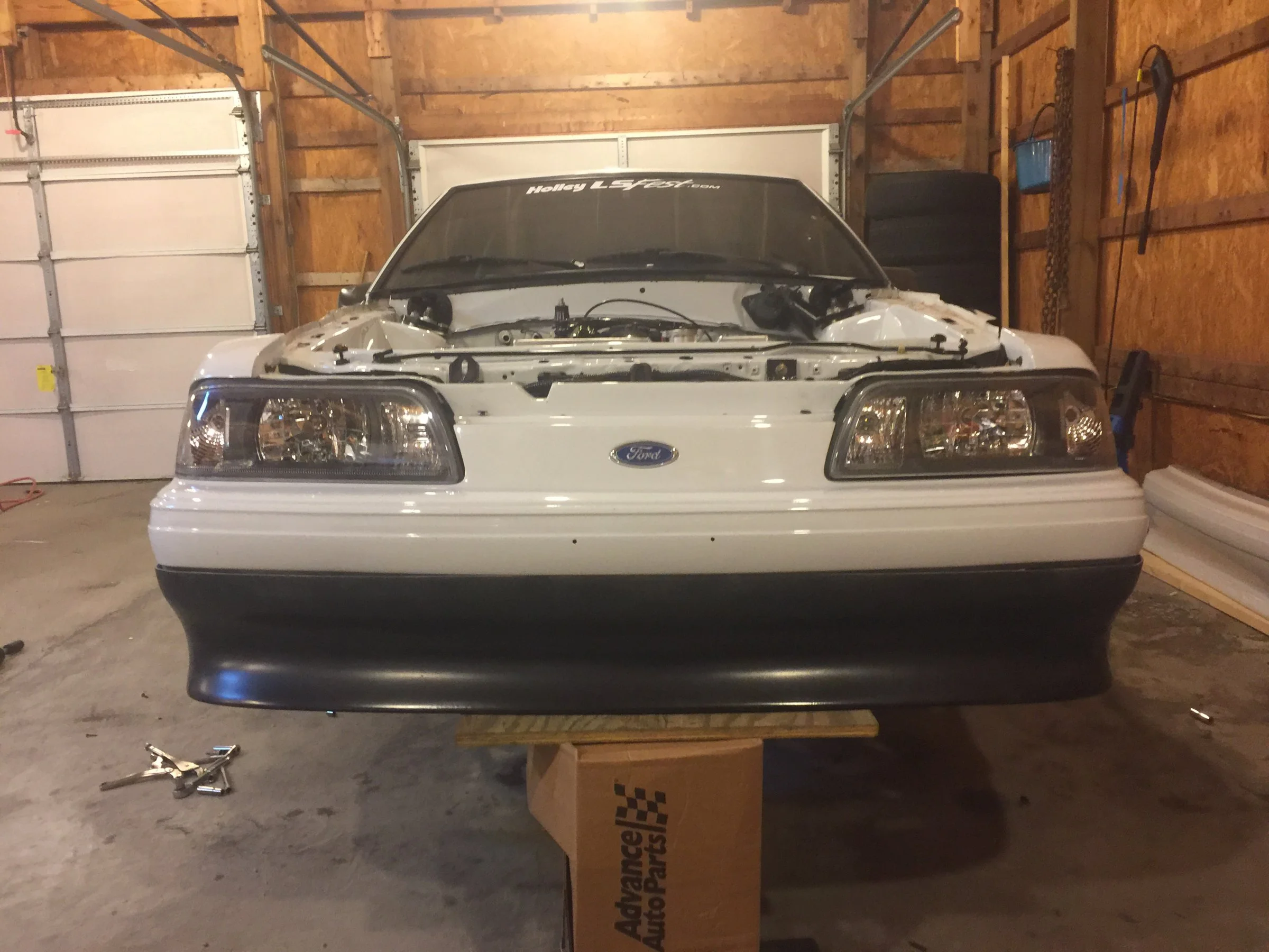

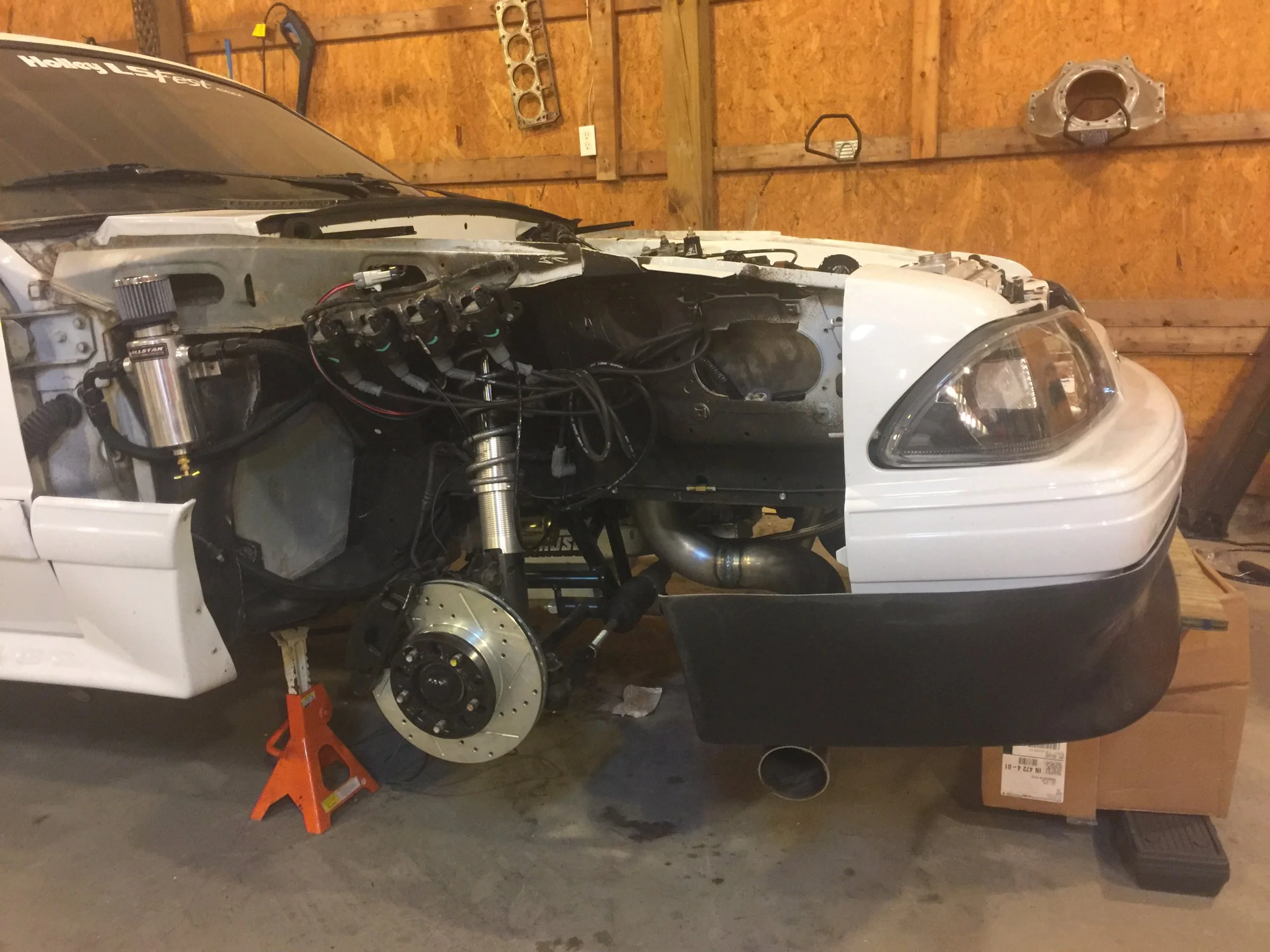

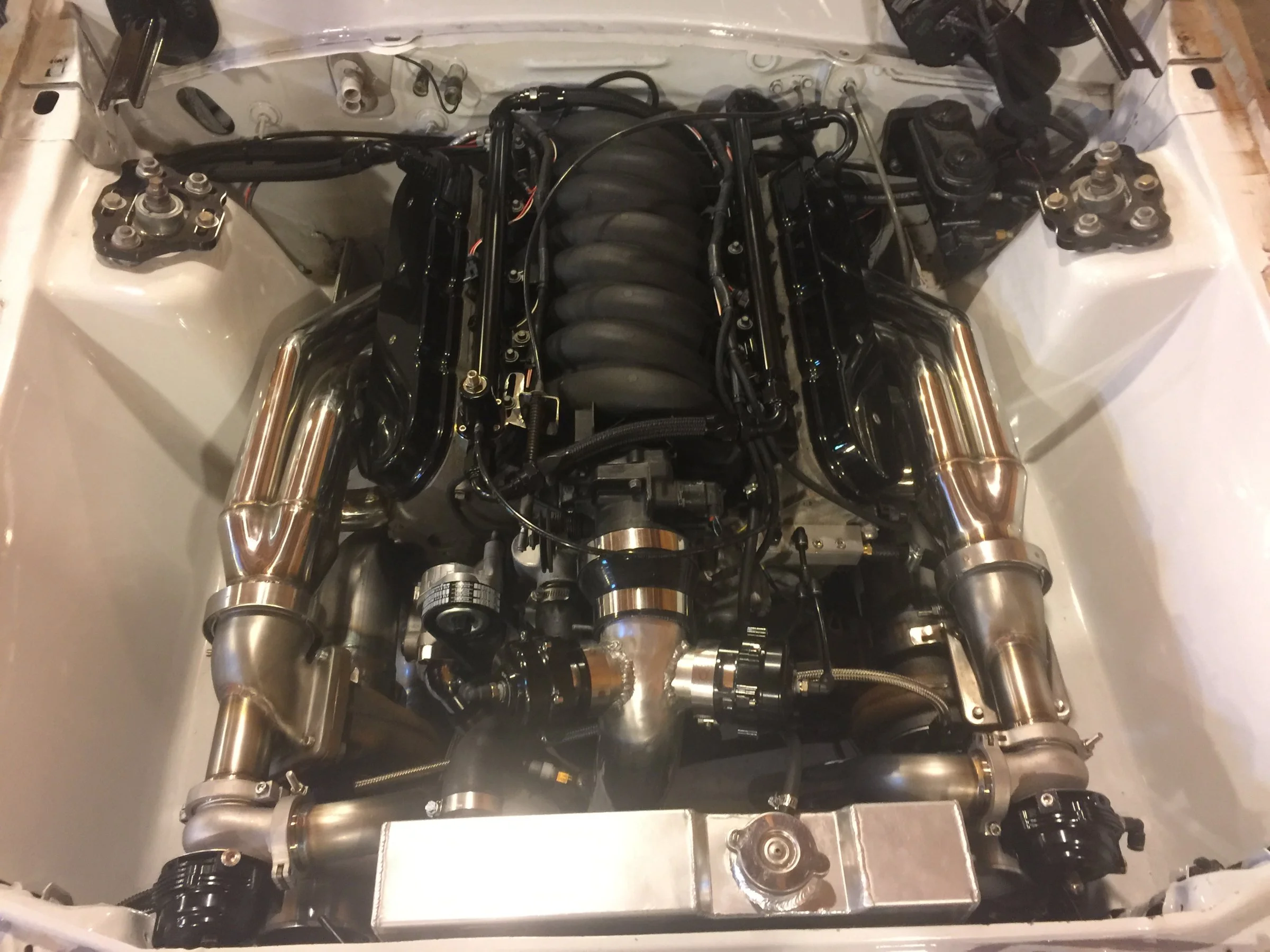

Tonight I got the turbo oiling knocked out. Got the oil pan torqued down and I know a few more things I can't remember now. Oh and a belt, I found the right belt.
Then I had to test fit the new bumper piece. Can already tell I'll have to tweak one of the downpipes but in general I'm very happy with how it's coming out.
Felt wrong but it died an honorable death.
Also decided to forego using someone else's tune and build my own start-up so this will be the post to reference when we're trying to figure out why it let go at an idle.
Reactions: A5literMan, Davedacarpainter, Noobz347 and 3 others
Man it looks great with that bumper, but where is the air going to come from that has to flow through the radiator and intercooler during street driving?

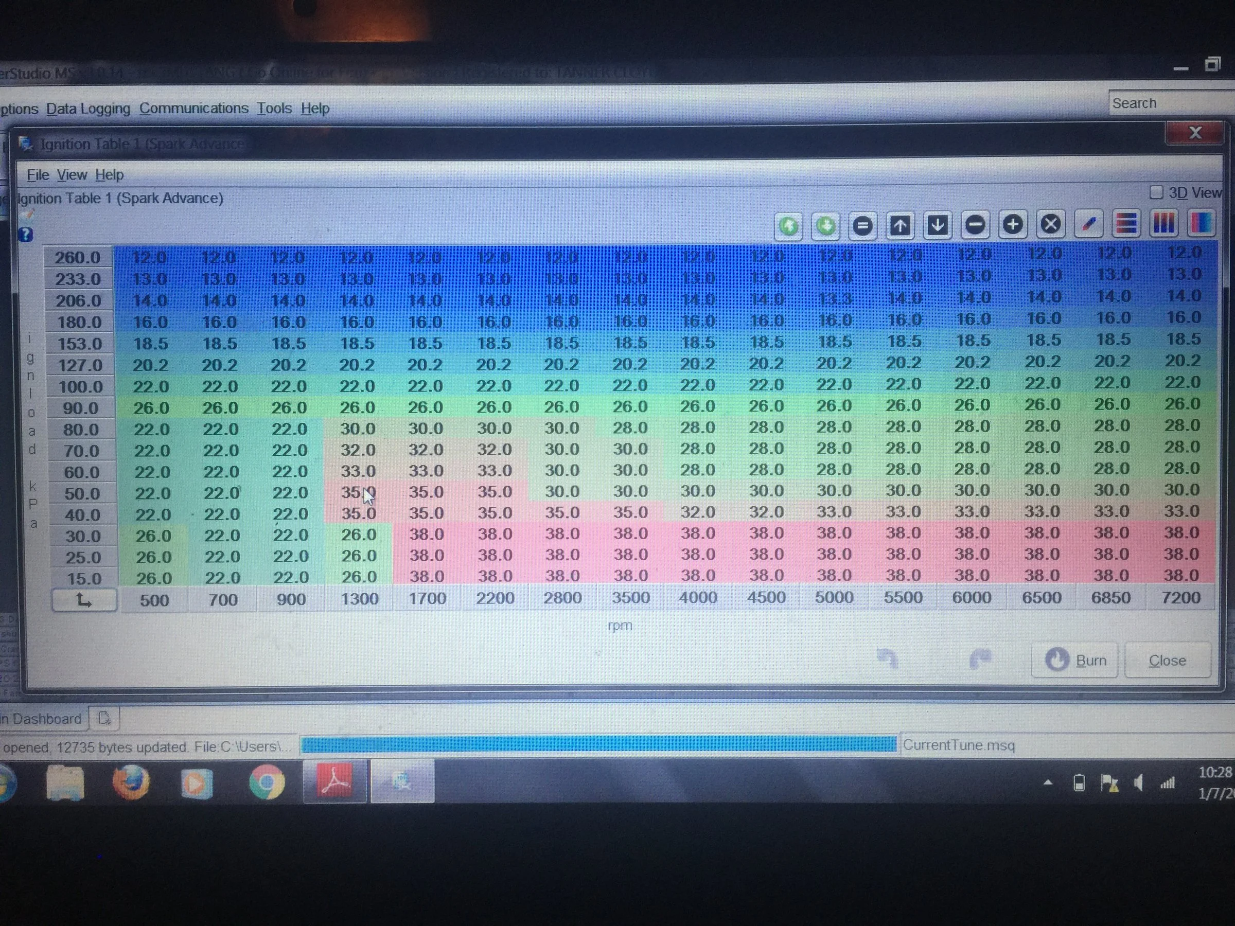

tannerc91gt said:
I appreciate it and will probably be PM'ing you some questions once I get it going.
I built a super conservative timing map and a pretty rich AFR table so unless I've messed up some ignition configurations it should run alright (knock on wood).
My MS3 came with the full version of tuner studio, VE Analyzer and the logger access so I've got access to everything I'll want I think.
The boost controller/2-step/transbrake/etc stuff is a little complex for a beginner but I'm months away from even trying to screw around with that.
It's easier than you think, I like the 3.4.2 firmware and you should upgrade to tuner studio ultra if you haven't already.
Getting the car to run and tune WOT is easy..... idle quality and drivability are what take the longest to get right.
May be a little elementary (I know you have used other software) but this is a good read.
http://www.megamanual.com/begintuning.htm
Good observation. Concerned about it myself.
Trans cooler has a fan and will be mounted out back. Radiator will get a really good fan. Intercooler I think will end up being fine but we'll see.
If I have any cooling trouble at all (more than likely will) I'll do the cobra grille to open up the nose a bit and if it proves to be starving the intercooler I'll either cut an opening in the lower portion or go a2w. I've always liked this style bumper but it was mostly done because I hated how the exhaust was going to look coming out through the GT extensions.
Michael Bunton's car for reference. He used the same valance.
I'm not too good for beginner stuff lol. I appreciate the link.
I registered my ECU tonight to get full Tuner studio/ MegaLog access but what am I missing with Ultra?
I'm not sure what firmware my ECU has as I've not powered it up and connected to it yet.

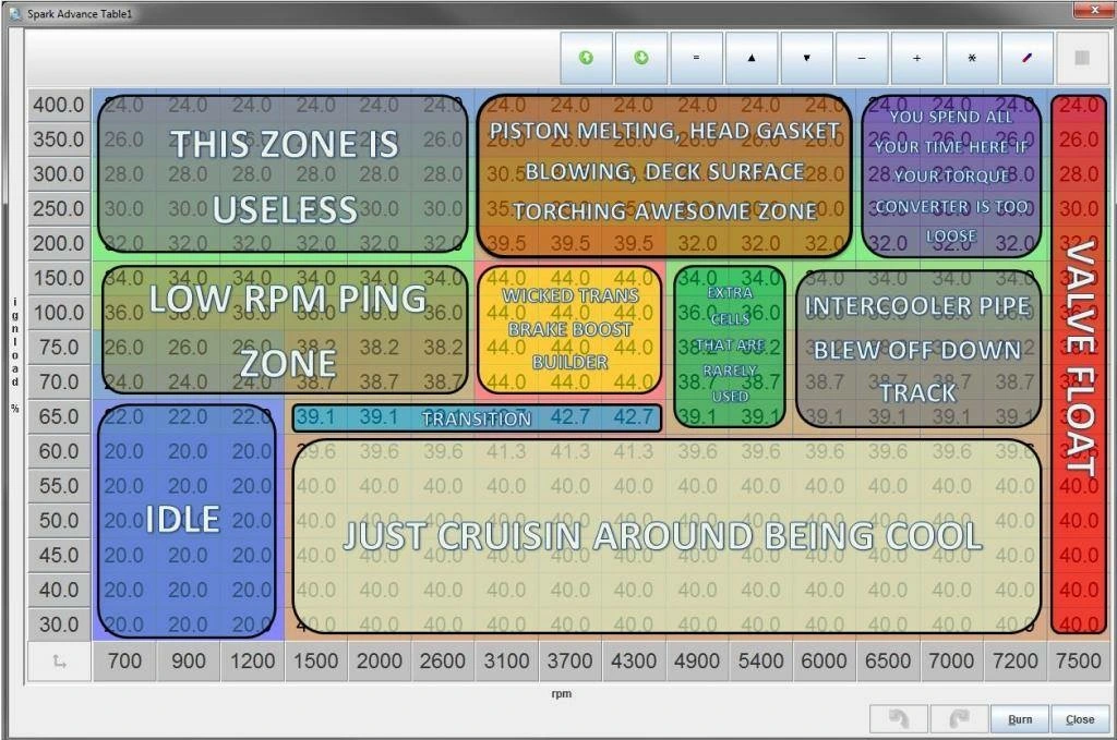

This is my timing table reference cheat card
But this is the table I put together. It goes to 23psi-ish though I don't plan to wander into that territory intentionally for a while.
Looks pretty safe to me?

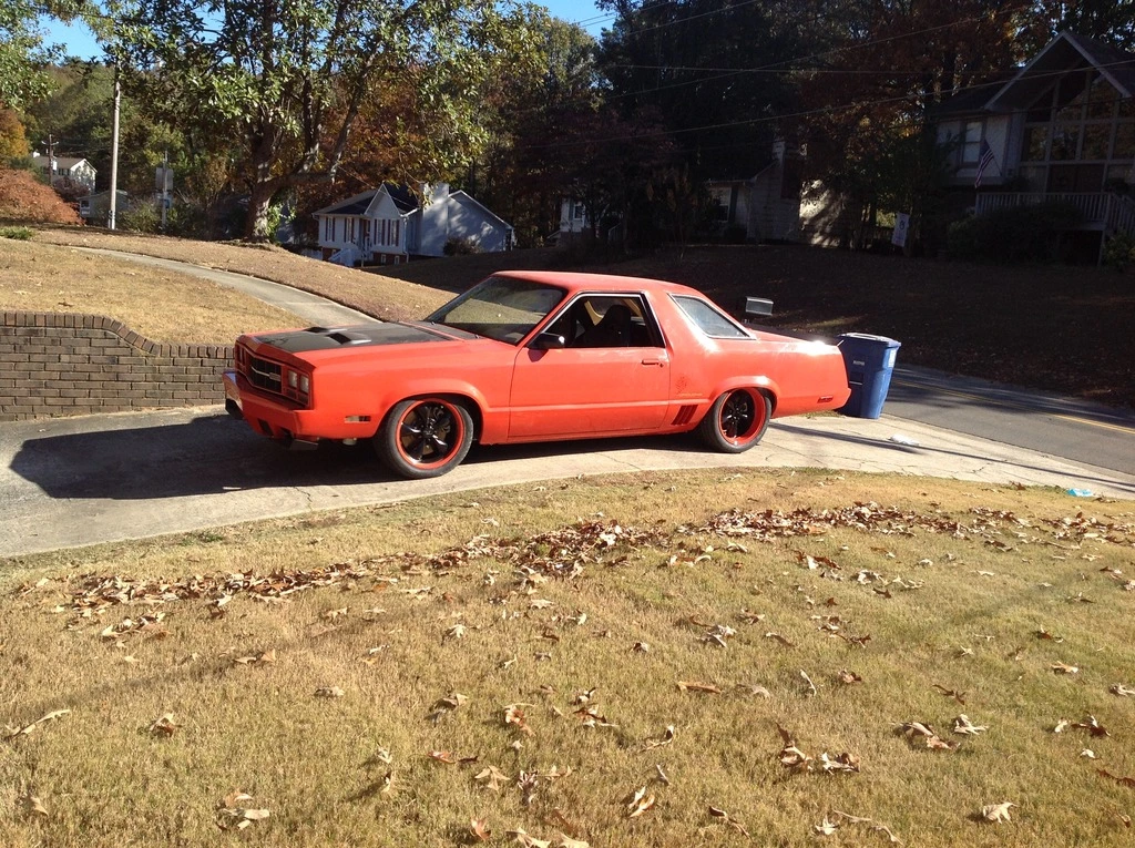

Drove 12 miles like this once
CarMichael Angelo
10,641
8,909
Birmingham, al
Jan 7, 2017
#556
  • Jan 7, 2017
  • #556
Sideways?

madmike1157 said:
Sideways?
It didn't show sideways once I submitted the post.
Not even going to fix it
CarMichael Angelo
10,641
8,909
Birmingham, al
Jan 7, 2017
#558
  • Jan 7, 2017
  • #558
I'll tilt my head then.
