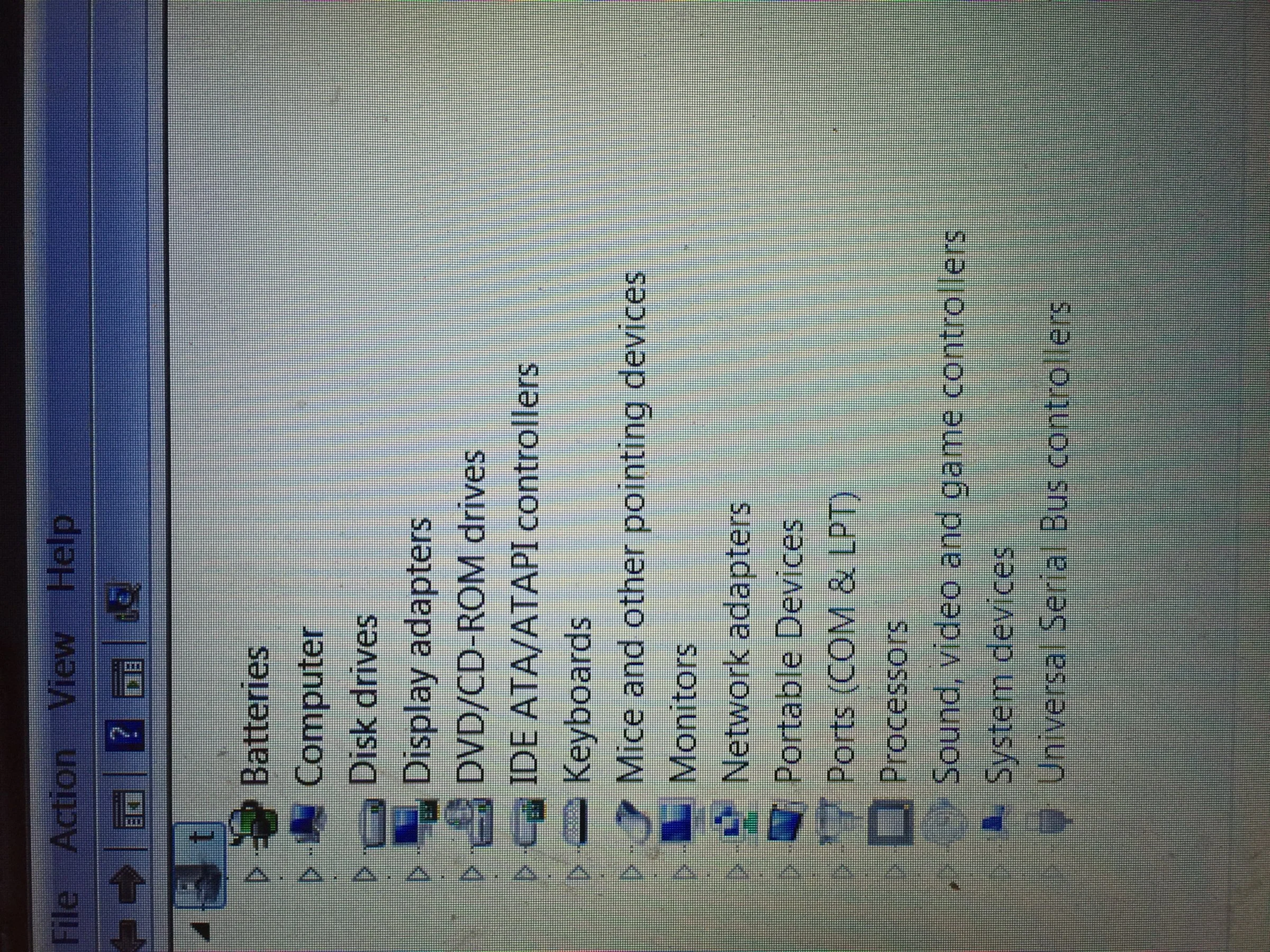

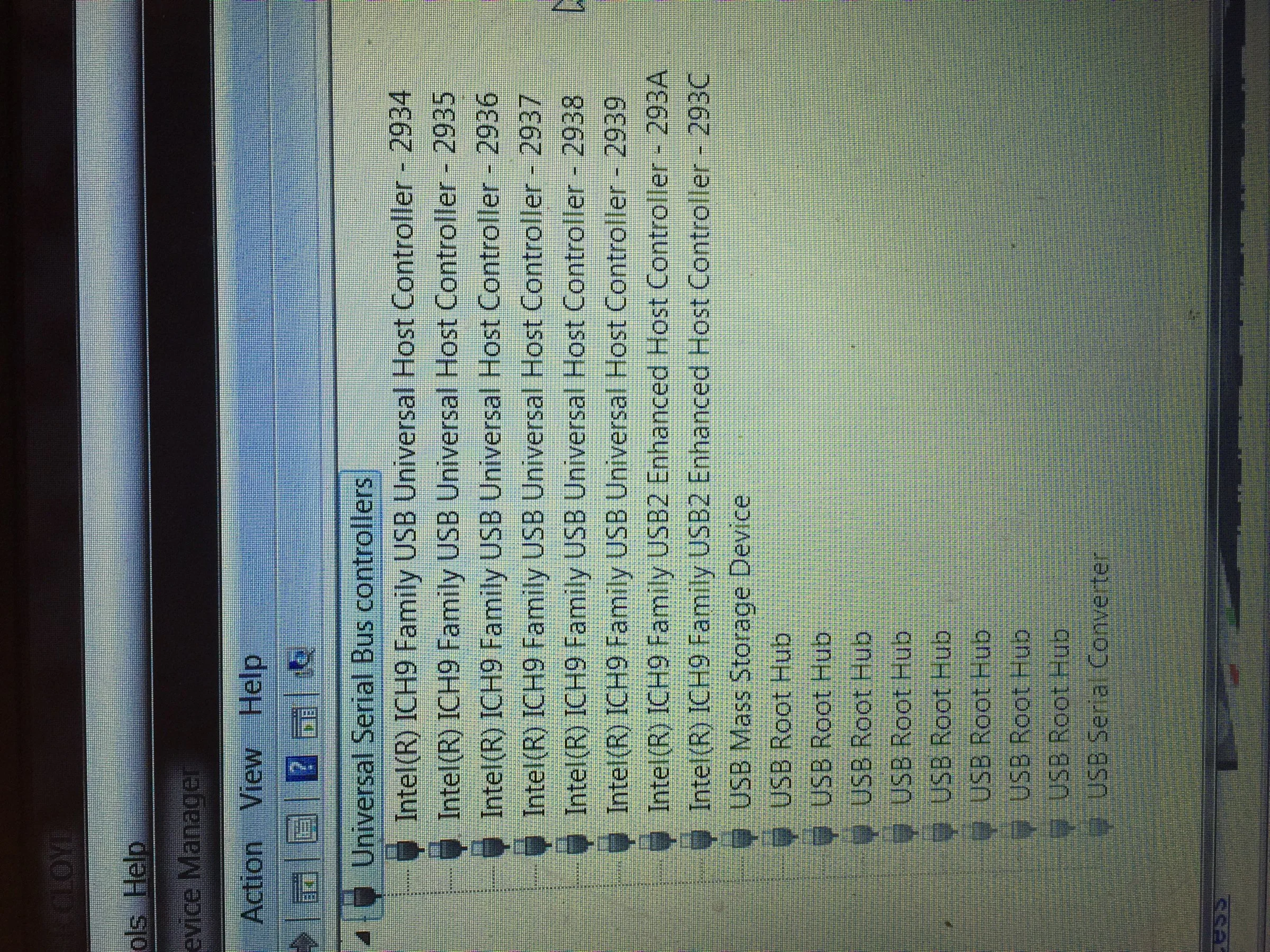

I've done the port configurations, checked the Baud Rate etc etc. I updated the drivers per their instructions as well.What they are referring to are the serial port connections. Typically it's a db9 connection, you then use an rs232 converter to usb...

You will need to access the port options in the control panel.
the port you have the ECU connected to needs to have (all setable)
-Baud rate 11500 minimum.
-set the port to port1 (not necessary but helps)....
Try the serial port connection.
No change.
