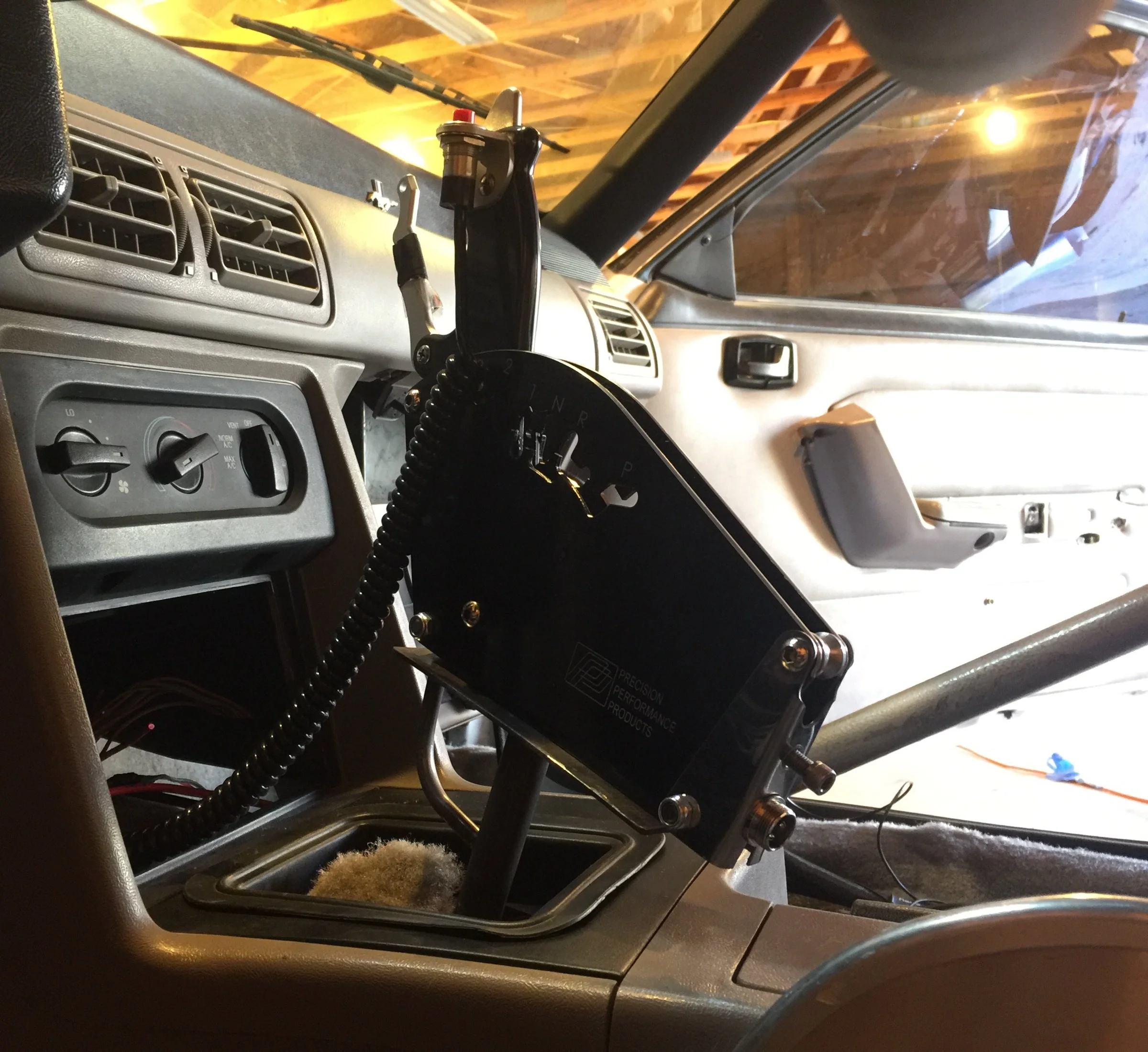

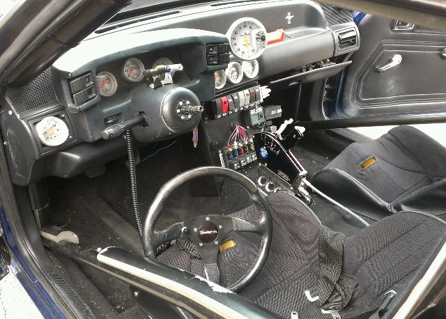

Shifter mount is all done. Ended up moving the pin and raising the shifter a bit and angling it back towards the drivers seat.
Will weld it in and make a nice plate for the shifter hole once I get my seat where I want it. Little too much gangster lean going on still.
Most on this board won't like it, and that's ok.
It looks far from factory but damn if it's not the most comfortable shifter and position I've ever had.
Itll have a plate covering the hole. Mount will be exposed. You guys are getting too hung up on aesthetics lol. I'd have put a quarter stick with a boot in it if that's what I was after.
Won't be touching the console
Reactions: A5literMan
What are you after then?
That just makes zero sense to me. I have a manually shifted Auto trans. It sits slightly behind the factory mount position and I cut 2" out of the shifter arm.
I do not have to reach to shift this car from a strapped in position either.

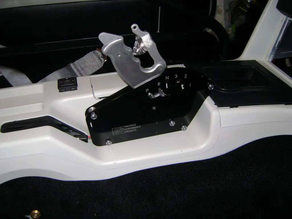

That thing looks like it's just going to moved around a lot. It's only the handle portion that's supposed to move, right?
I don't think I've ever seen any shifter ( auto-correct wants this word to be "shiftier" and I'm the noob :rolleyes: ) mounted like that one.
Do you have example images of others that are mounted like this? I may not have been in the right circles.
What makes you think it will move around exactly?
Man, you only thought you were going to get away with an LS swap. You will be hung over the shifter before you get it done. ;)
Seriously, maybe get a spare console and hack it up.
