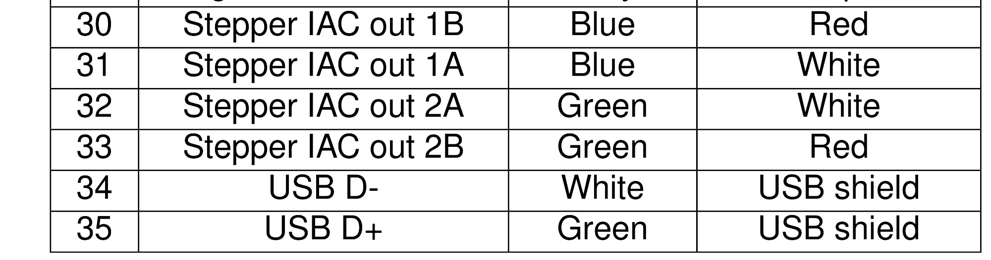

Open loop control.....that makes more sense now, with open loop control the ECU simply adjusts the valve to the settings that you have predetermined. Simply put the value you have set as the lowest "step" is too high. The valve may not even be moving at all depending on the settings you have in place.
I'm pretty sure the tune I sent you was setup for closed loop idle. sometimes the settings change when loaded if there is a firmware code mismatch.
Can you screen shot the settings? I will review them and send you a picture of what to change them to.
Sure I'll do that. Probably be more accurate than what I did
The afr safety settings were off and it was set to open loop.
I changed it to closed loop.
Leaving the warmup enrichment alone, just changed the stepper values a bit and dropped the target RPM down as well.
