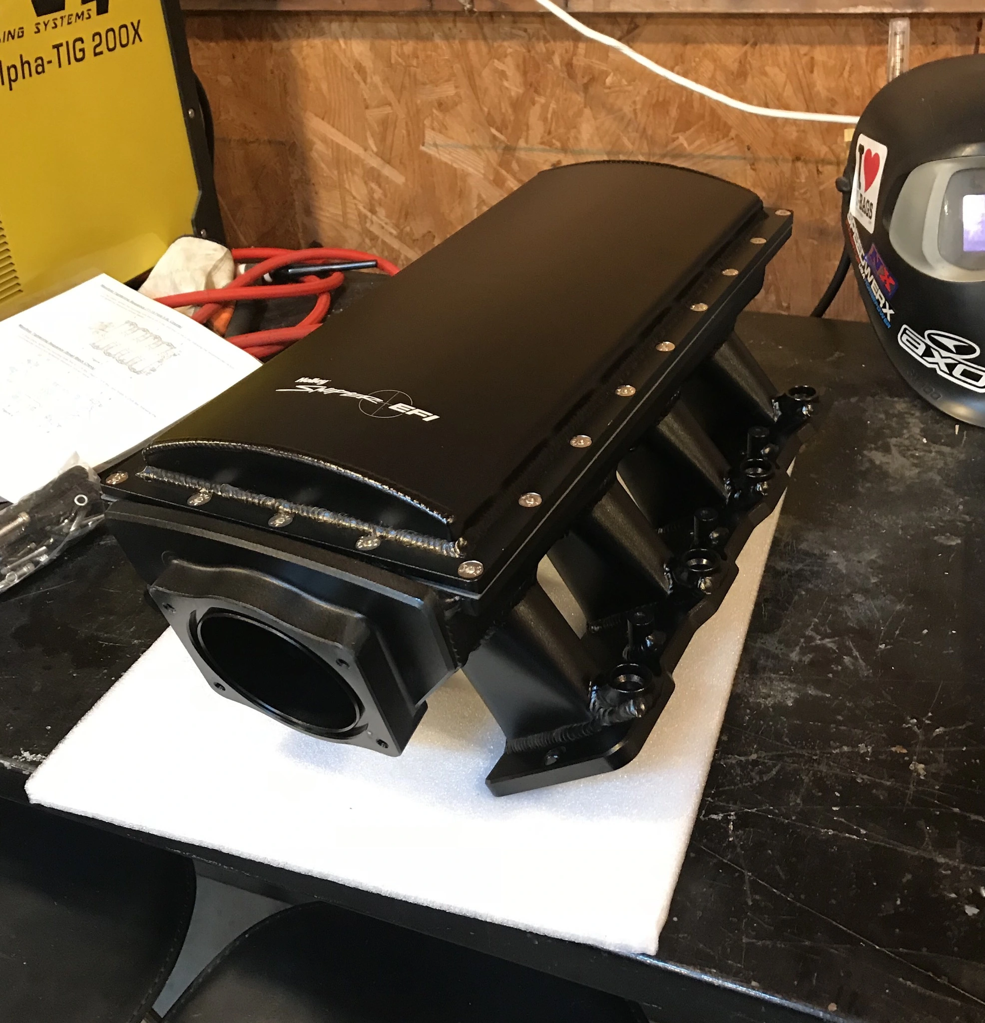

Picked up one of these. While the originals are admittedly garbage, these have been on some of the fastest coyote cars you’ll find and the LS world seems to be afraid of them.
I think the added plenum volume and the far better fit and finish will be a huge difference.
Think it’s going to work great with the cobra hood and not compromise looks like the plastic LS1 does or performance like a single plane/elbow would.

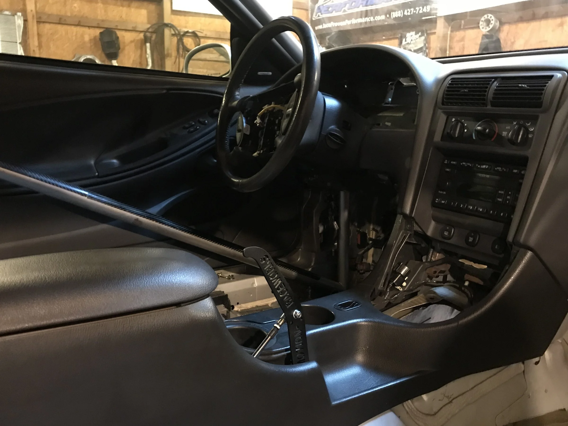

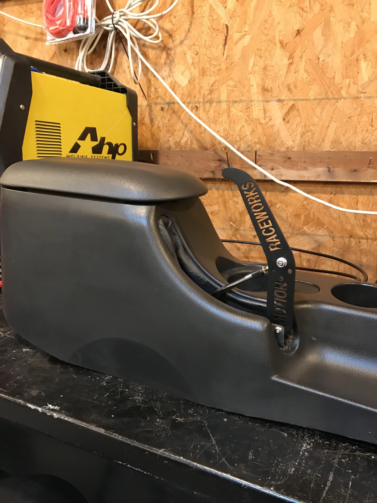

Started working on the chute mount also.
Don’t really want it over my head and I think it looks nice here. We will see if it’s comfortable to reach.

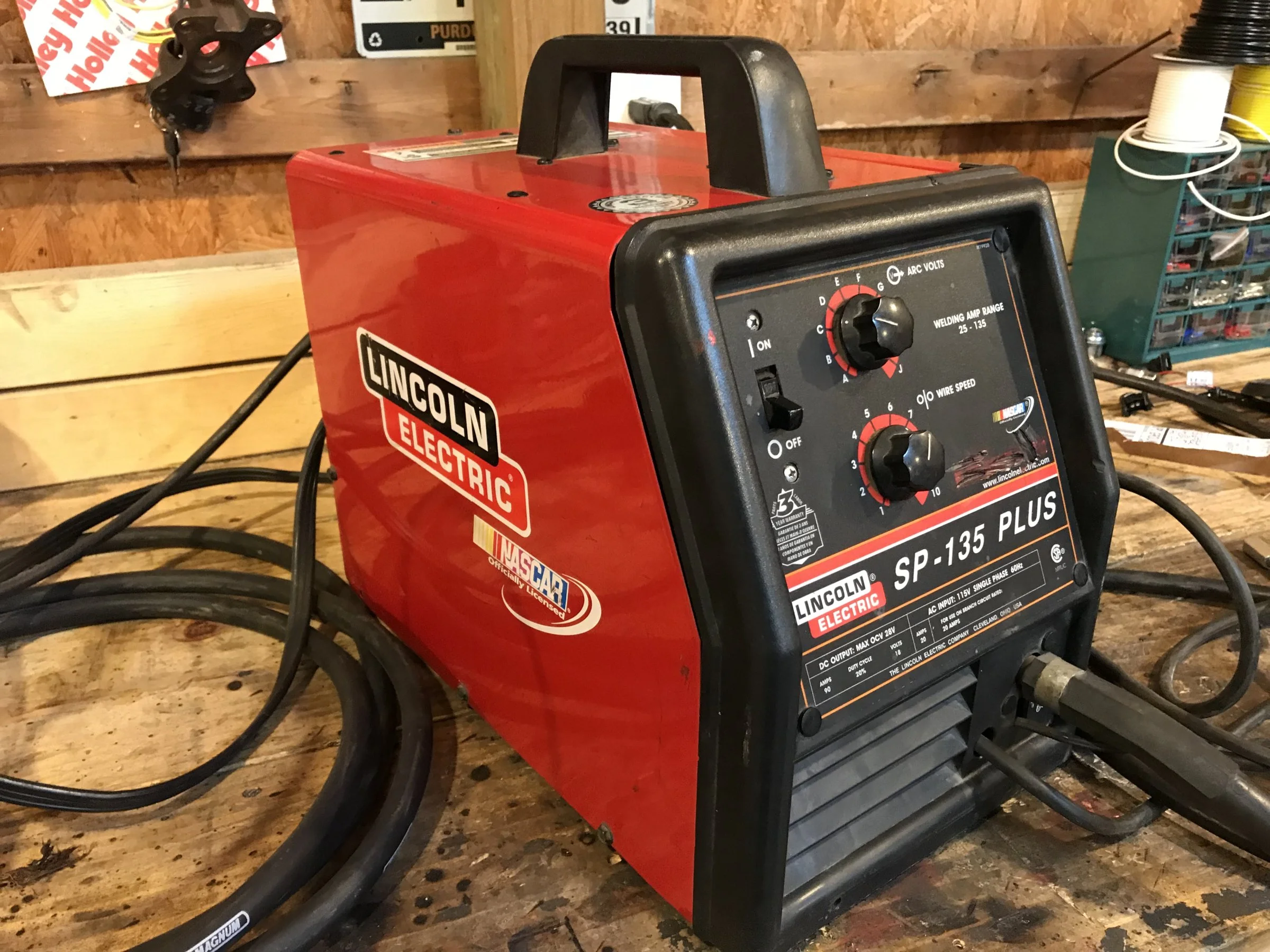

Oh, and I think I got a pretty good deal on a new MIG to replace my harbor freight flux machine. I need to weld in a lot of stuff out back and have never been happy with the beads (or lack of beads) the flux core gave me. Seemed you had to bury the end of the gun to get any kind of coverage from the flux.
Friend sold me this older Lincoln for $100 with a new gun, regulator and all that jazz.
lot of Win in that post. Thats awesome buddy. does the cobra already have a fuel system in it? Was it already set up for a Ls? Good score on the Lincoln,does it have the gas hookup?
This one uses gas. I’m pretty decent with a MIG, but never was with the fluxcore one I’ve got.

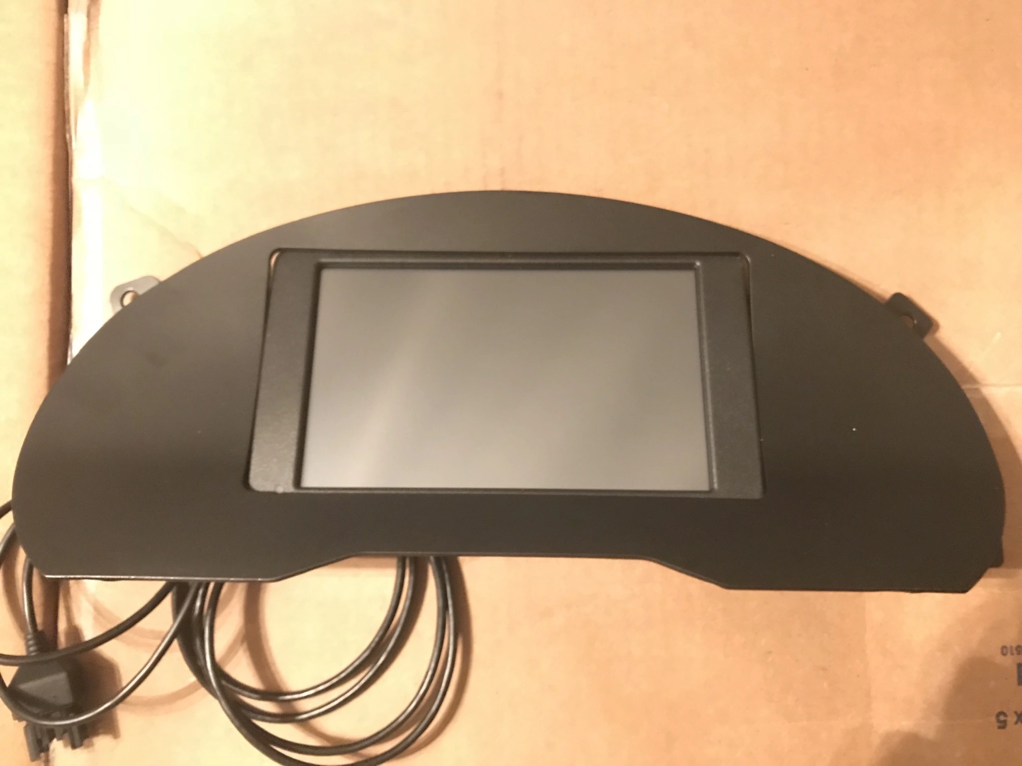

Also picked up a Holley dash and a sweet cluster built to hold it. No need to mess with finding a 94-98 cluster and all that fun stuff.
I’ll have the ability to monitor and control a ton of stuff now, where I had become I/O limited quicker than expected with the HP.

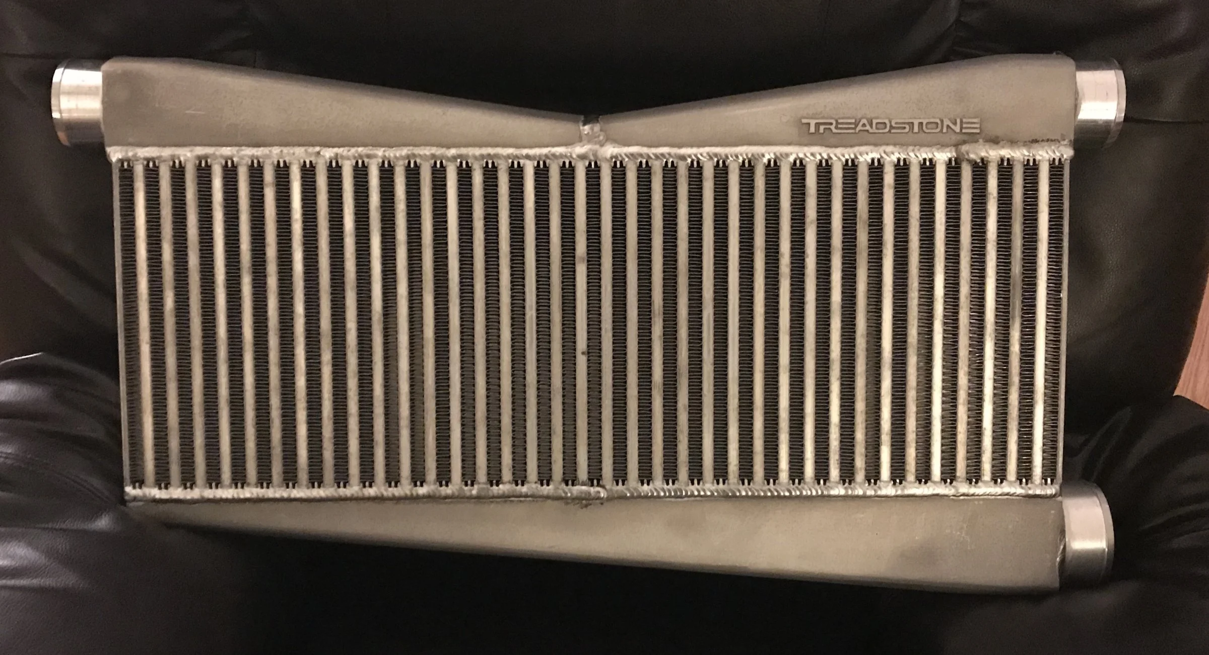

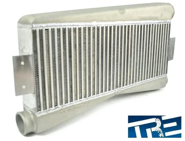

I snagged a 1300hp rated treadstone cooler yesterday. This helps me along with my goal of putting a “normal” radiator back on the car as well.

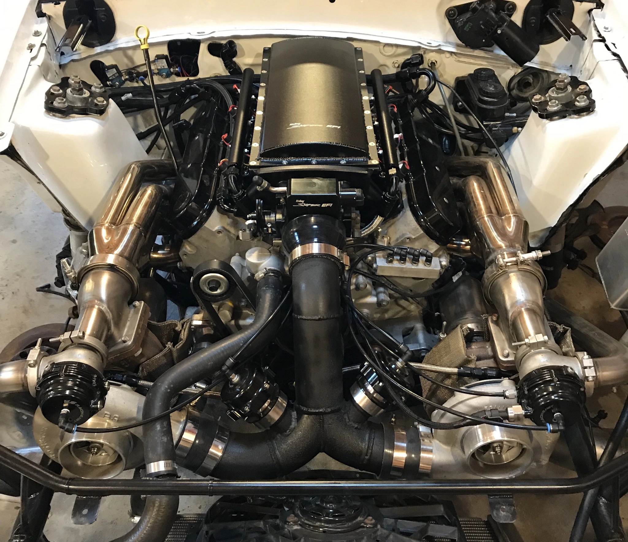

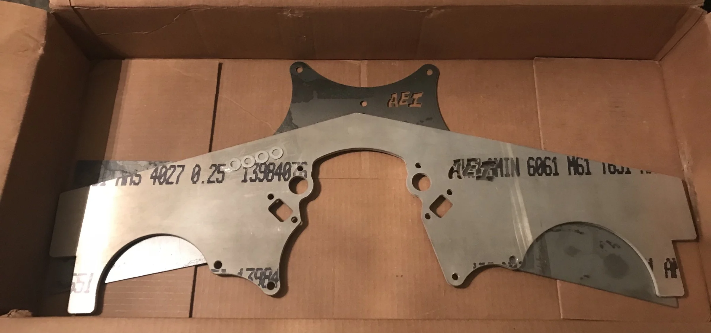

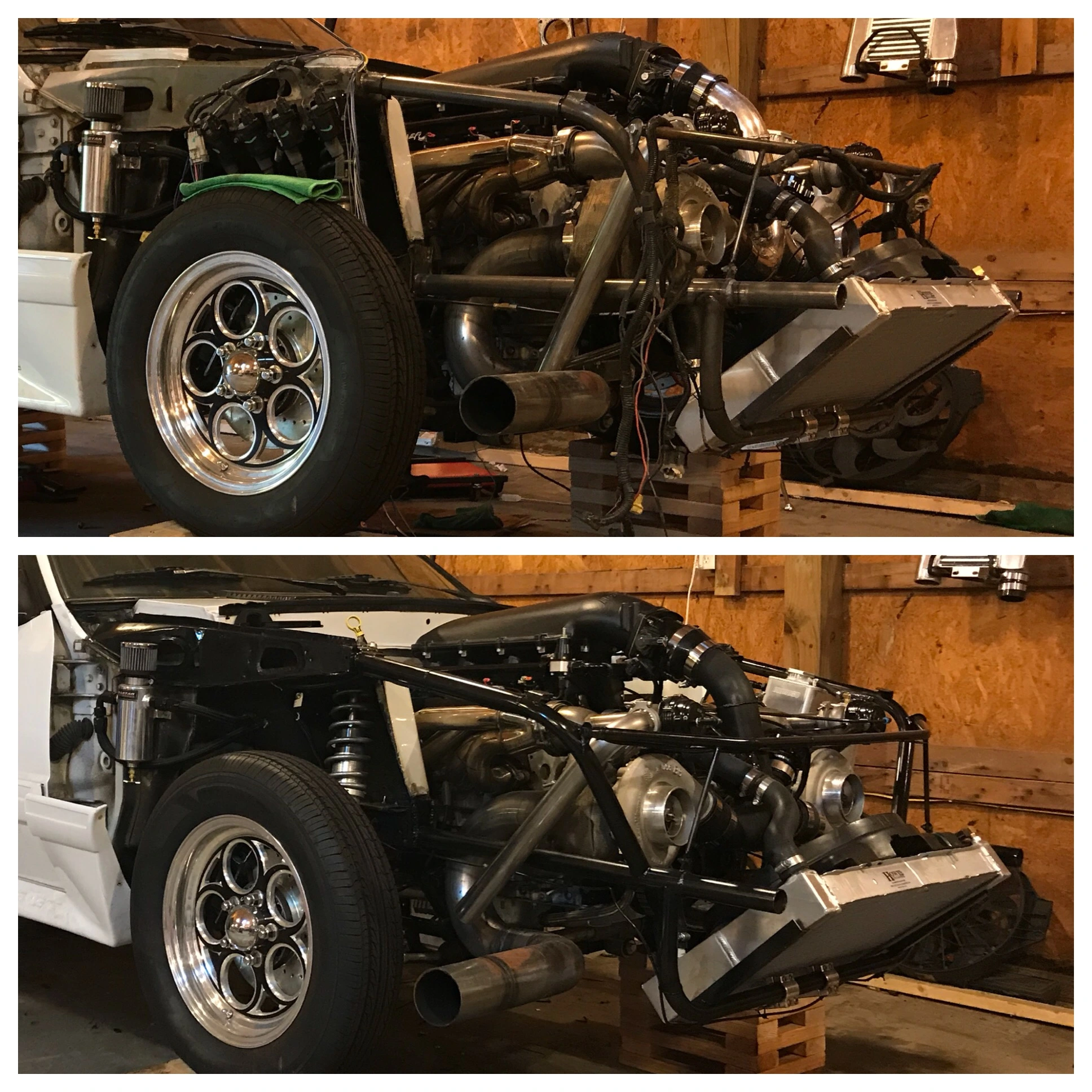

Motor plates also got dropped off this afternoon so hopefully Friday I’ll have a mock-up drivetrain in and can start getting ready to build the turbo kit.

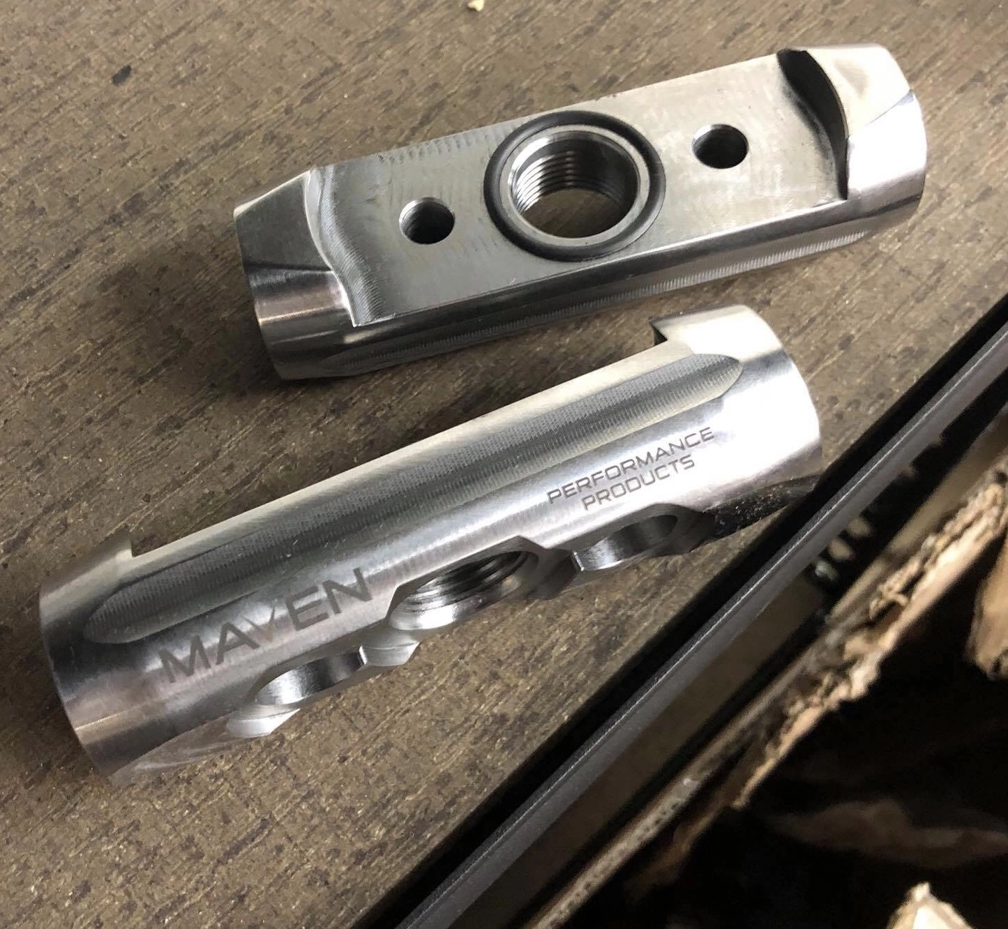

Got a good deal on a pair of these Maven s300 mounts to mount the turbos out of the way. Narrowed it down to 2 locations, just a matter of practicality once I can see it in person.

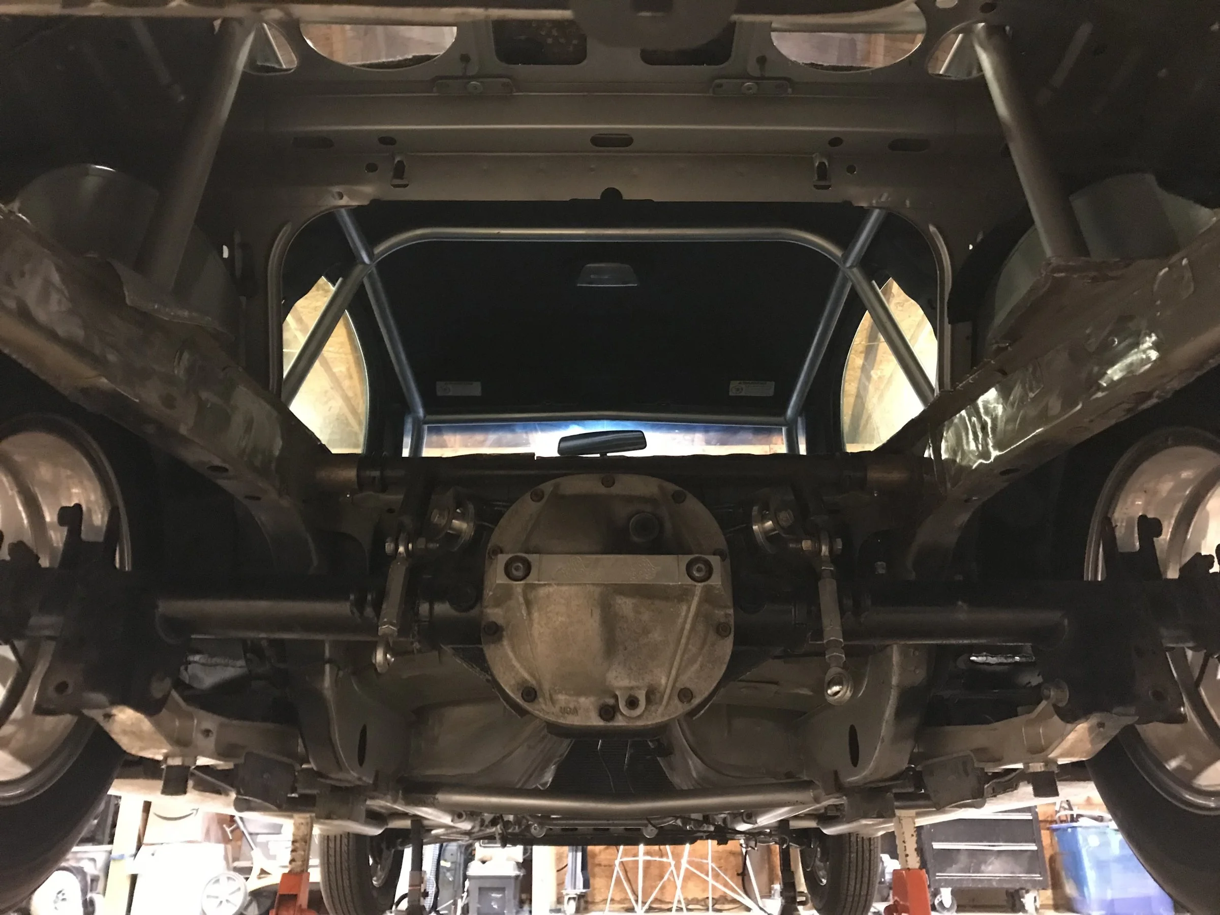

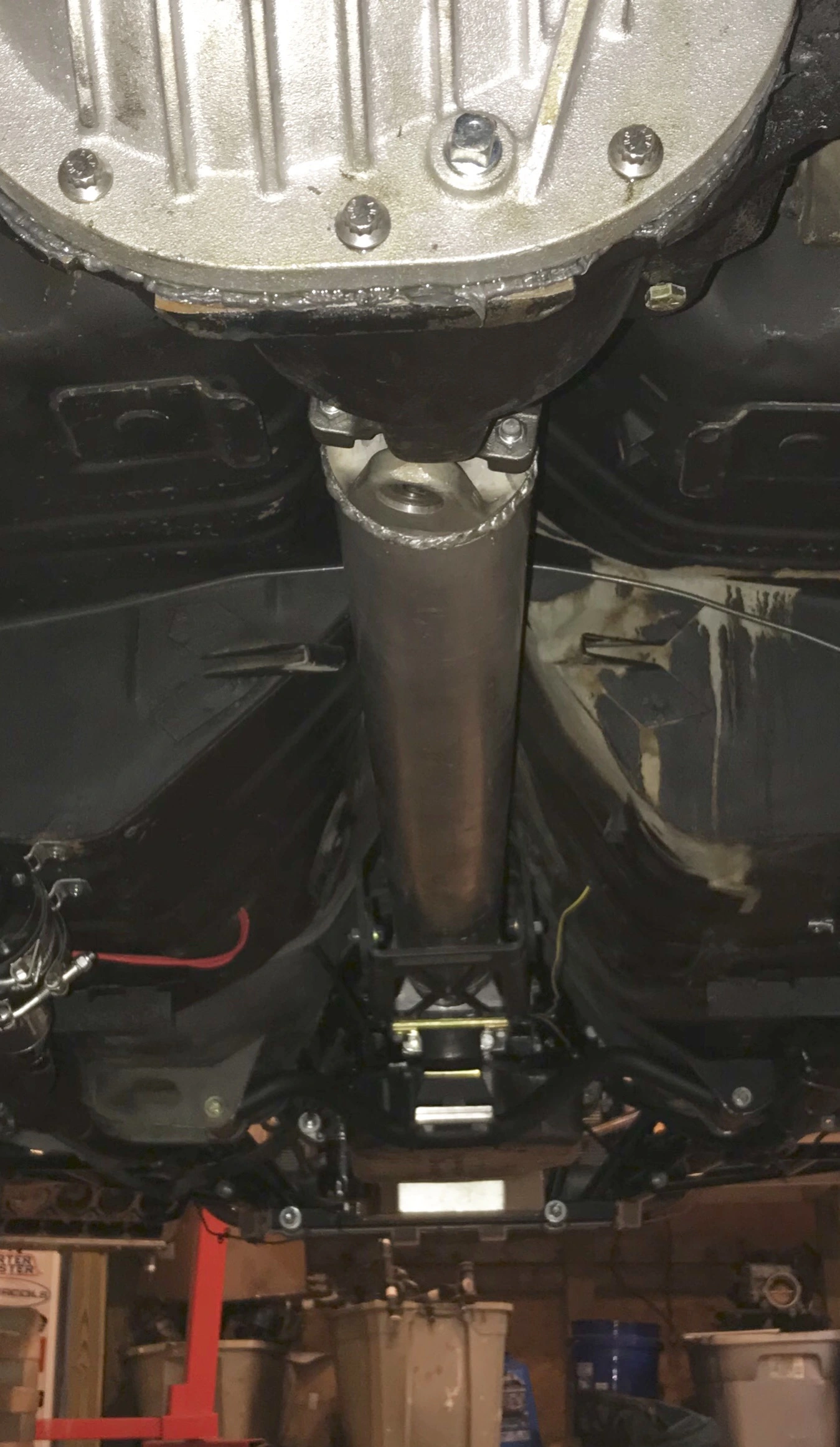

Pinion flange swapped, driveshaft installed.
We have a complete driveline on our hands. Complete with oozing RTV!:confused:
Supplied converter bolts aren’t long enough, which is odd. So i’ll go after those next weekend.

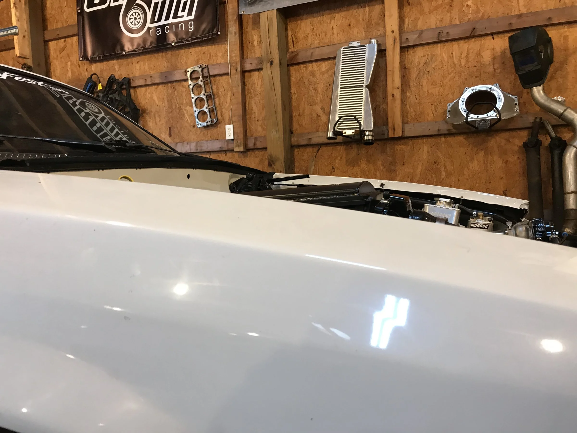

Intercooler showed up today. I was concerned I might be getting ripped off considering the deal I got on it, but luckily it was exactly as described.
Also got a sneak peak of the rear end, which I’m told will be done tomorrow afternoon. Probably can’t get it til Monday, I’ve got kid duty tomorrow :nice:

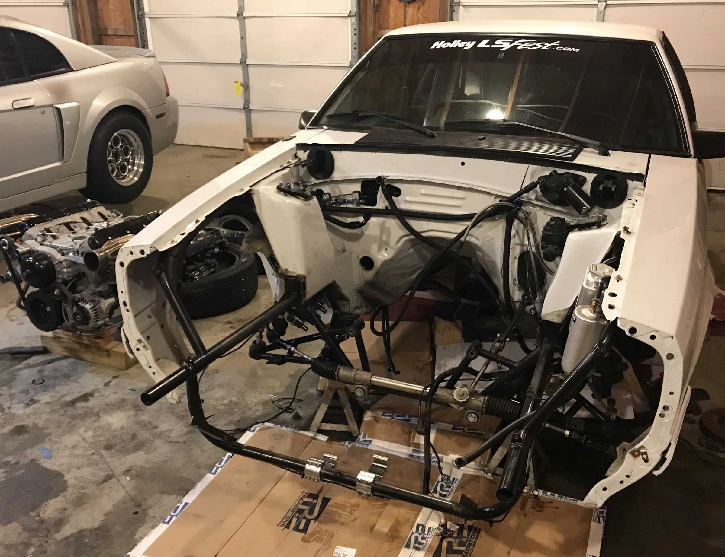

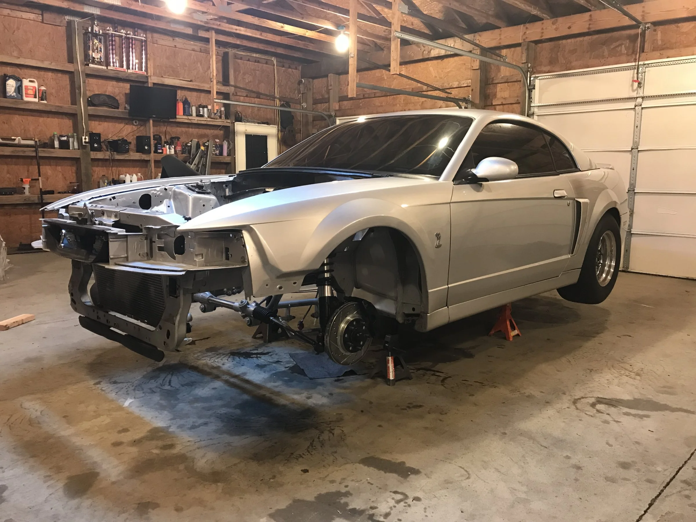

Removable core support made this removal a relative breeze.
Now I can fix the strut towers, repaint the front end and tidy up the engine bay.
