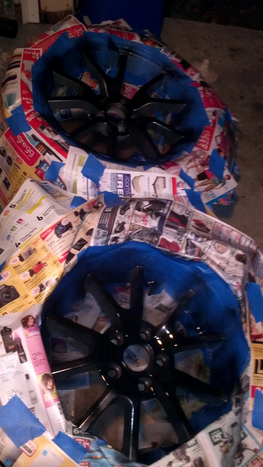

Well since i was scared i would hate it and didnt want to ruin my rims i played it safe and grabbed a few cans of plasti dip, taped off my rims and sprayed the plastidip as a primer...i dis it this way so that if it looked horrible i could peel it off without any damage to the wheel.
Once i put about 5 or 6 coats i let the rims sit overnight for the platidip to cure...i did a ton of coats because i was paronoid of any paint seeping through..

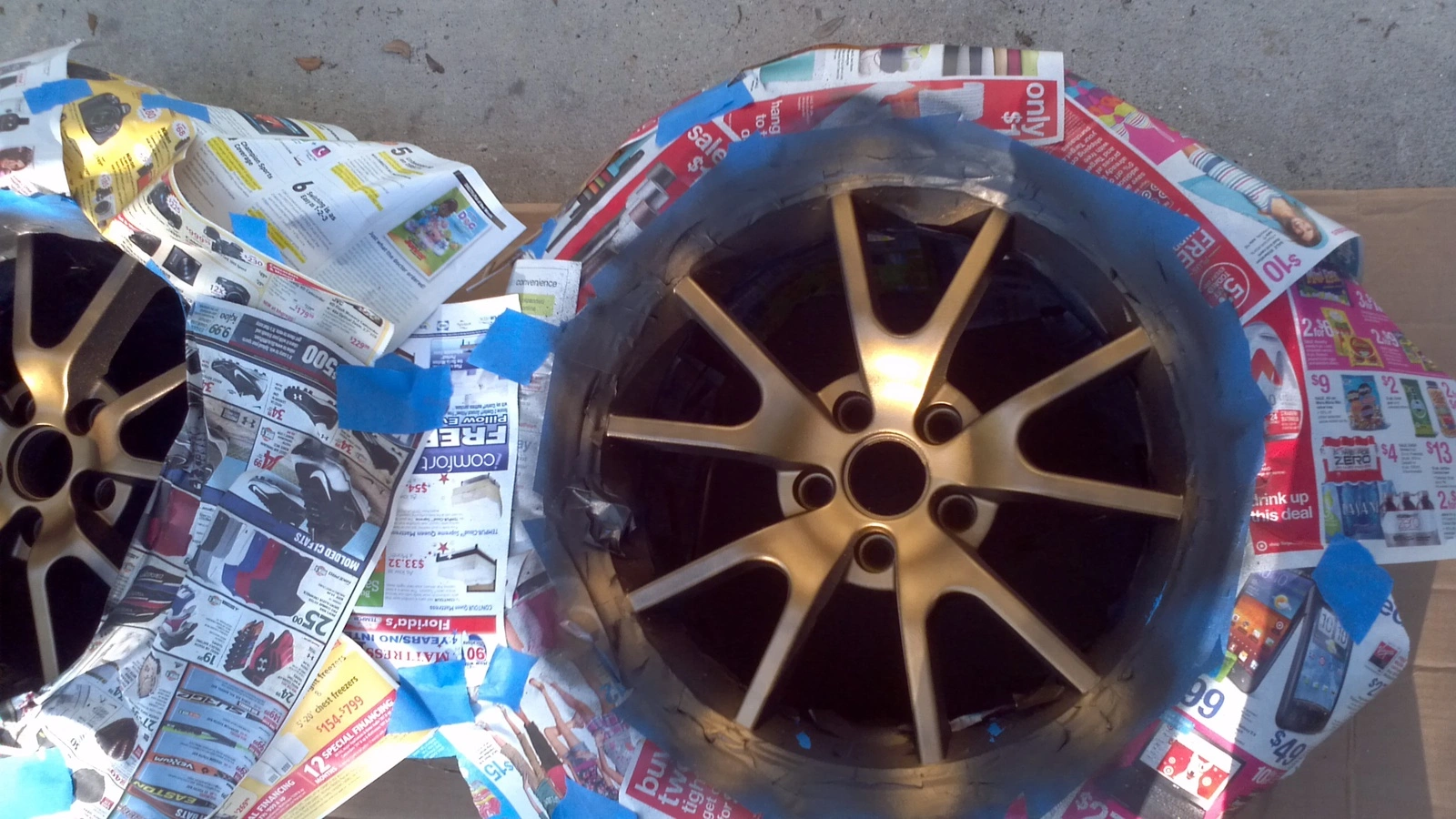

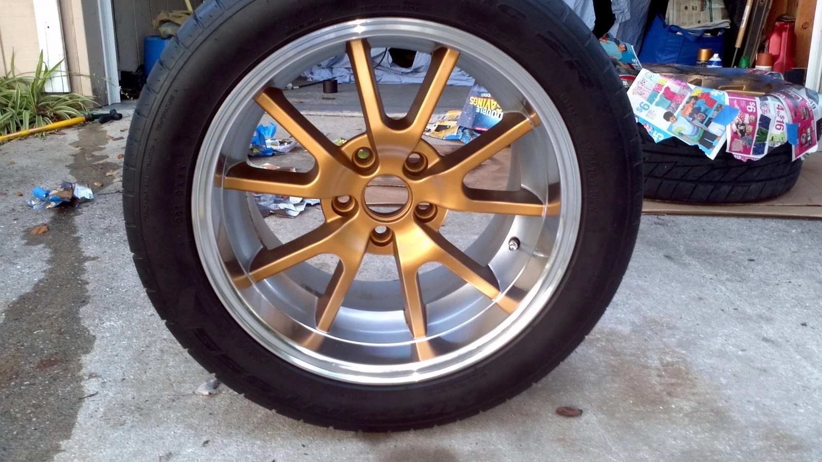

After i let the rims sit, i sprayed the paint and once i laid the first coat i knew i was going to like it..
Then end result came out like this
I will say this, if you are doing to do a project like this with plasti dip START SMALL..since the plastidip is a rubber coating it does not act the same way with tape like paint does...what that means is you cant tape an area off, let it dry, then peel the tape away like if you were painting a car or a design on a car...the plastidip coats over the tape so if you peel the tape, rhe plastidip comes with it...i had to ouline the tape with a razor blade before i peeled it off...once i did that, i was good to go..
Another thing...paints with primer built in will eat the plastidip away and you will be screwed so keep that in mind..
Since this came out the way i wanted i may, at some point, pull this off and actually paint them cause i love it..
