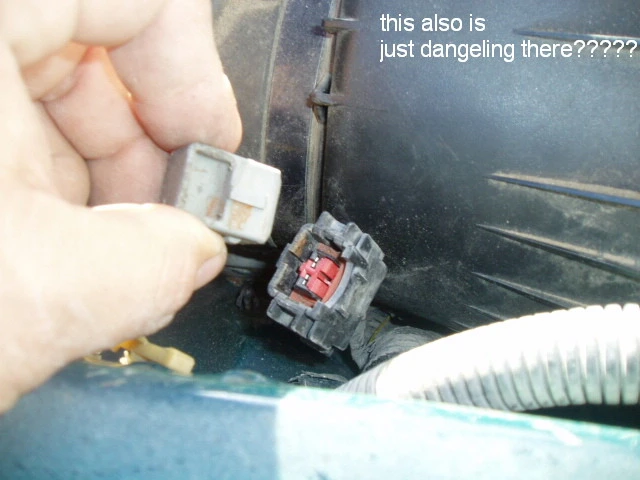

find this thing (the SPOUT connector) and you'll be close ... it's on the same harness as the SPOUT:
it looks pretty much like this ... this one is not from a 1995 stang, but it looks similar (not exactly like it tho)
