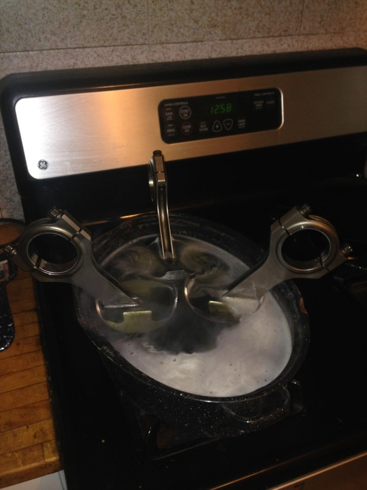

This coming from a guy that clearly does NOT have a wife to come in watching you boiling pistons in one of her pots on her stove, in her kitchen,........yeah, this is a single man talking.I've soaked them and then boiled Pistons in a pot on the stove to get the carbon and stuff off
mmmm, smells good, what's cookin? Piston stew!we used my buddies Stove. Good times ! Lmao
Beat me to it!!mmmm, smells good, what's cookin? Piston stew!

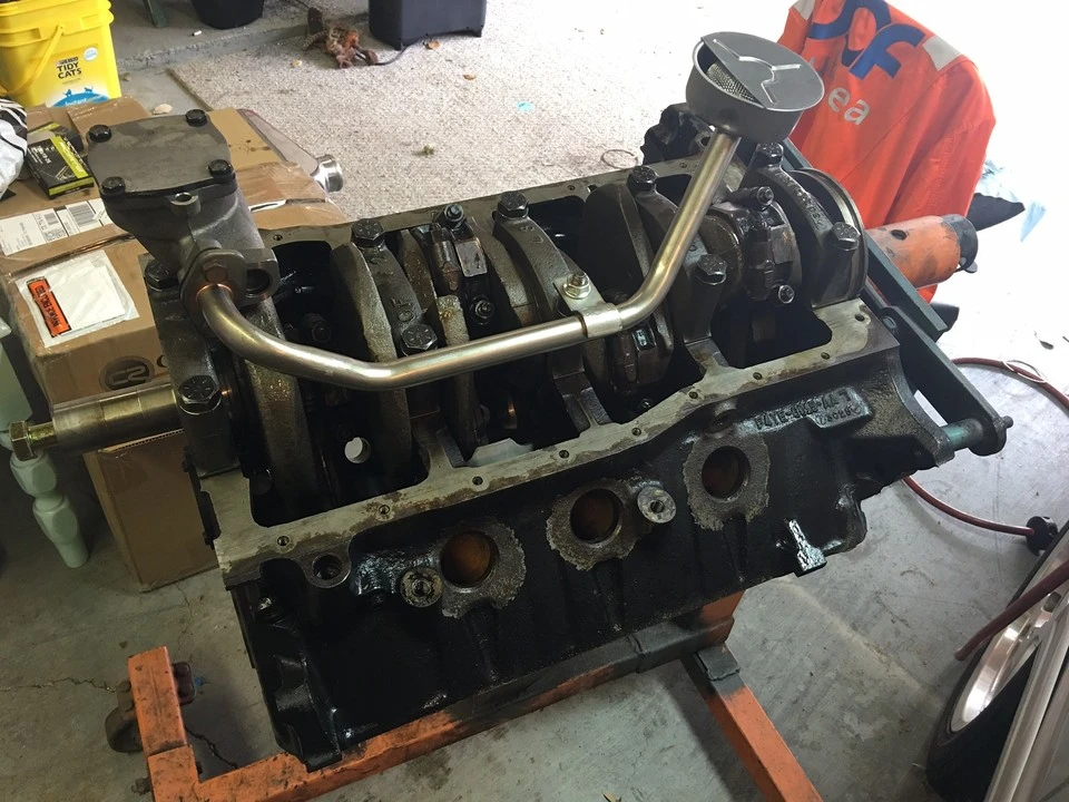

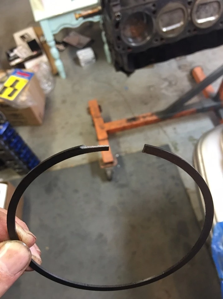

This is what happens when you're trying to do something that requires a fair amount of concentration, but your wife come into the garage to nag about something... It was a mad scramble to dig through the trash and fish out all the old upper rings. The best one I could find had an .030" gap, so I went with it. The rest of the short block went together without issue. All the clearances were good.
Next up is sticking the heads on, measuring pushrod length, then PTV and piston notching.
I hope that you plan to have the engine balanced AFTER you flycut the pistons...
I understand the logic and need to do so if this were a high $$$ race engine, but this is a junk-yard slug with a blue plate special overhaul. If it lives more than 6 months before I kill it, then it will be a wild success. There are far too many variables to spend much money on it now. I have a good crank and forged pistons on the shelf once it gives up the ghost. Those will get a full service at the machine shop.I hope that you plan to have the engine balanced AFTER you flycut the pistons...
For a few reasons, but most notably money right now. When I build this motor into something nice, I want to use all nice parts, not the junkyard superstar that this is meant to be for now.Wait...... why are they on the shelf? Why not just build it once?
I'm getting a lot of "you should ______" from people, but nobody is offering to help pay for it, LOL.
