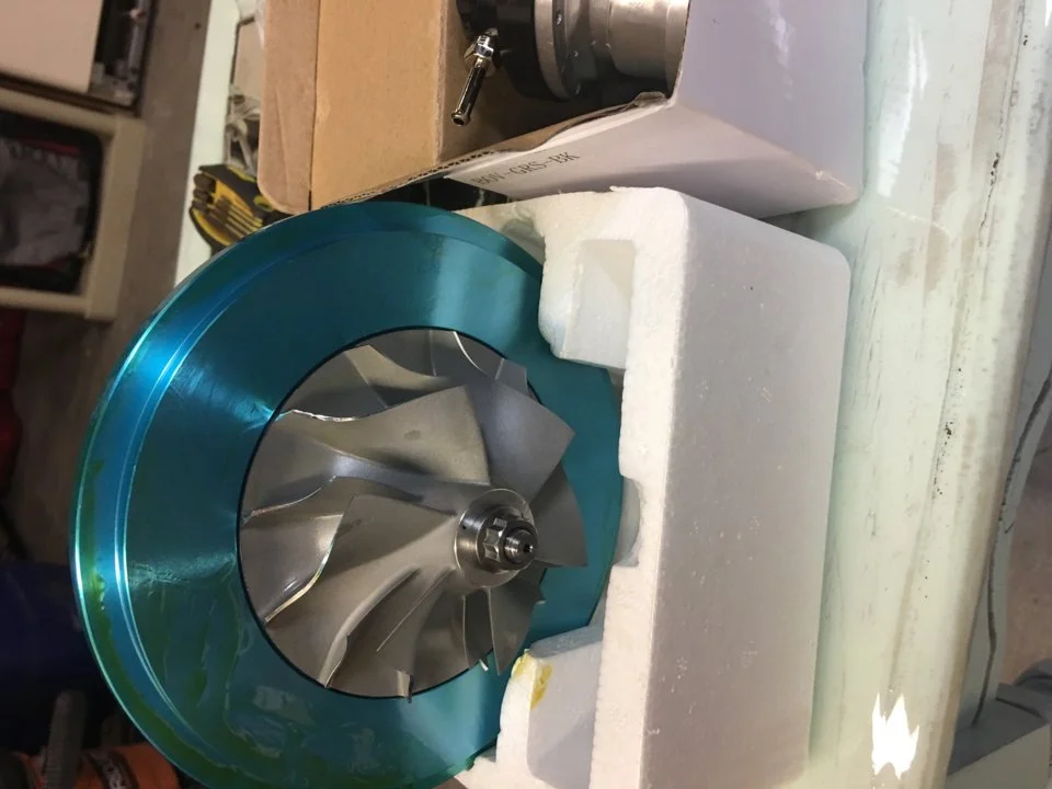

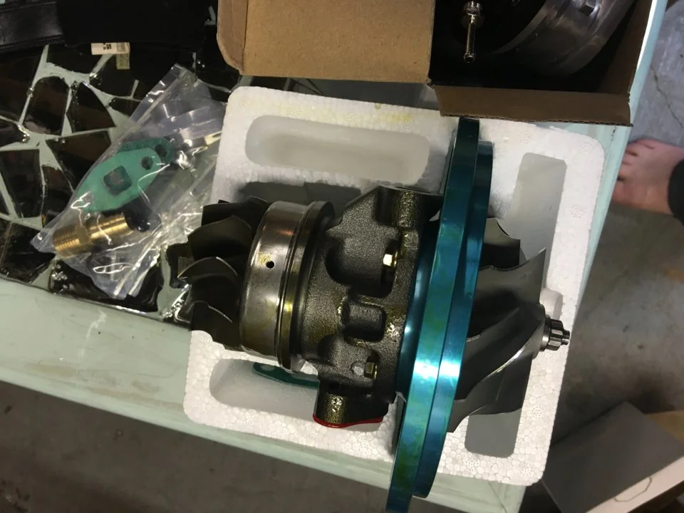

Ps - my turbo came today
Man, I don't mean to be a Debbie downer here, but without a housing you're gonna have a real tough time building boost.

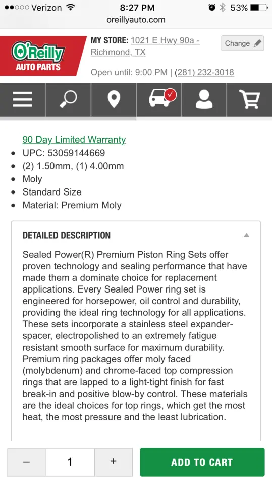

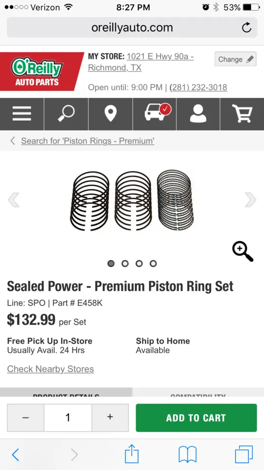

...of course, I have the wrong rings. And the right ones are twice the price.
I think this is a sneak preview of things to come.![]()
Well I learned the hard way that the Lightning Pistons aren't the same as other 351 variants. The ones above are for a lightning. Should I order the standard rings instead??depends on what the hone finish was done to the block. stock pistons should be a 5/64" ring
