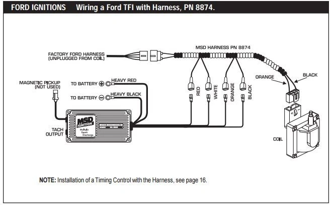

About the MSD box. I mentioned I have no shame a while back but I'm finding that even has its limits. I forgot to hook up a wire on the MSD box. It was an important one.

What wire wasn't hooked up? I'm pretty familiar w/ MSD wiring, and didn't know that there was any wire on the box that remained that didn't have a direct hook up. So just guessing,...had to be a wire dedicated to timing retard that needed to be grounded so that the box wouldn't pull timing?
