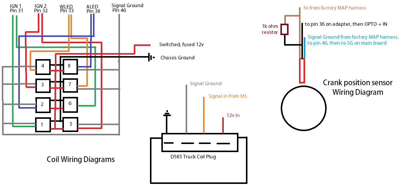

Well, you can retain 'most complex build' status. This is no more or less difficult than EDIS. It's the same concept, just a few more connections. All of my gremlins to date have been hair-brained errors on my part. As soon as I can quit working against myself, it should run fine. The coils all work as they should, it the crank trigger that's giving me fits it seems.
Here's my wiring diagram for anyone interested.

Im sure that's part of it. I think I just wasn't paying attention and got it too close. I 've found a lot of really stupid mistakes as I've gone back through everything, mostly stemming from hurrying because I only had a few minutes to try and get something done.

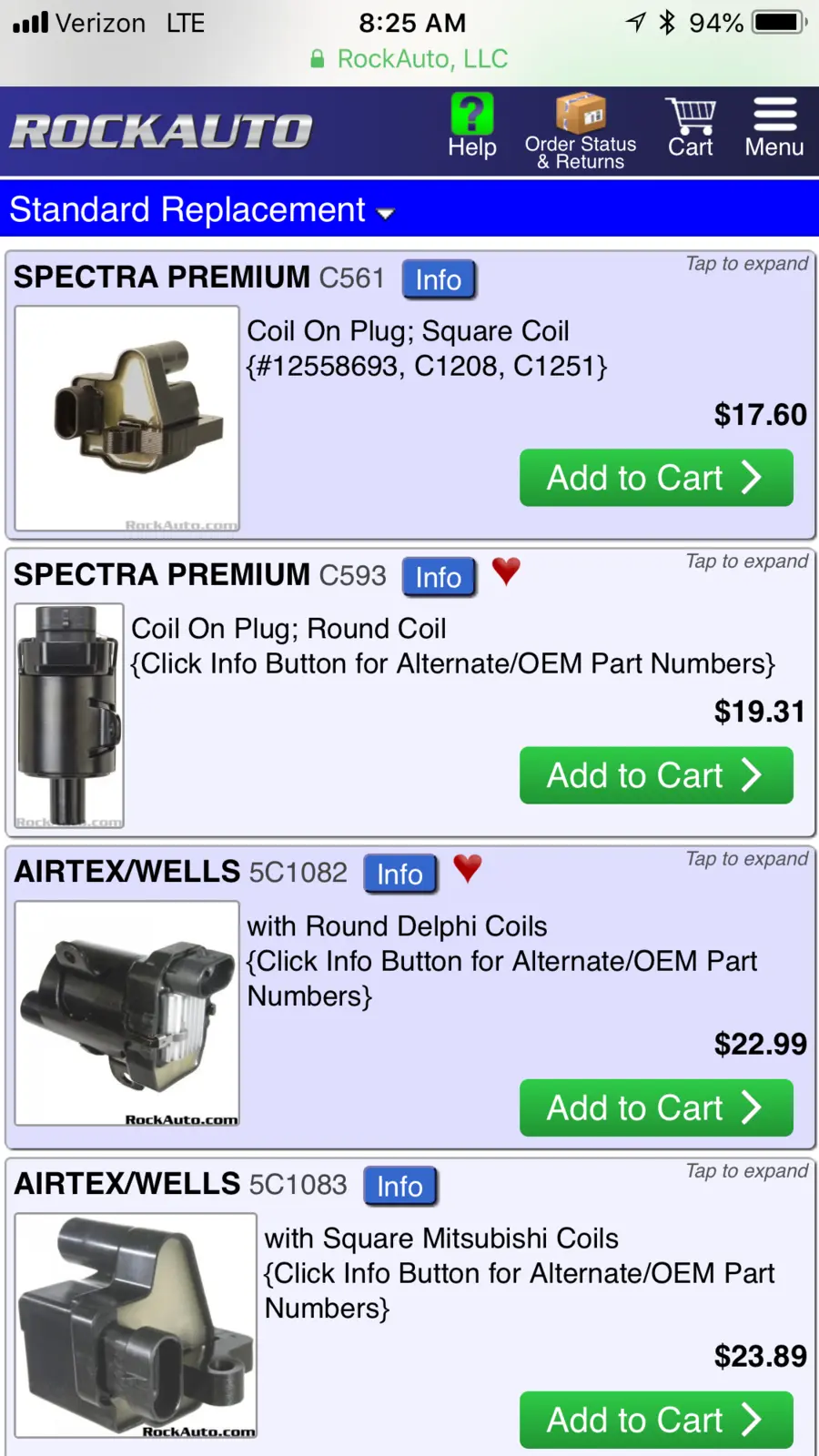

Tanner gave me a set he had laying around, but one was broken. I bought the replacement off Rock Auto for pretty cheap.
The wires are a cut-to-fit set, I got them from Jegs for $38 I think.

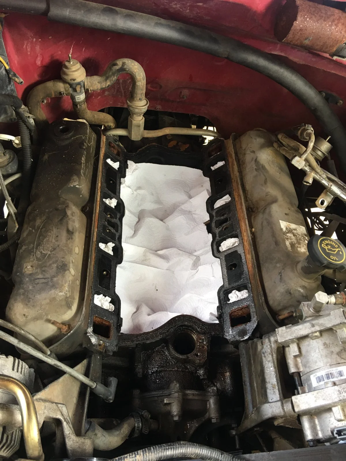

As if one non-running vehicle wasn’t enough, I tore into my truck to fix the coolant leak caused by the rotted and broken driver front intake bolt. Not to be outdone, the passenger front intake bolt broke off too.
Do I:
A) continue tearing down the motor and slap the GT40P heads on (still need valve job) and GT40 intake, headers, etc.
B) don’t fvck with the heads, but put on the GT40 intake and the 1.7rr I have
C) just fix the broken bolts and put the GT40 intake back on
D) leave it the hell alone, only fix what’s broke, and go back 100% stock
