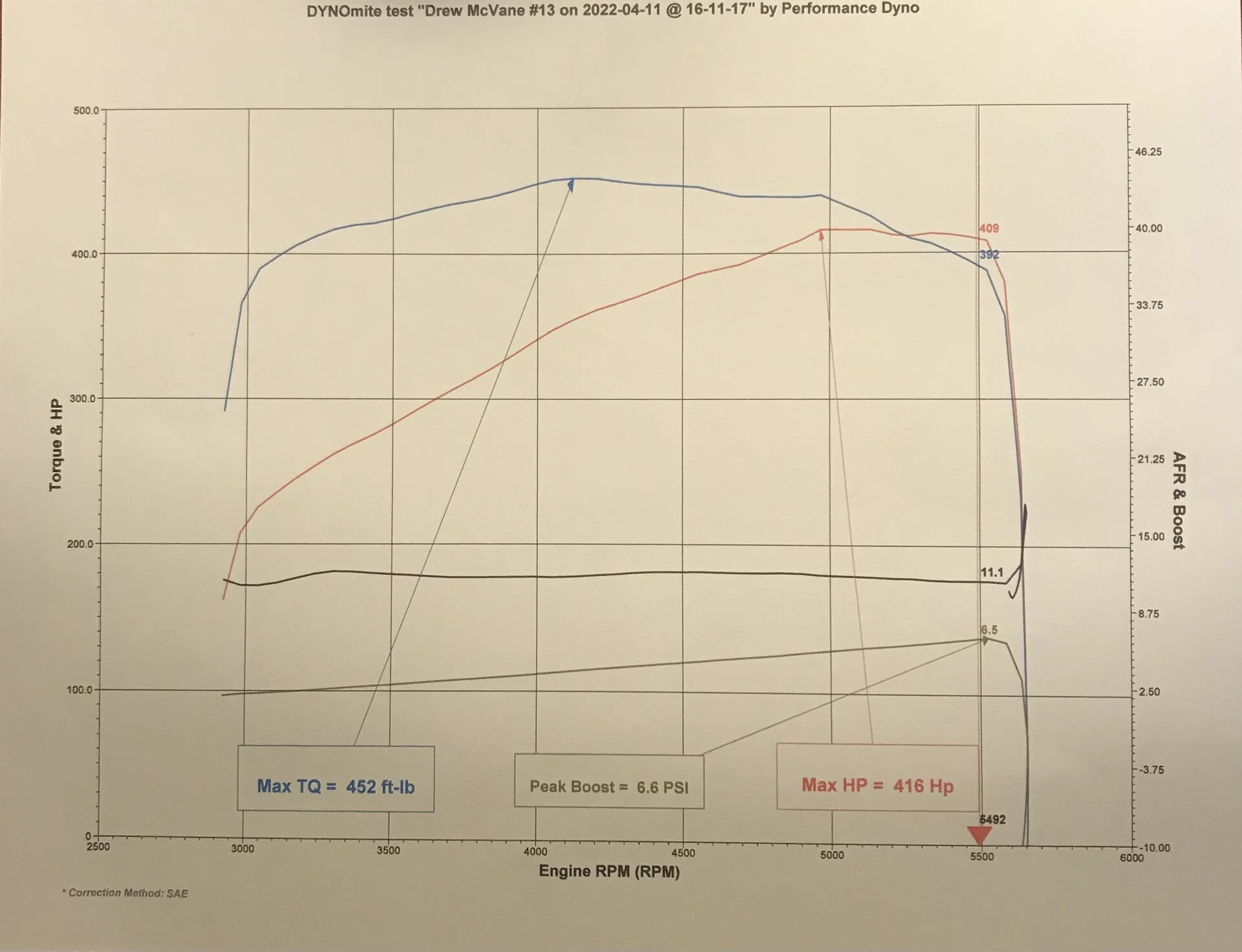

The long awaited day! Today I drove 90 miles to Performance Dyno to get my car re-tuned. This was the first long drive I have done this year. Previously I had only driven it 10 miles to get an alignment. The car ran great all the way there. The steering wheel vibration is GONE and the car drives much better. I still have the slight driveline vibe so I'll need to look into that. There is also an annoying rattle coming from somewhere in the dash or A-pillar that will need to be addressed ASAP.
On the dyno the car ran excellent. No issues at all and everything worked as it should. The tuner switched from SCT (which he had been using since 2000ish) to Moates Quarterhorse. He traded my SCT chip for the QH free of charge, which was pretty cool. The car made slightly more boost than expected, 6.6 psi. I was HOPING for 6 so this was very exciting. It made more TQ than anticipated and about what I was thinking for HP. VERY HAPPY. The car runs much better too. I guess all the changes I had made over the past 3 years had affected the drivability in slight increments so I hadn't really noticed. Anyway, here's the dyno graph.

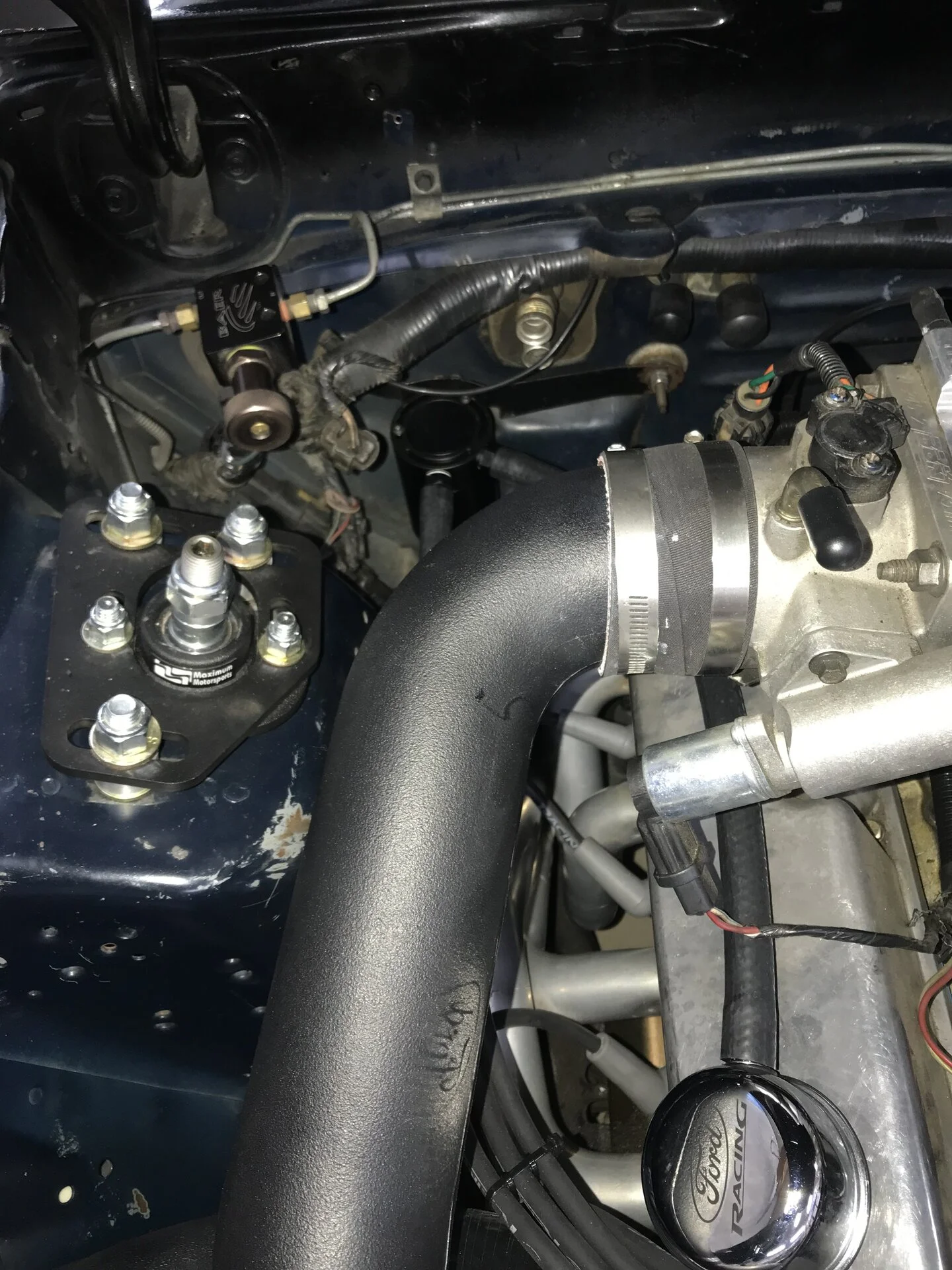

I installed a cheap Amazon catch can on the clean side of the pcv. Basically, I want to check if I have excessive blow by and catch whatever I do have. I think that the oil burning is going to cut down significantly now that I have a baffle grommet In the valve cover. I had been running it without one since I got the car because I didn’t know better. Anyway, the catch cab is a mishimoto imitation with baffles and a bronze filter. I just took the GF out for her first ride since the blower install; beat the crap out of it and the catch can is dry. If it stays that way I’ll prob move it over to the dirty side. It’s was only $20 so :shrug:

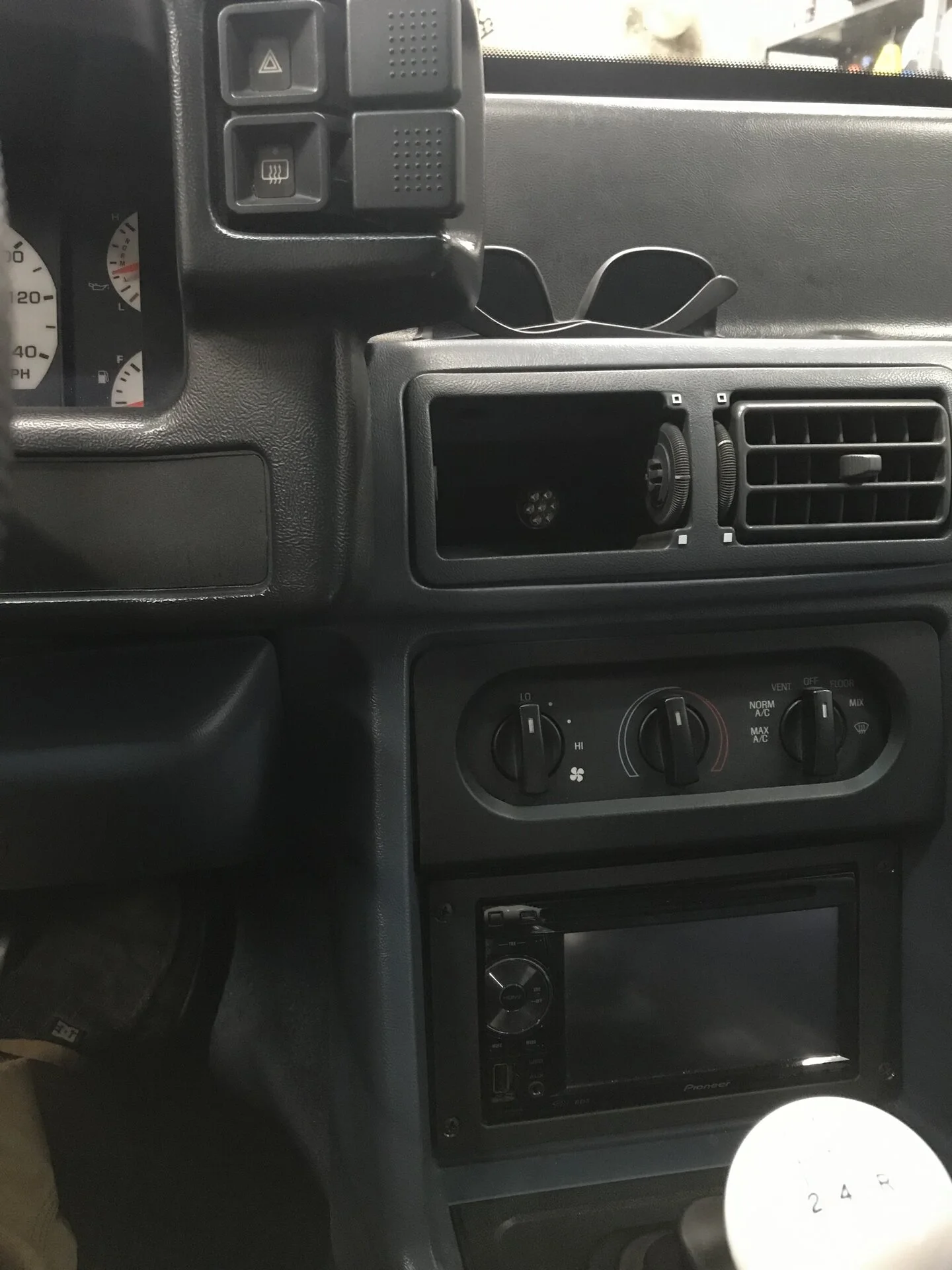

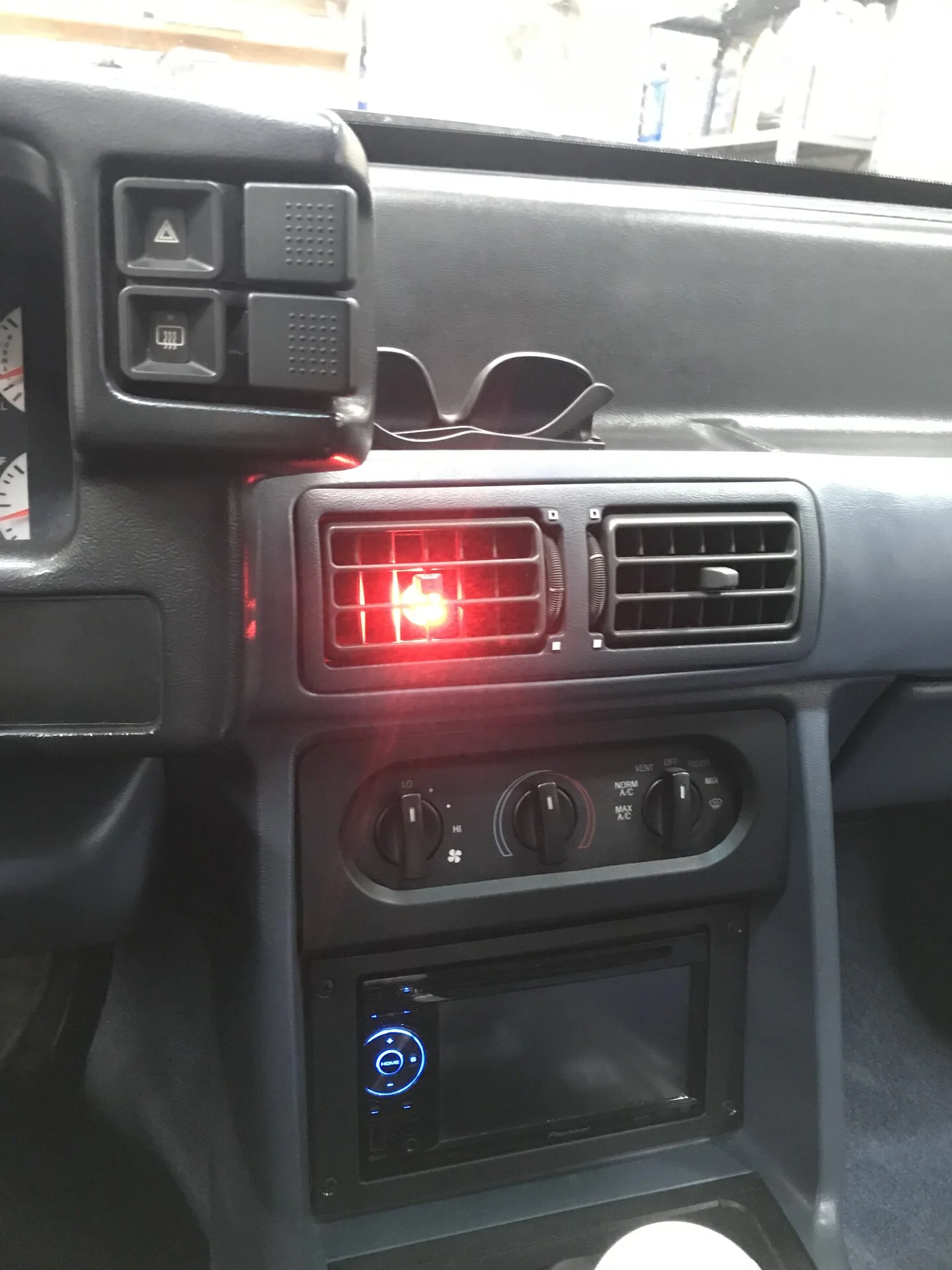

Some of you may have seen my post regarding questions whether or not a CDI box is a good idea to add a rev limiter. I didn’t particularly have an issue but I have revved my car past 5,500, which is where the power starts to fall off. I was considering a rev limiter, but since I don’t think any harm will be done to my engine by revving it up to 6k, I decided to add a shift light. This is a raptor first gen. It’s very bright and what’s cool about mounting it here is: a, It’s hidden. B, I can close the vent to hide most of the light. C, it’s easily accessible for adjustment. Currently it’s set for 5,300 rpm.

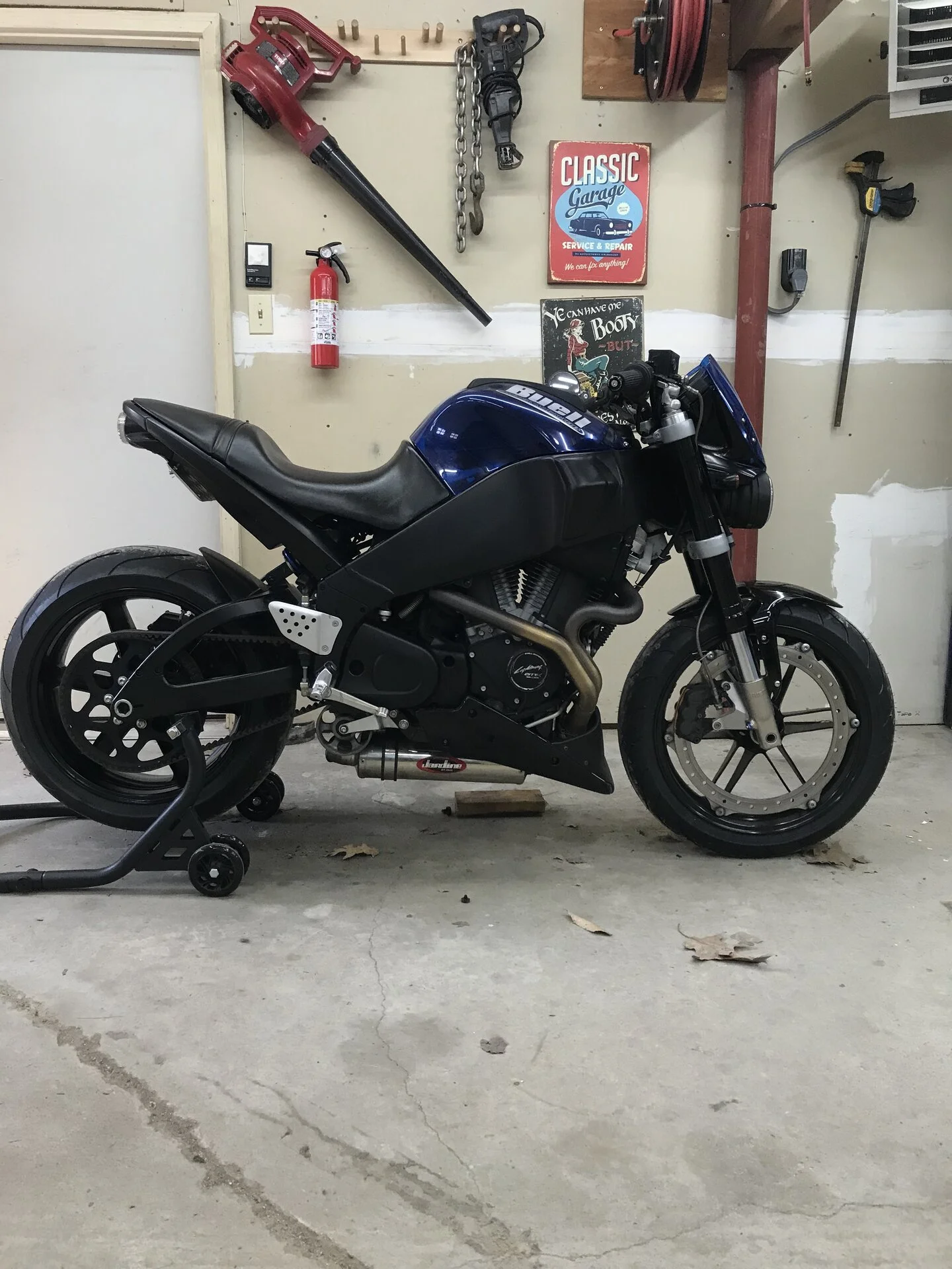

Haven’t really been hanging around here much. I’ve been driving the car but not as much as usual- riding my motorcycle a lot more, due to high gas prices. Just did a 3000 mile trip from maine to tennesse and back with my father. We hit the dragon, the moonshiner, the snake, the rattler, and the blue ridge parkway. Epic time.
The car is running great. I haven’t done anything but drive it all season. I think want to put stickier tires on it, maybe drag radials? Not much traction anymore. I also need to move my catch can. I put it on the “clean” side to see if I had any blow by. Since installing it I’ve caught no oil. I’m going to swap it in between the pcv valve and the upper intake. I’ll post the most recent pic of my car. It’s from a while ago.. the gf and I took it dinner - downtown portland.

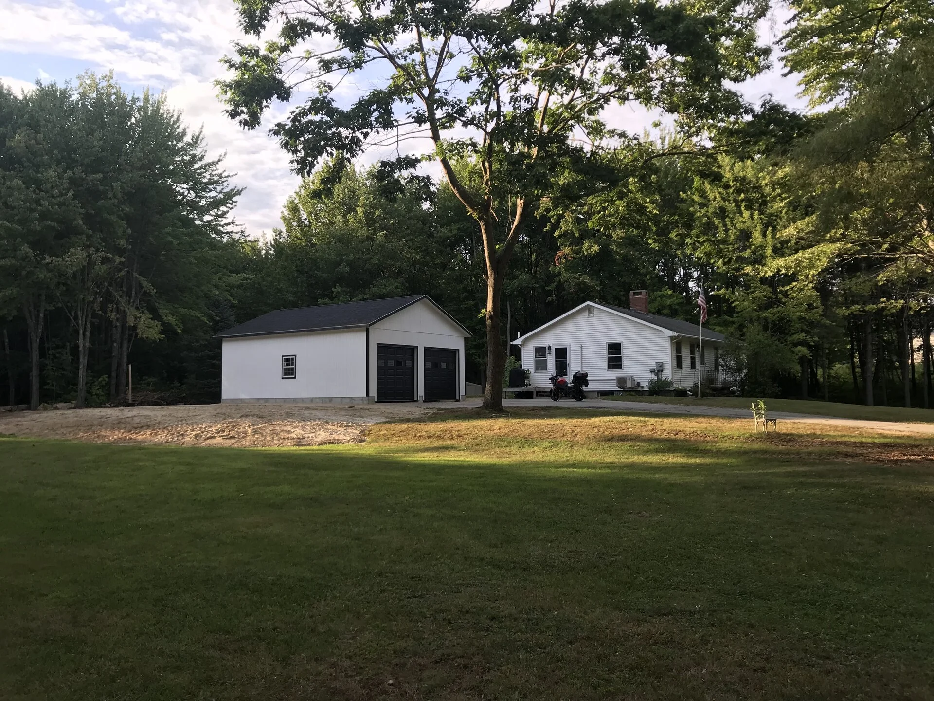

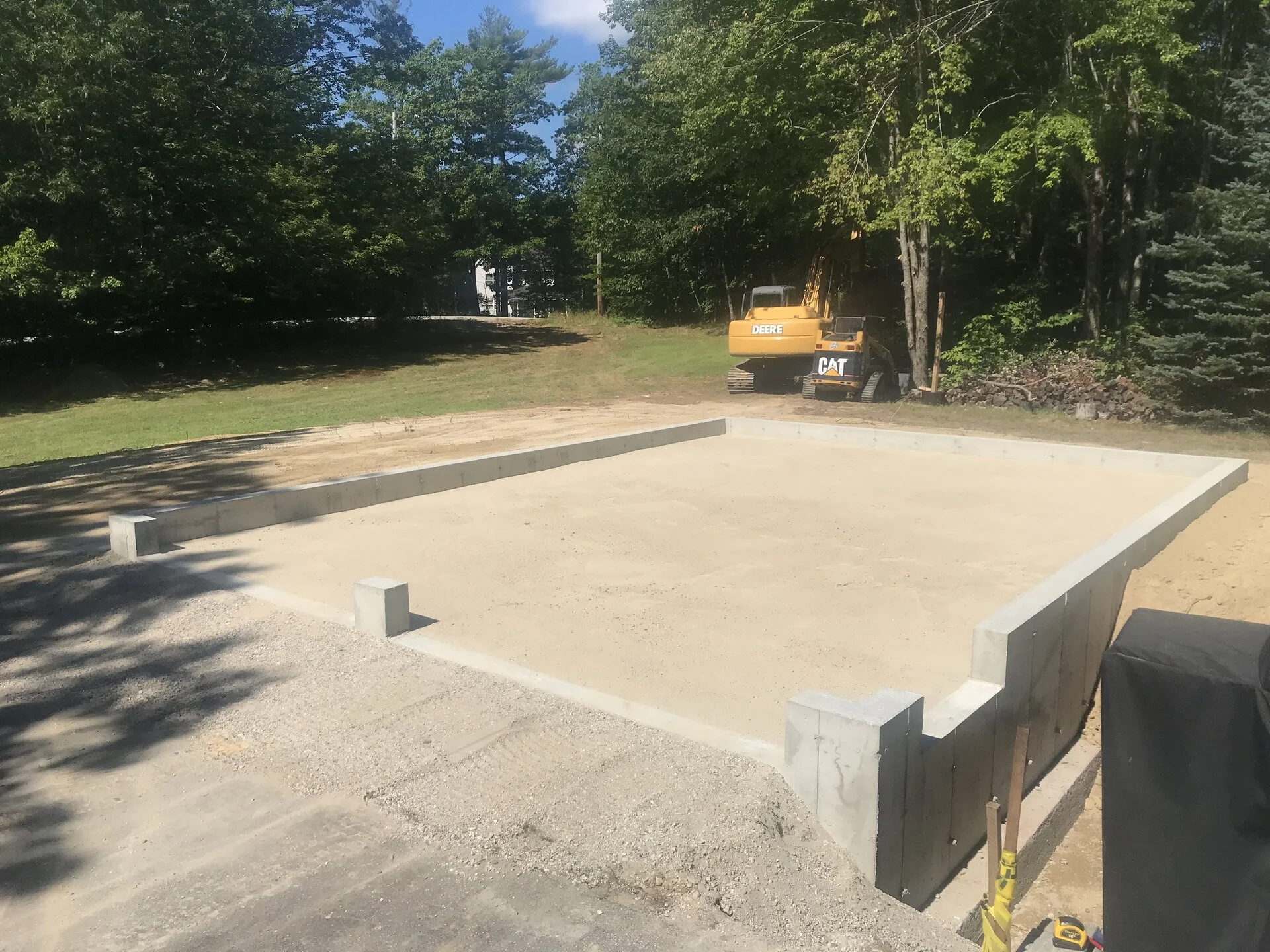

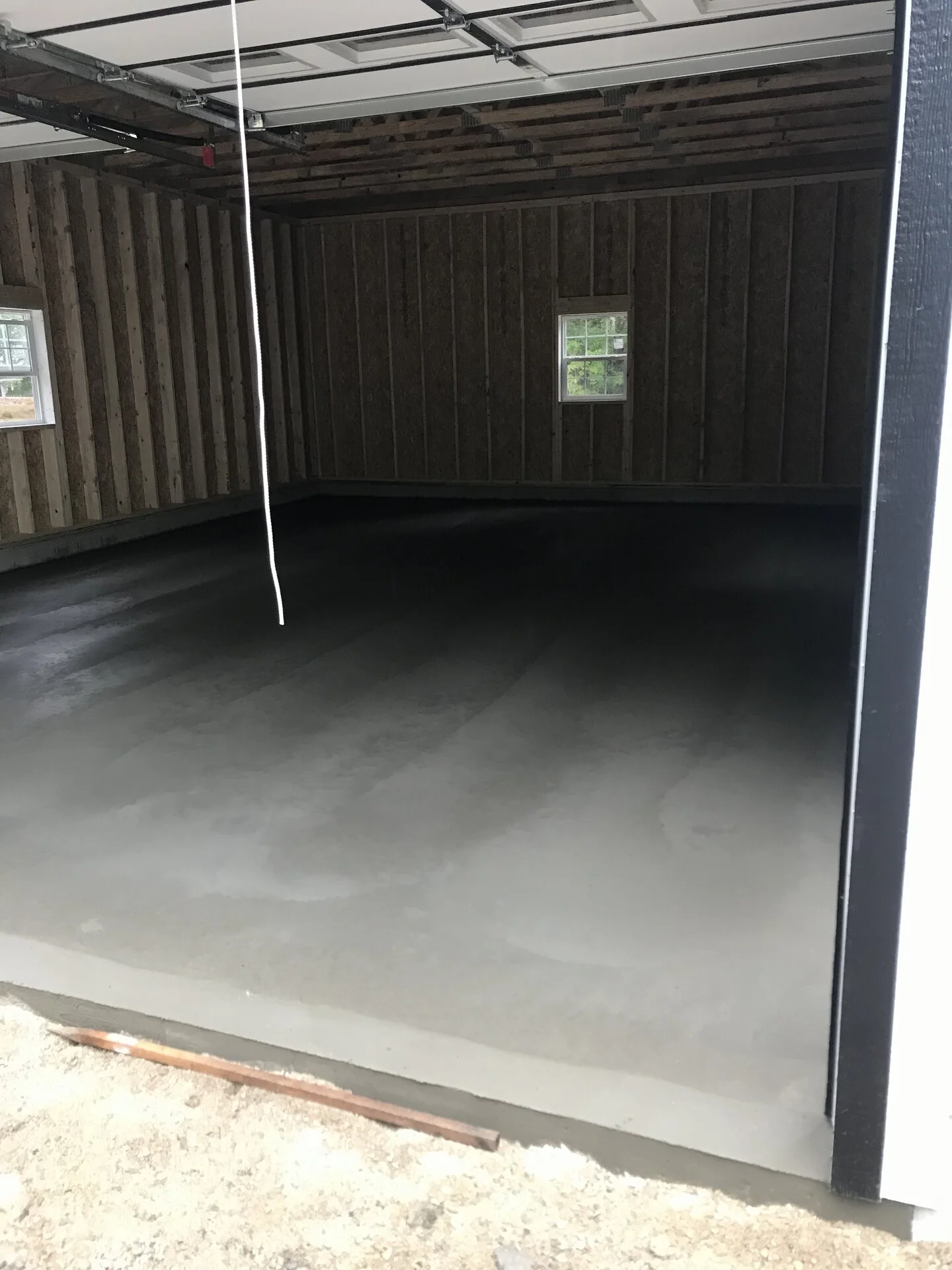

Not exactly car related but I figured I would update this… since the car will be living in it eventually.
The building was started and completed Monday (modular) and the floor was poured today. Next is the man door install, loam around it, then electrical. It’s 24x32. I think 11’ tall walls but haven’t gotten to measure yet because floor is drying.

Hell yeah man. I always tell my wife our next house will be much smaller, with a bigger garage, and more property (so neighbors are further away). That’s exactly what I’d like! Good luck and enjoy!!

Gonna spray foam it?
@Rdub6 Thanks man!
@Monkeybutt2000 My plan is to eventually insulate it but I don't know when or how. I would love to go spray foam but I'll need to crunch numbers when the the time comes, I know it's pretty expensive but obviously has it's benefits.
A couple of friends, beer, some staple guns and some bats of insulation.... That looks like a fairly easy job with minimal cutting...... Let Bob Villa have the expensive spray stuff.......

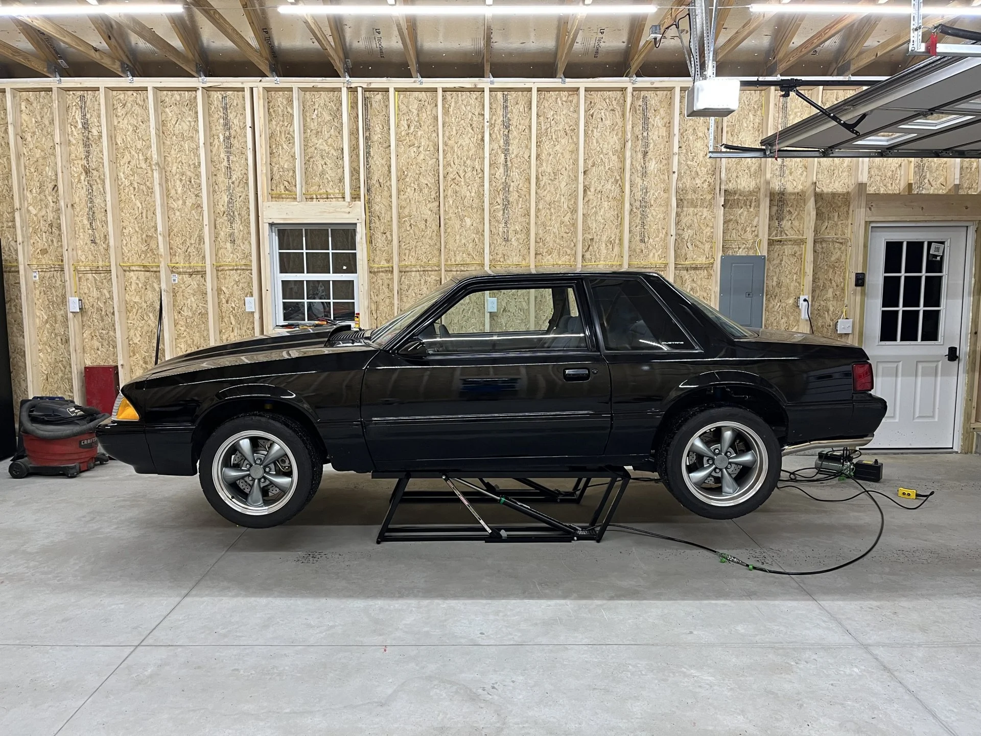

Picked up a quicklift today. It’s brand new; an older gentleman bought it and decided it was too heavy so I got a great deal. I think it’s a lot safer and slightly easier than using a jack and jack stands. They’re placed on the sub frame connectors in the pic. I plan to use this in conjunction with a 4 post.
