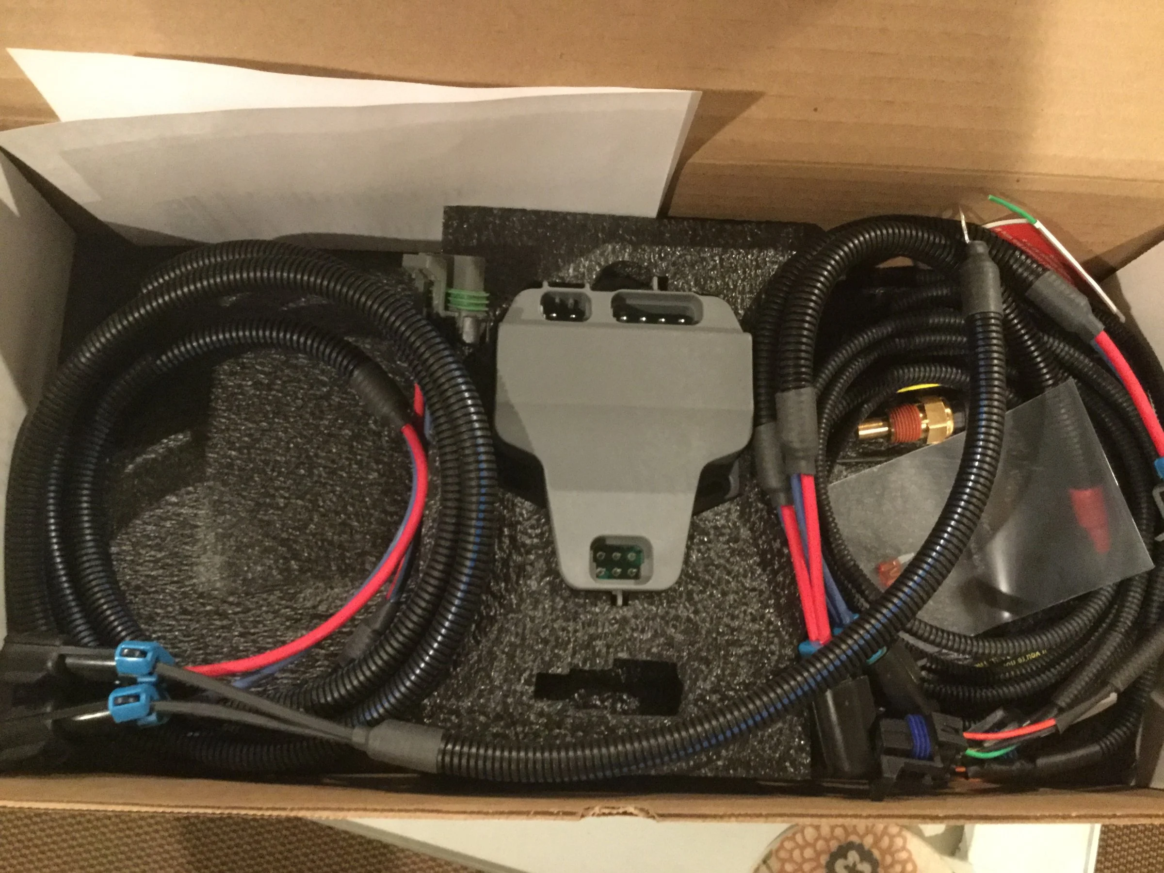

What's an " aoS" Holley carb?The photos rightside up now; thanks Noobz. I think I found a fan controller. Two-speed dual fan rated and American made. Now I just need myaoS Holley carb and I can make some progress
