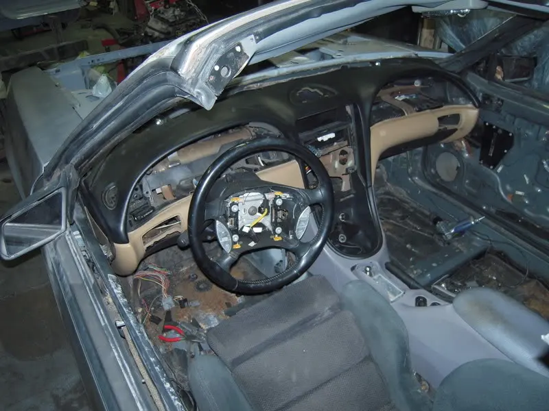

I think Im going to be using the fox door panels for a little while and then getting a set of gray door panels and custom making some to fit. I just want to get the dash done and work on getting that out of the way and then moving on to wire hiding and stuff like that. As for the gauges, I will be getting a Florida 5.0 autometer gauge cluster to make the install that much easier. Plus I love the way that looks. Other wise all the wiring will be from the 89. Im gonna need to get the wiring diagrams for the 98 and the 89 for the multifunction switch and the headlight switch. Its alot of work but it'll get done sooner or later. An as for Mustang week this year, I think that may be pushing it. If I finish it close to it I wont be going because I'm gonna want to drive it alot locally to make sure I have all the bugs out of it. Well see. Im about to head home to get ready to go to the shop. Havin this week off of work has really allowed me to get alot of work done.

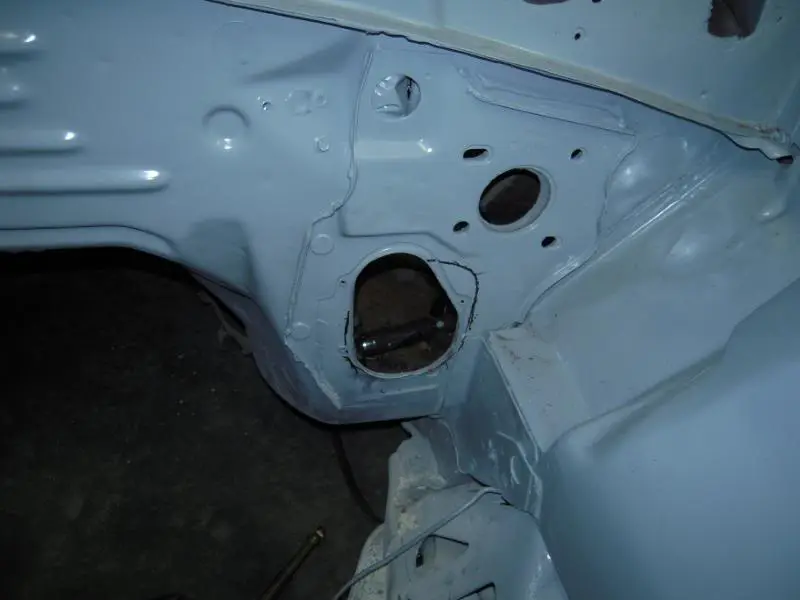

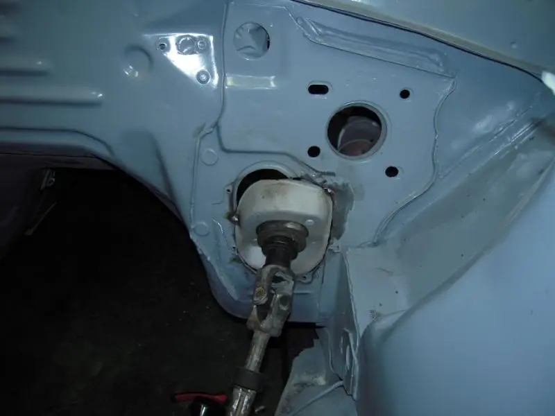

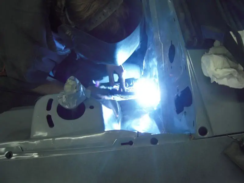

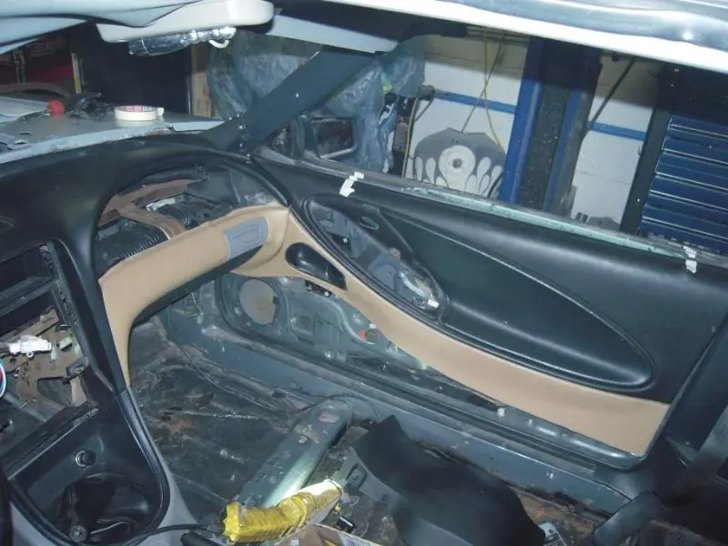

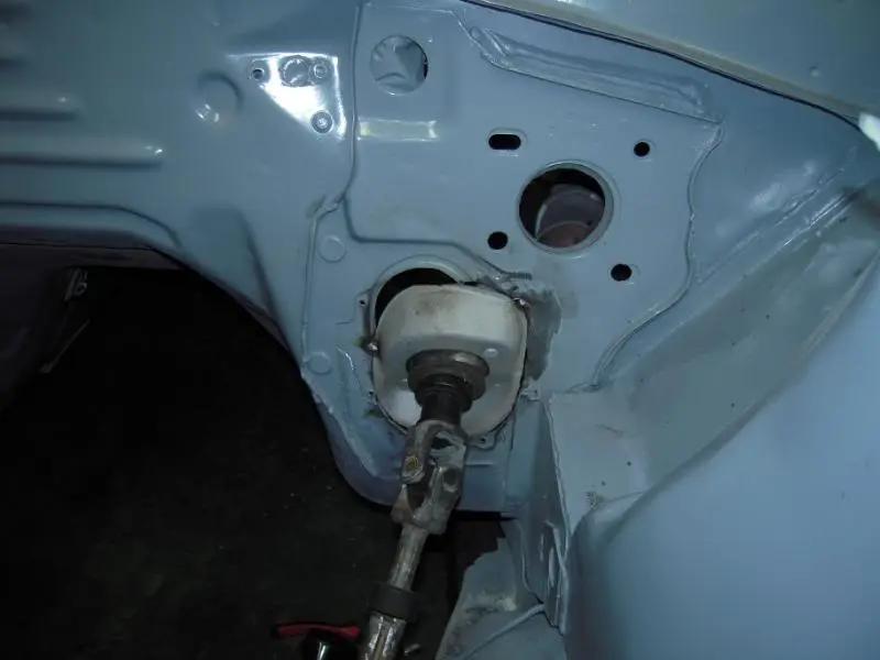

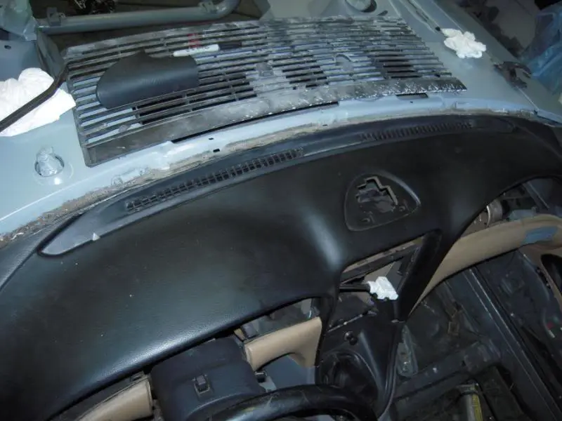

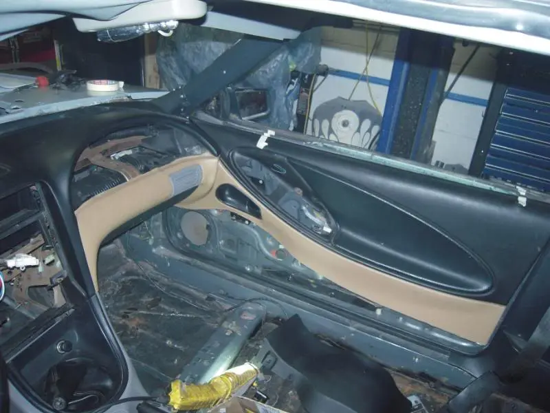

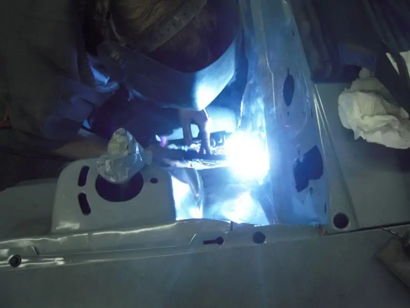

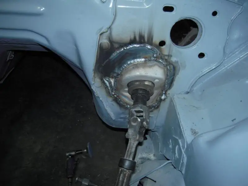

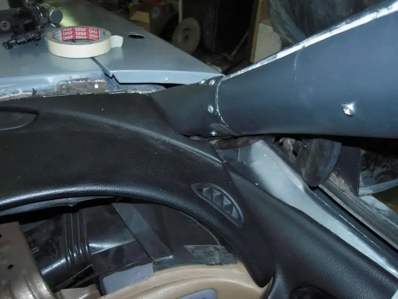

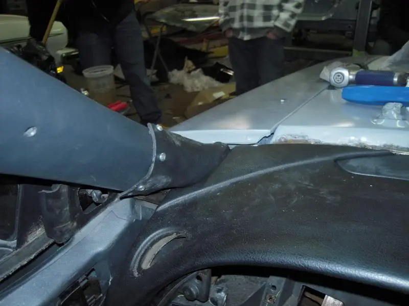

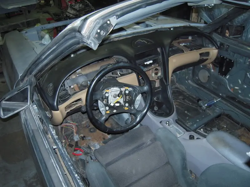

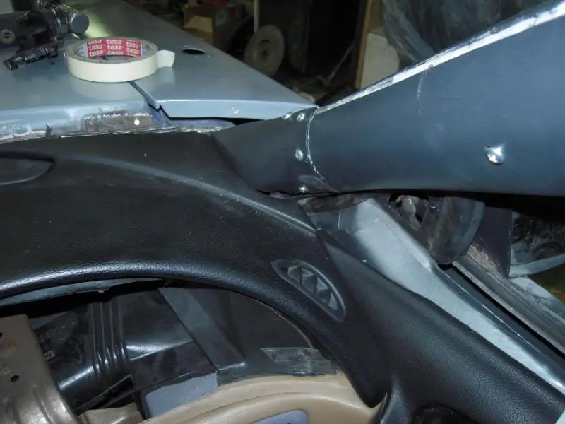

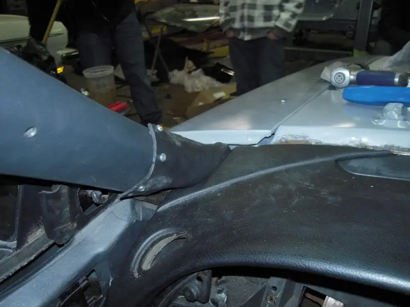

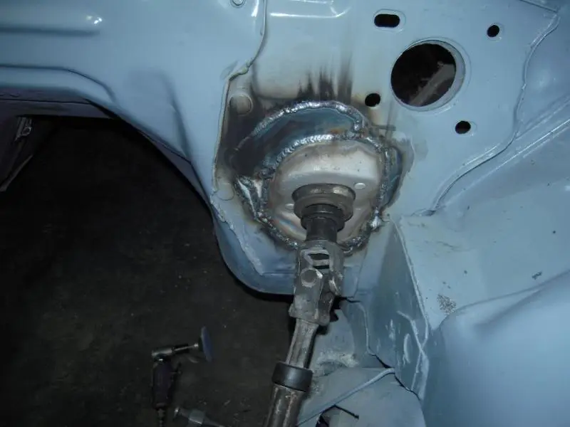

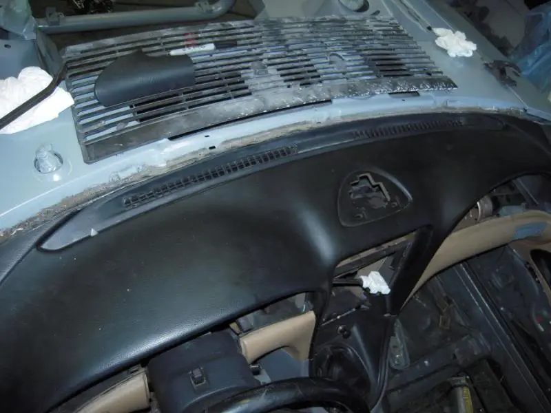

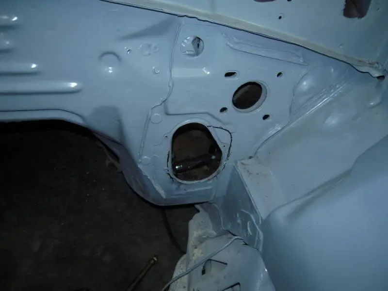

hahah thanks tyler, I'm hopin this thing is gonna come out nice. We'll see tho. Here are a couple more pics. I AM gonna end up doing the SN style door panels. I bought a set of white 7 up door panels for 30 bucks off ebay to hack up and attach the sn section onto and then fiberglass something up to make it look all good. I also got the car steering with the SN steering column with the bearing in the firewall and used the SN steering rack and simply screwed on the Fox inner tie rods. I also hacked up the SN and Fox A pillar trim to match up to the dash. They fit pretty well. I will be molding on a tweeter mount and fleecing it and then covering it with black vinyl to make it look pretty. I also bought a defroster vent cover and cut that to fit. The dash fits up to the firewall perfectly now and pretty much looks factory. I can't wait to finish all the wiring and stuff so this thing will be in for good!!
Enjoy:
Action shot!!!
Yes I know they look haggard for now but it will look nice when I'm done with it.

Dude...that mock-up of the door panels looks awesome. You GOTTA go that direction. I know you can make it work really well. You are doing a really nice job, keep taking your time like this to do things right, it will pay off.

Nice job so far. Since Hack Job is gone, somebody had to do an SN95 dash swap!! lol

Since you are using the 94+ door panels and handle you need to consider what you will to do for the door latch. The fox handle uses a hard rod to push the door latch to release it. The 94+ handle uses a cable to pull the door latch to release it. I saw one guy just get two 94+ door latches and cut that portion off and weld it to the fox latch. It worked fine. Another thing you can do...which I would not want to attempt this is to: Get the two 94+ door latches and two 94+ strikers. You would have to weld up the old 3 holes in the fox doors and drill 3 new ones for the 94+ latch. The bolt pattern on the newer latch is much smaller than on the fox. Just two options for you.
If the molding of the A-pillar trim doesn't go well...and I'm not saying it will go bad....you can get 86 and older A-pillars. They have a different shape at the meeting of the dash and fill the gap pretty good. That's what I did on Hack Job.
Make sure when you are bolting the column in the dash you have the steering shaft and rack and pinion fully bolted in. You just want to make sure everything is square. I fought getting my column straight, but I fianlly got it with some small tweaks here and there.

No problem. Everything looks like it's going along great. The 94+ heater box will fit no problem. You'll see where you have to make some changes to the way it bolts up and being that your car is newer than my 81....you might not have to modify the firewall for the heater and ac hoses/tubes to go through. The 81 firewall needed some modifying done...more than what an 87+ firewall looked like. Just make sure nothing rubs. I put that black door edge protecting trim on the firewall where the heater core hoses and a/c hoses went into the car. Cheap insurance!
