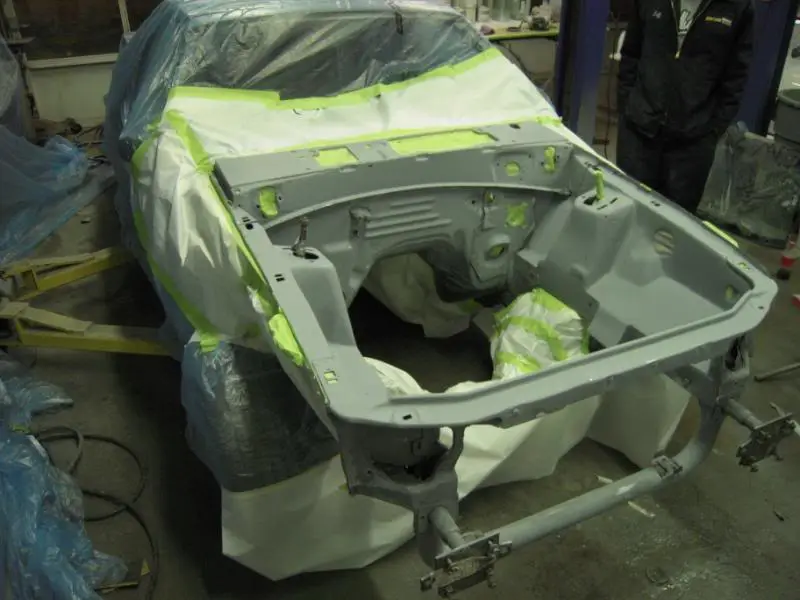

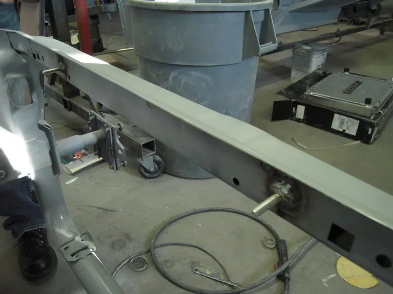

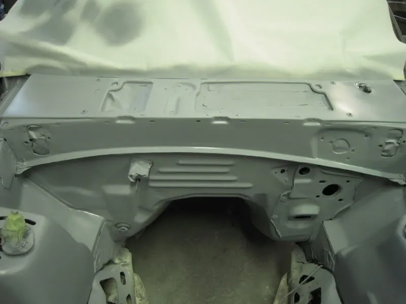

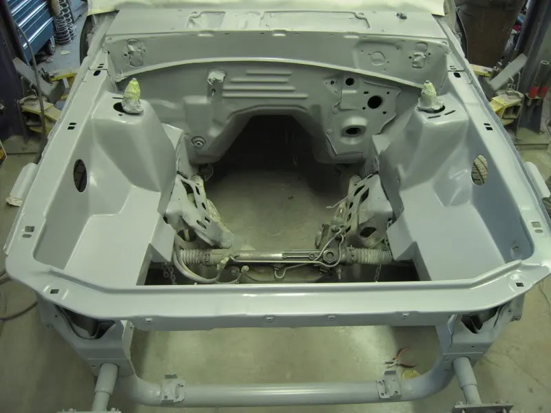

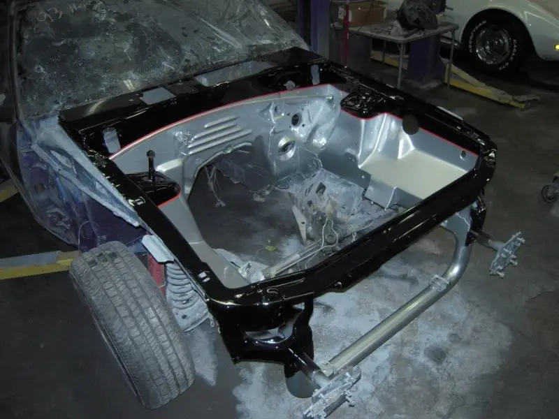

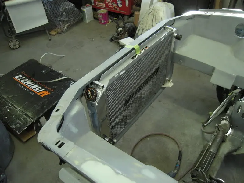

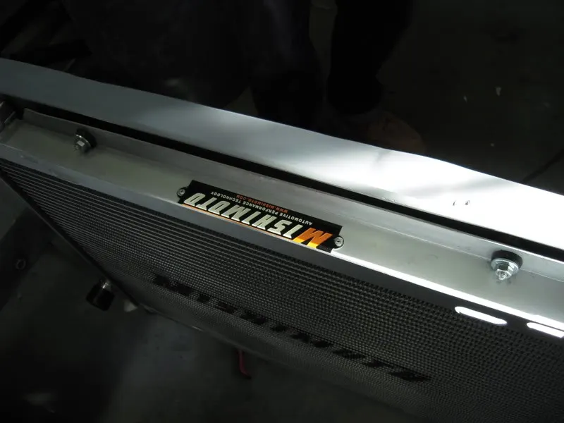

UPDATE:

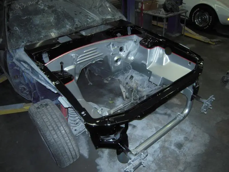

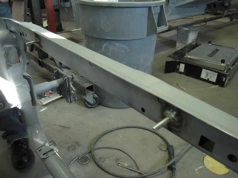

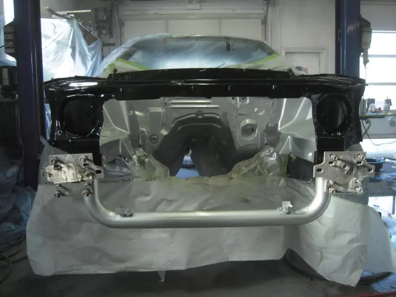

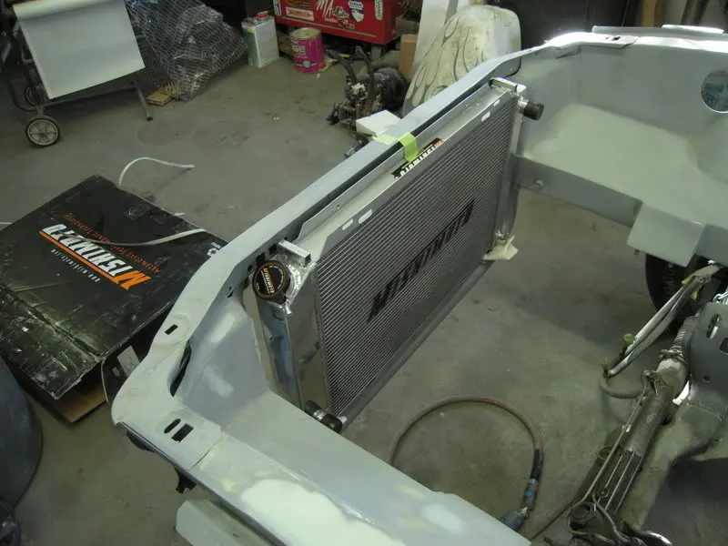

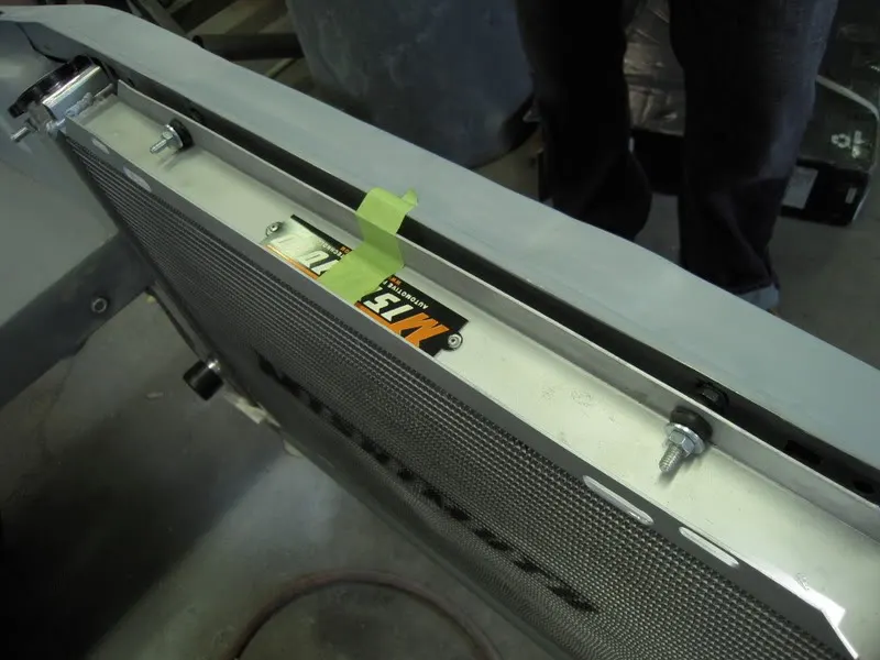

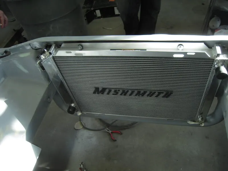

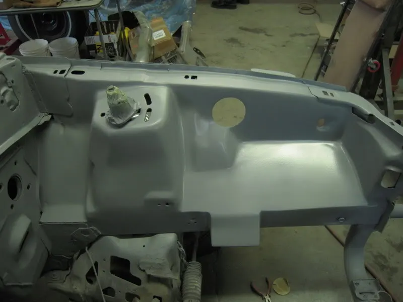

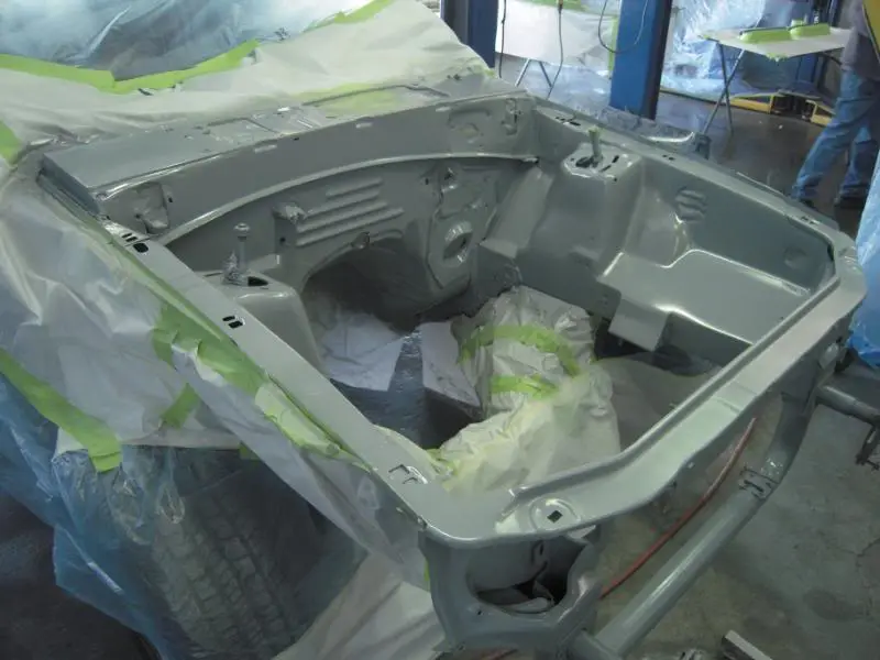

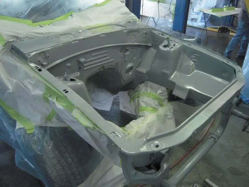

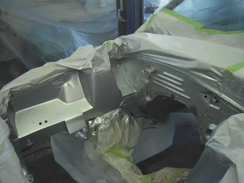

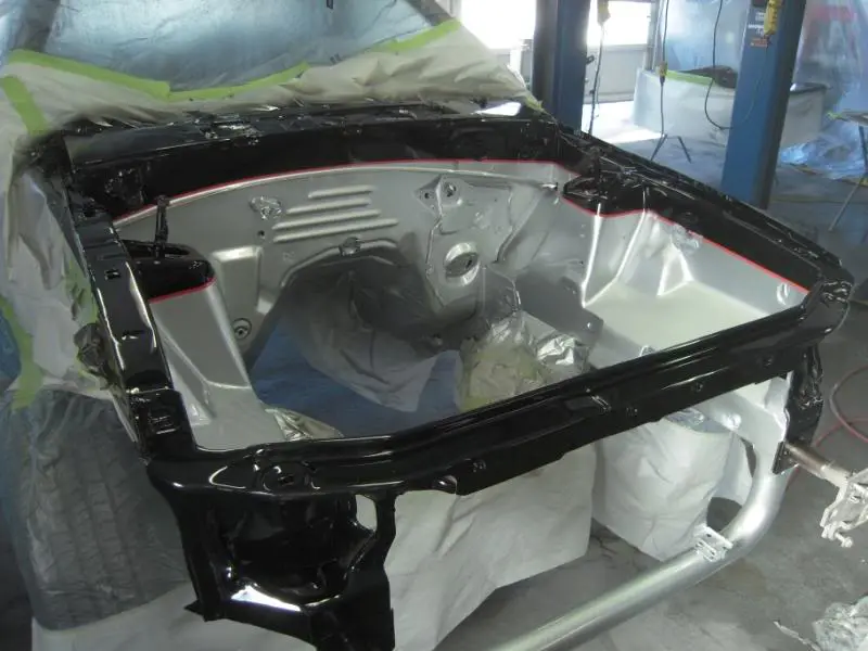

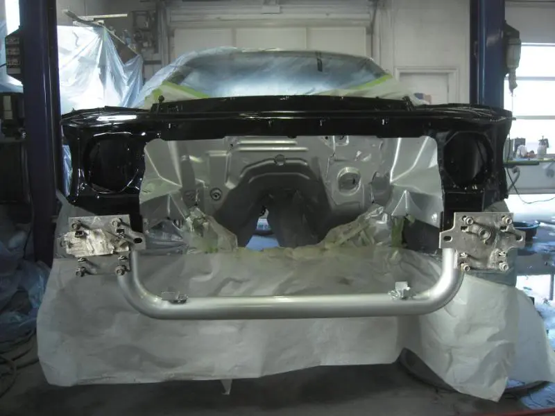

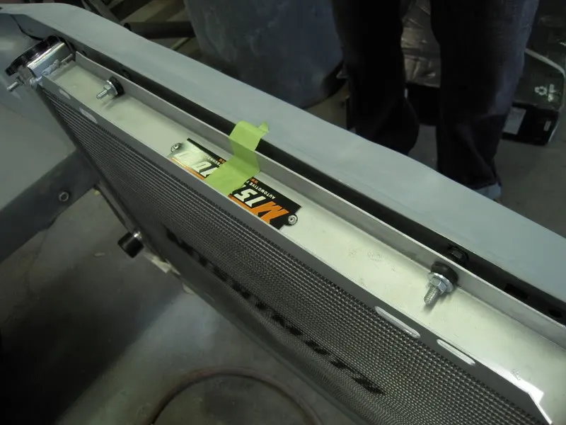

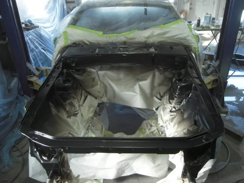

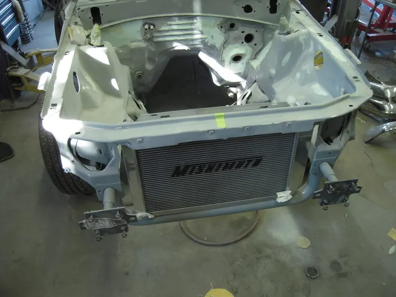

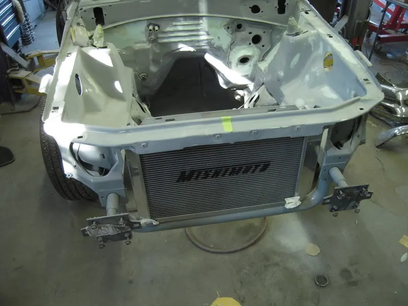

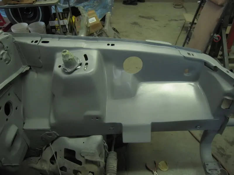

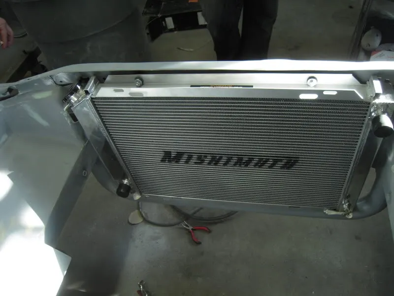

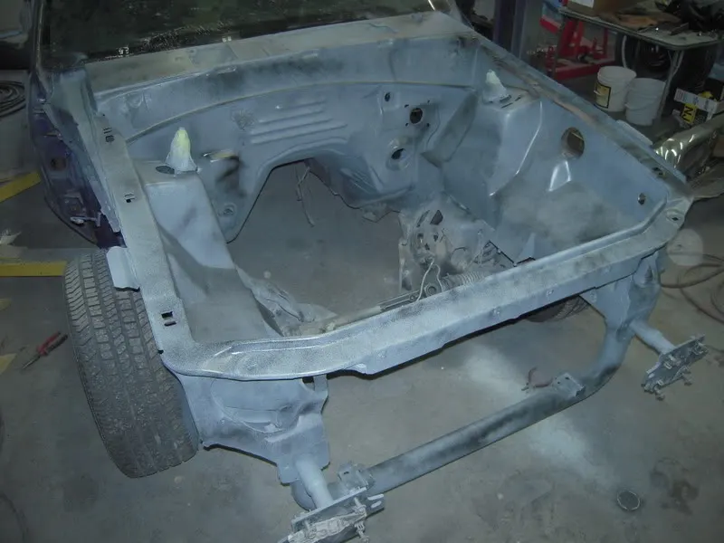

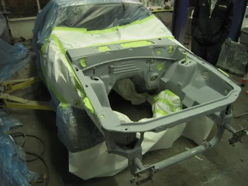

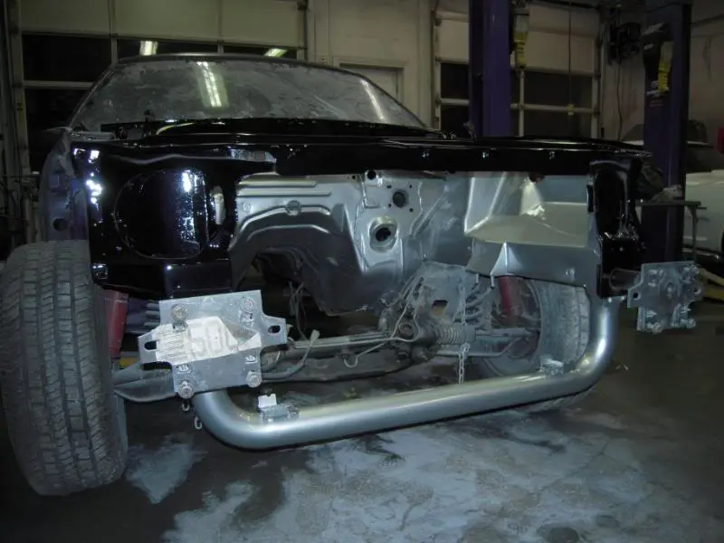

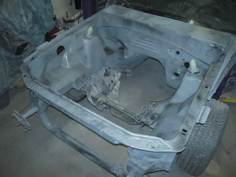

I finally finished the body work up on the engine bay and got it in prime. I also got my rad mocked up and welded in the mounts. Its a pretty solid set up and am happy with it. My buddy gave me the idea and I think it was a pretty damn good one. The engine bay should be painted in the next two weeks and the engine should be in about a month or so.

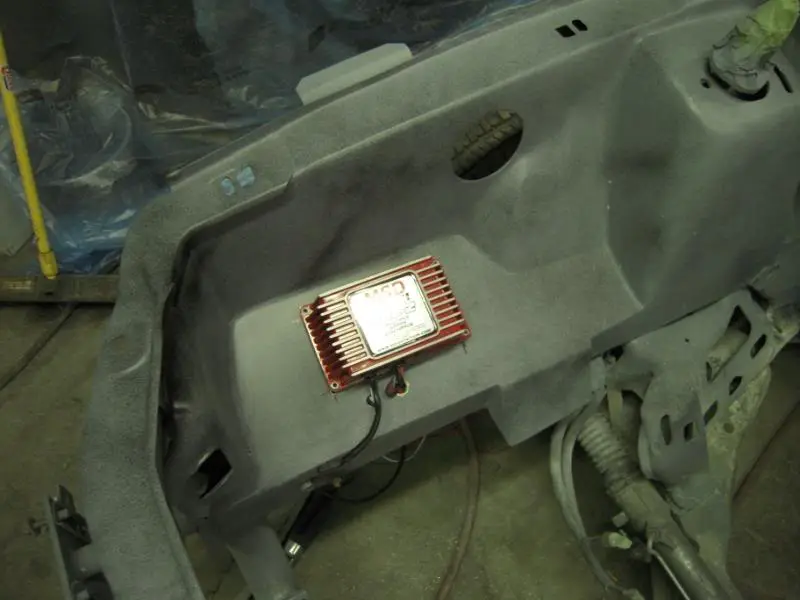

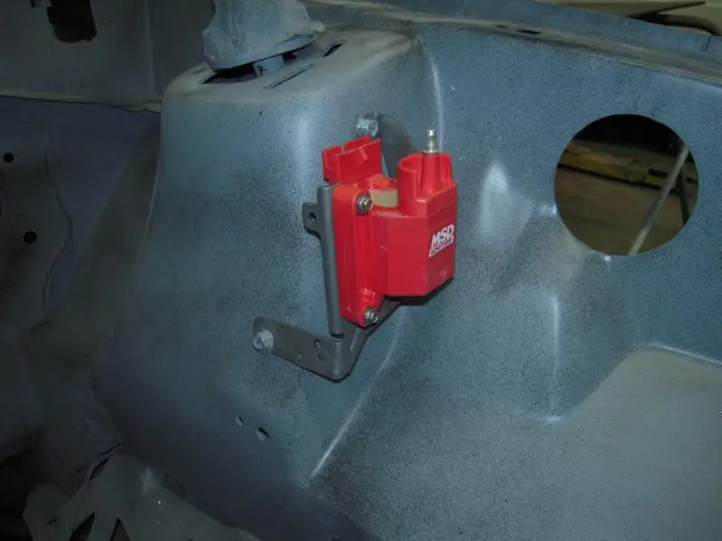

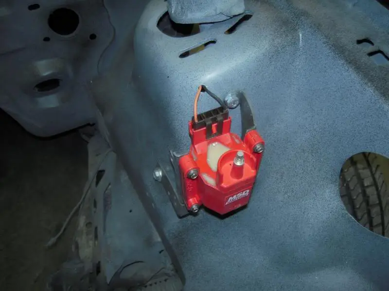

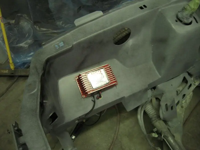

Thanks! I wasn't sure what to do but my buddy came up with the idea real quick. My grommets are actually the ends of valve stems that I cut off. The rad is really solid in there. I have my MSD 6AL-2 box coming in this week so I'm gonna mock that up before I paint it so thats ready to go. I can't wait to shoot some paint on this puppy! I also just ordered my drag springs so now I have all my front end components ready to go so once the bay is painted I can go ahead and install my QA1 k member and new control arms. I'm FINALLY seeing some really good progress going on this car. I did start the engine bay last April an all lol.

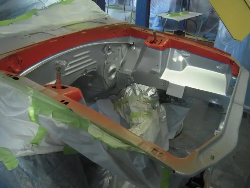

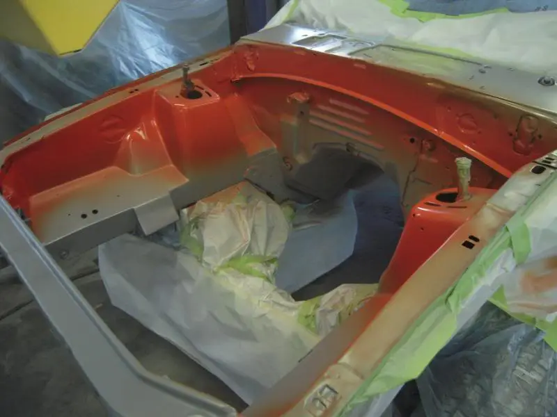

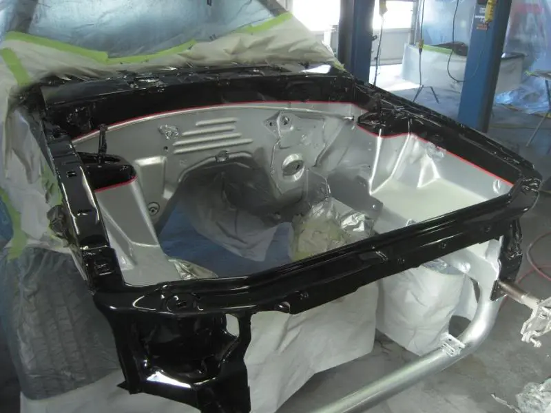

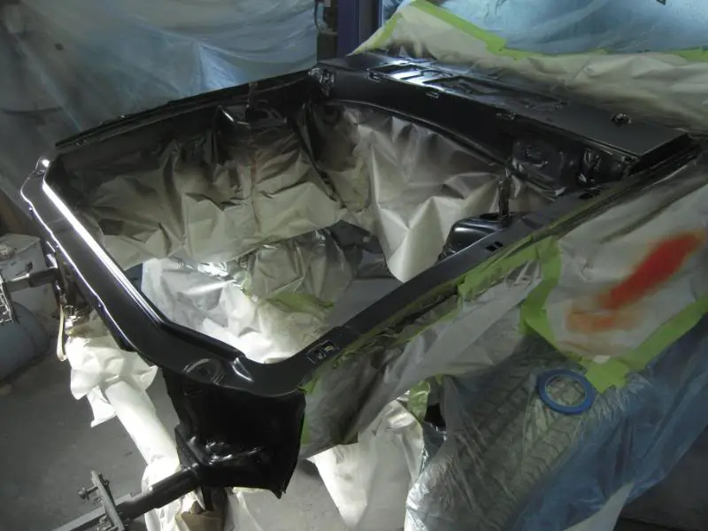

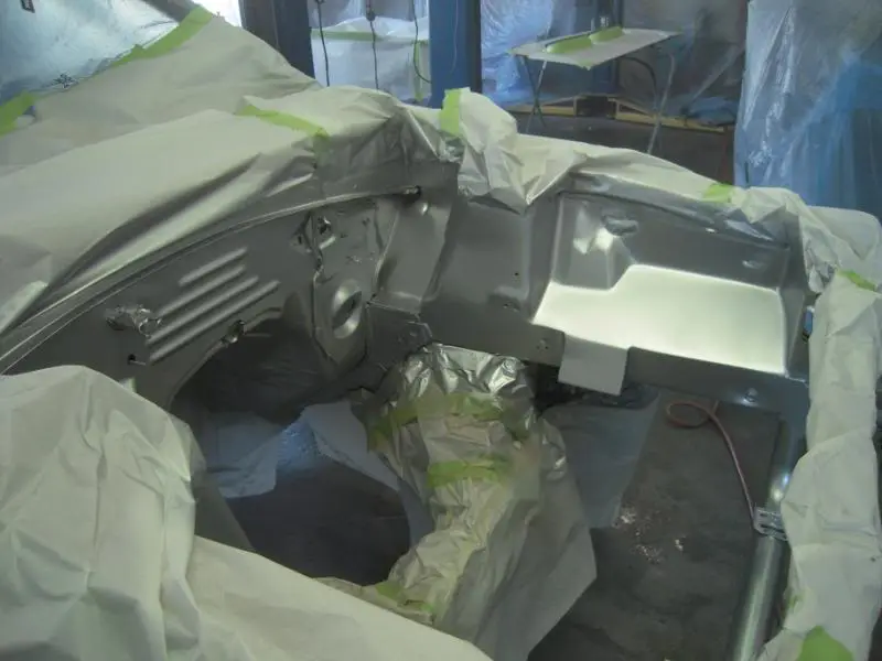

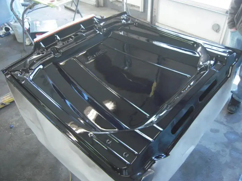

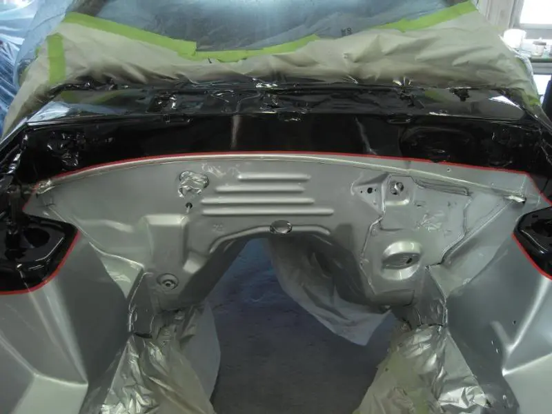

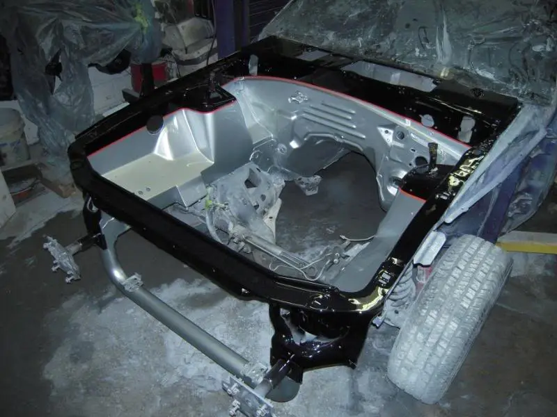

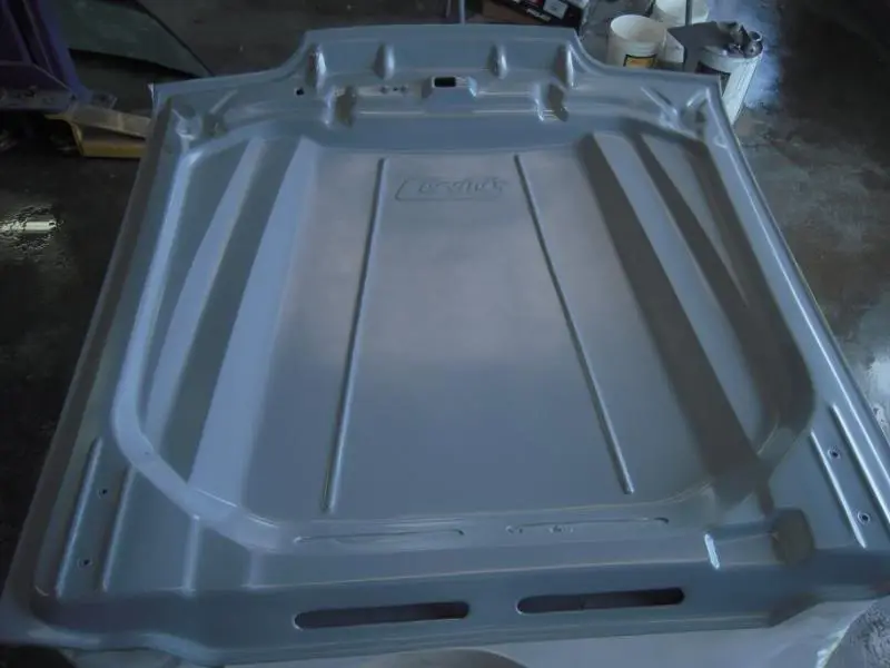

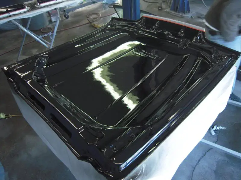

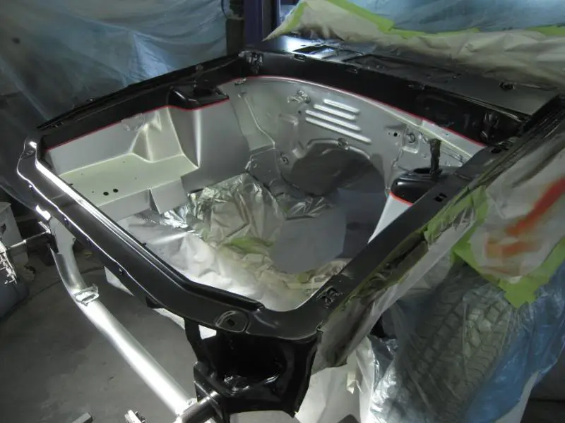

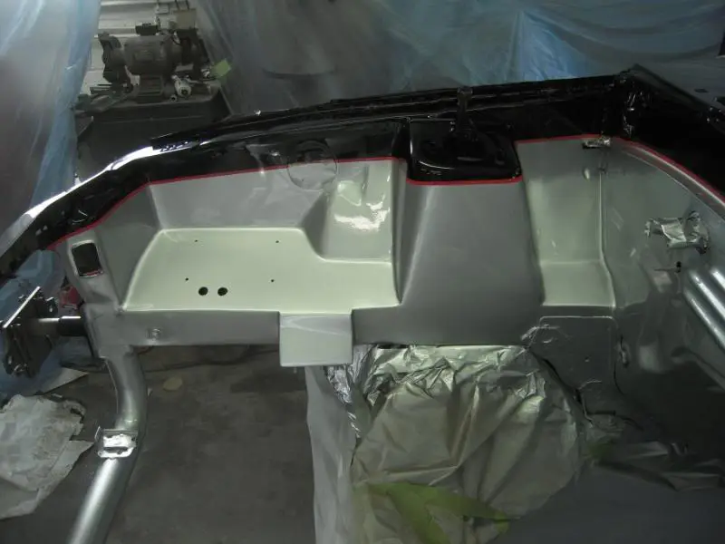

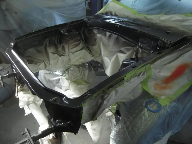

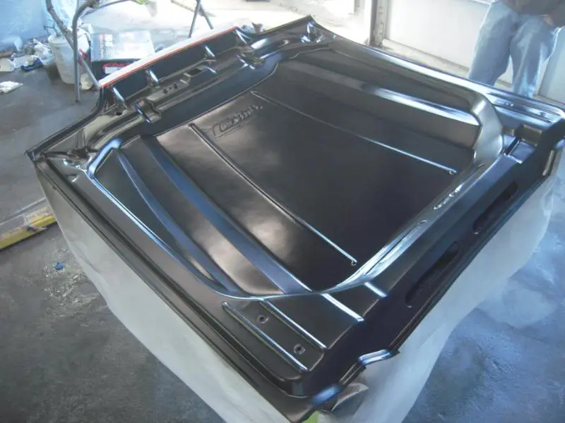

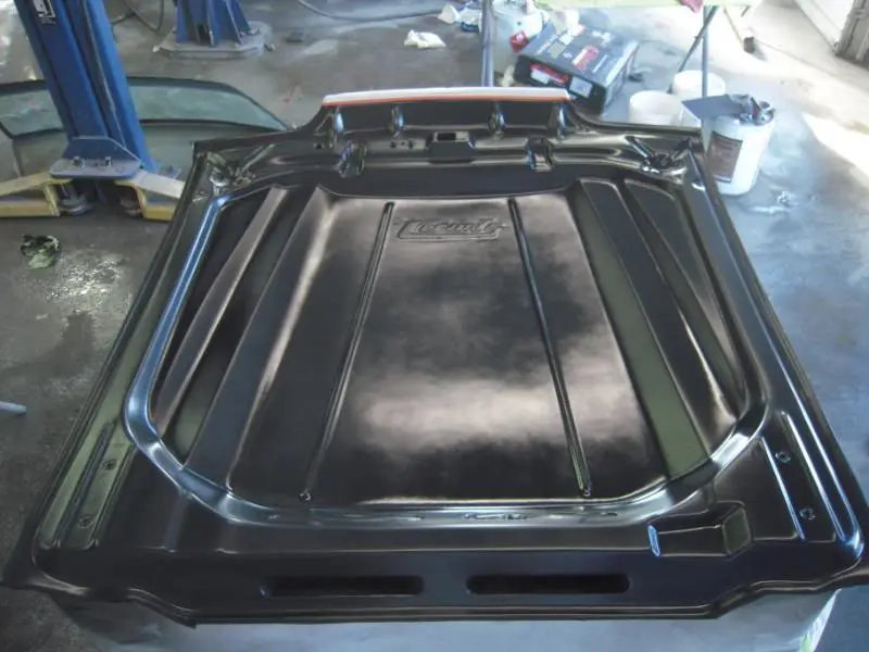

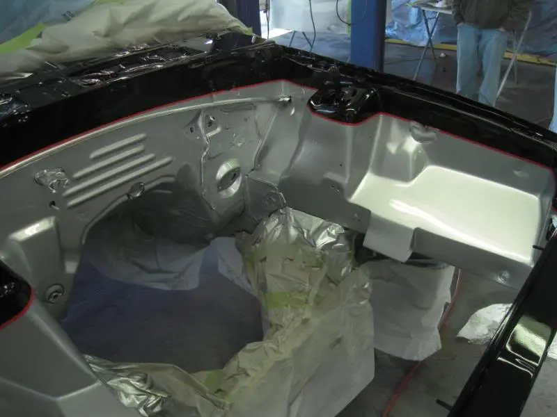

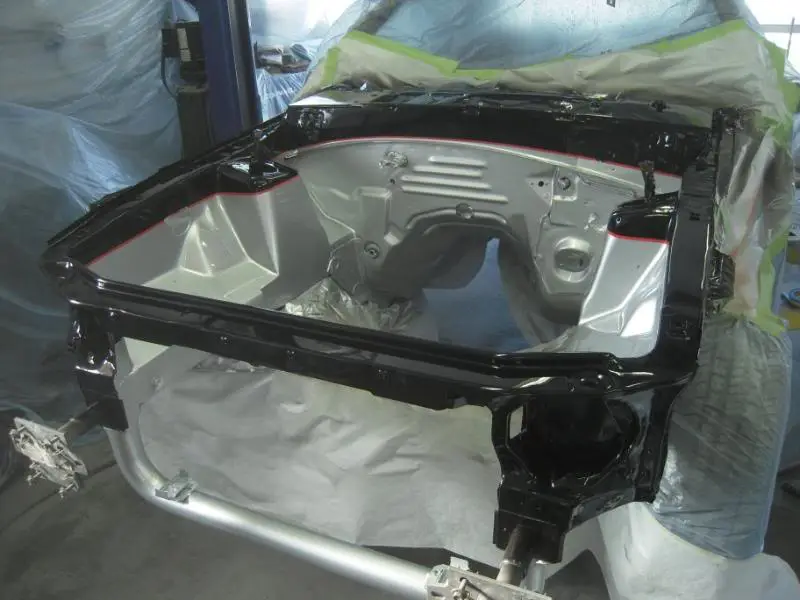

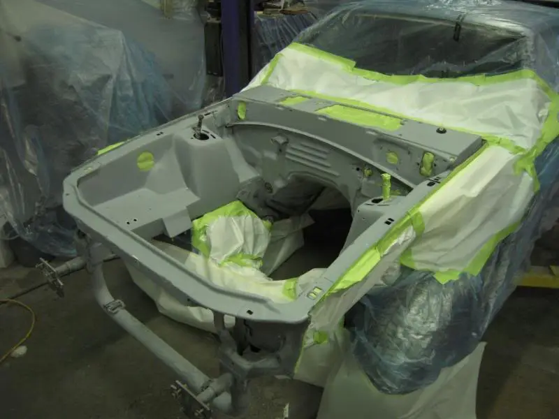

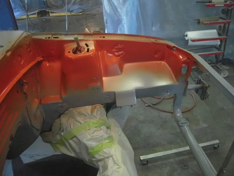

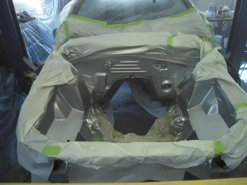

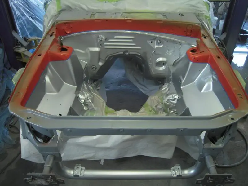

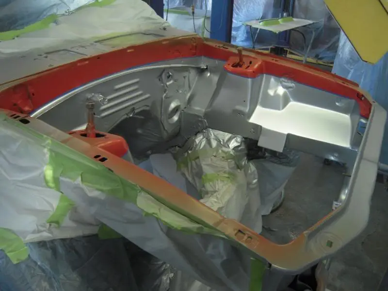

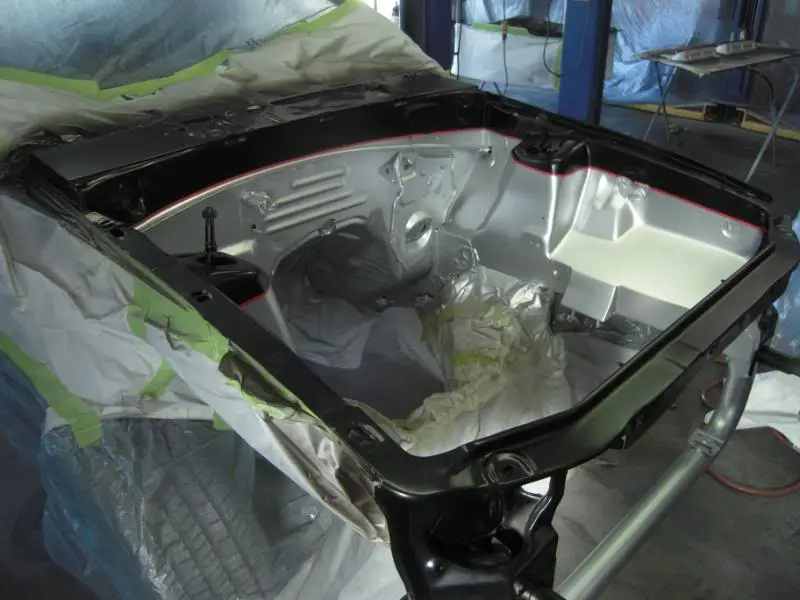

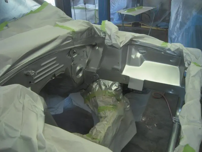

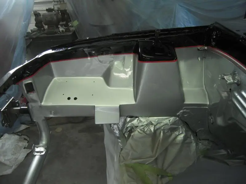

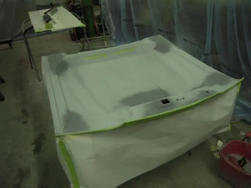

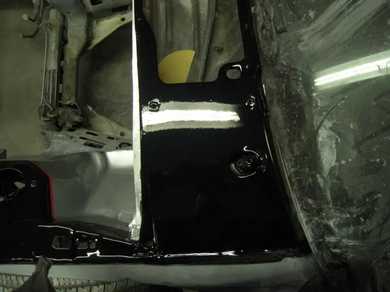

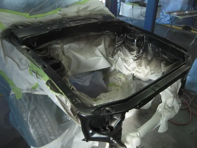

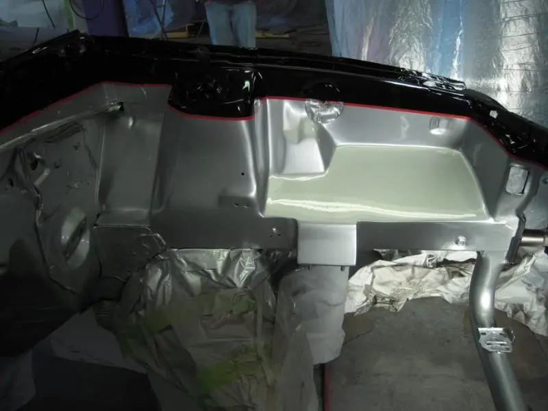

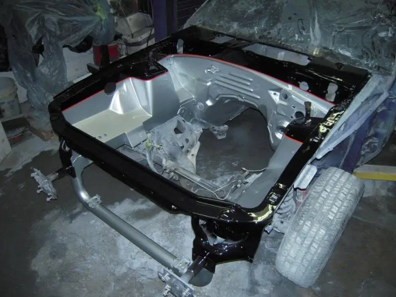

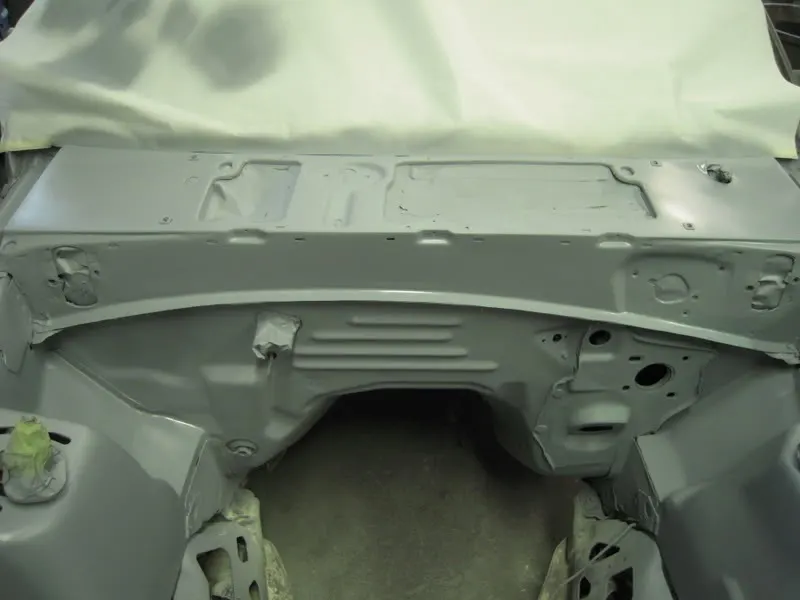

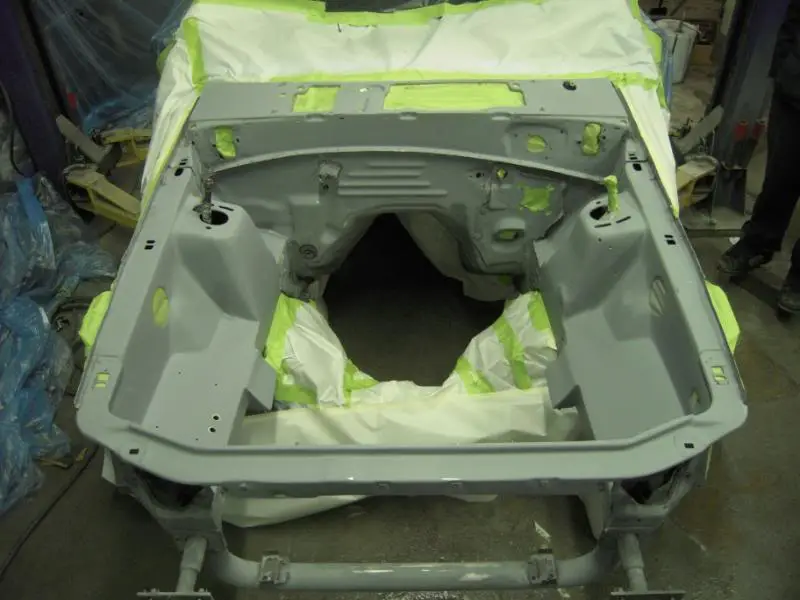

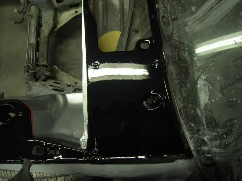

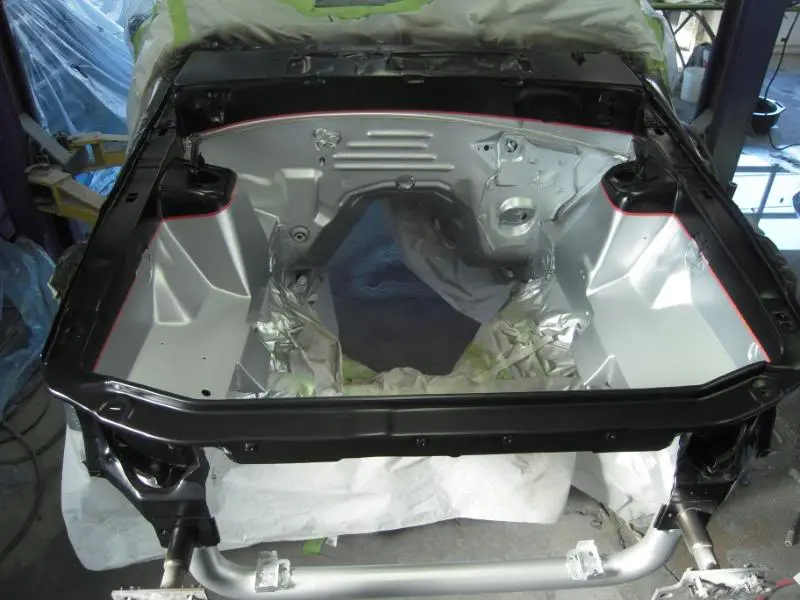

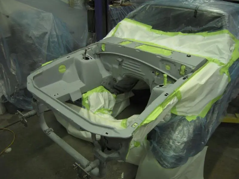

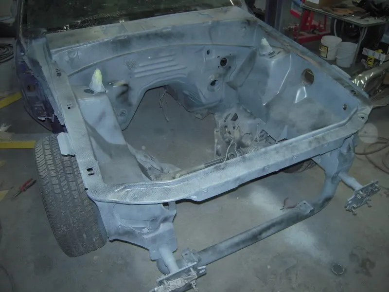

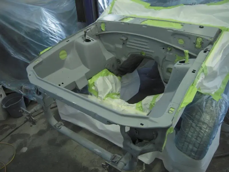

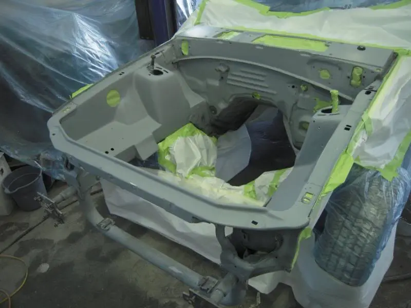

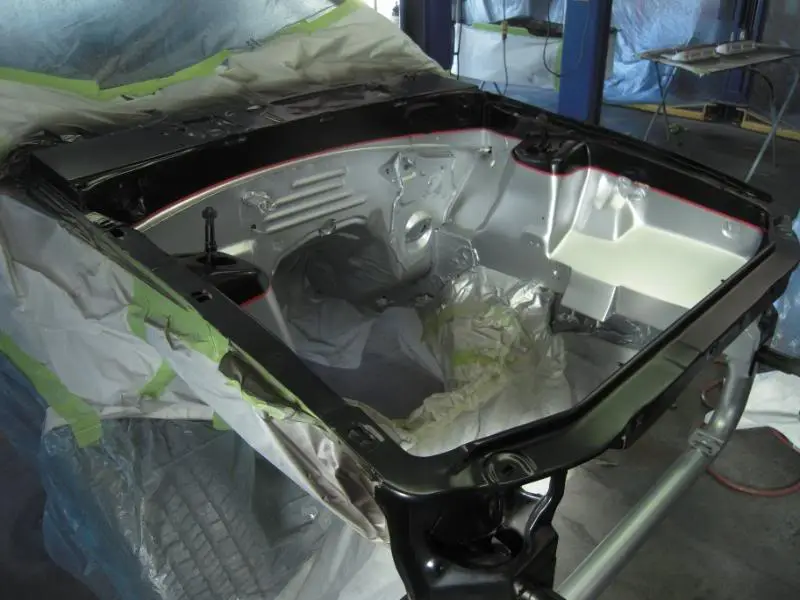

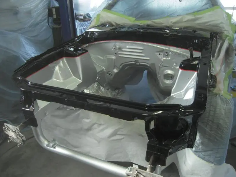

After 8 LONG months of wondering how its going to look and countless hours of sanding and blocking and sweating and cursing ITS FINALLY PAINTED!!!!!! I'm in awe about it, I can't believe its painted and that its MINE!!! Here are about 50 pictures of the process. Enjoy!!!

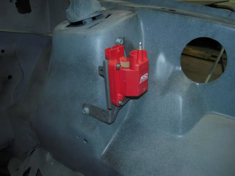

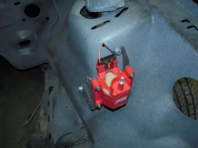

MSD 6AL-2 and MSD Blaster Coil Mocked up
Wet sanded and all prepped up and ready to go as of 12:30 am last night.
SPRAY DAY!!

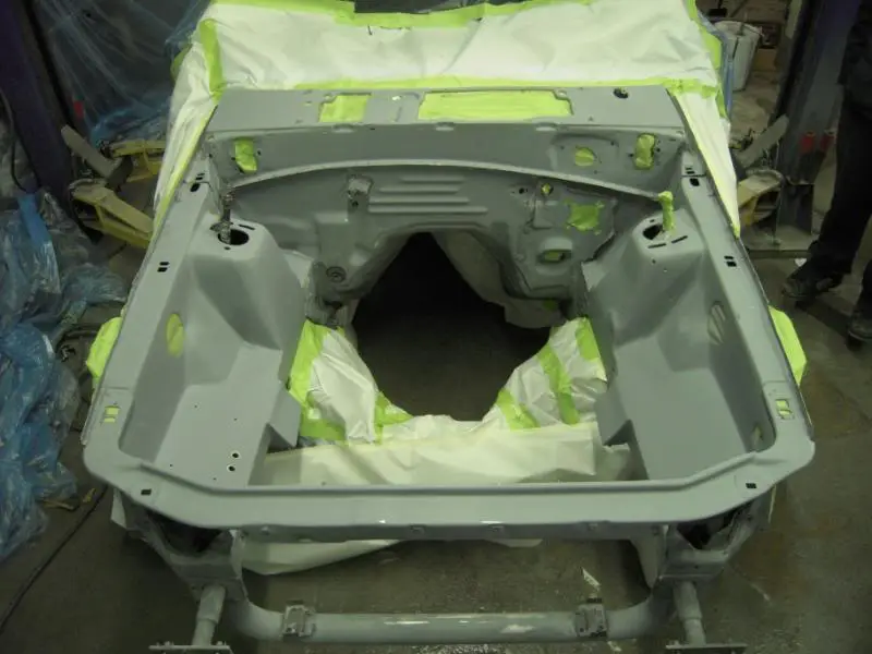

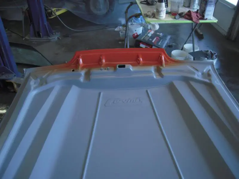

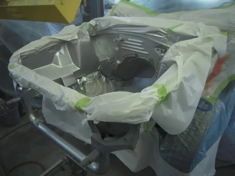

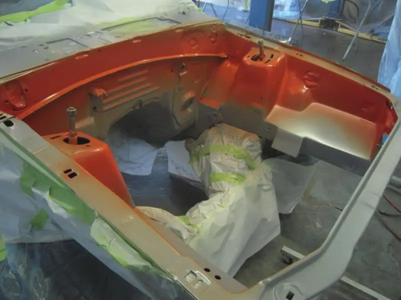

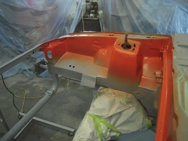

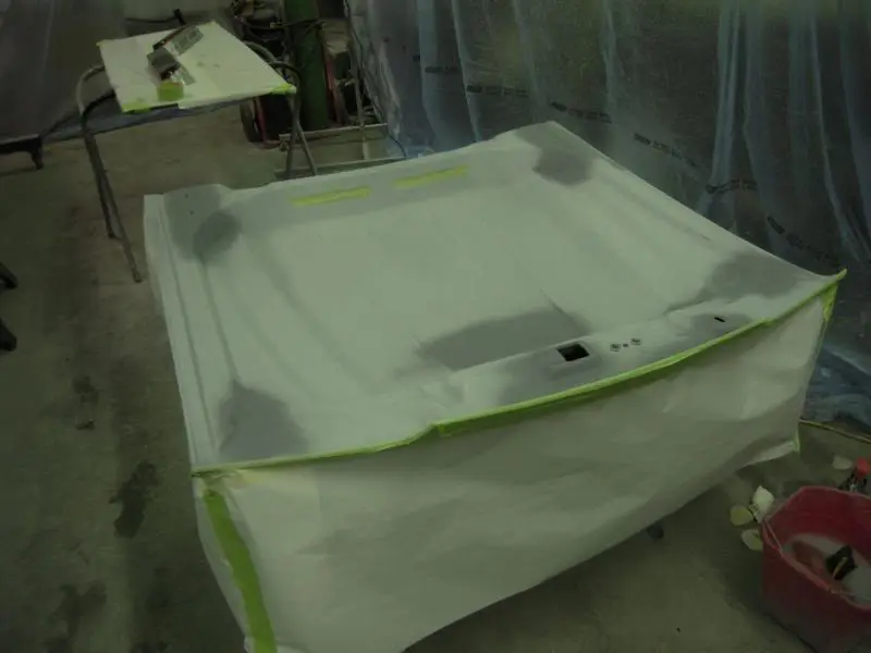

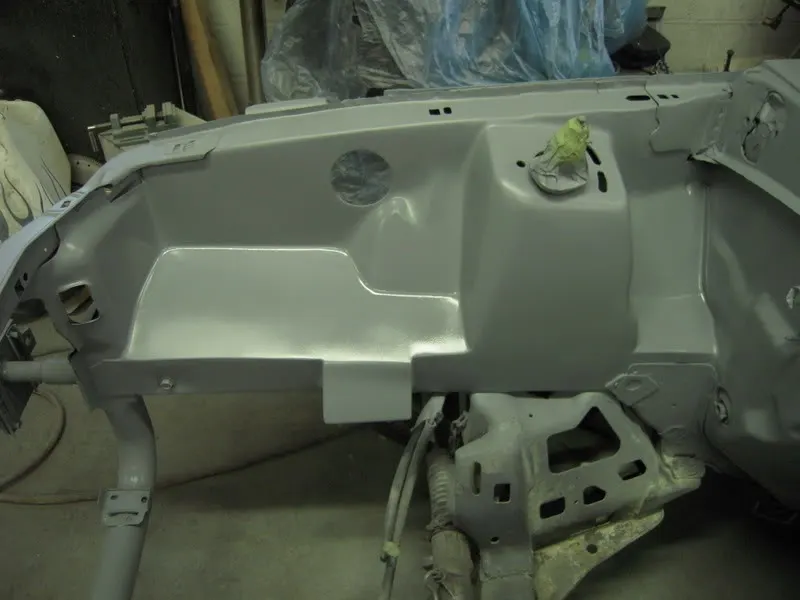

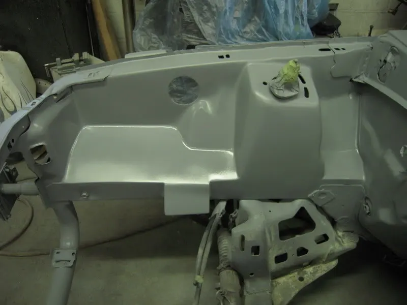

1 coat of DTM Epoxy Primer Sealer

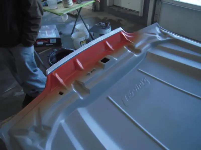

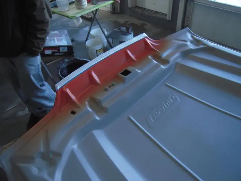

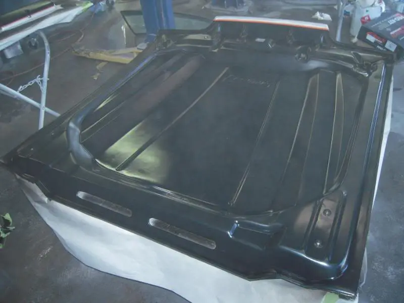

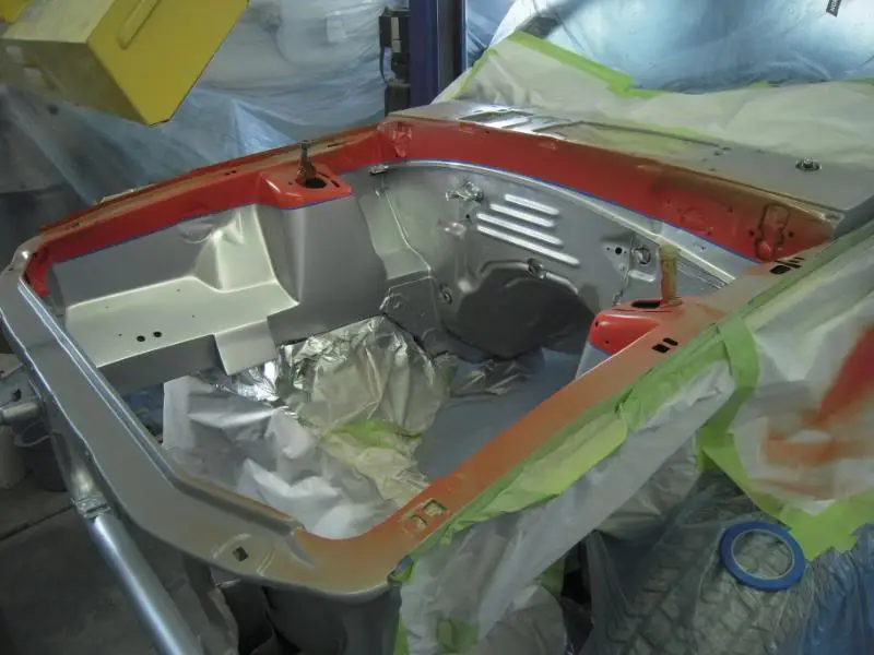

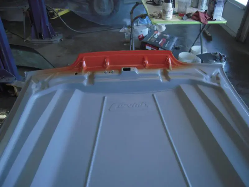

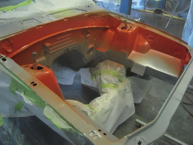

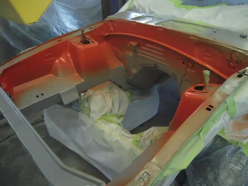

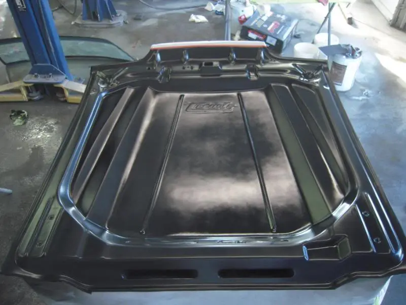

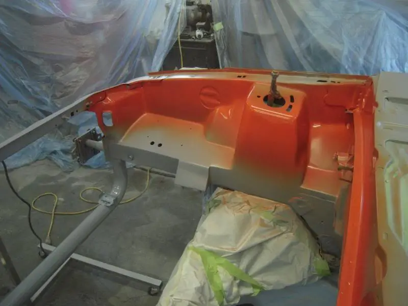

3 coats of Competition Orange for two tone break.

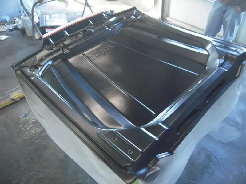

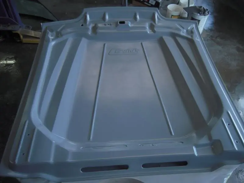

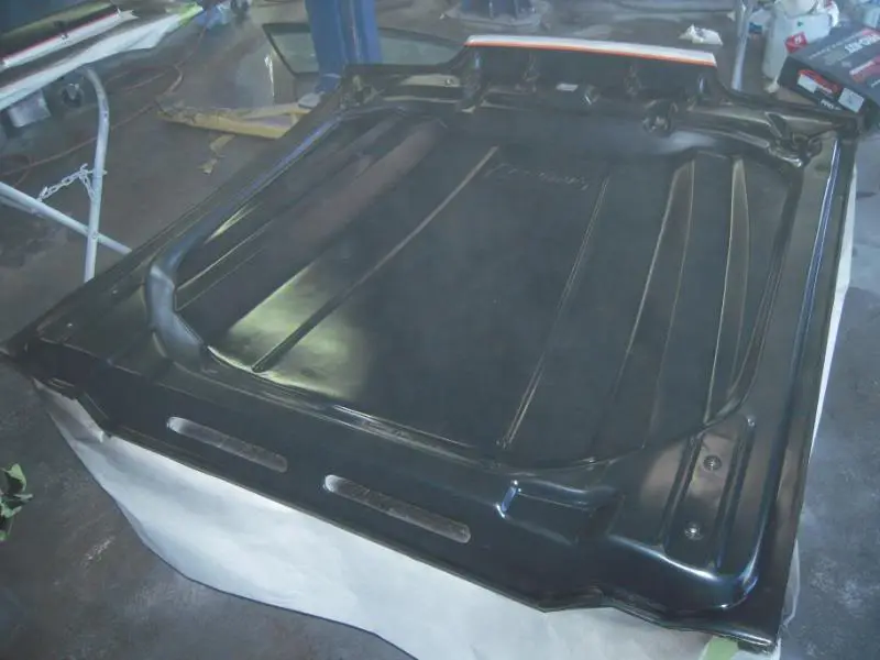

Brought two tone to the back of the hood as well.

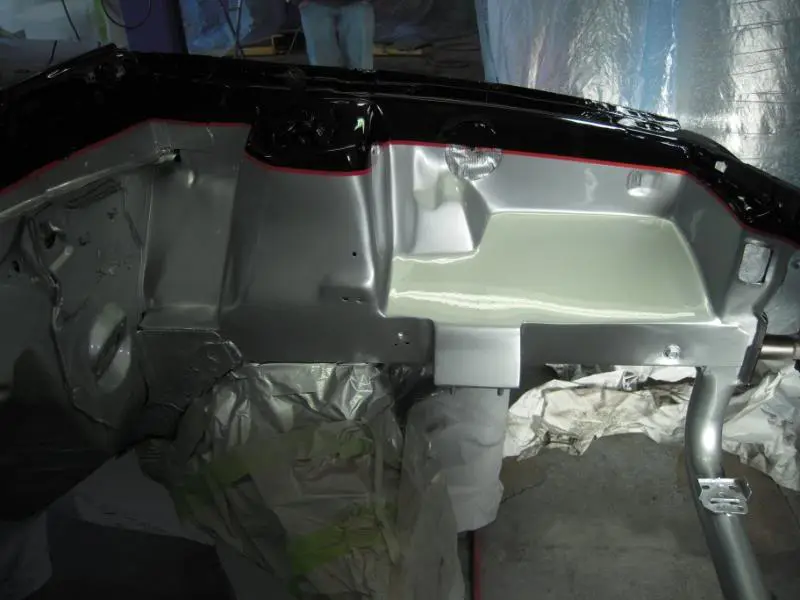

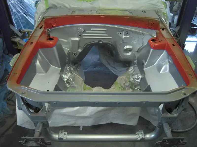

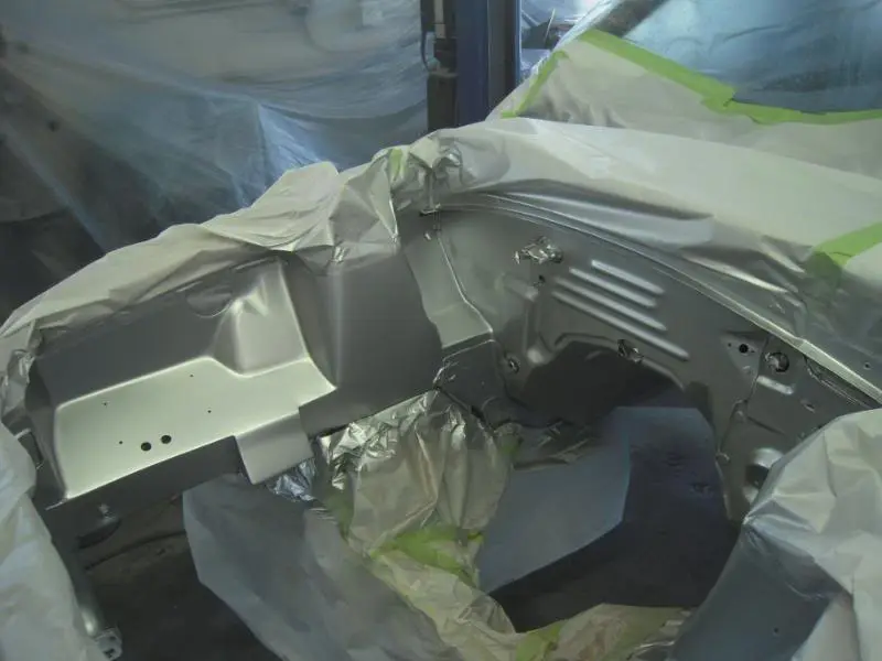

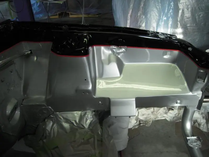

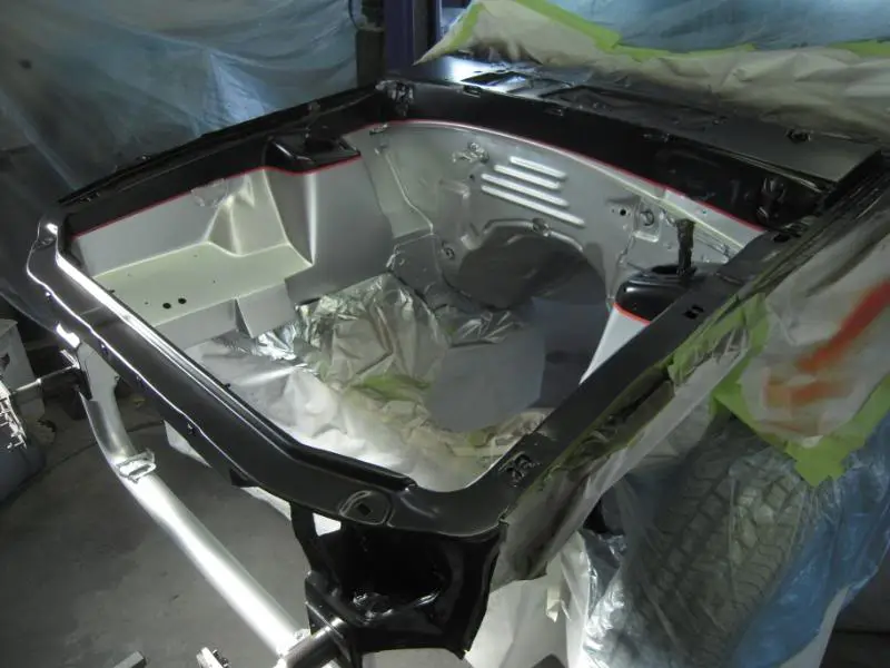

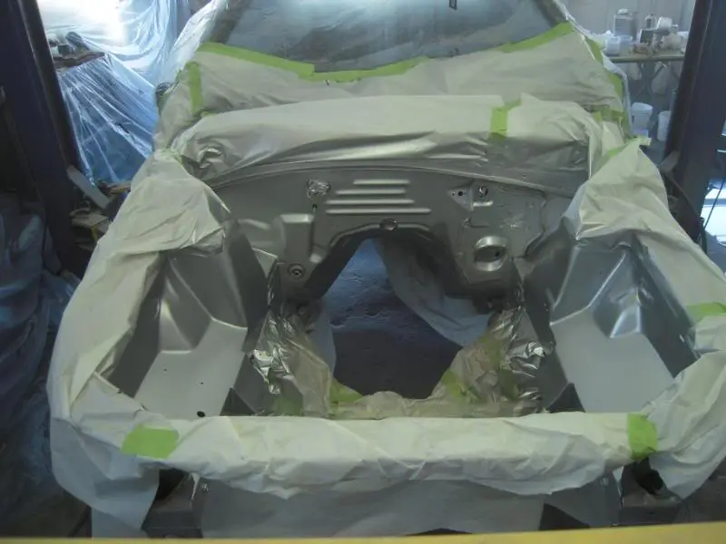

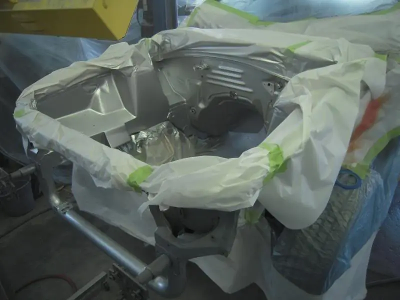

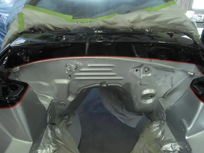

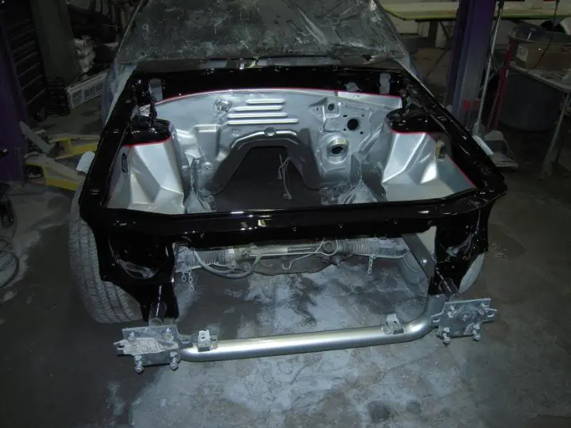

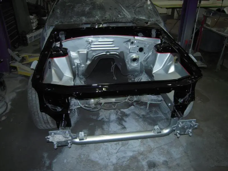

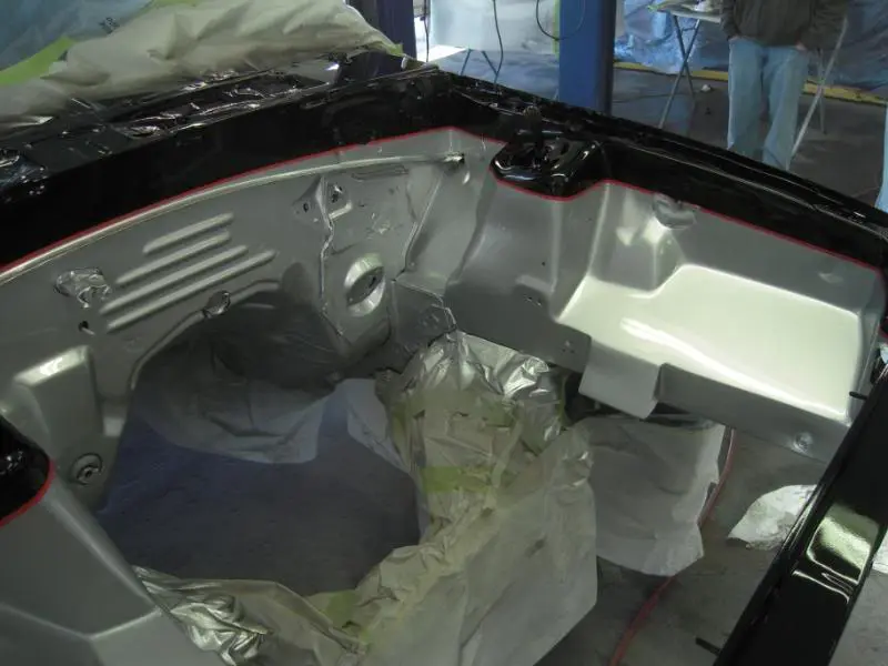

Taped off and sprayed the silver for the bottom. 3 coats of Volkswagon Reflex Silver. One light coat of blue pearl coat was laid on it in hopes that at night it will have a blue hue.

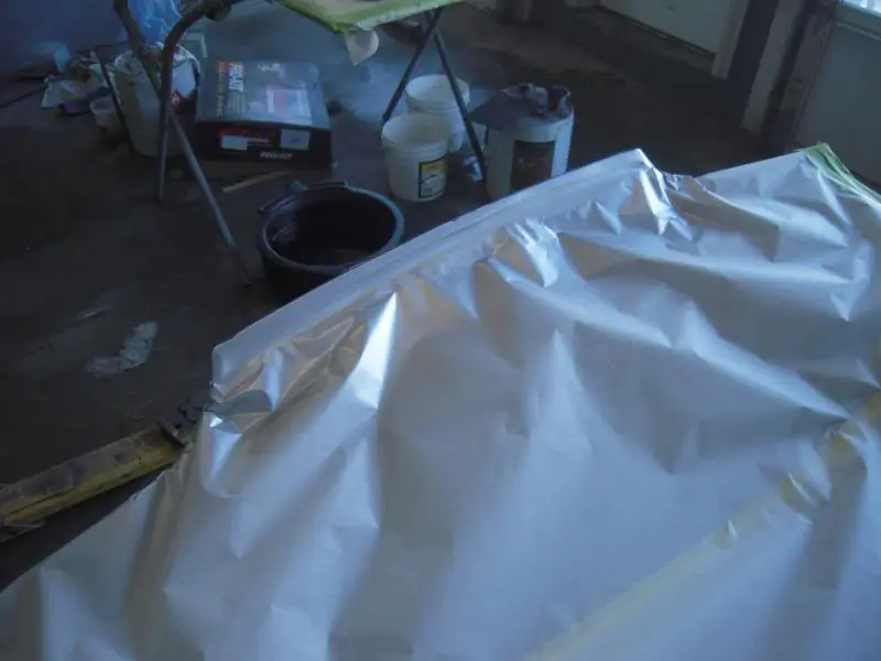

Paper removed and waiting to tape off to spray the black.

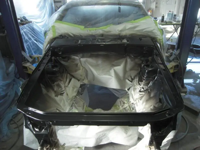

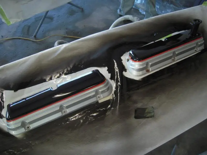

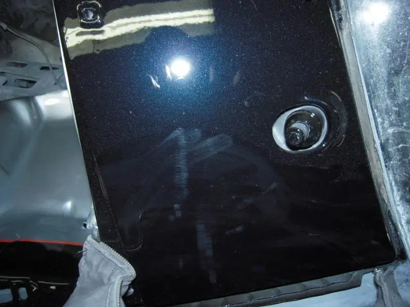

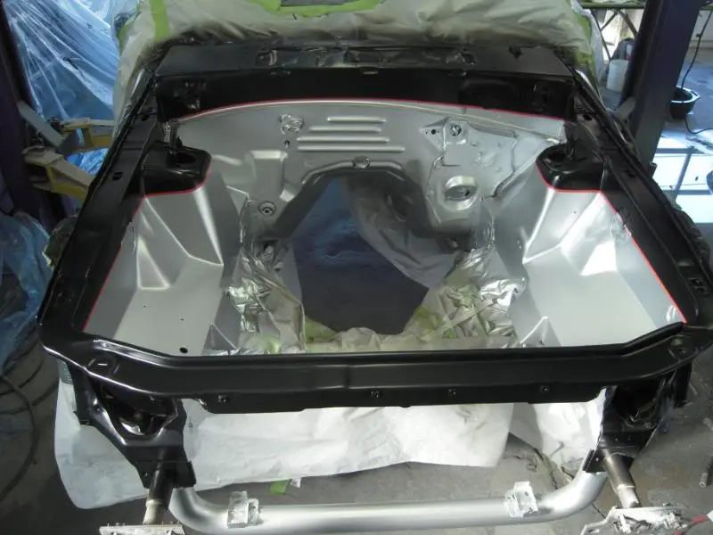

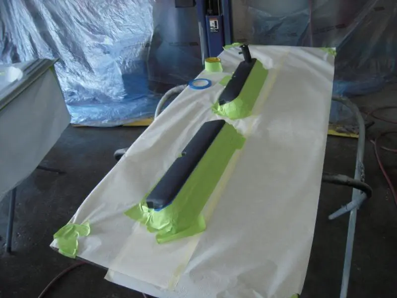

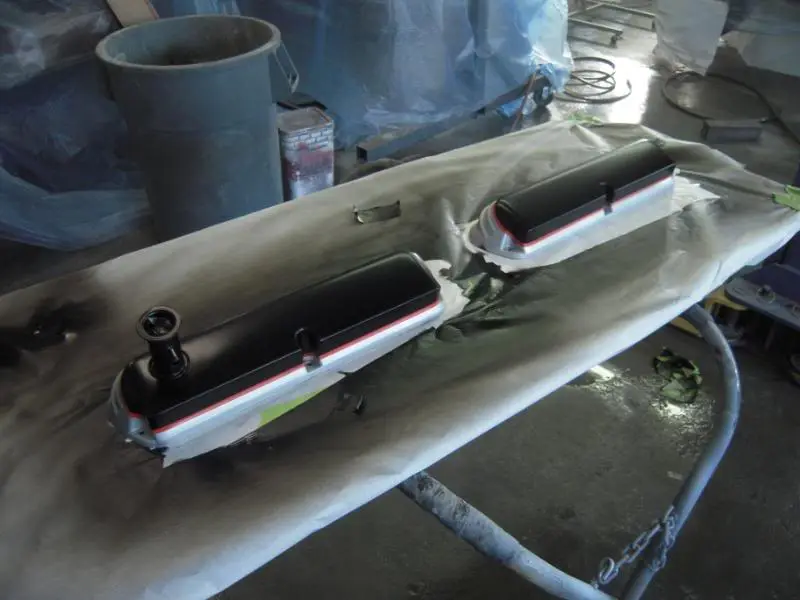

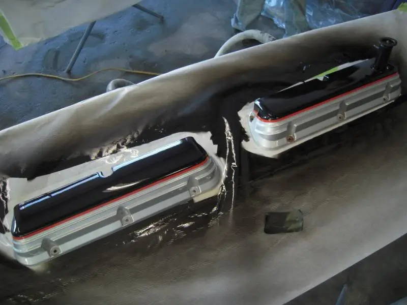

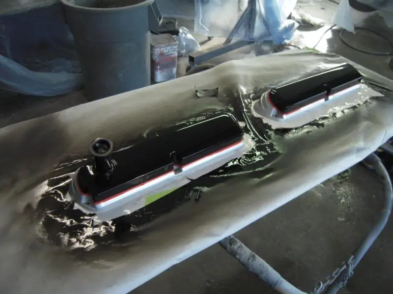

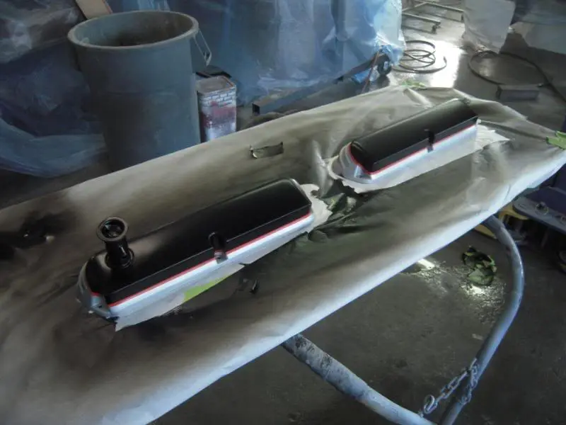

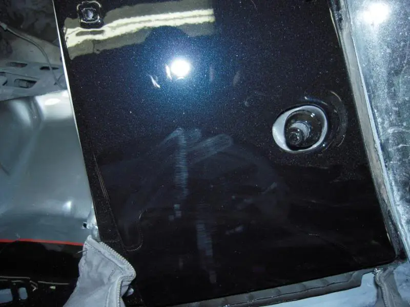

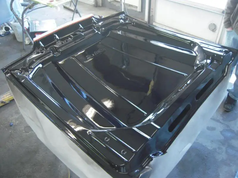

Taped off bottom and sprayed 3 coats of modified Honda Nighthawk Black (substituted the violet pearl in the mix with more blue pearl)

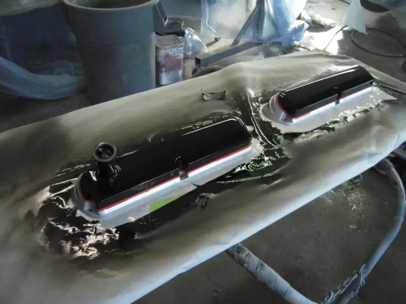

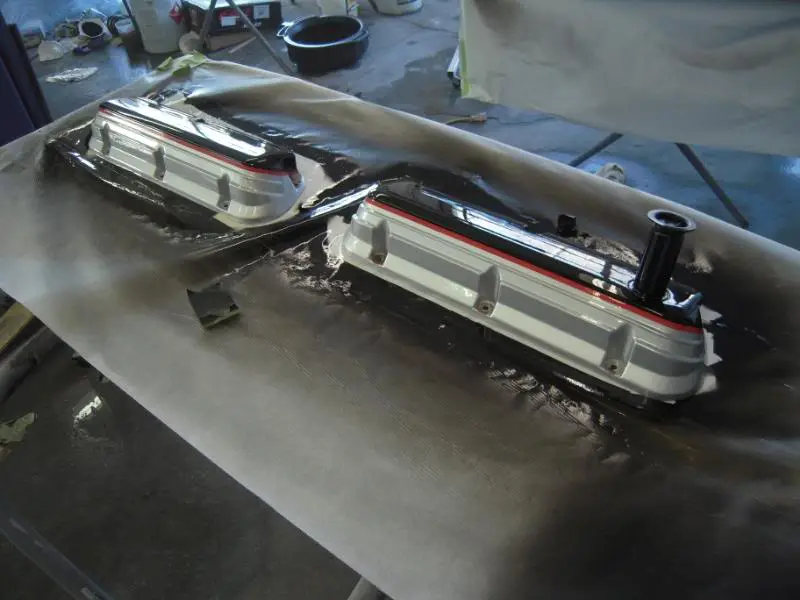

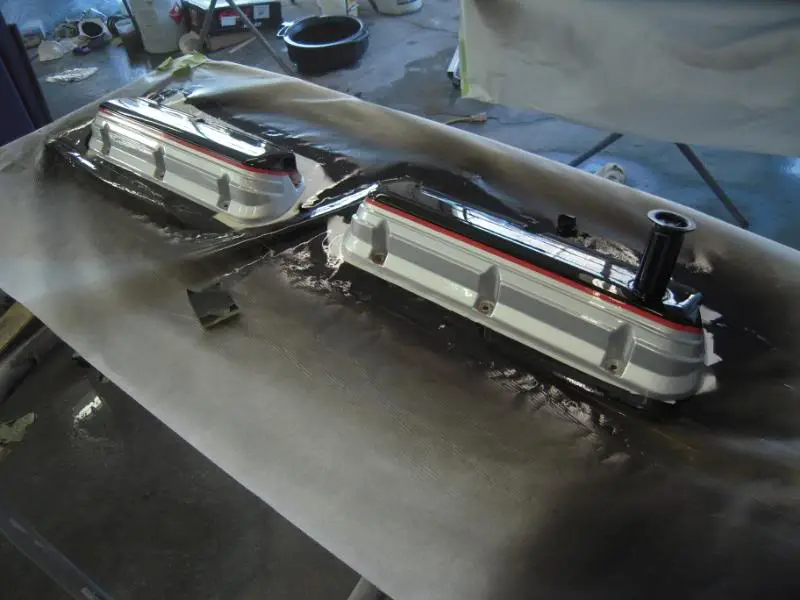

I did an experiment with regular black with a blue pearl coat over that on the valve covers but came out too dark bluish so I resprayed them.
Tape removed and ready for clear!

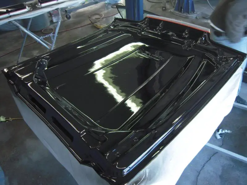

Three coats of Nason Selective Clear.
